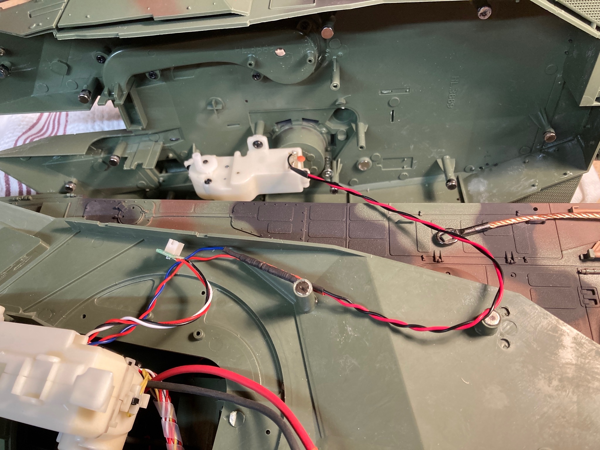

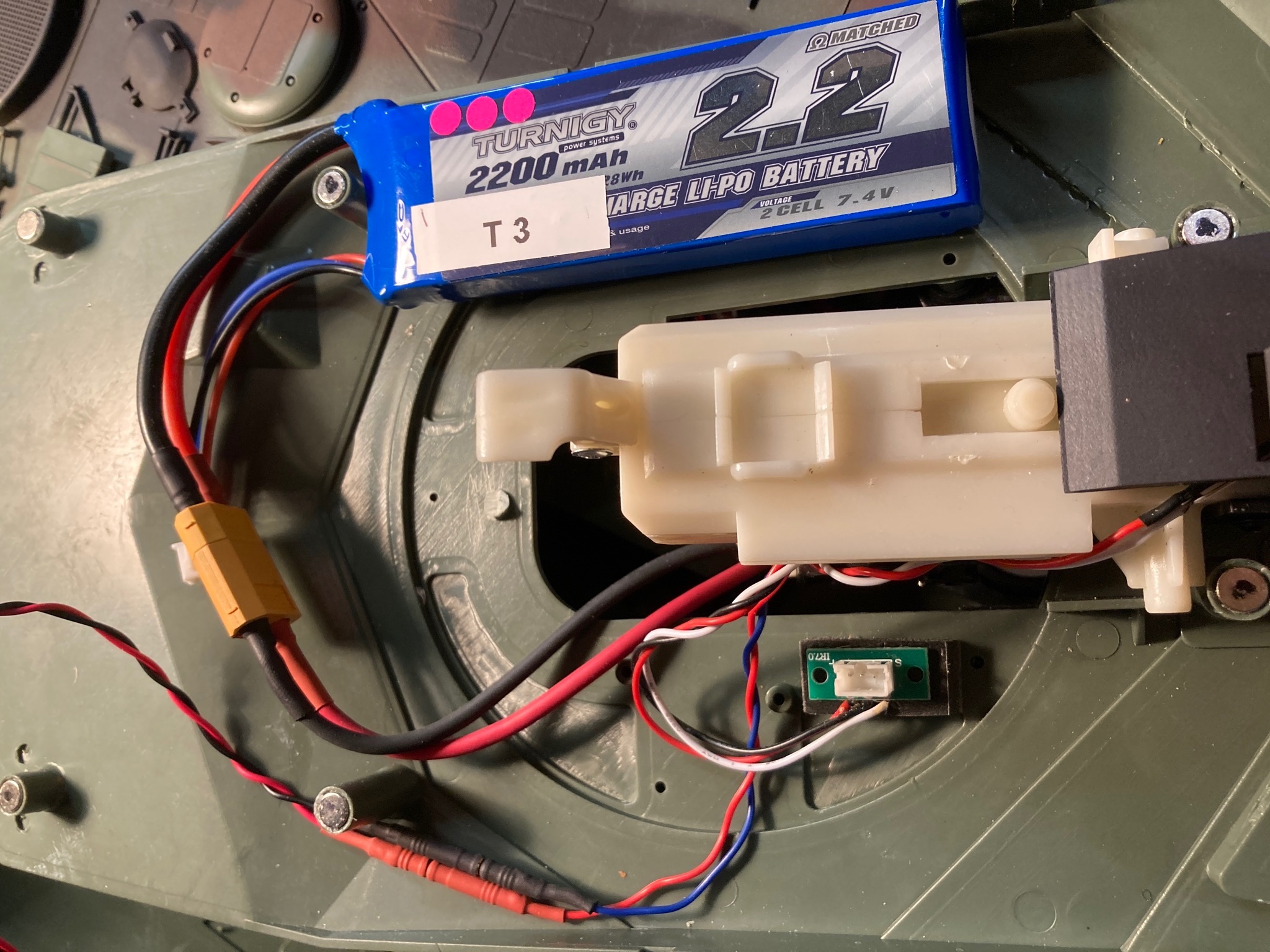

The extended wire allows the turret to sit alongside the hull when changing the battery .
With the battery fitted there is still lots of space inside the turret. The socket for the battle function will also need to be extended but is temporarily held on a servo pad to stop it wandering about and falling down inside the hull !

Slick wiring Mr Zooma, overall very tidy solution your pulling off.
Top job that Man !

Thanks Herman,
Electronics is not my strongpoint (nothing is to be honest), but I like to see tidy wires and neat soldering so I keep practicing until I get it looking OK.
Extending the “battle socket” may not be quite so easy but a long radio extension lead could be chopped in half to provide the wires with a plug and socket to lengthen the wires and allow it to be unplugged when the turret top needs to be completely removed with no wires attached to the lower turret.

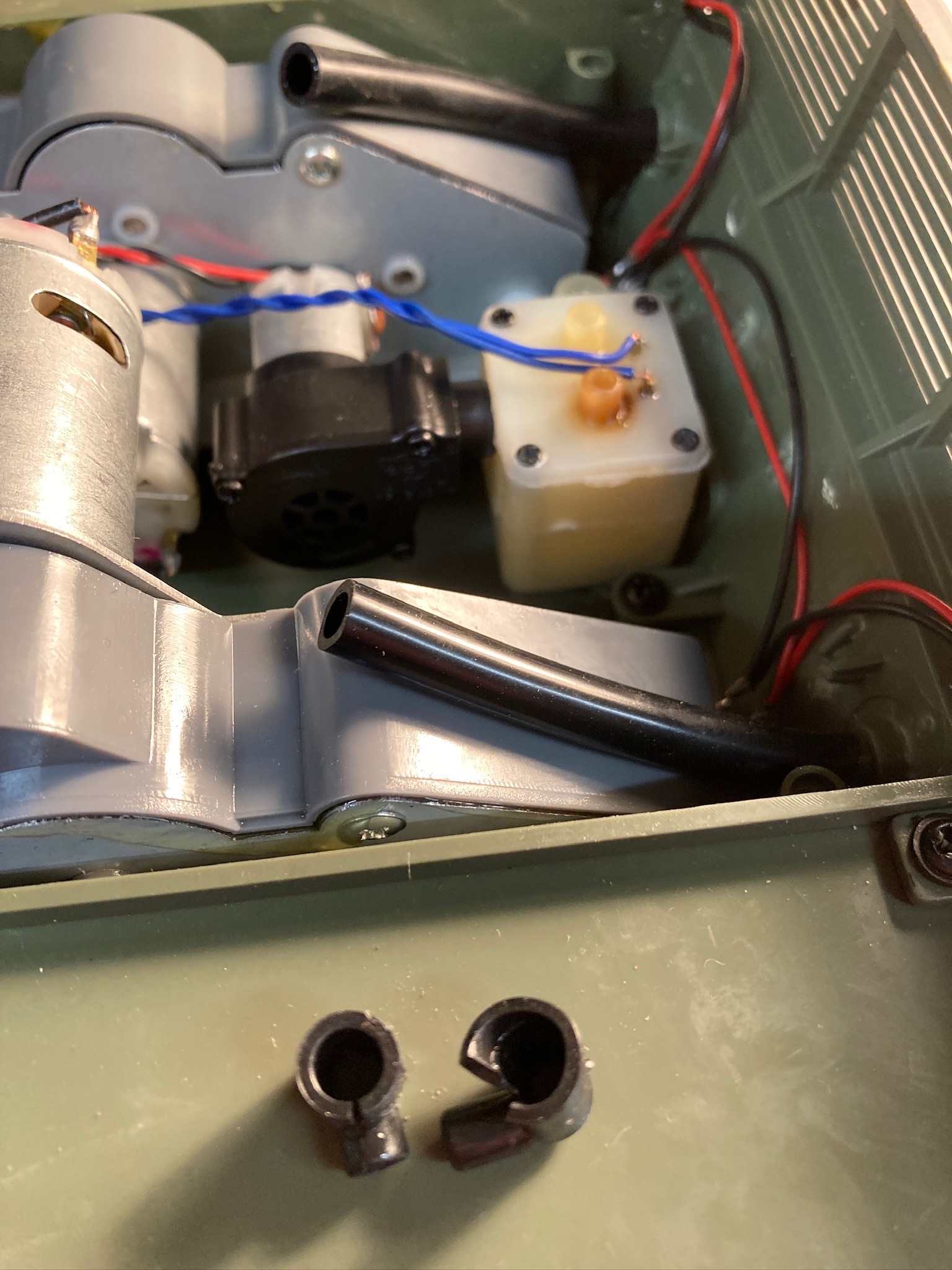

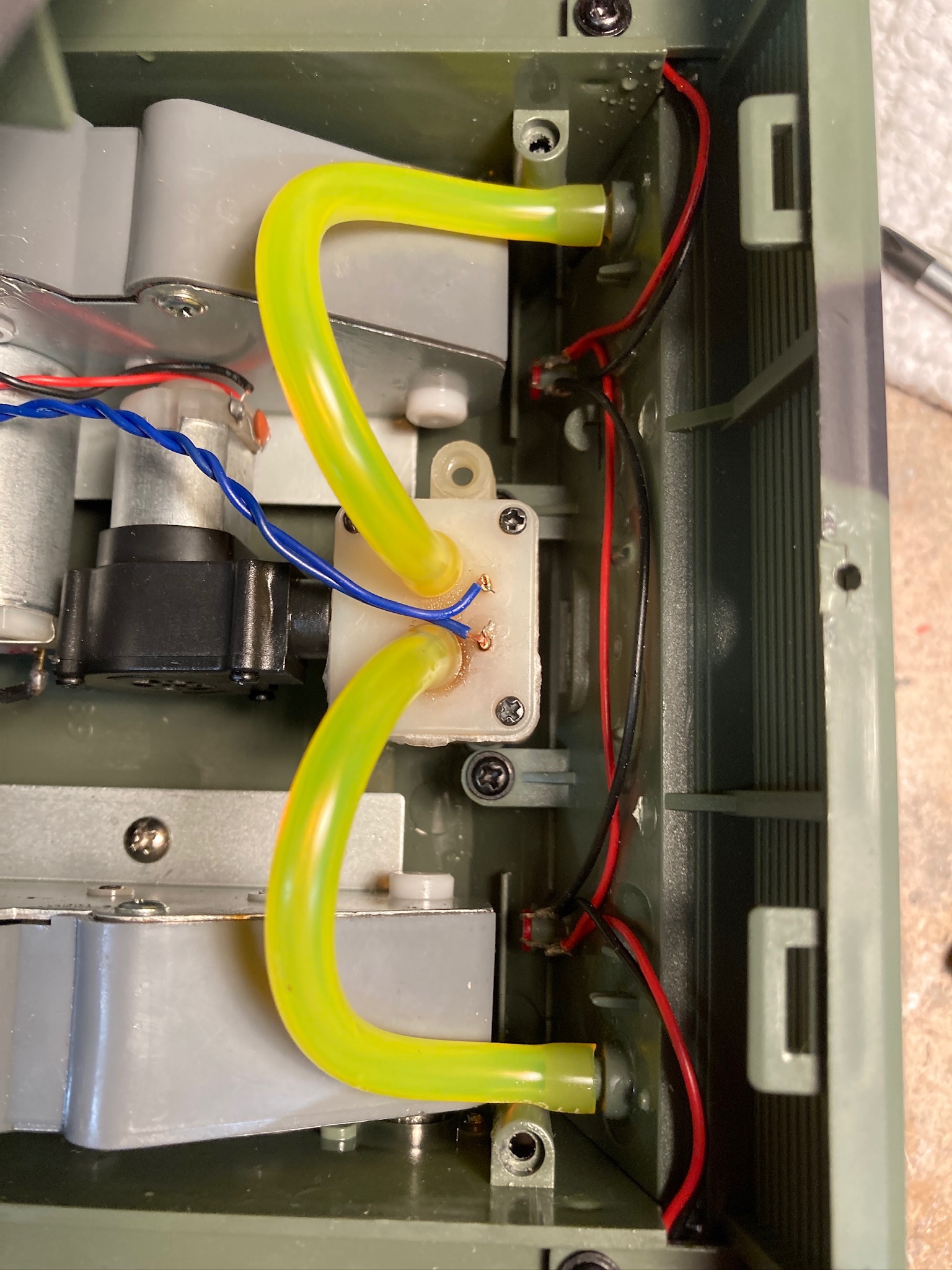

Re:Heng Long Leopard 2A6 Smoke Problem
When running my HL Leo 2A6 last time I noticed the the smoke function was working OK but the smoke was coming up around the top deck and not out of the exhaust outlets!
Checking inside I noticed that the two black moulded caps that sit on top of the smoke unit had split and melted!
As the unit was still making smoke, the unit had obviously not been allowed to run dry.
Rather than buy and fit two more of these “melting caps” I did away with them and connected some yellow Tygon petrol tubing directly from the smoke unit to the exhaust outlets.
Time will tell if the Tygon tubing holds up OK, but it is a good tight fit - much tighter than the original soft “rubber.” tubing and the installation looks tidy.
If it fails - it won’t be any worse than the original factory fit !
Sadly - the Tamiya Leopard 2A6 does not have a smoke function, so this is an advantage that the Heng Long Leo has for those (like myself) that like to see smoke coming out of the exhaust outlets.
.........but it is something else to maintain or repair when it goes wrong!

That tubing looks like it will do the trick. The HL plastic (ABS) leaves a bunch to be desired and often splits. I hope this will be the cure. Great work!
