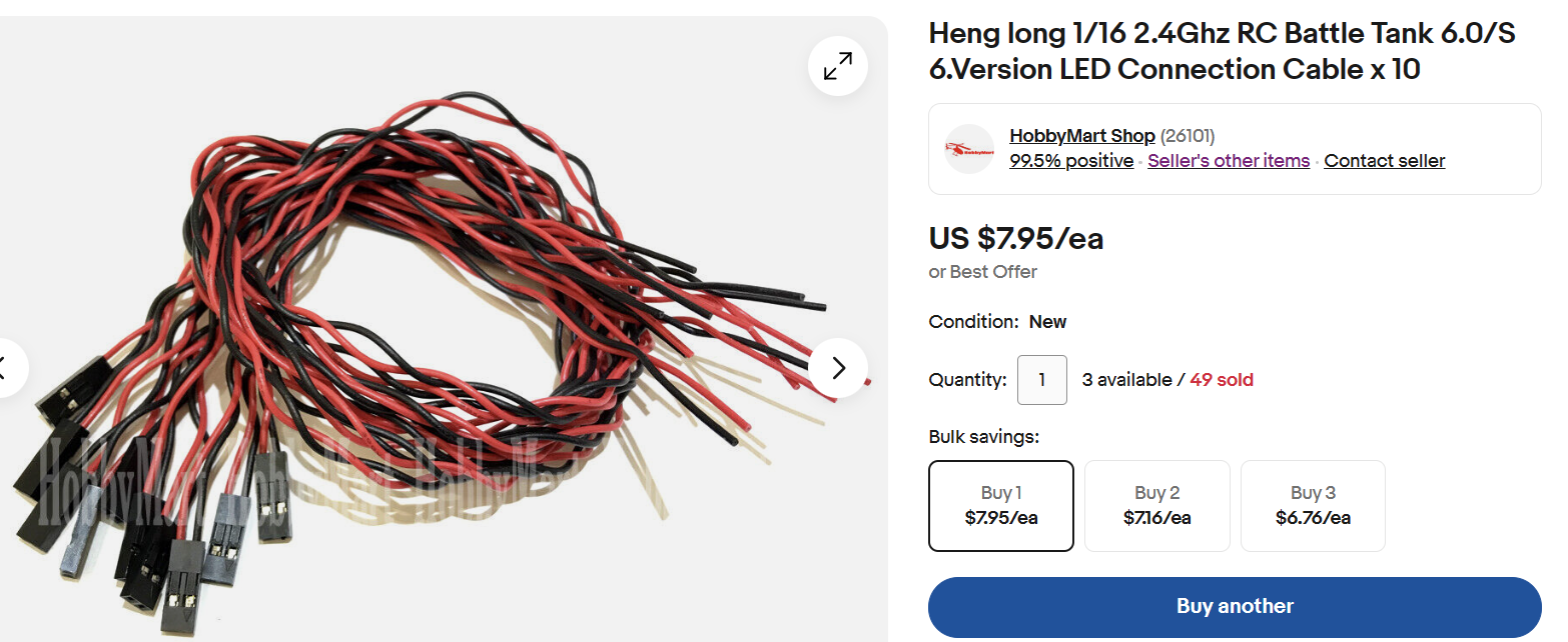

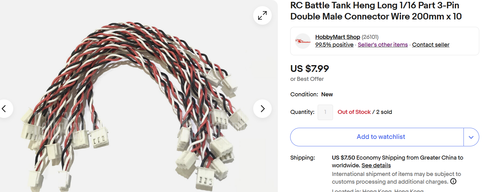

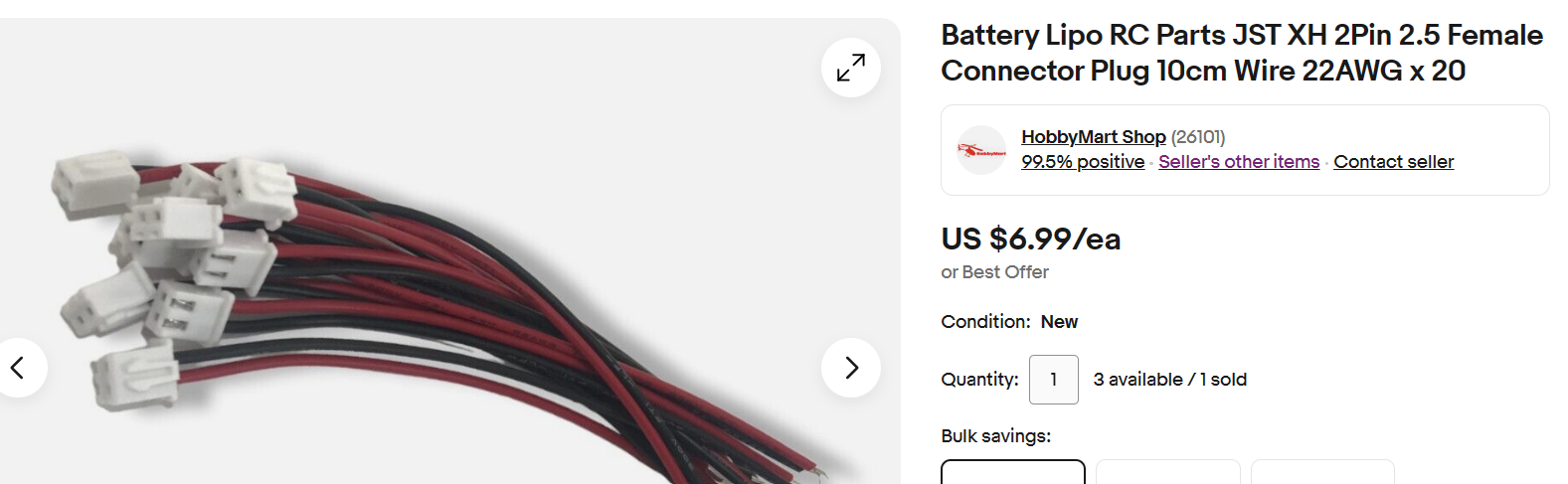

Herr Dr. Professor wrote: Sat Jan 13, 2024 12:45 am Louis, I have noticed from photos and discussion here on RCTW that the Tk 7.1 seems to use motor connectors different from the JST 2-pin type. Did you find that switching the 7.1 to an older HengLong tank is nonetheless a simple swap-out?
Yeah, i had to replace the connectors on the Taigen gearbox motors to match the TK 7.1, but it's fast. I also ended up having to buy a lot of connectors for the rest of the electronics, and specially for the LEDs. Need a lot of them.
Some of my purchases on eBay last month.

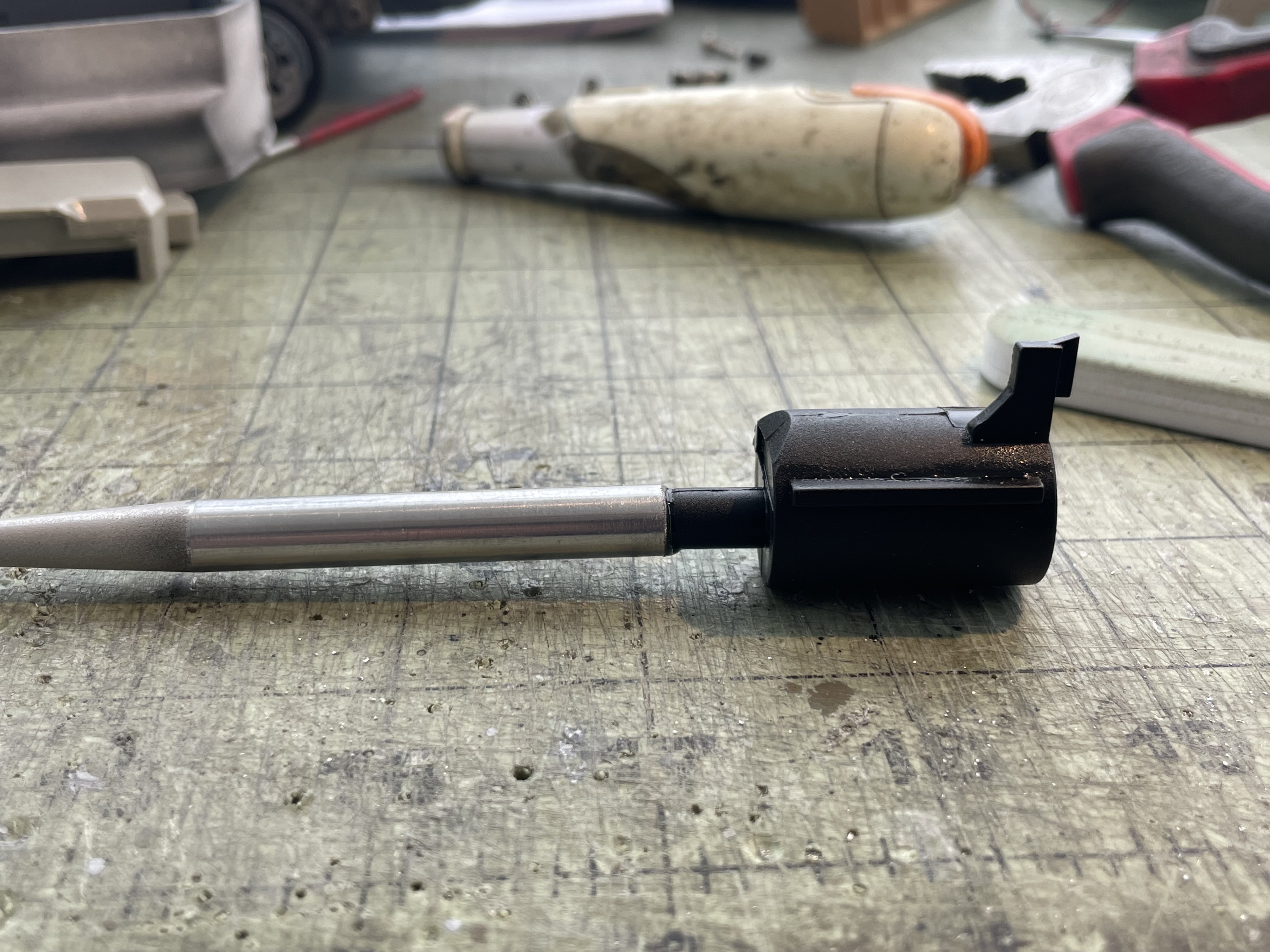

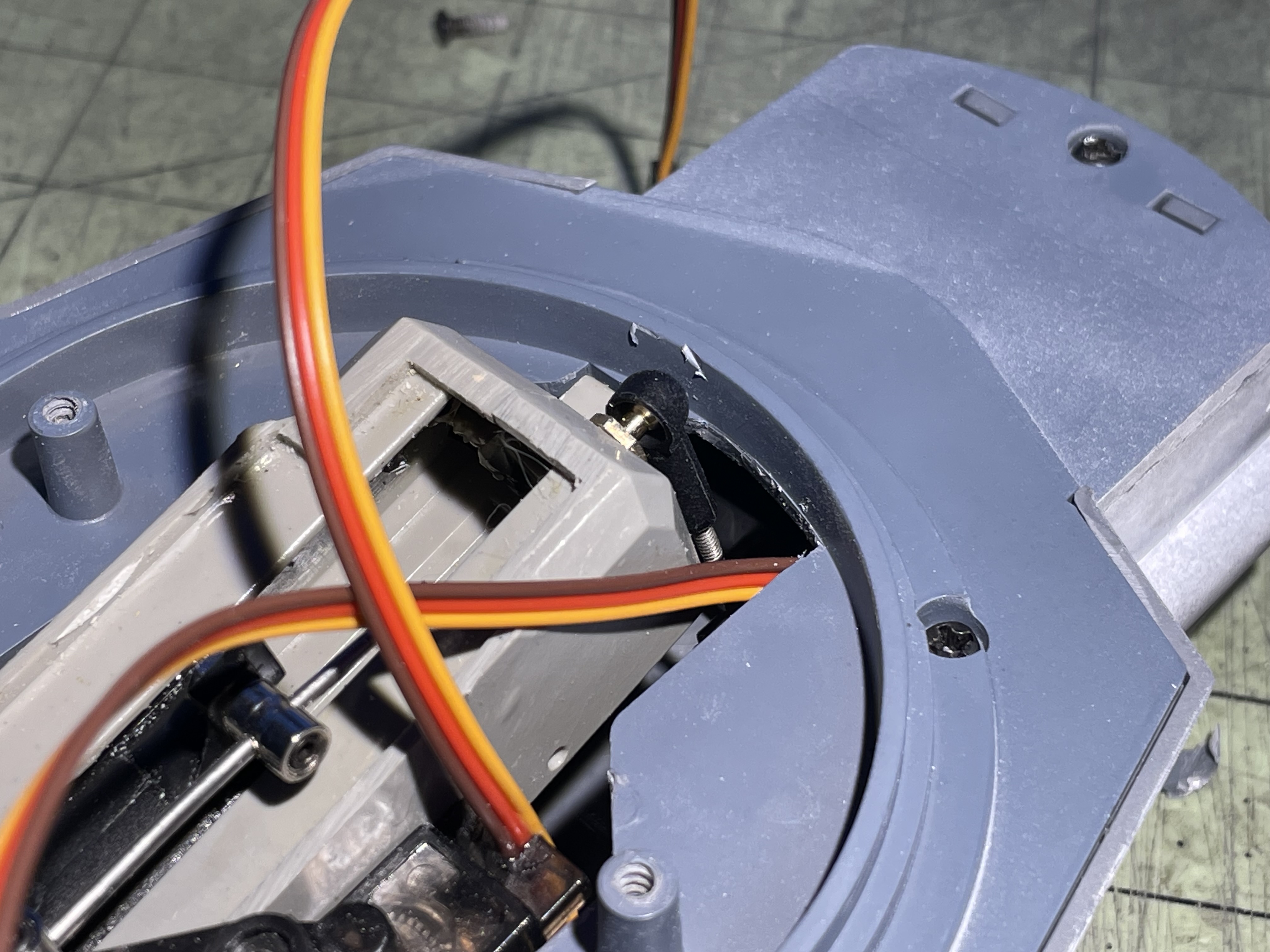

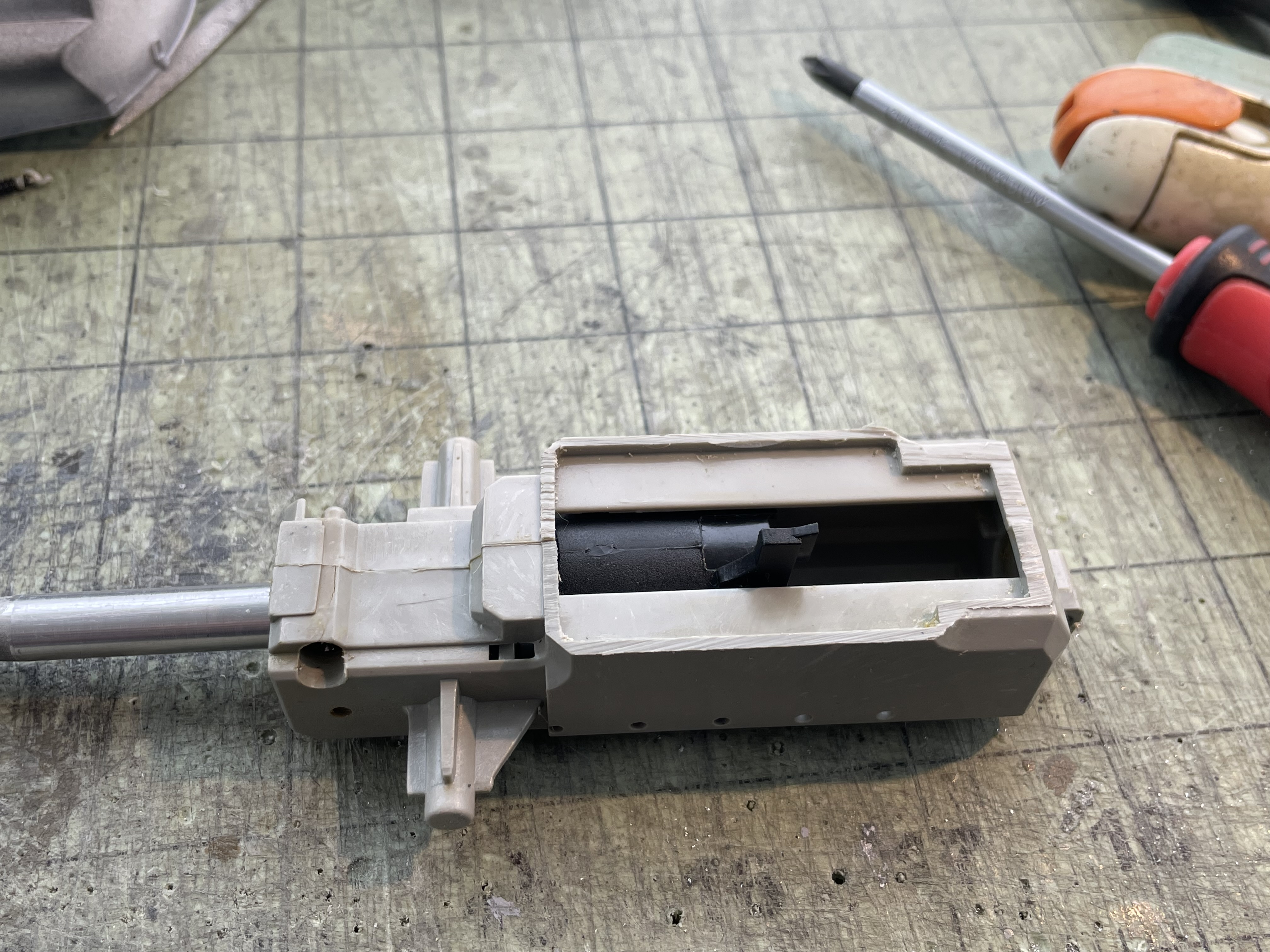

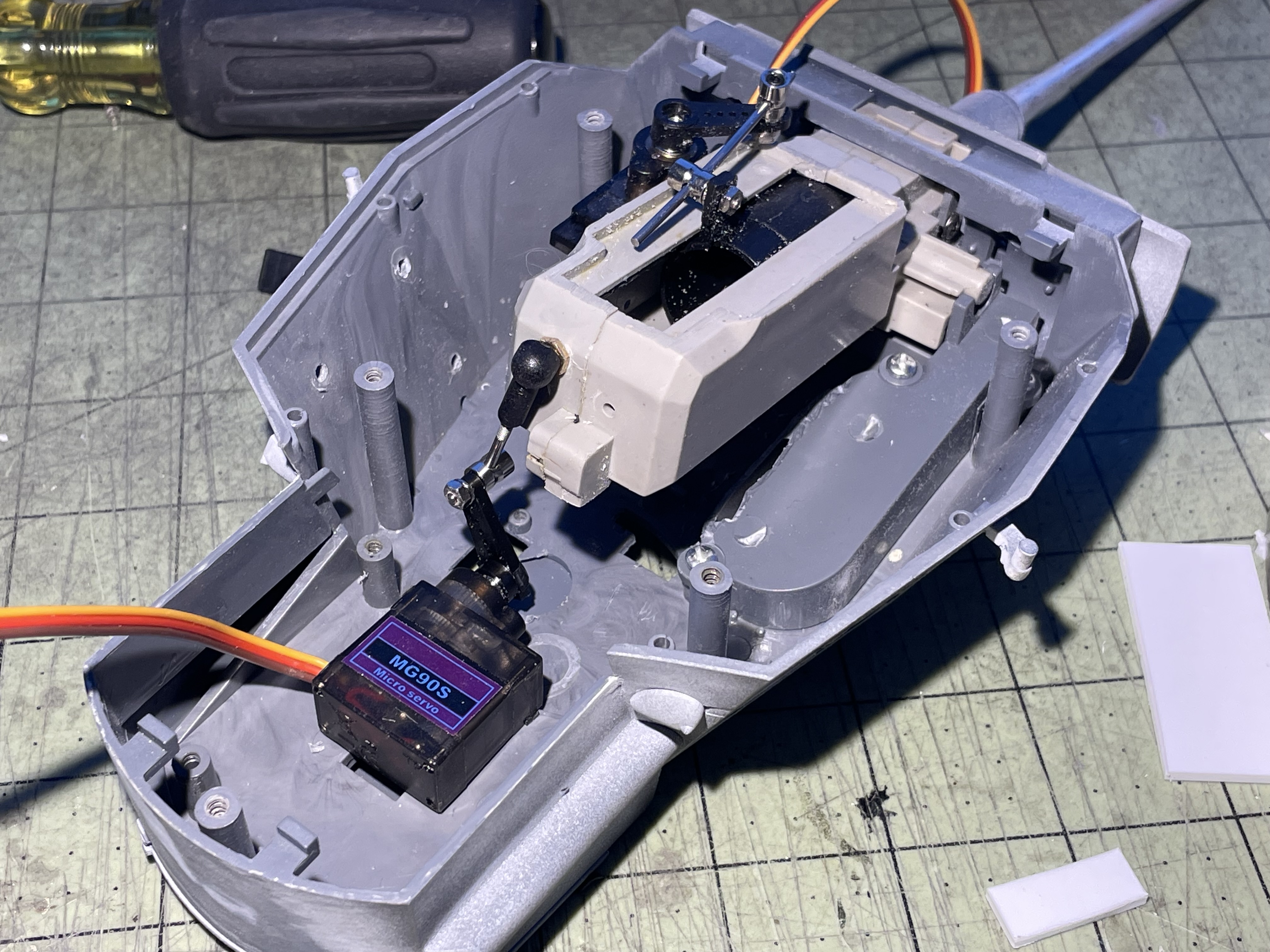

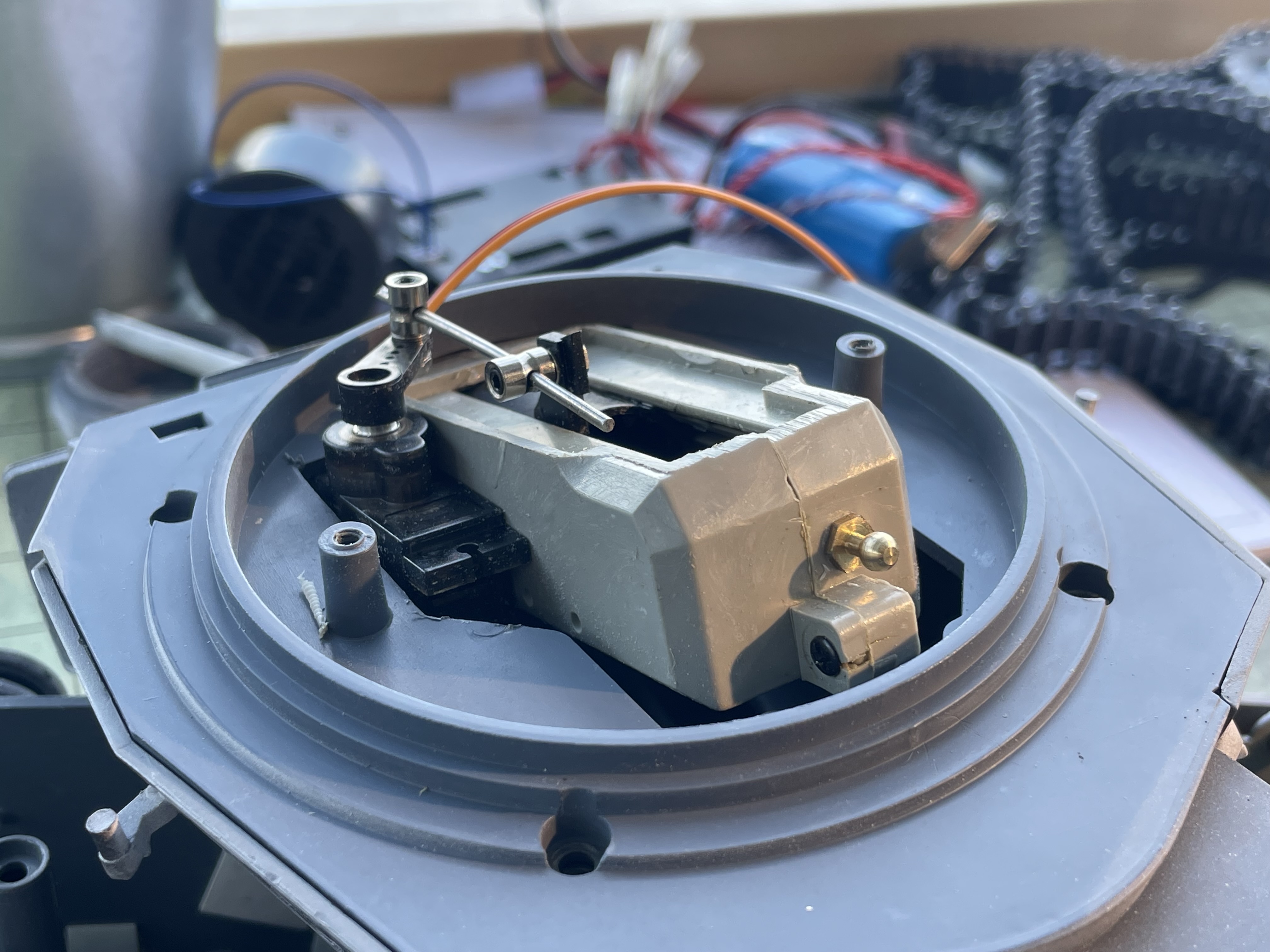

Here is a couple more pics on the recoil unit. I improve my design with every build. This time, I decided to leave the plastic bracket on the slider and connect the recoil push rod to it. Those little metal swivelling push rod connectors are excellent, cheap on eBay. It’s solid enough. I gave an angle to the servo to optimize the recoil. I tried and tested a couple of locations for the elevation mount point until I found the best one.
