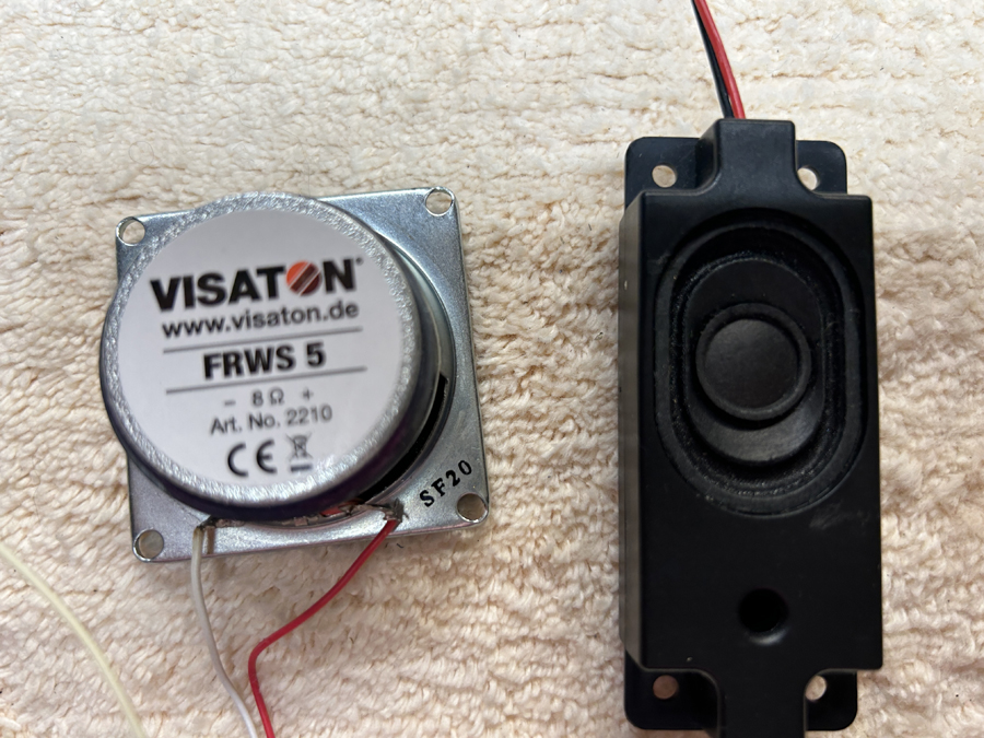

Back on May 22 (of this year
) jhamm noted that in at least one of his excellent FAMOs he used a Visaton speaker: "The speaker is a FRWS 5 with 8 Ohm and fit perfect behind the radiator grille." I immediatley bought the same speaker (below right), intending to use the same. But I have found that the volume of the Visaton speaker is much too soft and that other speakers, particularly, but not only, the single or dual HengLong speakers (single shown below) produce much more sound. Can anyone explain the cause of the difference? (HengLong does not specify what ohm ratings for the speakers. I am using the SGS #258208 TVC-TRF05 HT8: Famo MFU.)

HL are 3 W 4 ohm I believe
The Visy 8 ohm causes too much resistance.
Ideally a 10 W 4 ohm will get you a good result

I use the Visy 5 in 5 of. Y tanks and they work well better than the HL ones.
All 4 ohm
All 4 ohm

Hello,
a 4 Ohm Speaker is louder than the same with 8 Ohm - because the Ohm´s law.

If you connect 8 ohm speakers to a 4 ohm amplifier, the audio volume will be about half as loud as when you connect 4 ohm speakers. This makes sense, because under an impedance of 4 ohms, the amp can deliver all its power, and the speakers can then fully utilize this power. Please note that it is important to match the impedance of your amp to that of your speakers.

Thank you all! Your answers confirm exactly what I suspected. I am going to hit eSlay and Amazon to try to find the same sized Visaton speaker in 4 ohm because it would fit perfectly behind the grill of the FAMO. I'm still plugging away at this build.

Seems to match your wishes? you noticed that there is a plus and a minus on the HP, I don't know if the sound quality changes significantly? Connected correctly, the membrane must move forward

the speaker in your link is too much in size... 70mm

Yes, I saw that problem. Here is the dimensional data of the 4-ohm Visaton speaker I ordered:
