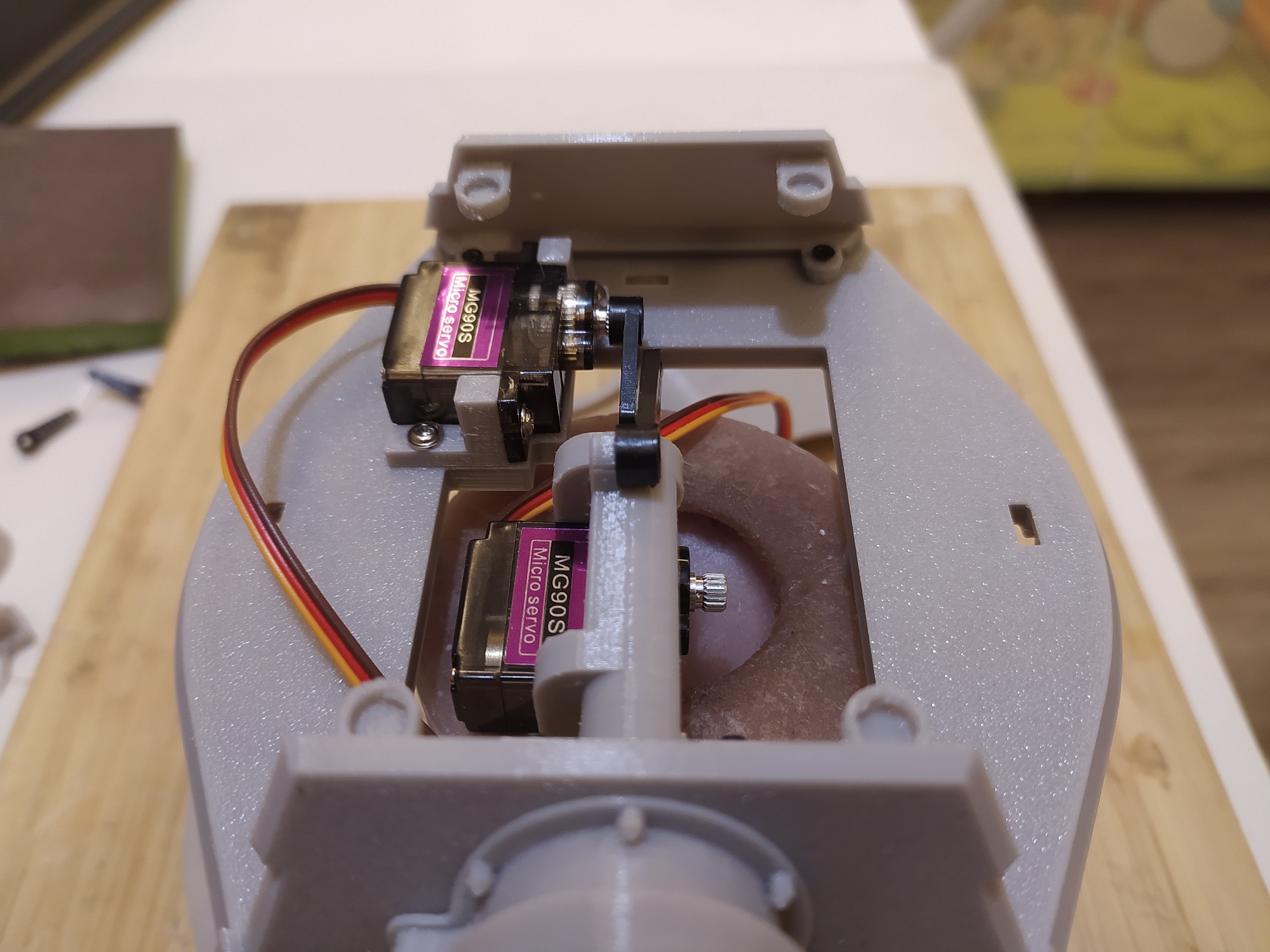

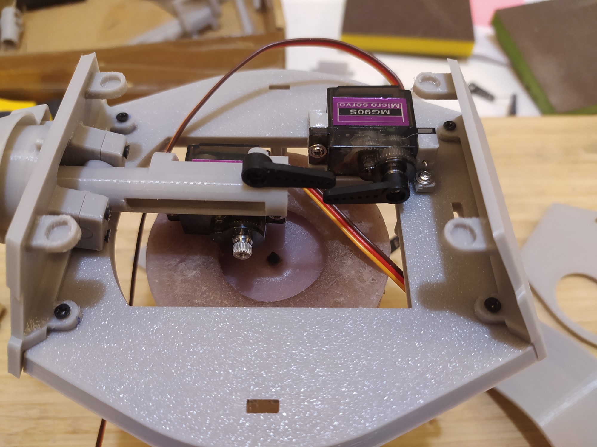

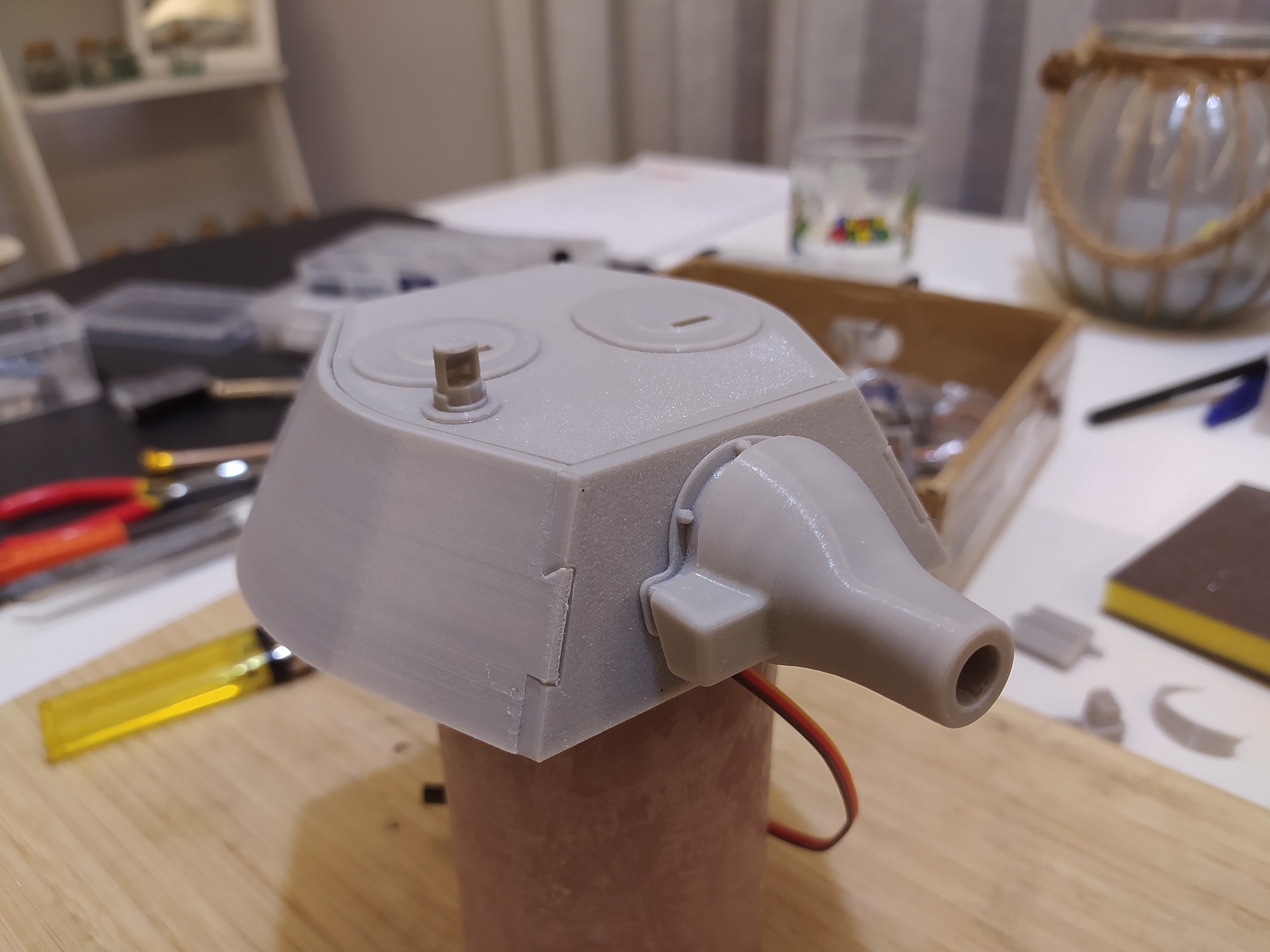

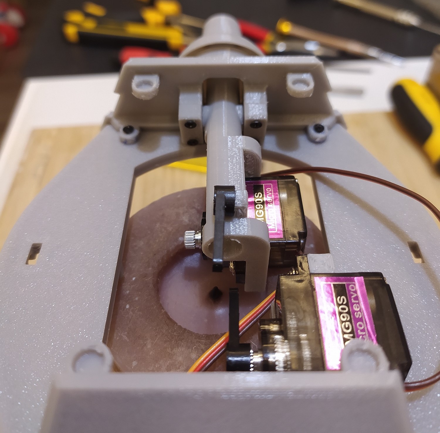

by Edumardo

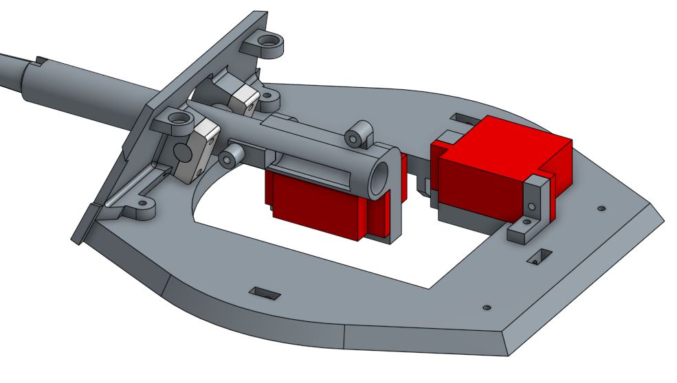

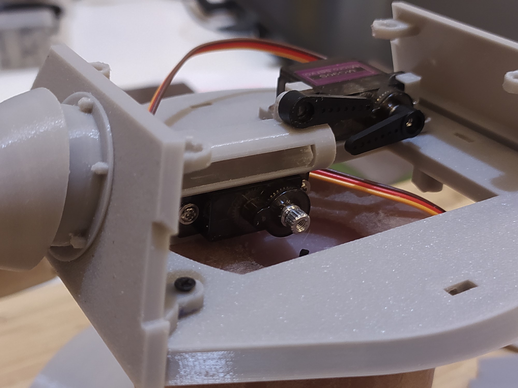

Hi gyus,
I've been busy with other projects, but good news! I'm about to publish the turret files, including turning, elevation and recoil ;)
I have spent hours and hours and hours redesigning and printing until I came up with a valid design. The recoil system is fully inspired in the RiskyR M4A1 Sherman.
A few photos of the model and construction:
turret 1.jpg (46.52 KiB) Viewed 3439 times
The entire turret and mantlet looks very smooth
:wave:
Re: VK 16.02 Leopard
Posted: Tue Nov 08, 2022 6:04 pm
by RiskyR
The first thing I was thinking when I saw your pictures: "hey, that looks familiar!" :haha:
Looks very nice, I'm glad I was able to inspire someone to do this themselves! Keep up the good work 8) :thumbup:

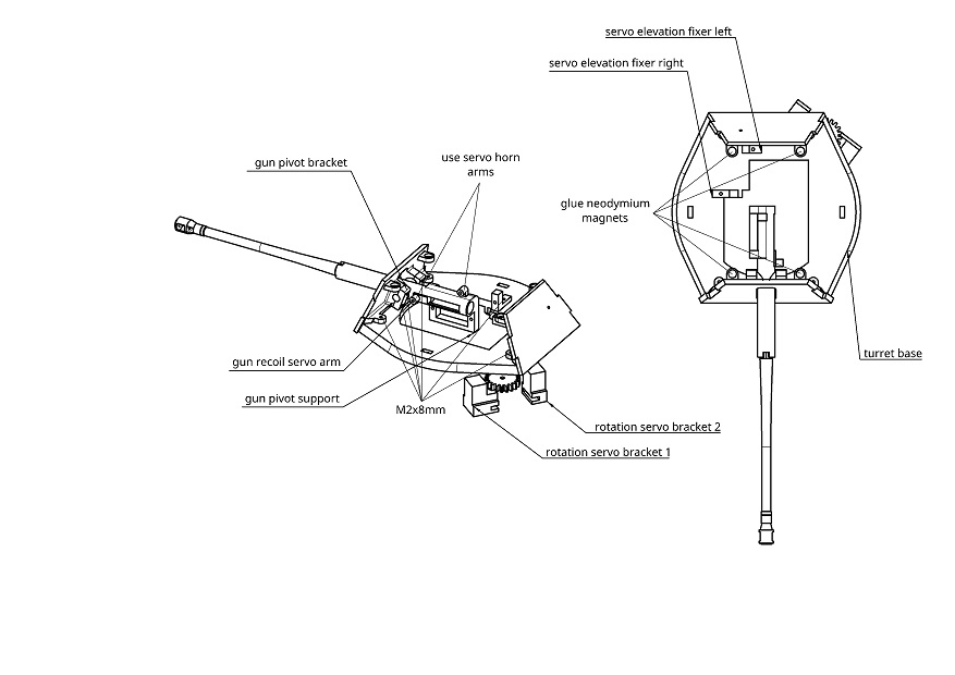

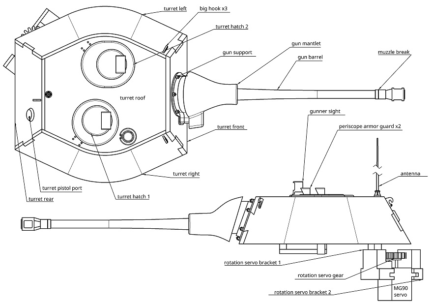

Hi guys,
I have released the turret files on printables: https://www.printables.com/es/model/245 ... 02-leopard
I also updated the assembly guide:
turret assembly 1.jpg (108.97 KiB) Viewed 3347 times
turret assembly 2.jpg (65.22 KiB) Viewed 3347 times
Enjoy printing 8)
