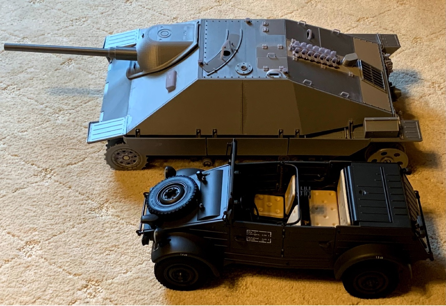

Probably an irresponsible purchase but......
Makes you realize how small the Hetzer really is.

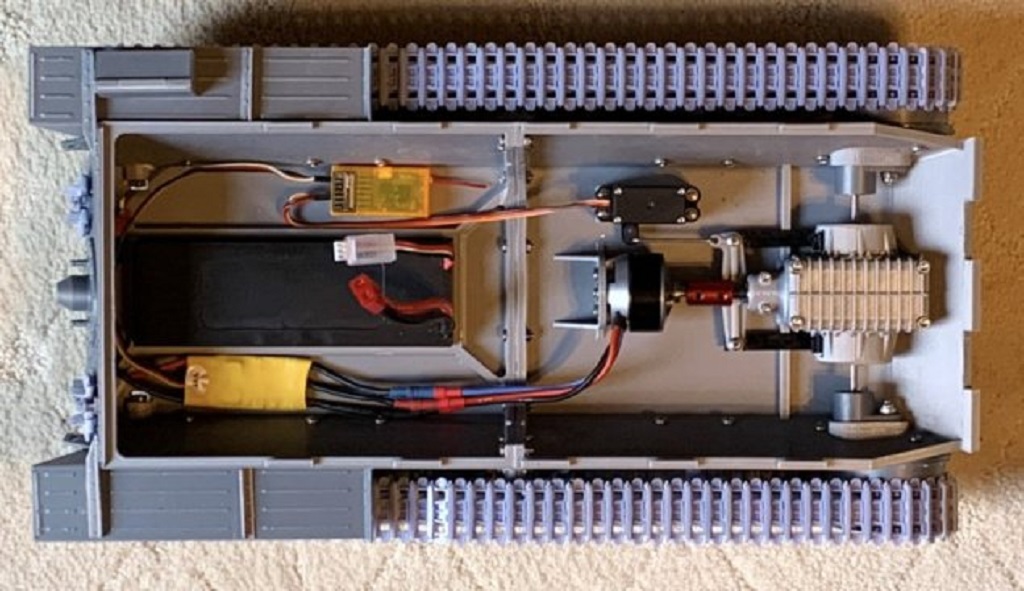

Well, after putting in some long hours Saturday doing final assembly, putting the drivetrain in and adding all the wheel covers etc. I'm VERY pleased to say that the 1/12th scale Hetzer runs and drives perfectly, using the full scale method of drive and with scale speed and plenty of power - much more power than my HL stuff despite being a single, small motor and a 2S lipo (5000mah). It powers over stuff without strain and will idle down to just a couple RPM while sounding practically like the real thing (due to the literally hundreds of moving parts and over 40 bearings no doubt). I didn't even have to reverse a servo or trim anything - worked first try. Its quite loud, and at full throttle it sounds like its going to blow up, just like the real thing would lol. While there are a bunch of little fiddly details to finish (running light, brake light, periscopes tools and mantle cover) that stuff is all easy - just time consuming, so I'm going to take a break a while and work on some of my non-AFV projects for a bit then will come back to this on and off for the details. I also need to find somebody locally to paint and weather as that's not my thing. Thanks for following along, and I'll be back now and then before I start on the Stug for the next one.

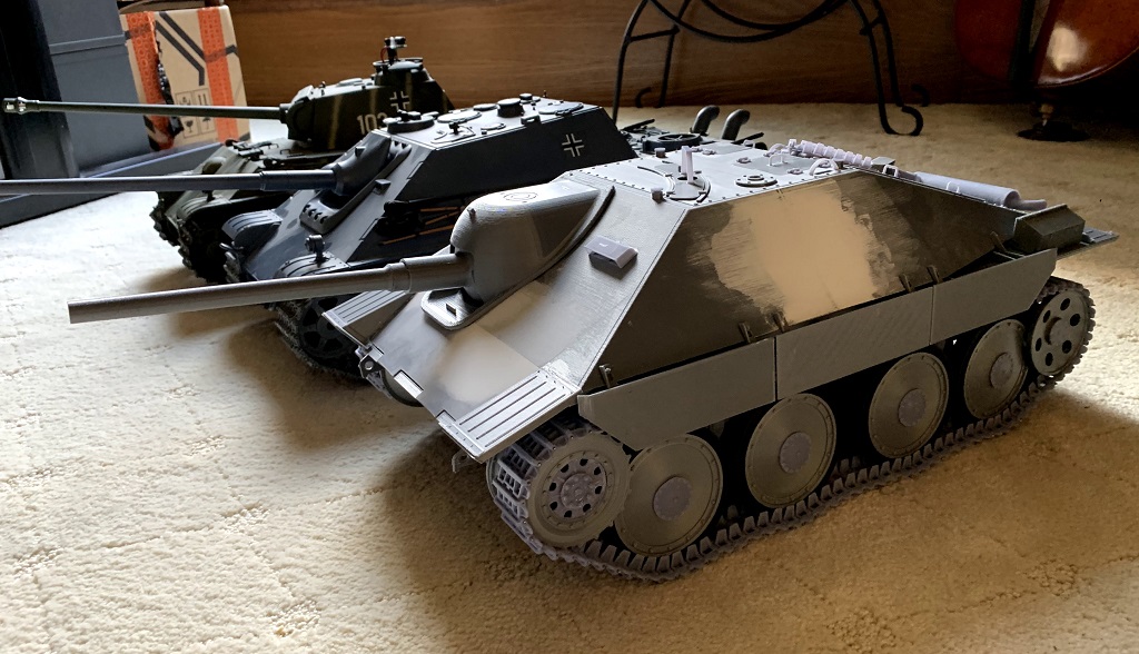

Next to my (modified) 1/16th Scale HL models. The Jagdpanther is set up for FPV driving too which is fun. Once I build those in 12th scale in the next couple years, I'll sell these off.

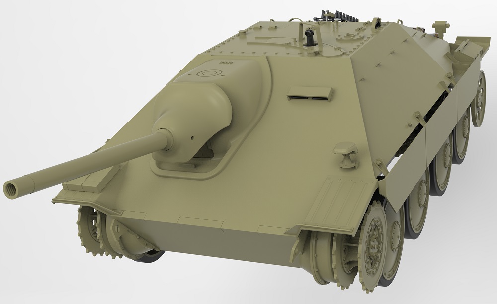

With not much else going on, I made lots of design updates and reprinted lots of parts over the holidays.
- Modeled the gun shield finally
- Modeled Notek light
- Modeled antenna mount
- Modeled forward vision blocks
- Modeled Jacking block
- Modeled main gun periscope
- Corrected various parts of the front fenders
- Corrected the side and rear periscopes to scale
- Corrected "handing" of the Schurtzen hangers
- Corrected exhaust exit shroud mounting
- Corrected air intake fan grille vane direction
- Corrected driver vision ports
- Minor functional adjustments to final drive internals and mounting
- Minor corrections to roof penetrations and hatch closure flanges
- Minor tweaks to the rear convoy light
- Superstructure and roof revisions
- Updated bogeys, implementing the slight differences between front and rear in the spring pack and spring holder
* and many other little detail corrections

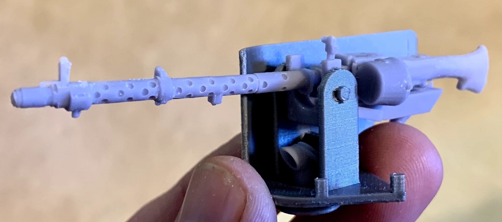

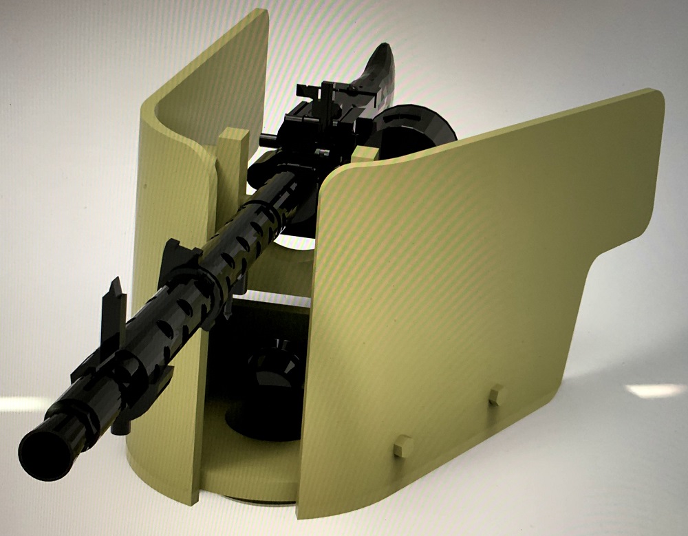

Printed (FDM and SLA) the MG mount. the gun mount is as full scale and rotates and pivots as you'd expect. I took this pic without the left shield to show the details, including the little periscope peeking out at the bottom. Today was the last day of my winter break, so back to work tomorrow!
