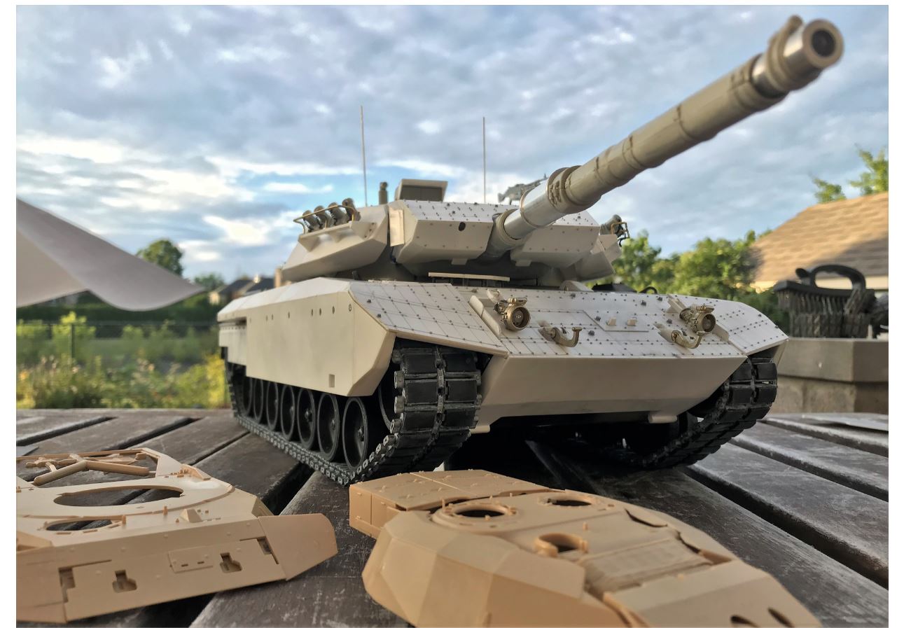

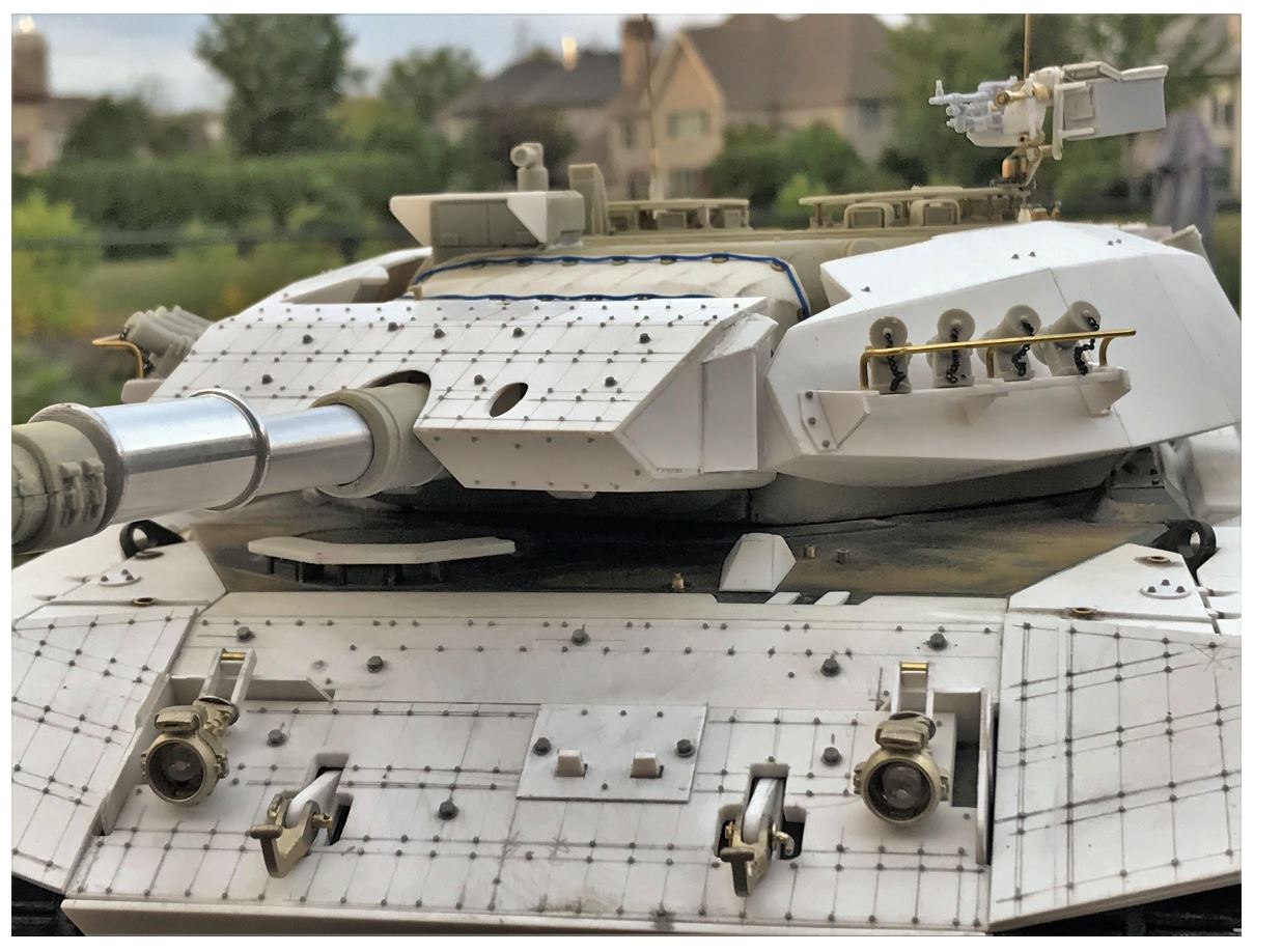

The construction is pretty much finished. I will do a final walk around to ensure nothing important or visible is missing.

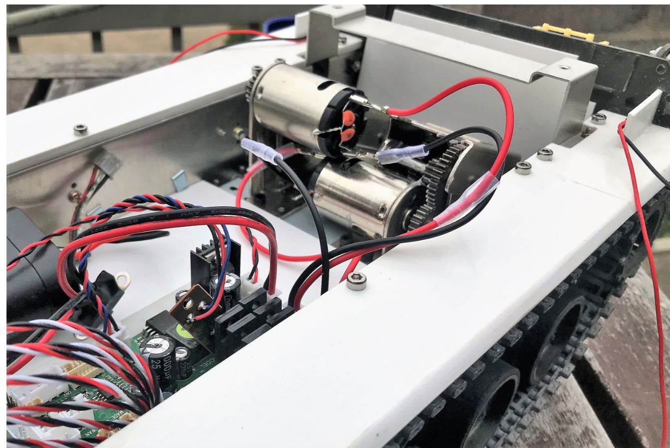

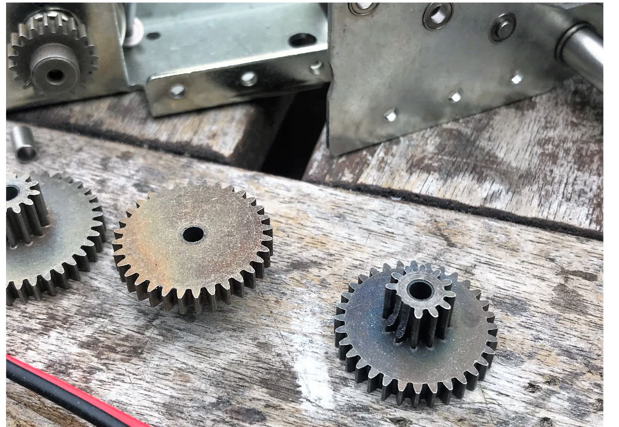

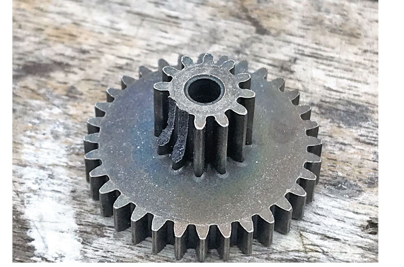

And highlighting my negligence of leaving a small loose metal screw inside the hull during the build, one of the gearbox suffered a major failure when the screw got between the gears, resulting in a wasted 40$ Mato gearbox. The gearbox was repaired from cannibalizing a spare one on inventory. The good thing about Mato gearbox is that they are easily taken apart for modifications and repair, and the gears are pretty standard from one model to another.

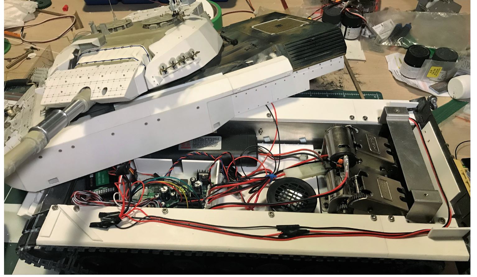

View of the interior electronic. Its quite roomy. I put in the electronics that i am familiar with and that i can get functional with little work: Clark TK60 board, Flysky 10 channel receiver, Heng Long speaker and Mato gearbox.

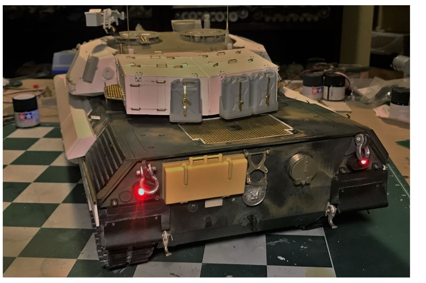

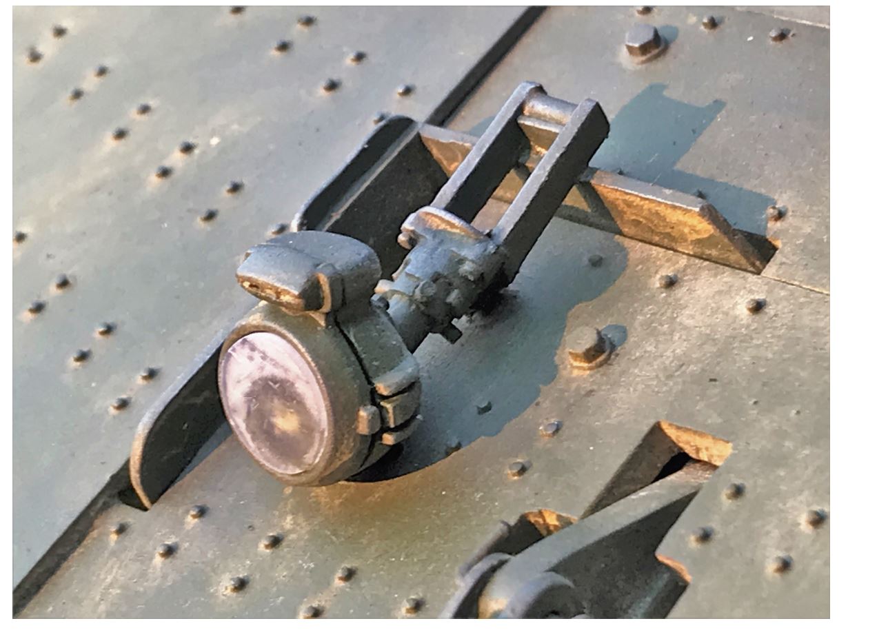

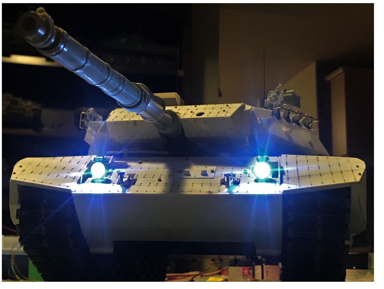

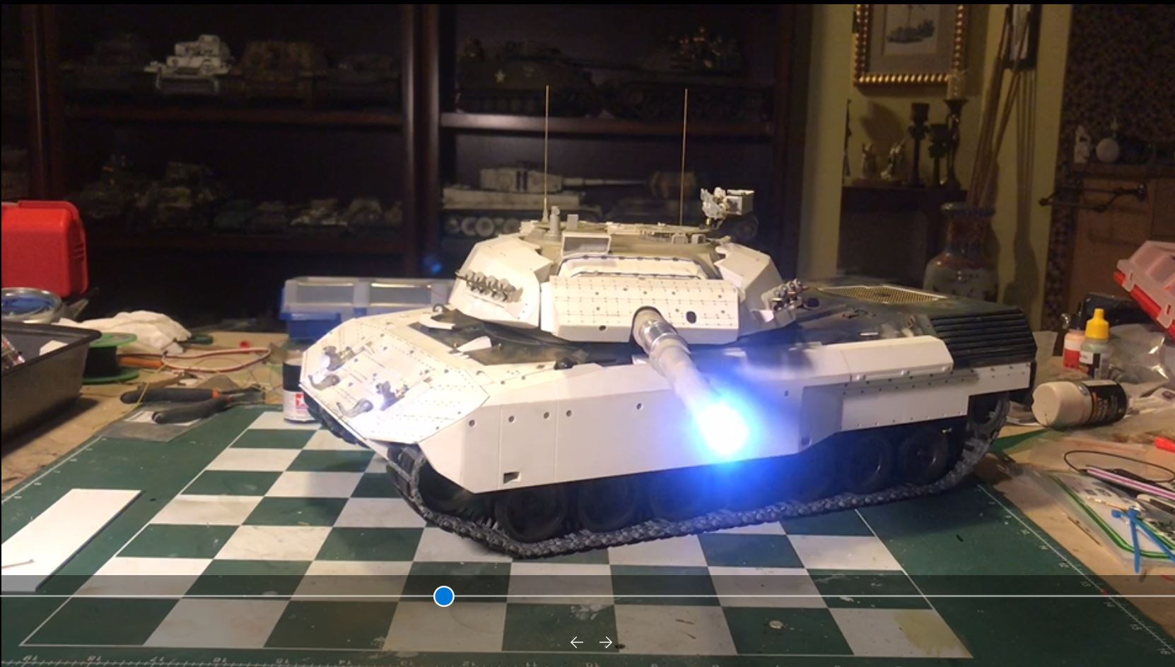

Headlights and tail lights were made functional.

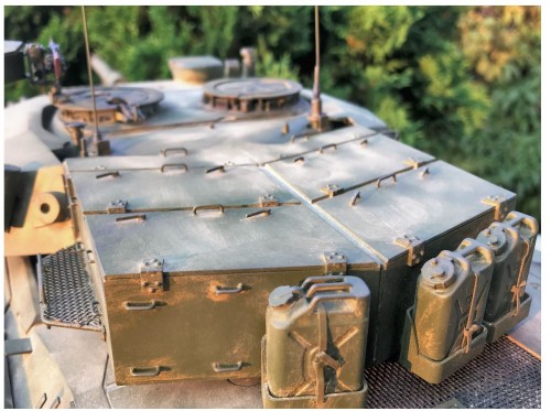

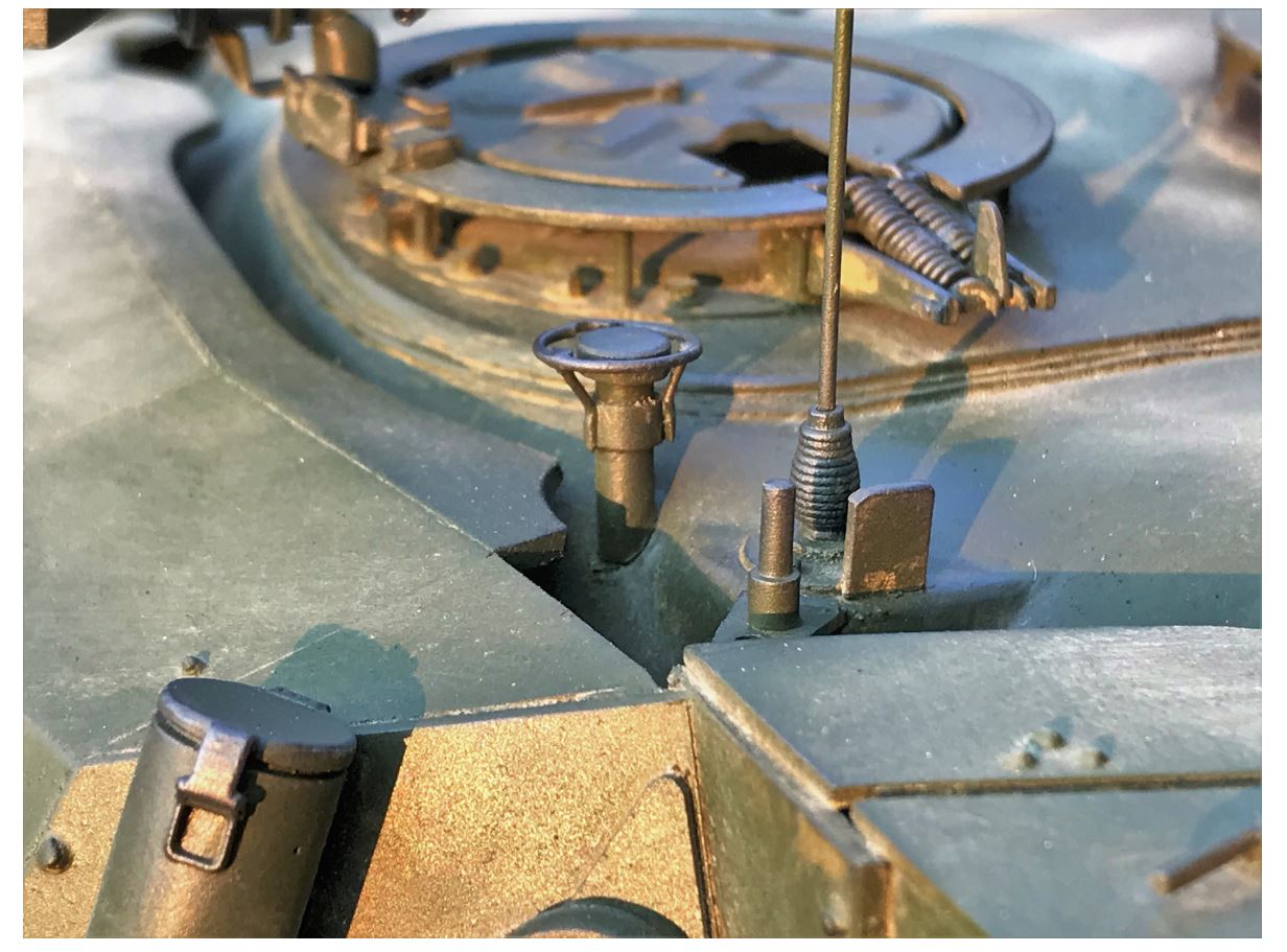

As seen in the book Leopard C2 Mexas in Afghanistan, the Leopard were usually covered with layers of dust, in some cases, thick as cake. Representing such weathering, although accurate, does not necessarily look good and might not be the best for an RC tank. My idea is to keep the dust application light. I did not create and detailed this beast for 45 days to drown it in mud.
RC 1/16 Canadian tank Leopard C2 Mexas - Afghanistan - build
Canadian Leopard markings in 1/16 scale are also non-existant,

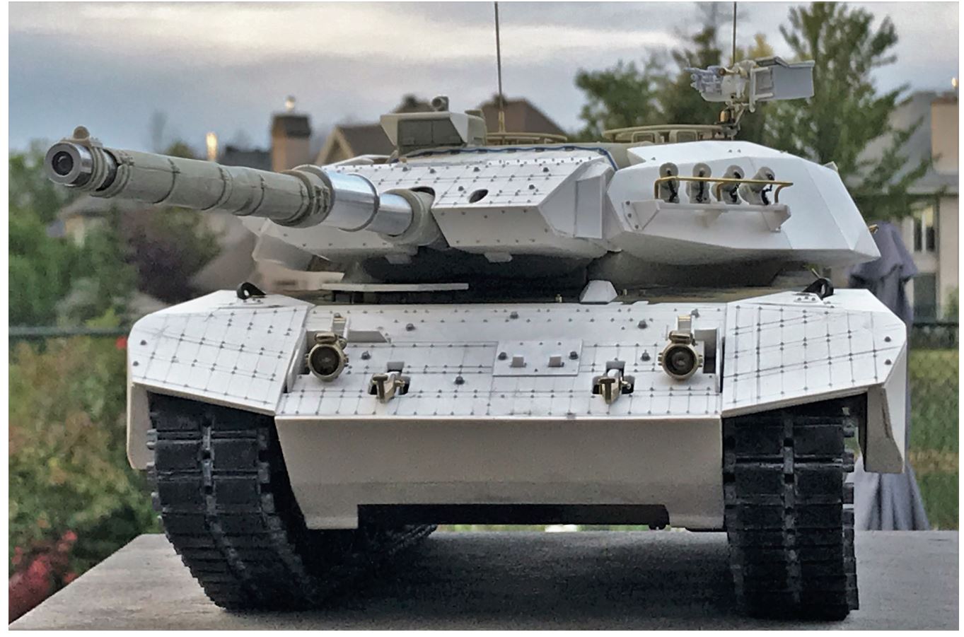

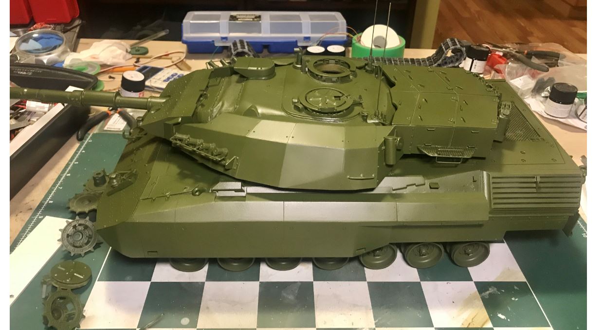

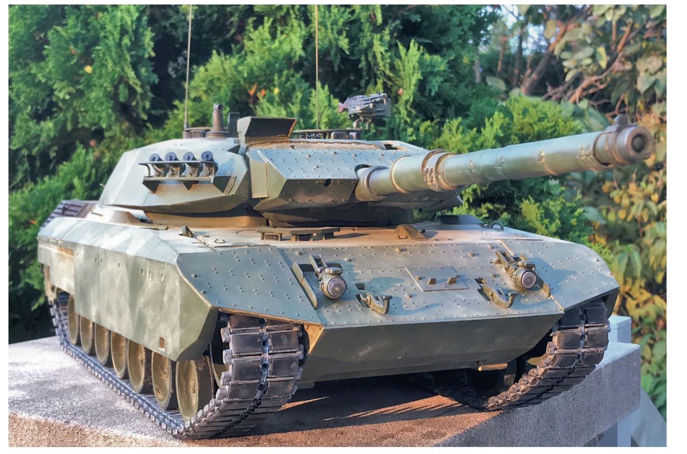

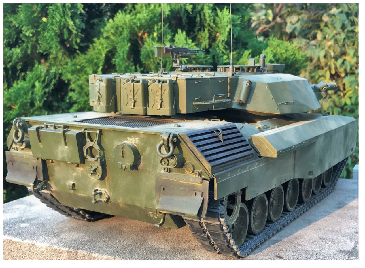

Here, after application of a primer, the tank is applied with a coat of Nato Green. It does not really matter to have the exact color and tone, the dust pigments applied later will blend in and change it all.

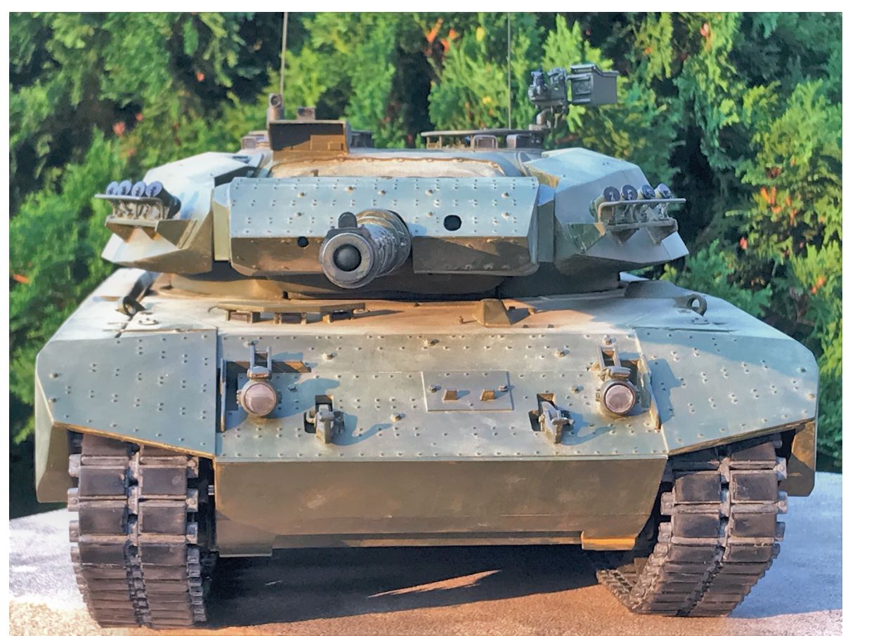

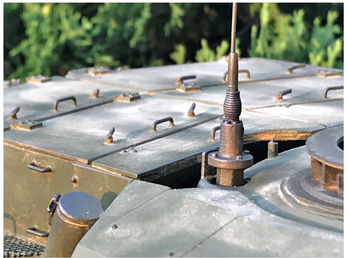

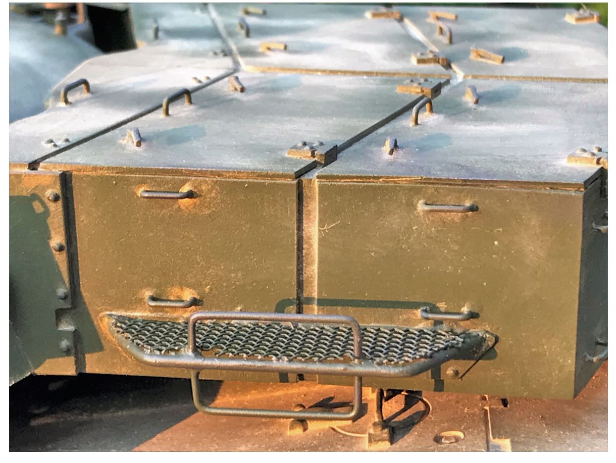

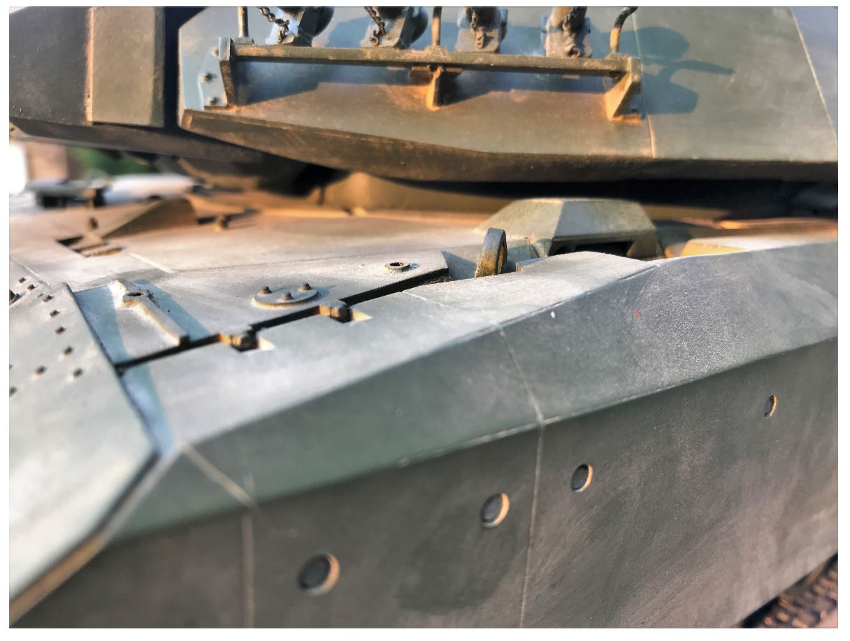

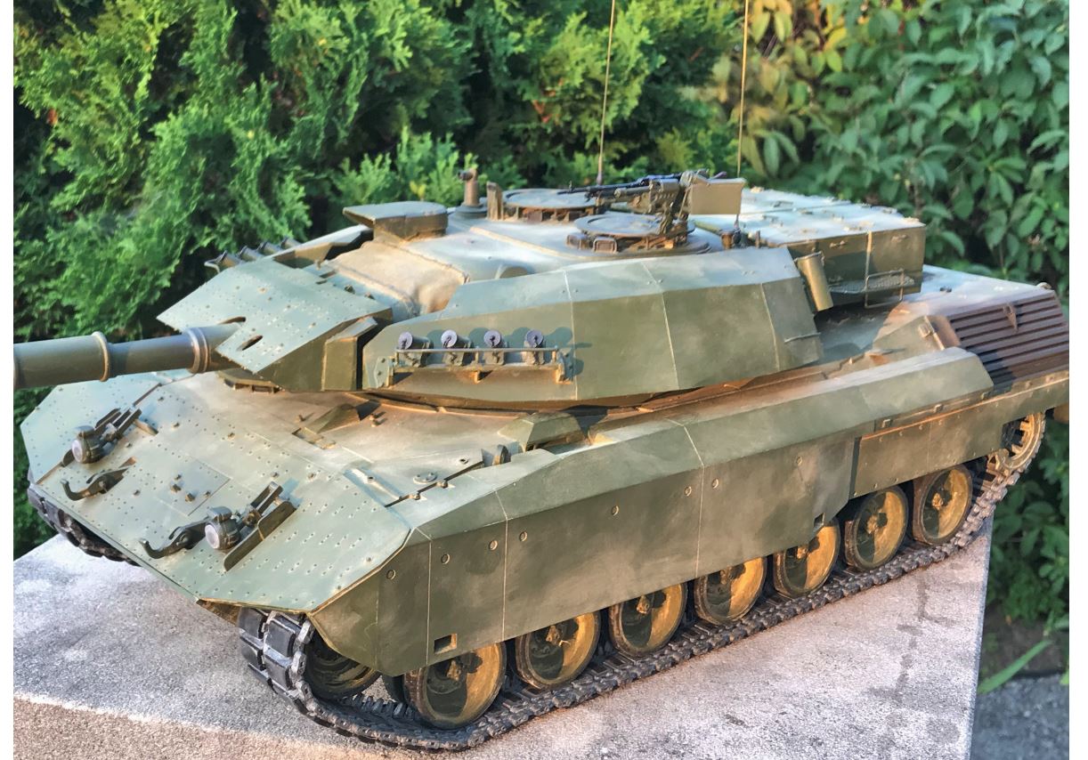

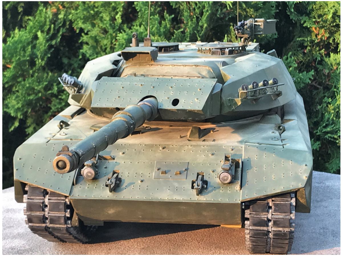

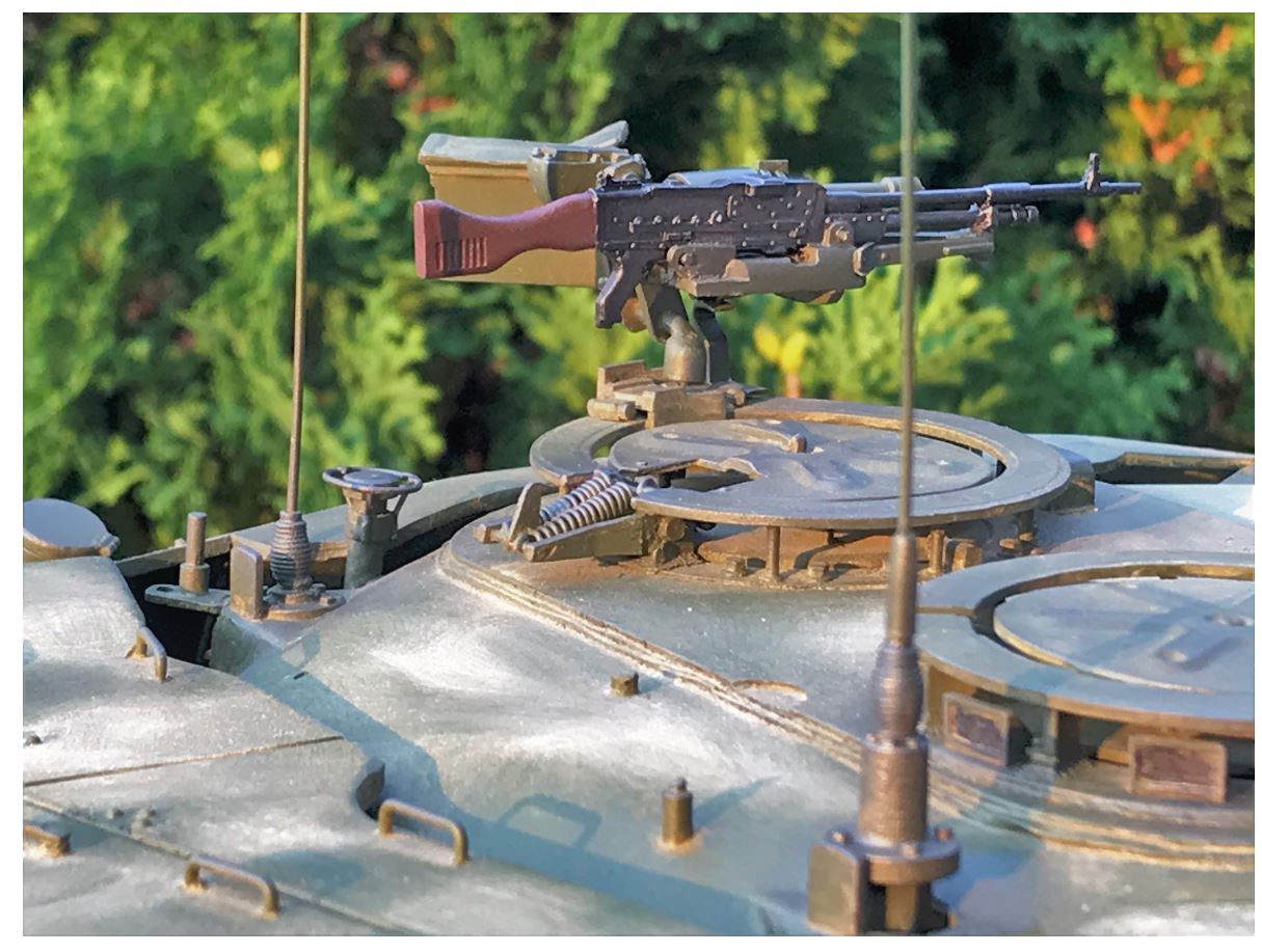

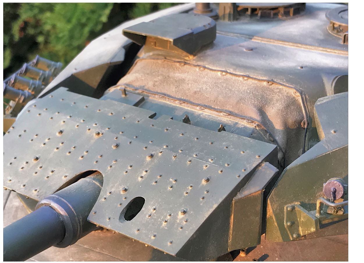

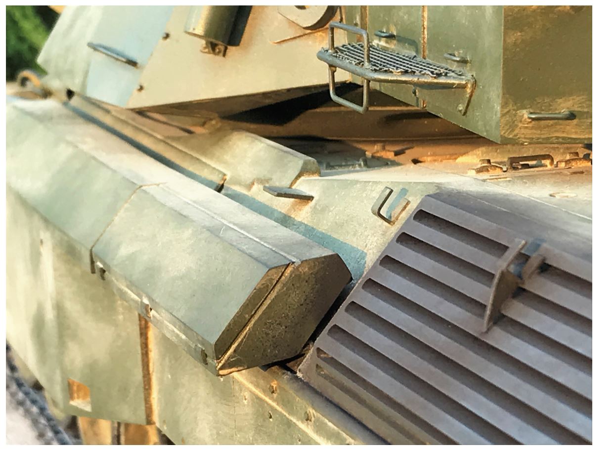

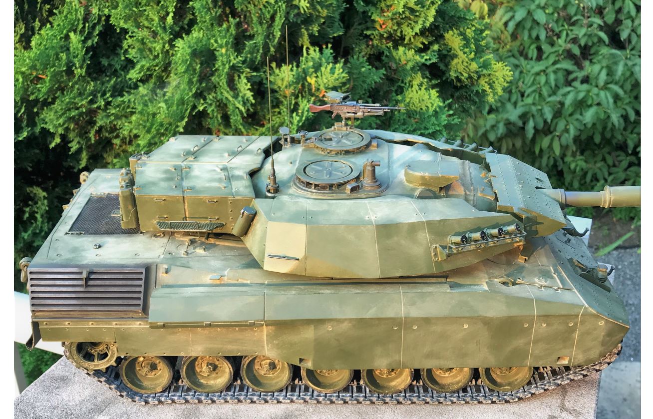

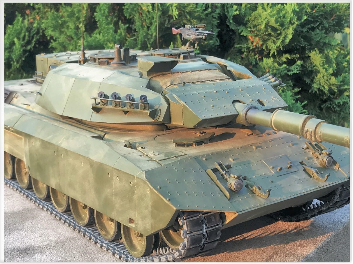

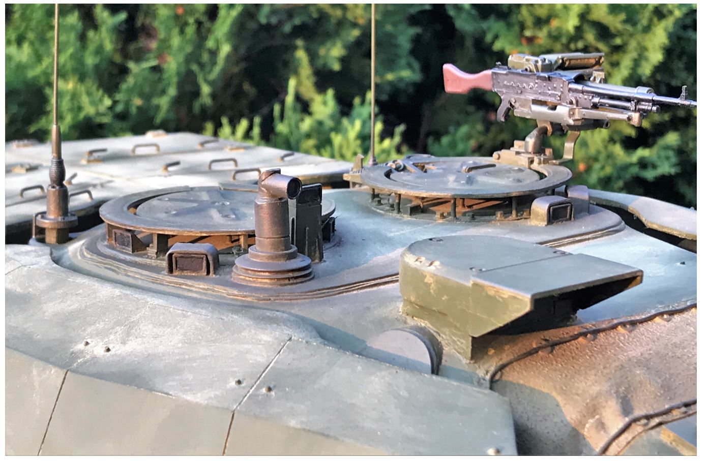

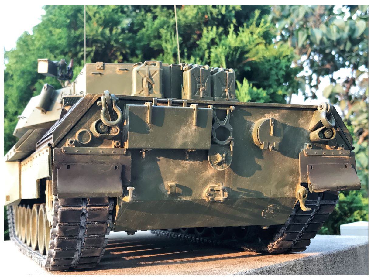

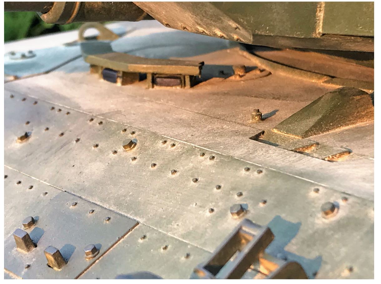

African dust pigments were applied freely over the vehicle with a thick brush, like if it was going through a sand storm, (a 20 minute operation really), pressing the stuff against the green paint, making sure the dust pigments goes into every possible crack. Then a coat of pigment fixer was sprayed directly over the tank with the airbrush. That's it. This is what it gives. Here is an exterior photoshoot for checking the results. Some small improvements are still required but its almost finished. The tracks are also not yet weathered.
