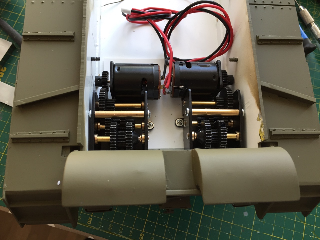

Von Mooflesaaa wrote:Gearboxes have been mounted. Now figuring out how to attach the upper hull. I'm thinking pixies, fairy's and strong earth magnets. Image

There's not a lot of real estate inside a PZ IV at the best of times. :think: One problem fitting gearboxes like the ones you've installed, is that the terminals of the two motors are perilously close together.
What I've done, in the past, is to unscrew the mounting screws on one motor; rotate the motor through 90 deg, where there's usually another set of mounting holes, and then refit the motor in the new position. That way, there's no danger of the terminals getting shorted out. Now that you've moved on to another stage, perhaps you won't want to revisit the installation- but it's as well to be aware of the potential problem.
I had the same issue on my Cromwell and Comet builds, where the terminals would have actually touched unless I'd bent them, or relocated them with a 90 deg twist as I did here:
