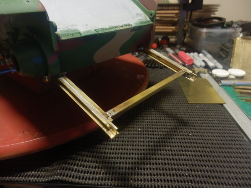

I'm getting the lower blade mounting arms done now and hope to get my drill & screw on over the weekend.

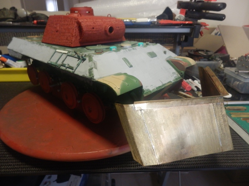

The blade is on 8)
Well, at least to the lower mounts it is.
Took a bit of manipulation to get the final angles & heights right, but once I had the right look, it was marked and solder paste appled in the required spots.
Clamped the blade back onto the mounts & hit the areas with the butane burner.
Solder paste took immediately & seems to be very firm.
The top mounts I made need to be trimmed shorter slightly, so a bit to do there yet.
The lower mounts were secured to the final drive housings by drilling clean through the plastic and bolting with an M3 hex head bolt and a nylock nut on the other side.
The drive sprockets will cover the heads of the bolts & will not be noticeable.
Once this blade is all mounted & done, its going to move quickly I hope !
