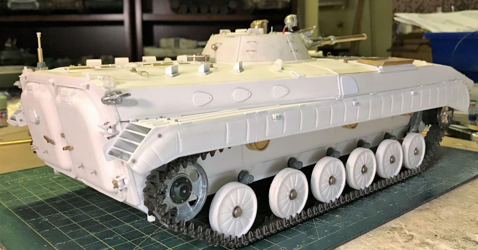

Continuing with the BMP-1 build after a good winter vacation.

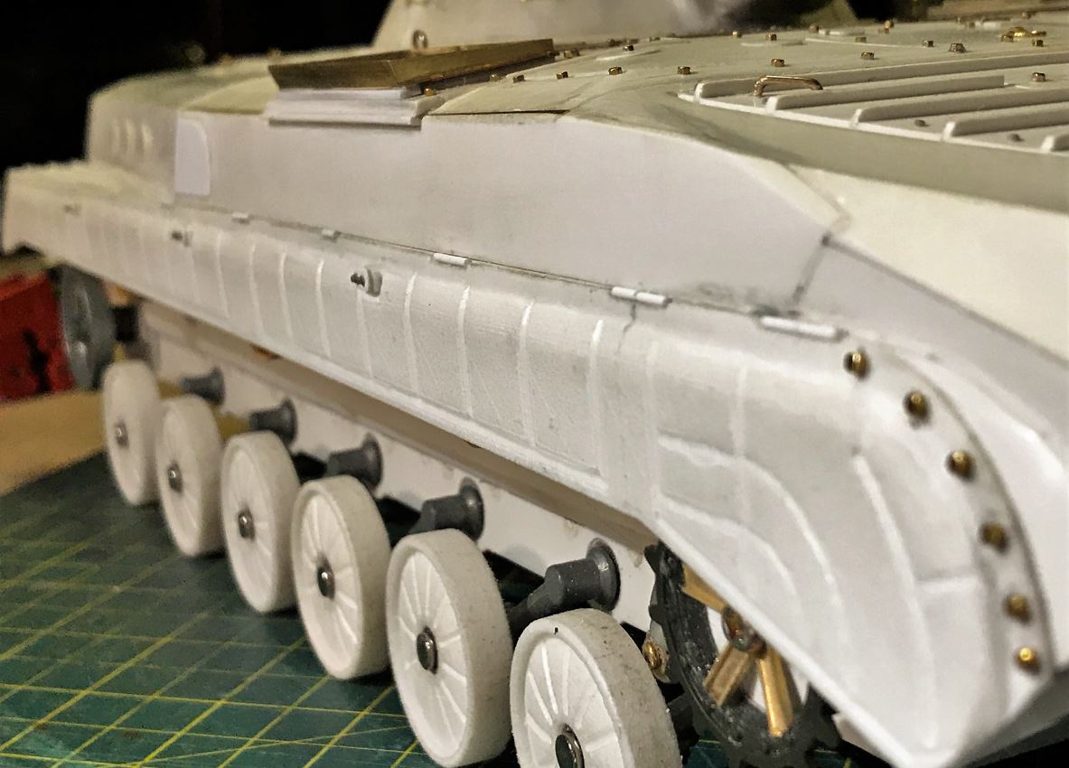

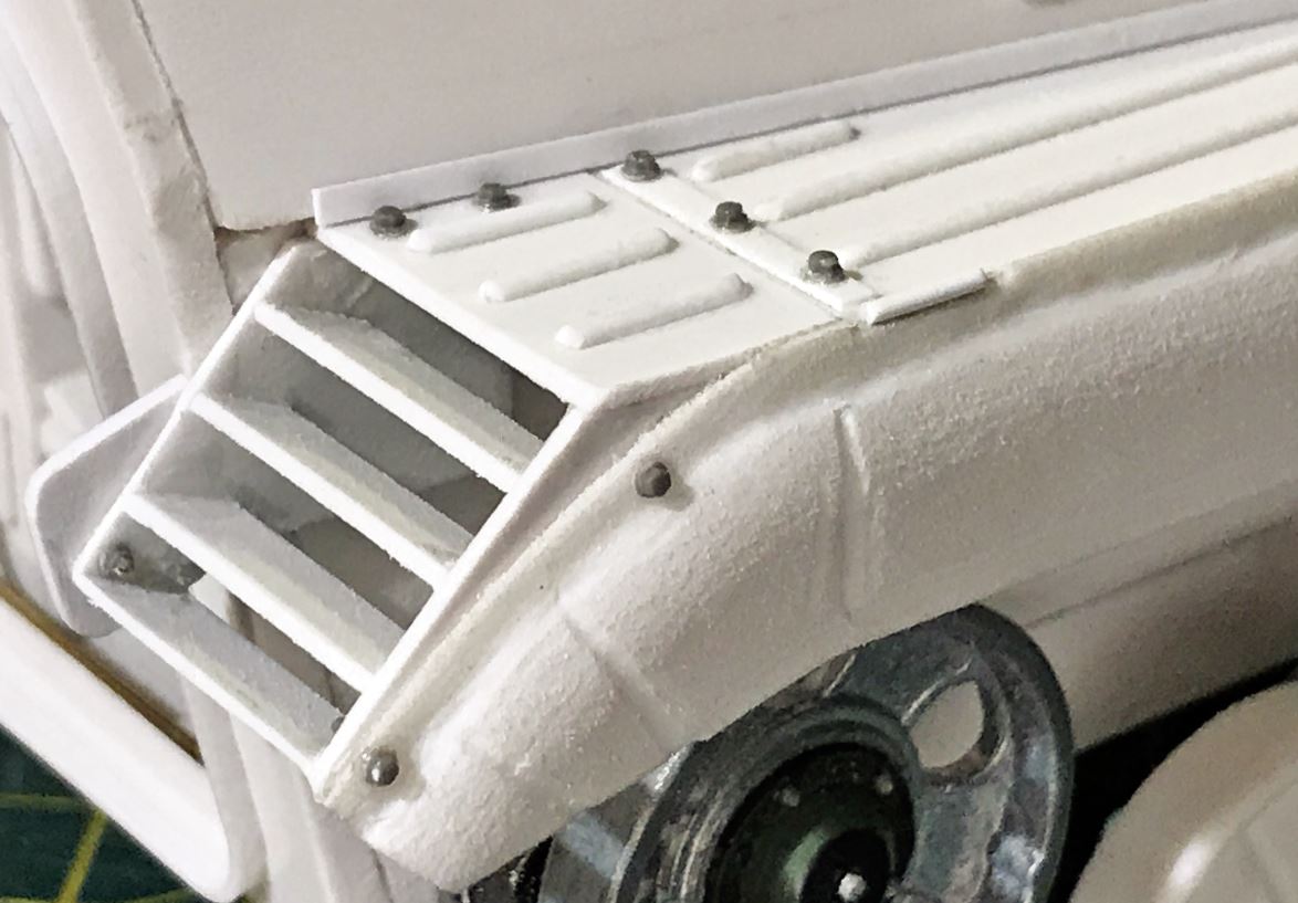

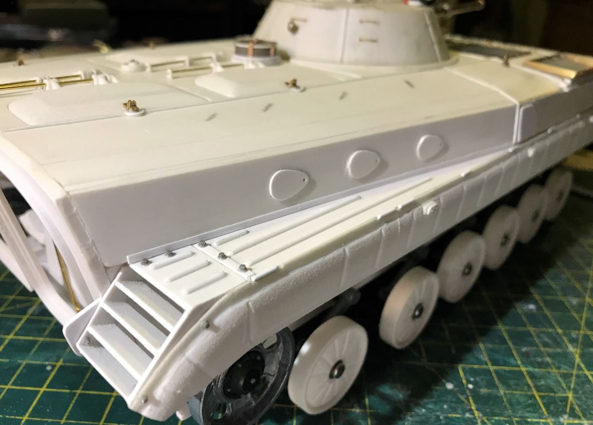

The fenders at the back of the vehicle need to be completely scratch built from photograph and reference analysis. It is simple though.
Ludwig had 2 trench like grooves made along the fenders, I assume they were meant to somewhat represent the embossed stiffeners at the back. I earlier decided to flip the fender parts so that the grooves are hidden underneath. The highly visible and desirable embossed stiffeners were instead rapidly made with 1.5mm half rods.
Th side skirts were not made to be raised with hinges. They were glued to the fenders attached to the lower hull instead, except under the brass bolts which has the upper hull under them. In order to lift the upper hull, the bolts on the front side skirts need to be unscrewed. Opening the hull will be rare because the cover at the front of the vehicle can be removed to give access to the electronics, battery and gearbox compartments for simple maintenance.

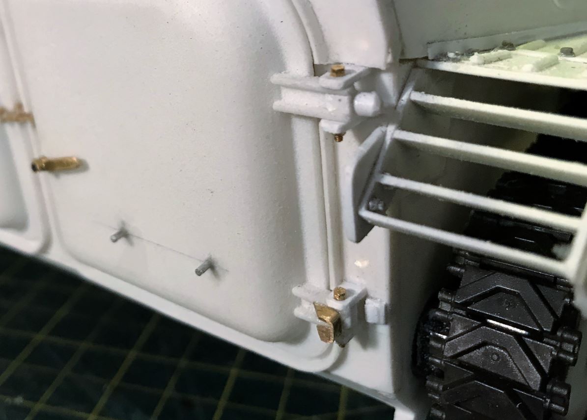

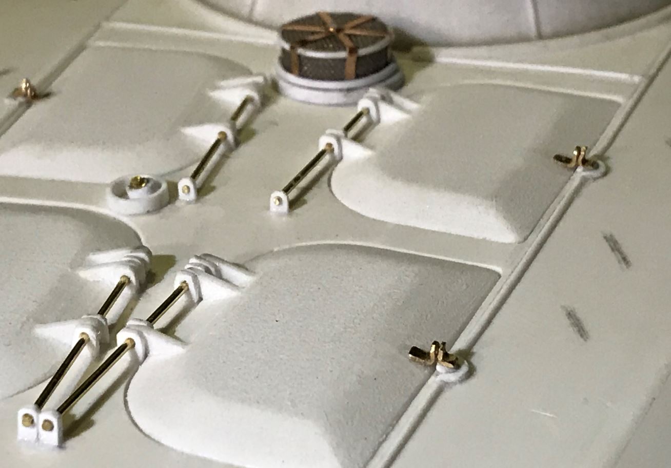

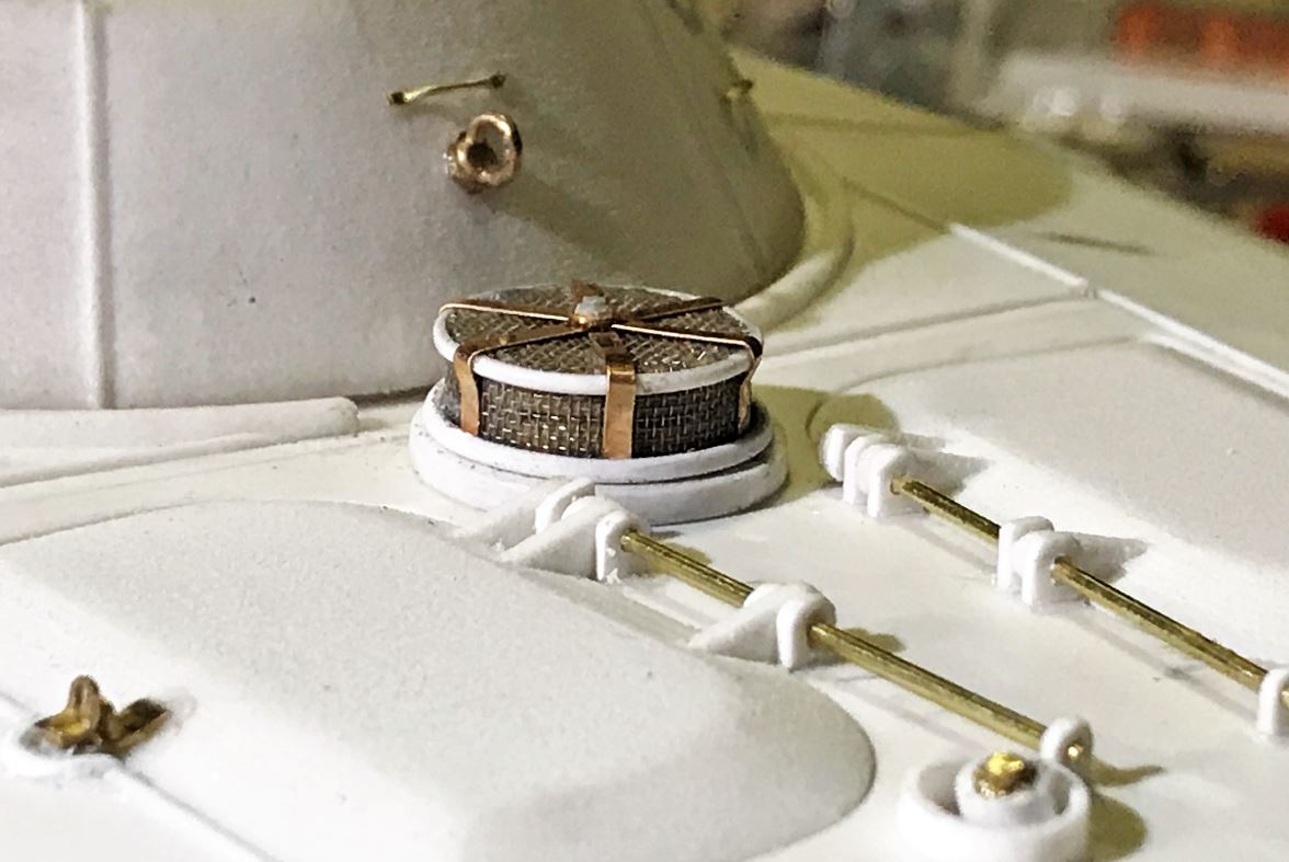

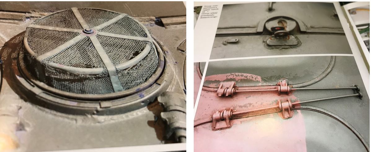

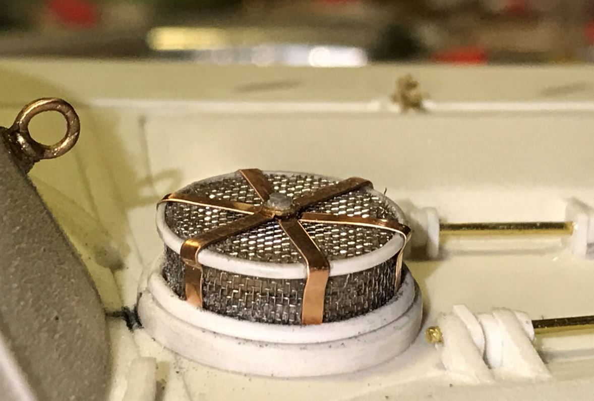

View of the BMP rear compartment air vent and rear hatches hinges that need to be reproduced from scratch.
The air vent.

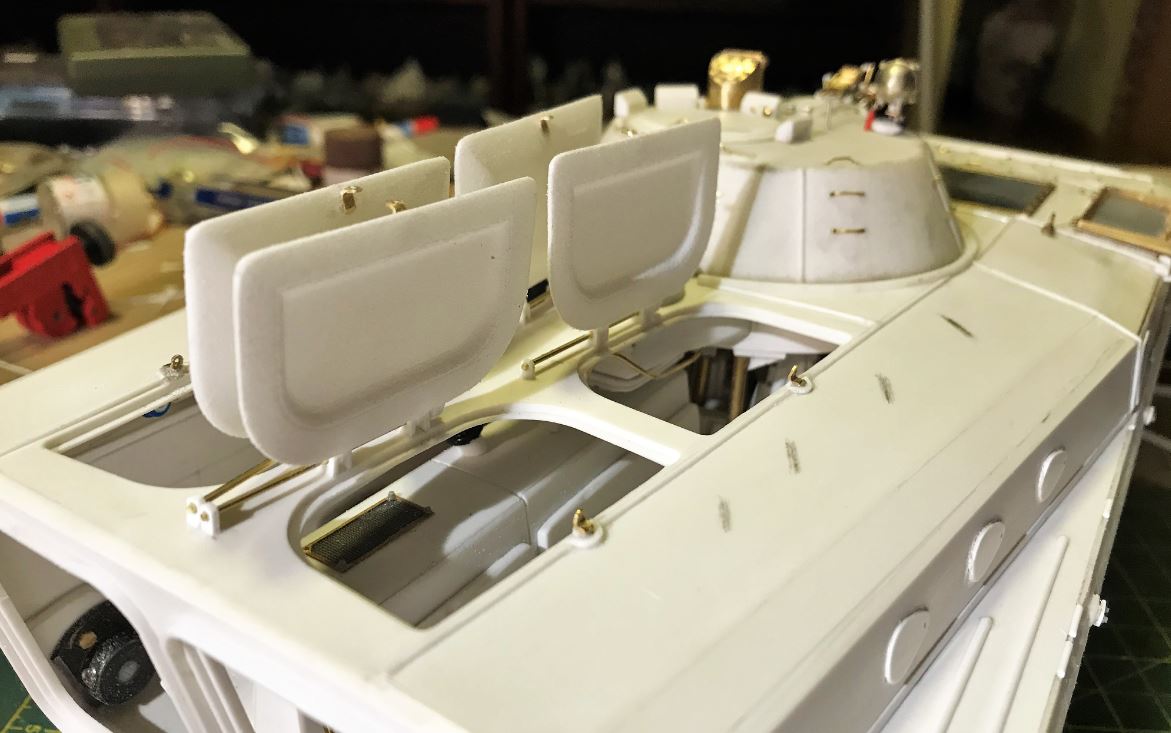

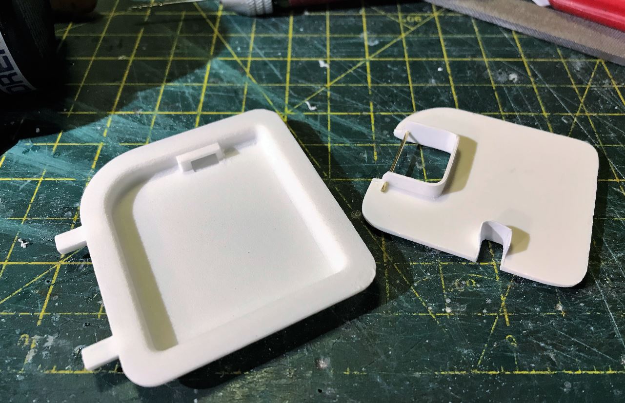

The 3D printed rear hatches are good but need preparation and sanding to fit. Sadly, no hinges were provided so it takes a while to repro them with some resemblance to the real thing.

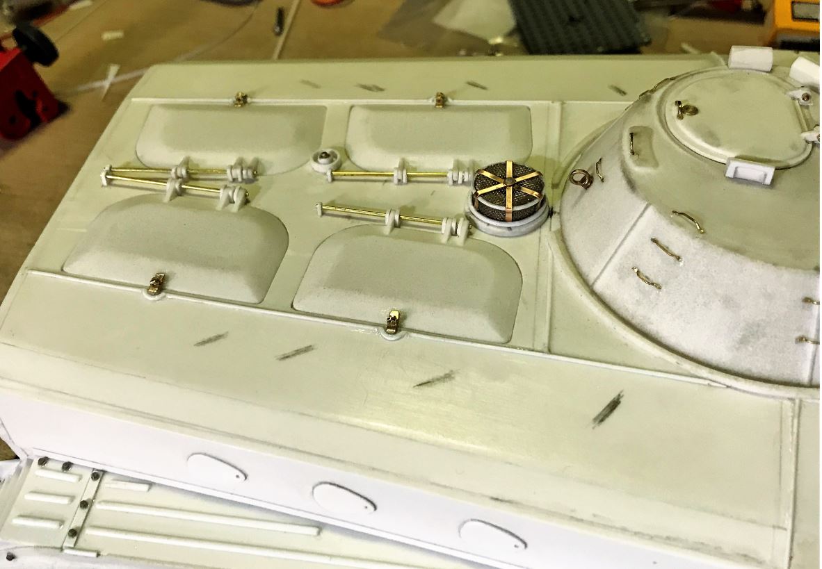

The locks for the hatches and the fuel cap were created.
Of course, the hatches were made functional.

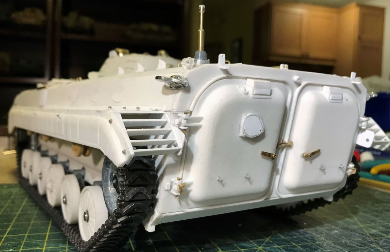

Next step is to install the periscopes and the many little brackets and small items on the hull, then work on the rear doors.

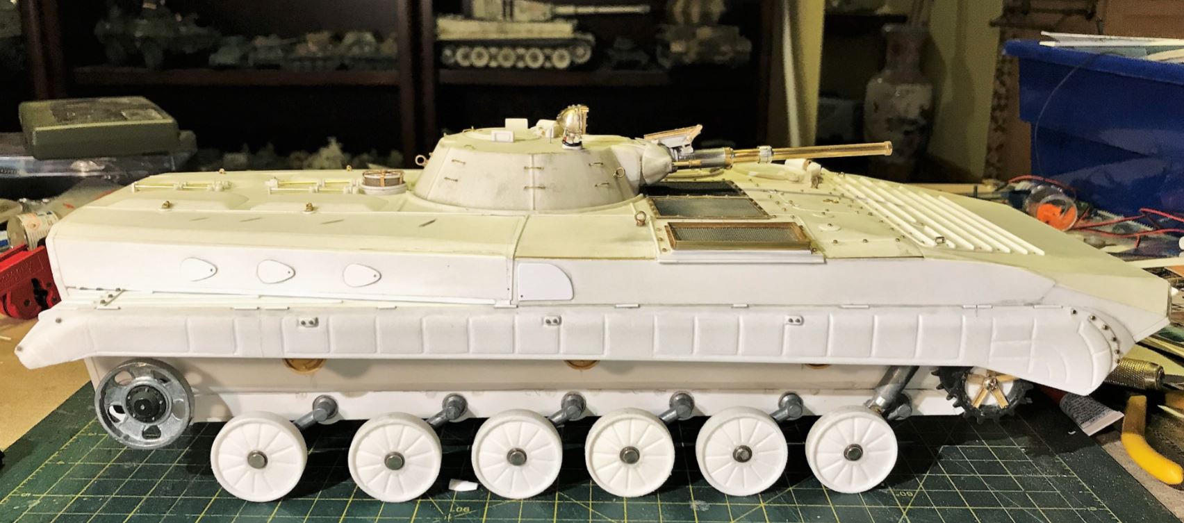

Overall view of the vehicle as it stands today.
The air vent.

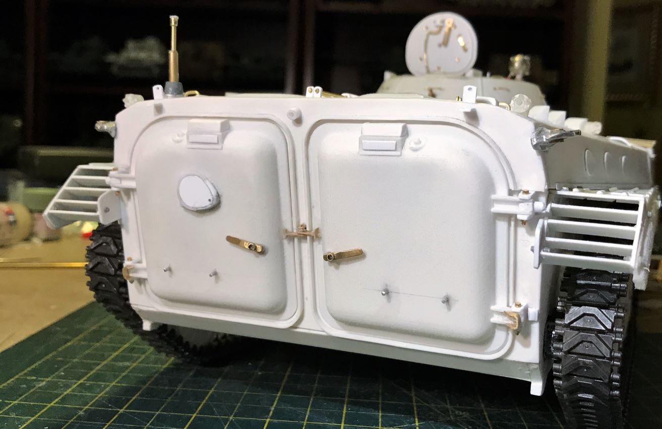

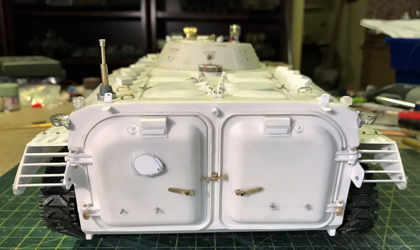

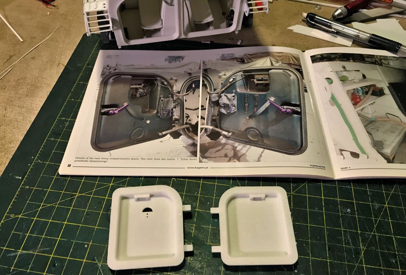

Hi, presenting the back of the BMP.

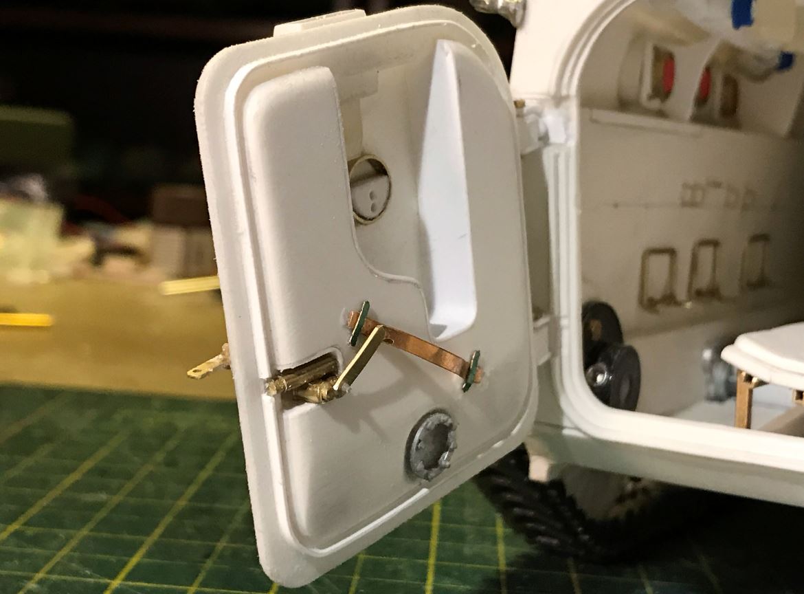

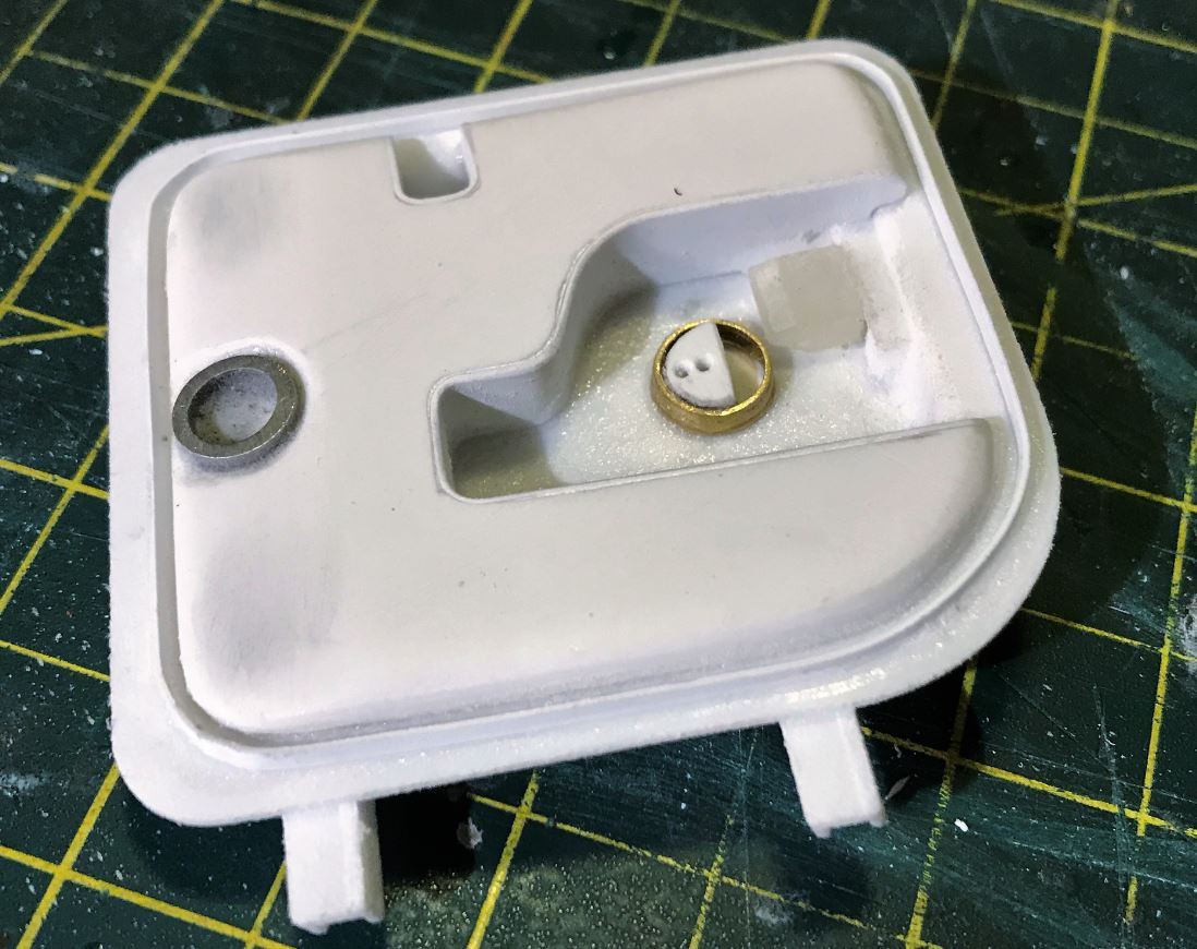

The 3D printed exterior shell of the back doors are the only items available to the builder. Everything else needing scratch building. On the real vehicle, the inside of the rear door contain auxiliary fuel tanks for the engine. They must be quite heavy to operate and likely dangerous in combat. The infantry is already sitting on a massive fuel tank in the middle of the crew compartment, and they have fuel cells on their escape hatches as well.
First task was to prepare the fuel tanks.
And slowly build up the door with the items seen in reference.
Overall view of the vehicle with rear doors installed.

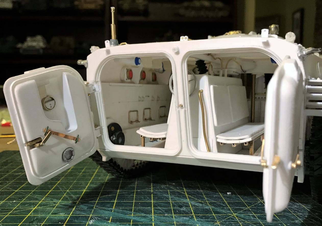

Notice the gun port on the left door. It's shape needed to be corrected.
It is left to the builder to ponder his options and design the complicated hinges mechanism. I referred to pictures and did something as close as I could to the real thing.
As you can guess, it was not easy.
Builders that are not recreating the inside of the vehicle will be tempted to simply glue to doors in place and forget about the hinges. But I do have an interior to worry about and the construction of realistic doors is adding a lot to the model presentation. The flexible tubing for the fuel tanks will be added after painting.
The latch is non functional. There are limits...
