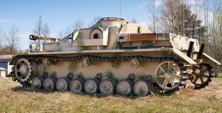

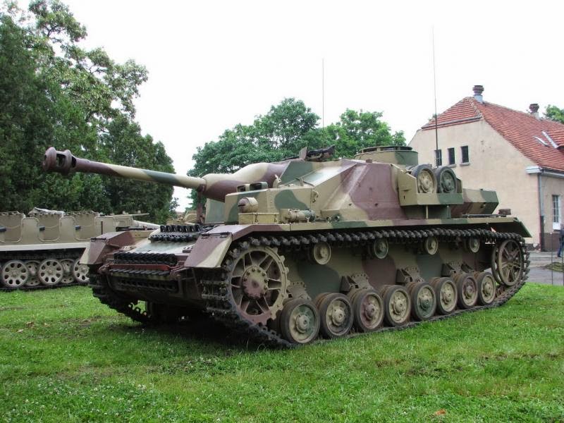

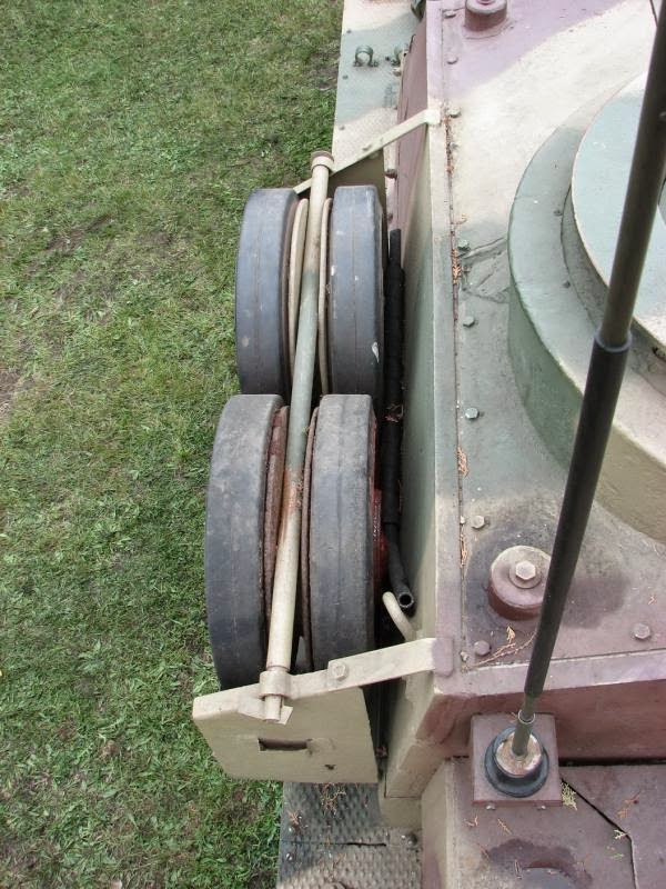

I find it interesting that the spare wheel box on the Stug IV was installed vertically, although the obvious choice would be to fit it directly against the casemate side. But then it would be angled.. :eh: Can't think why it should be vertical, but it is. Maybe it was something as simple as allowing rain to run off the casemate side :eh: Here's another example:
Stug IV- with vertically mounted spare wheel box.
StuG IV- based on Ausf J..jpg (89.58 KiB) Viewed 2766 times
This model's interesting because it was based on the Ausf J model I'm building; but it's clearly a fairly late model, as it only has three return rollers... Talk about- penny pinching, eh? Perhaps that should have been pfennig pinching. :D
Why am I bothering with the orientation of this particular fitting? Well, I'm just about to fit it to the StuG IV, and want to get it positioned in an authentic manner.

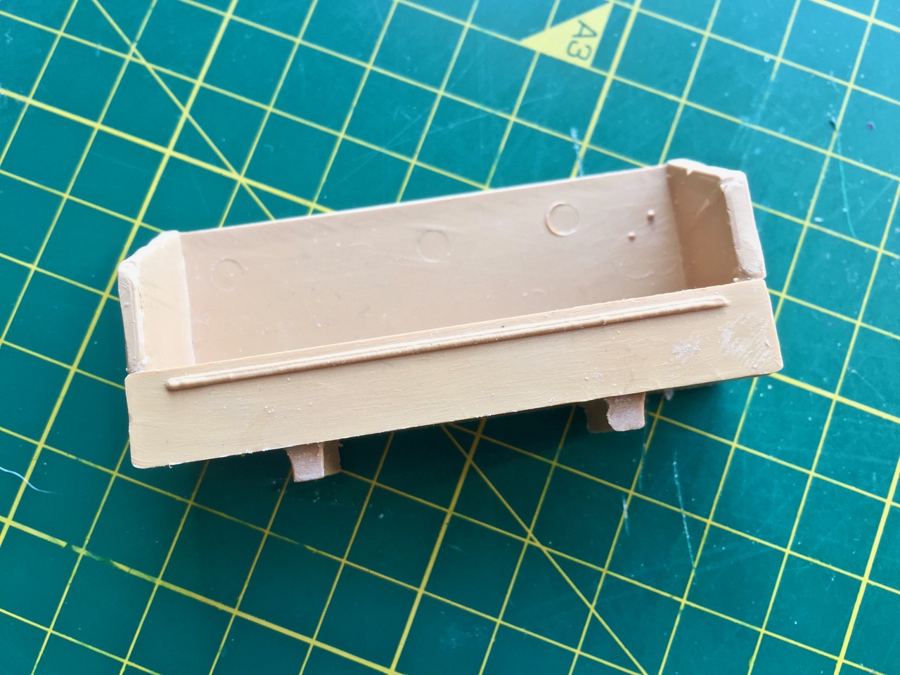

Here's the Asiatam version of the box. I've already bonded the transverse retaining panel to it. As you can see, it's a fairly crude affair; but serves as the basis for an expert in tarting tanks up. I'm not one of those. :|
Asiatam StuG IV- Spare wheels container
But in order to fit this to the casemate side, I shall need to make some triangular fillets out of styrene... I'll also have to fabricate the two straps at the top.

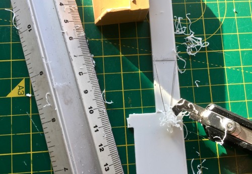

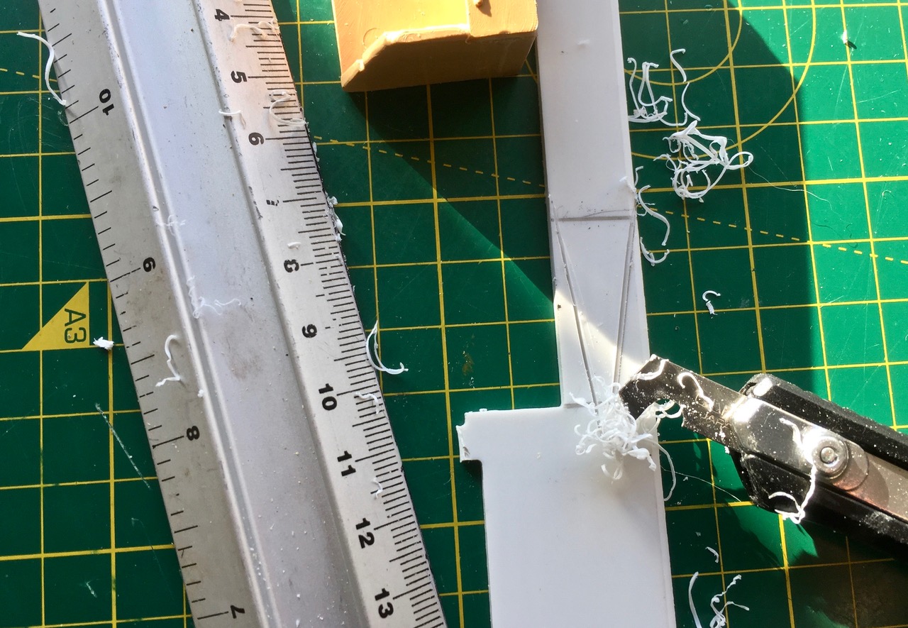

A Good principle in scratch building is never to throw away spare bits of sprue and used styrene. Here I'm using some of the 2.5mm sprue surround that came with my Cromwell kit. The castoffs from that kit are almost sufficient to build another model, and also come in a useful variety of gauges. :thumbup:

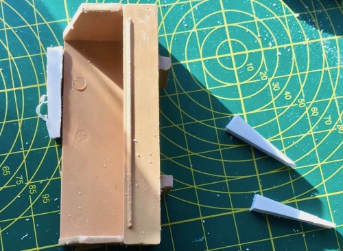

and here they are after I've excised them and sanded them to size. The base of the triangle needs to be 5mm in order for the box to stand vertically.

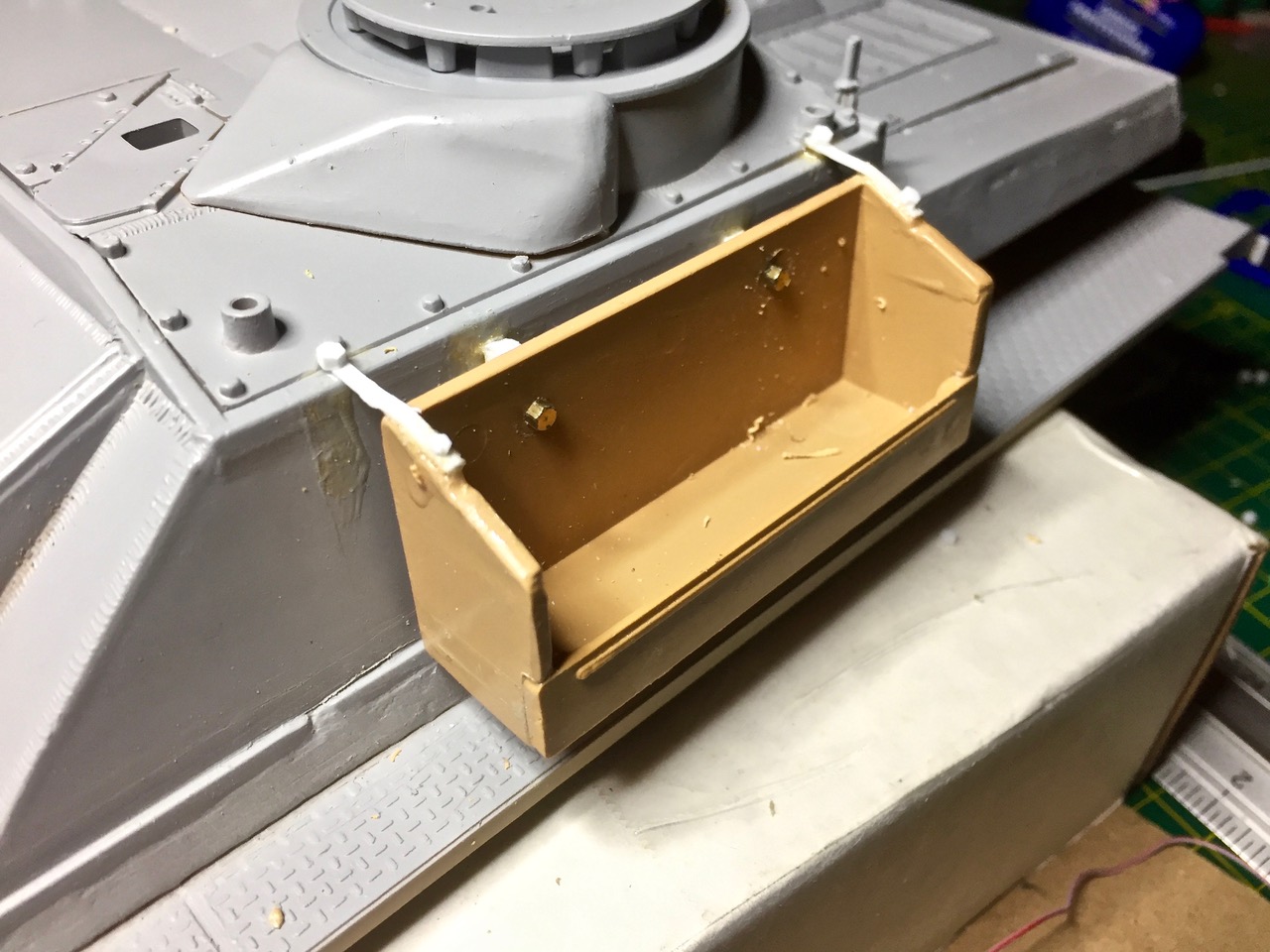

Right from the outset, I've had problems bonding the bits of this kit together. Time and again, parts that appeared to be adhering properly, fell off later. I started with cement, then ABS cement (with address pressure); then Plastic Fusion
two part epoxy. I've also used Loctite 401 (metal to plastic). All of these used with varying levels of success. Two part epoxy worked the best binging the Casemate to the hull: the two largest (and structural) parts in the kit, and the ones therefore needing the firmest bond. :/
Re: Asiatam StuG IV conversion kit...
Finally, after the top straps sprang off, and with the box began sliding laconically down the casemate side (this- after thorough sanding and preparation.. >:< ), I had to get the pin vice out, and drill holes for mini bolts.
Here's an update.
As you can see, I finally cursed and cut the casemate roof sufficiently to allow it's mis-shapen bulk to fit in place. :lolno: I will have to sand all the glue splurges off later, when everything has dried; but, for the moment, the box is in place. It still needs two feet, where the box floor connects with the fenders.. :yawn:
:haha:
This assault gun was very nearly assaulted during todays travails... :lolno:
It will also take a lot of subtle filling, and sanding, before it ever sees a topcoat of paint.
Asiatam StuG IV spare wheels contained mounted..
