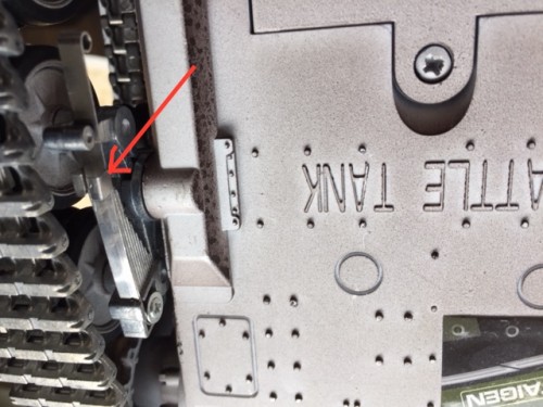

Below, indicated by the red arrow, is the dread retaining clip Taigen, Asiatam (and presumably) HL use to keep the spring 'Leaf' assembly in place. Here we are looking at the plastic floor of my Taigen Winter ed. Pz IV. When it arrived, clips were missing, and two were adrift...and that's before I even started it up for its maiden clank. :-<
Sometimes these even fall apart in hand, when one is attempting to rectify the problem. They're very flimsy. Should you happen to chose this metal assembly, for your build, make sure the swear-box is near at hand :lolno: :thumbup:
Even superglueing them to the leaf unit doesn't guarantee that it won't fall apart the moment that stress is put upon it:
Taigen/Asiatam Spring Lead retaining clip..
Long term, the only workable solution would be to use square profile pipe tubing (nylon for strength, perhaps), or even PE, as an alternative fitting. Even twisted wire would probably work, although it might look a tad incongruous.

43rdRecceReg wrote:Sometimes these even fall apart in hand, when one is attempting to rectify the problem. They're very flimsy. Should you happen to chose this metal assembly, for your build, make sure the swear-box is near at hand :lolno: :thumbup:
How does the leaf fit into the bogie assembly? I'm wondering if it'd be possible to modify the inserted end of the leaf with a short right-angle bend to hold it in situ.

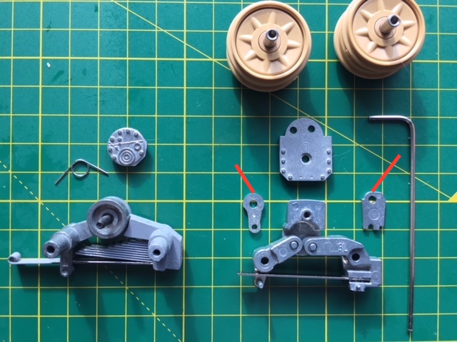

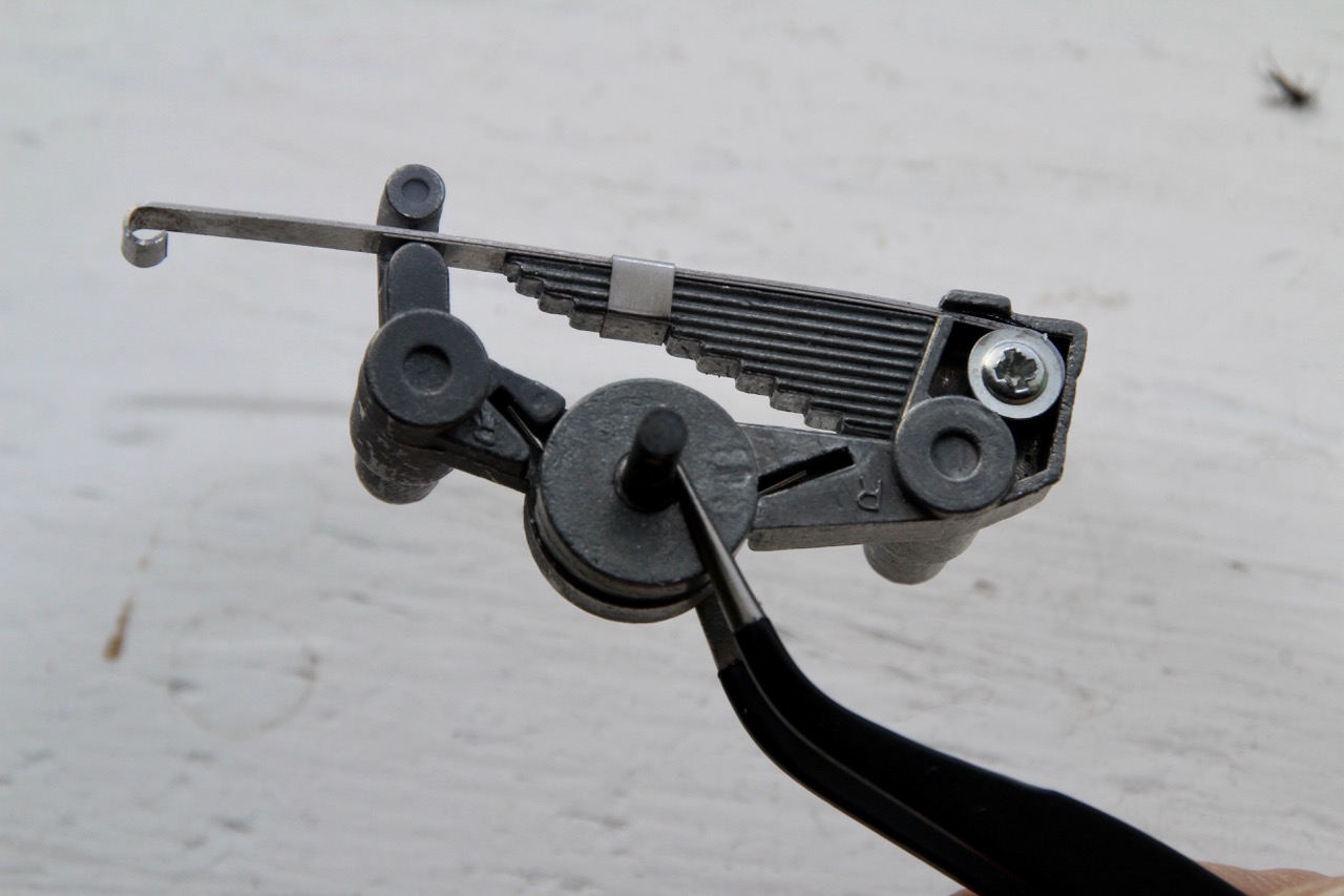

How does the leaf fit into the bogie assembly? I'm wondering if it'd be possible to modify the inserted end of the leaf with a short right-angle bend to hold it in situ.[/quote]
Well, Dan the leaf spring assembly looks very much like a real layered unit, but only the bottom spring does any actually 'springing'. At one end is curls around a stub in the 'leaf' housing, where it is secured by a self-tapping screw. In the centre section, it is clipped to the leaf assembly by the fragile square profile clip. At the far (sliding) end it is not retained in place, and merely slides between the leaf housing and a little stub. Under pressure, it could deform and detach sideways from the stub.
With the Tamiya arrangement, both ends of the spring are secured in place by locking plates.
Taigen/Asiatam Pz IV suspension bogie components
The locking plates on the Tamiya system are indicated below by red lines...
Pz IV suspensions compared
The Tamiya system therefore looks well secured in comparison to the chinese alternative.
