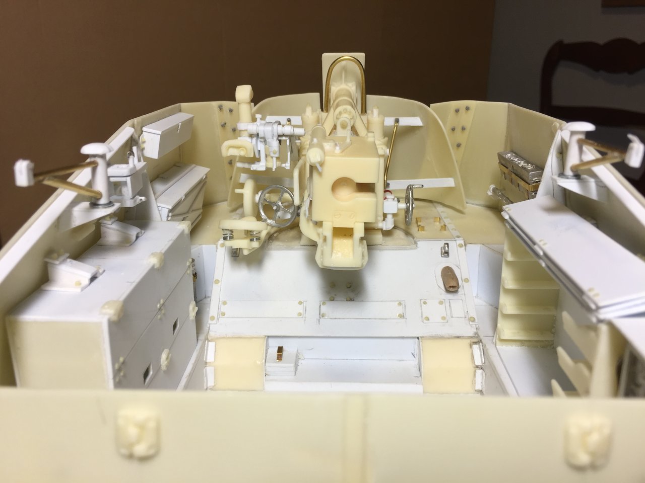

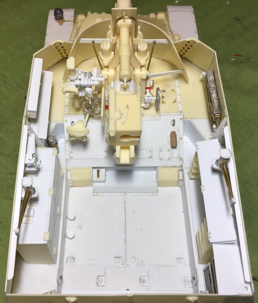

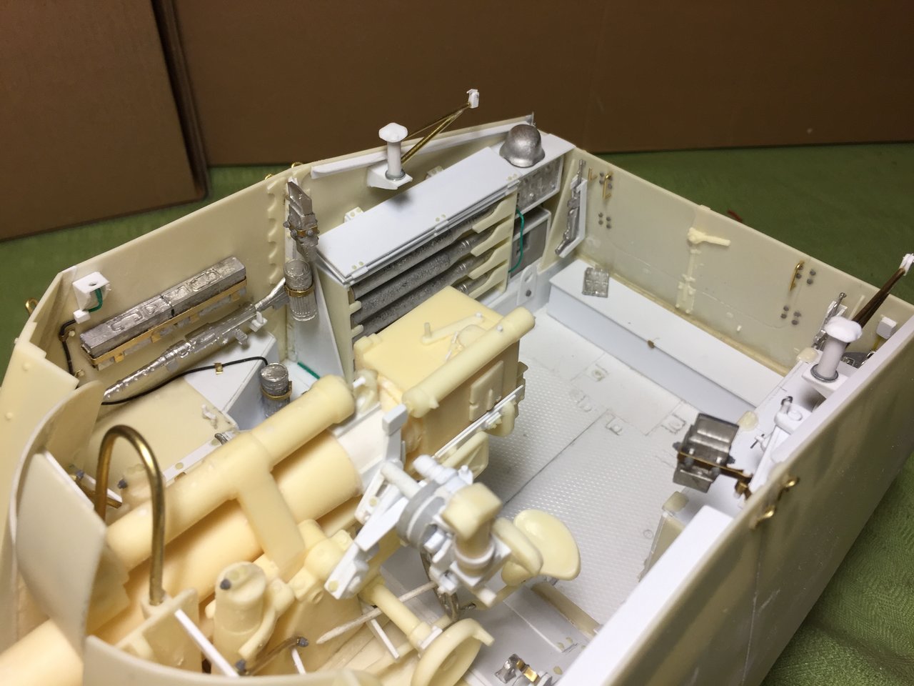

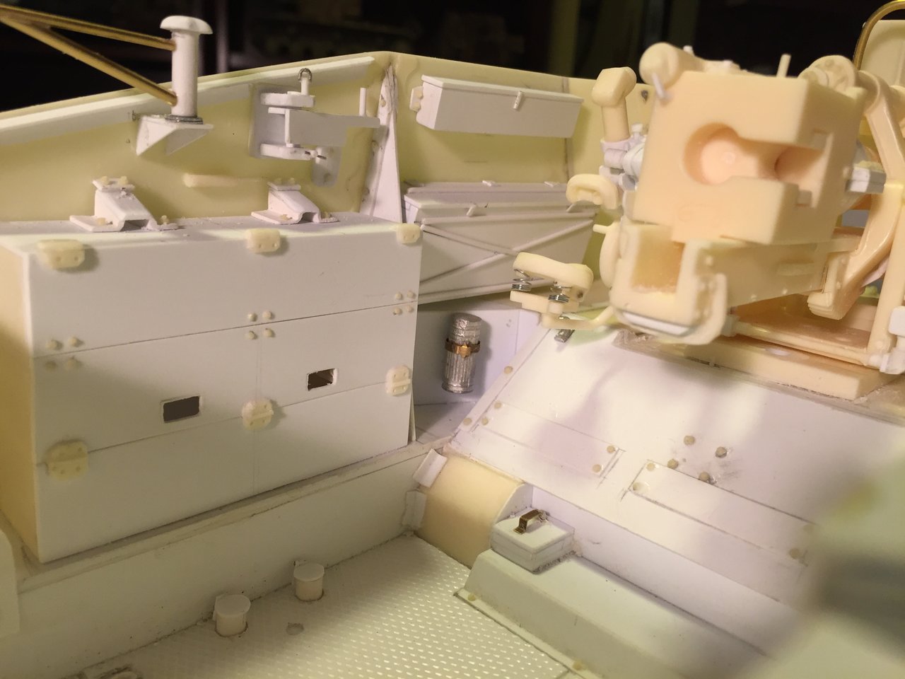

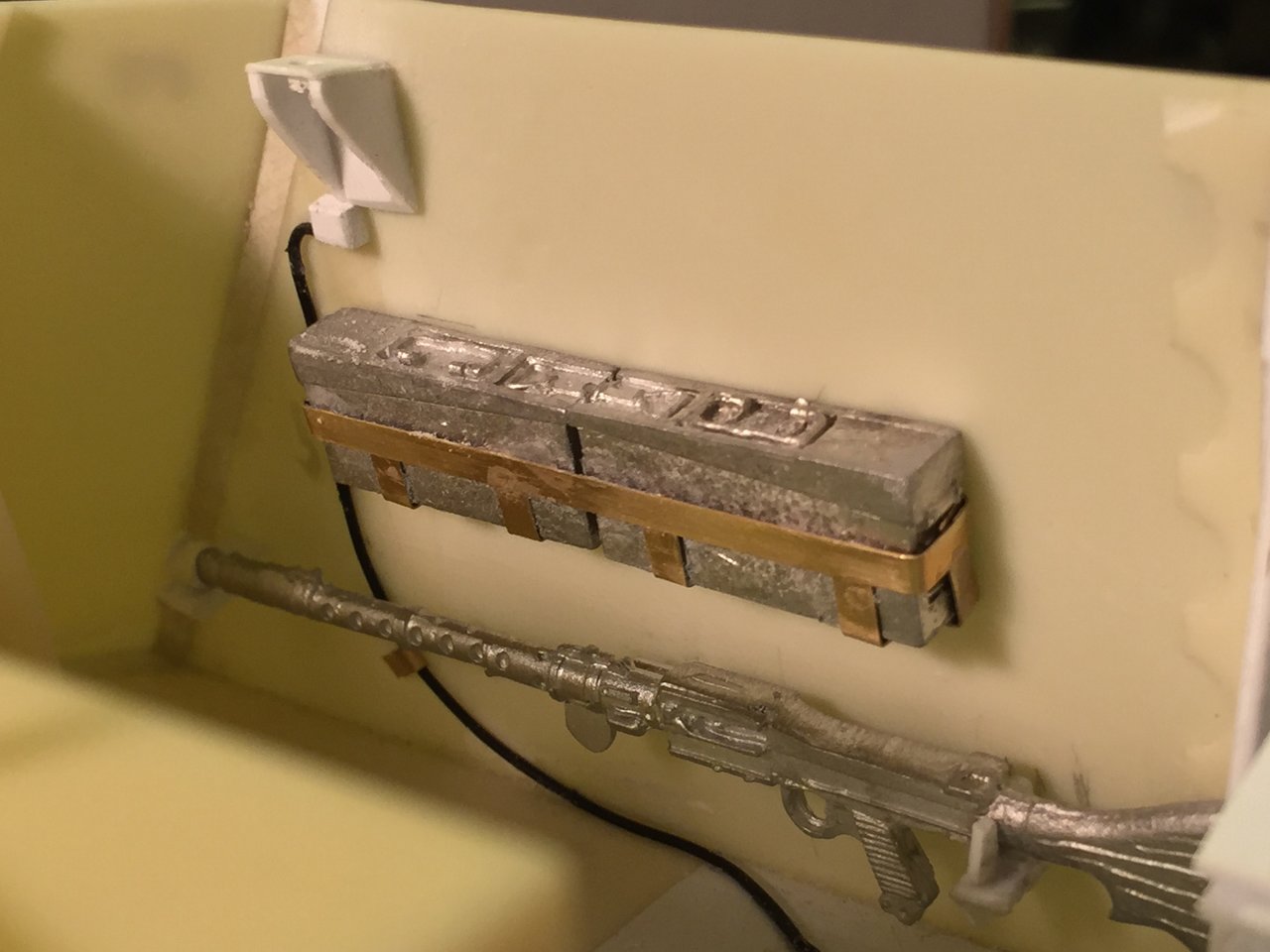

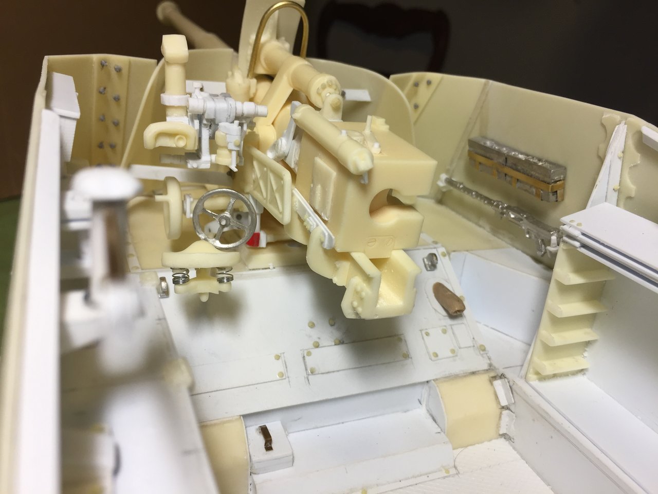

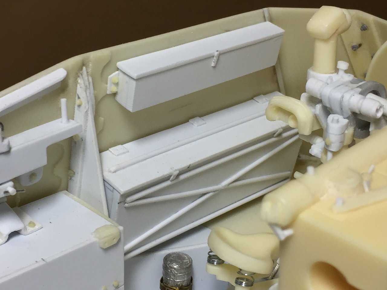

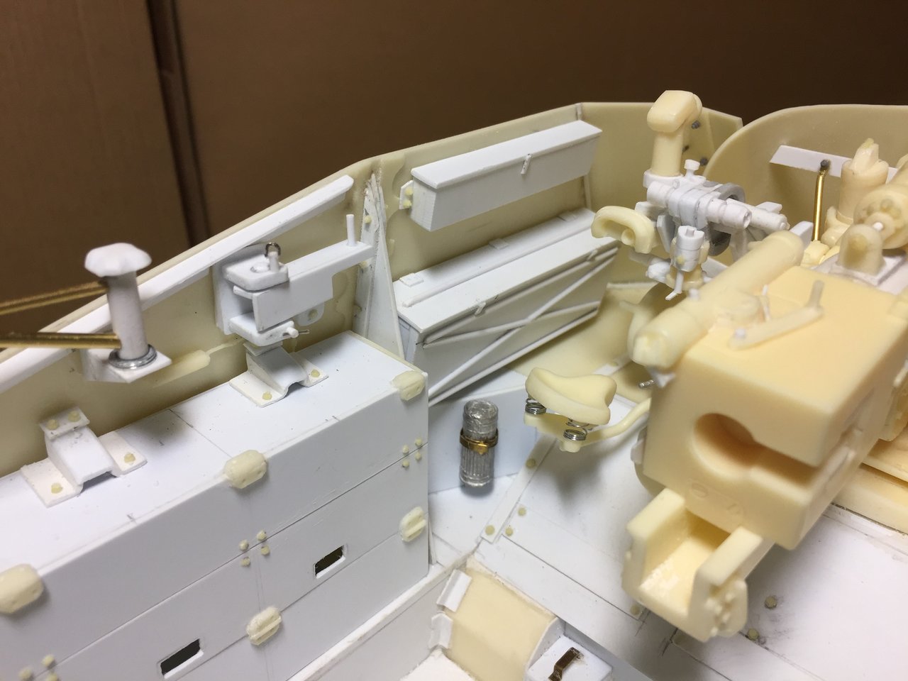

With this step, the last interior modules were built in plasticard and installed, this is the optical equipment bin on top and the tools bin below. The locking clamps are temporary as I have some photo etched on order.

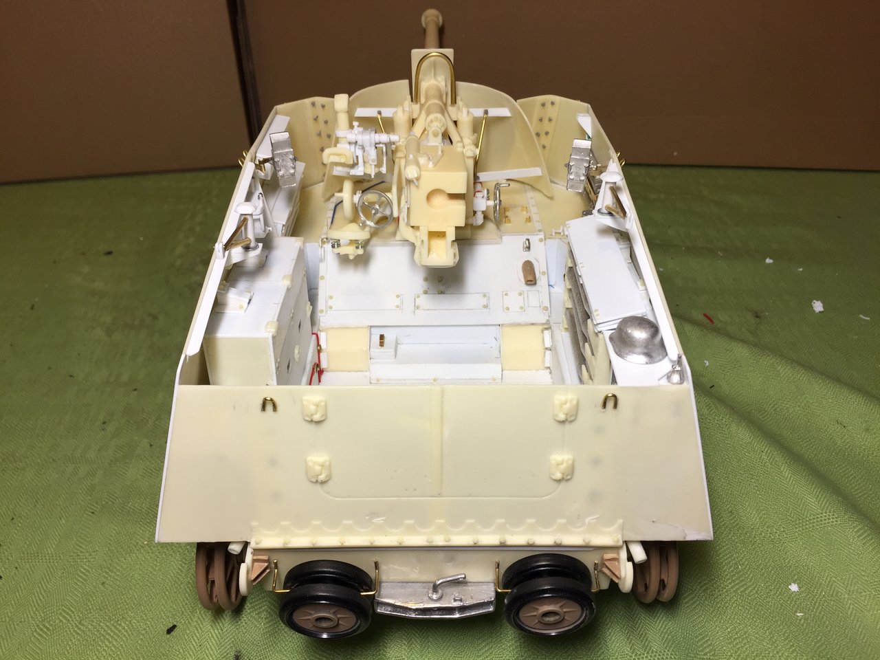

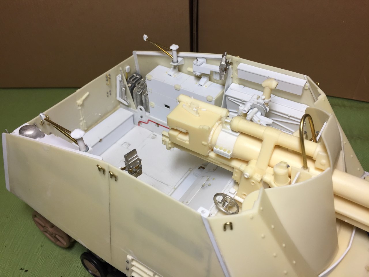

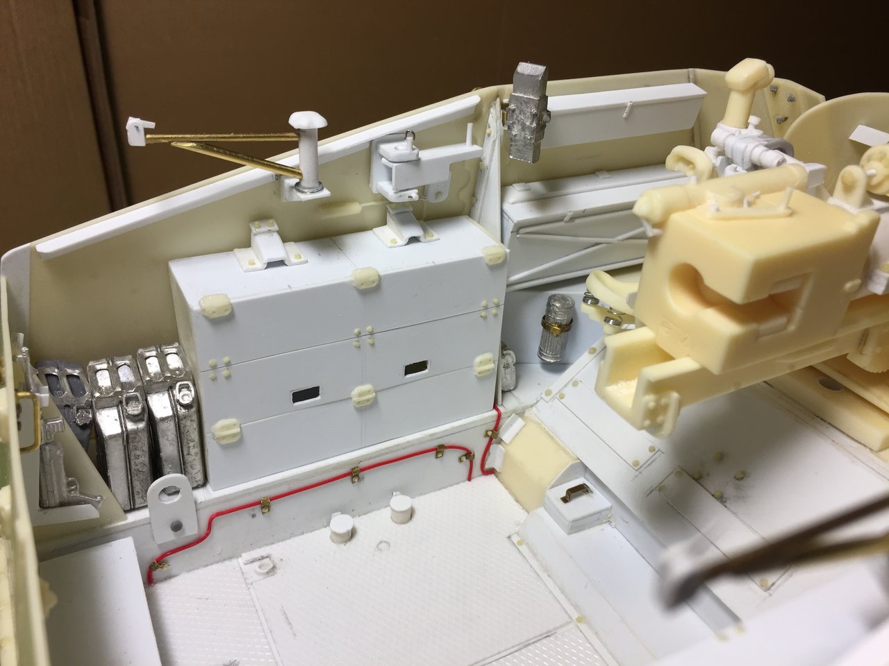

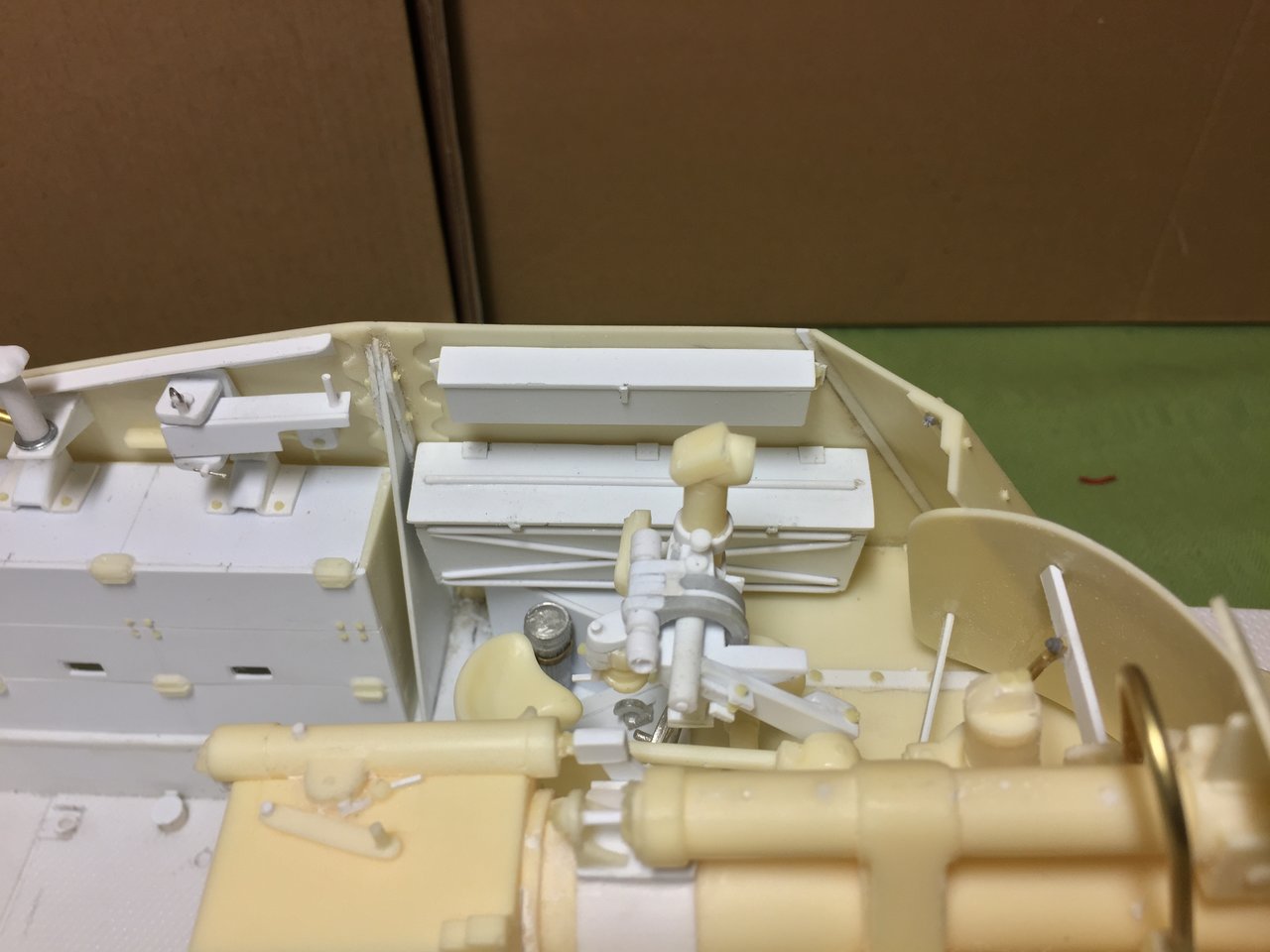

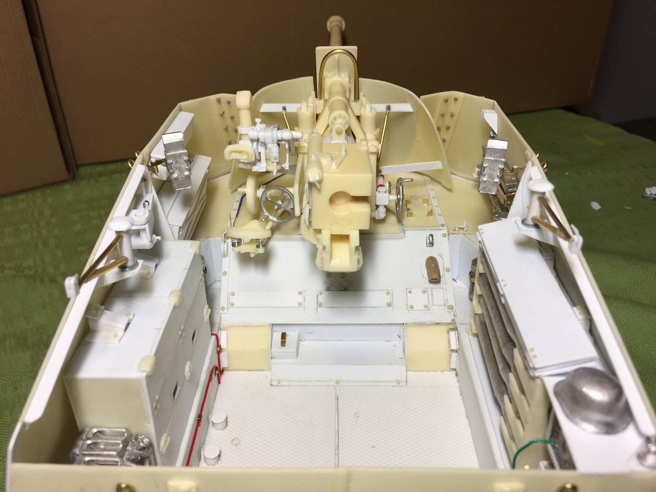

This is the overall interior now. It is mostly completed. I need to install some telecom wiring in a few places and some other miscellaneous equipments and brackets that i see on pictures. This is the fun part.
The temporary MG 34 stand I did last week was replaced by my interpretation of the pictures I saw of the stand on a Hummel. The surviving Nashorn no longer have their MG stands.
While I am awaiting some parts, I will finish the exterior as next steps. There is quite a lot still to do.

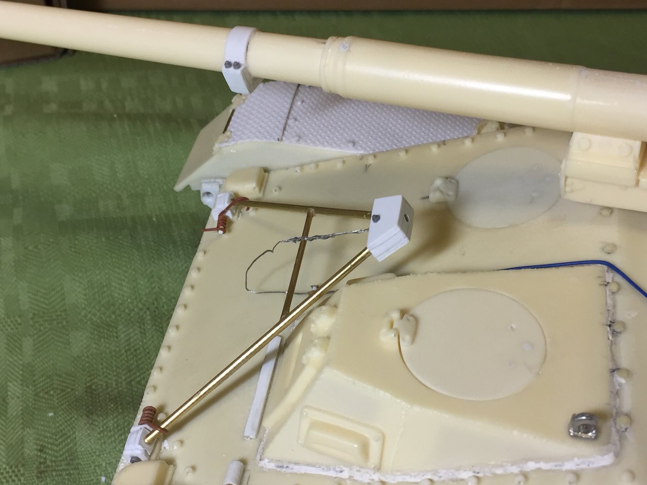

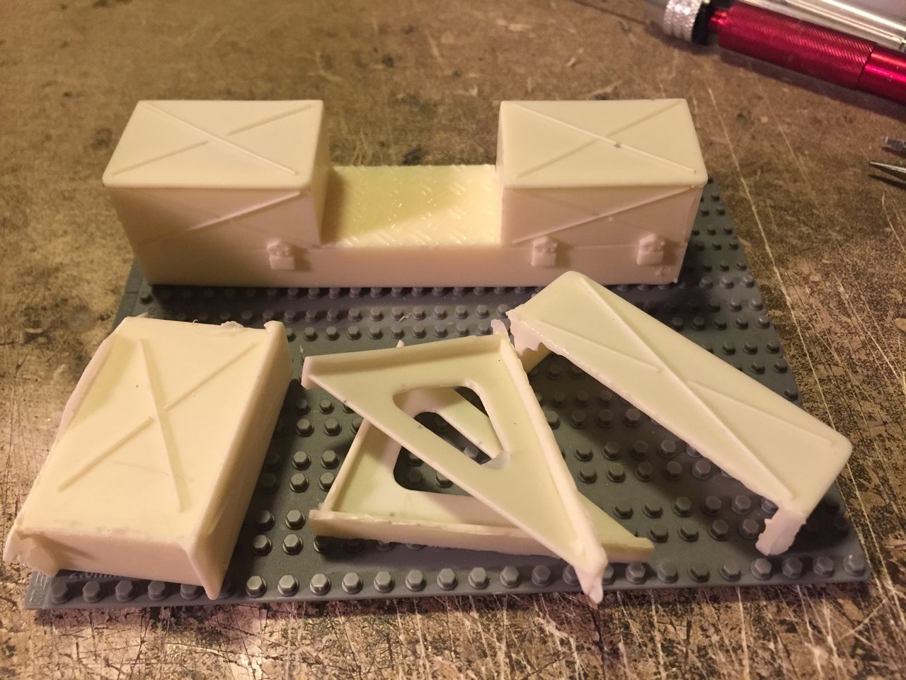

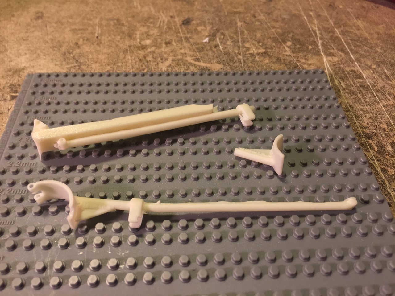

First, I wanted to show you some parts provided with the kit. I recognize some braces from the Munster Hummel. And some terribly formed bins vaguely resembling those seen on a Hummel as well. So, Juckenburg provided Hummel parts for the Nashorn, which should not be the same. I have no use for these.
Here is the Hummel or early Hornisse barrel clamp provided with the kit. The ring fits the 150mm barrel of the Hummel. I have no use for these either.

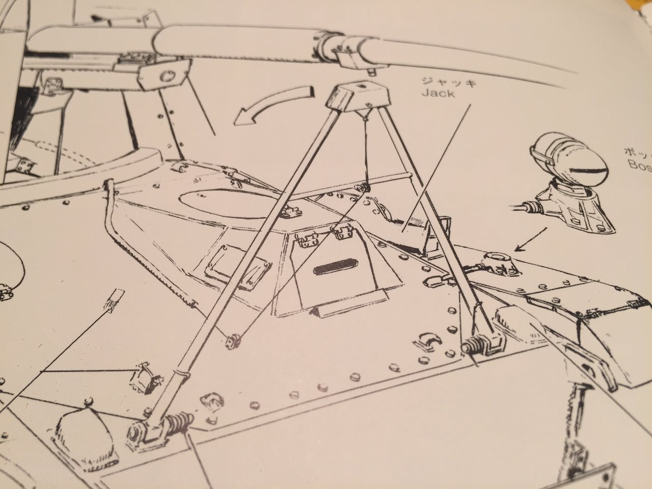

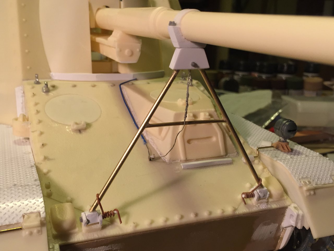

Here is the Nashorn barrel clamp as it should be on this kit, as shown on the excellent book "Panzers at Saumur, vol 3".

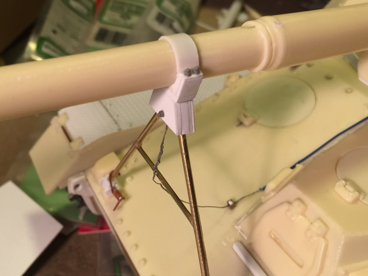

I worked hard to recreate the clamp from pictures, including the release mechanism. The Nashorn is equipped with a barrel clamp that is released from the inside of the fighting compartment. The Hummel type clamp installed on early Hornisse was requiring a crew member to come out in the open, climb the glacis and manually release the clamp while totally exposed to gun fire.
All barrel clamp parts needed to be scratch built.

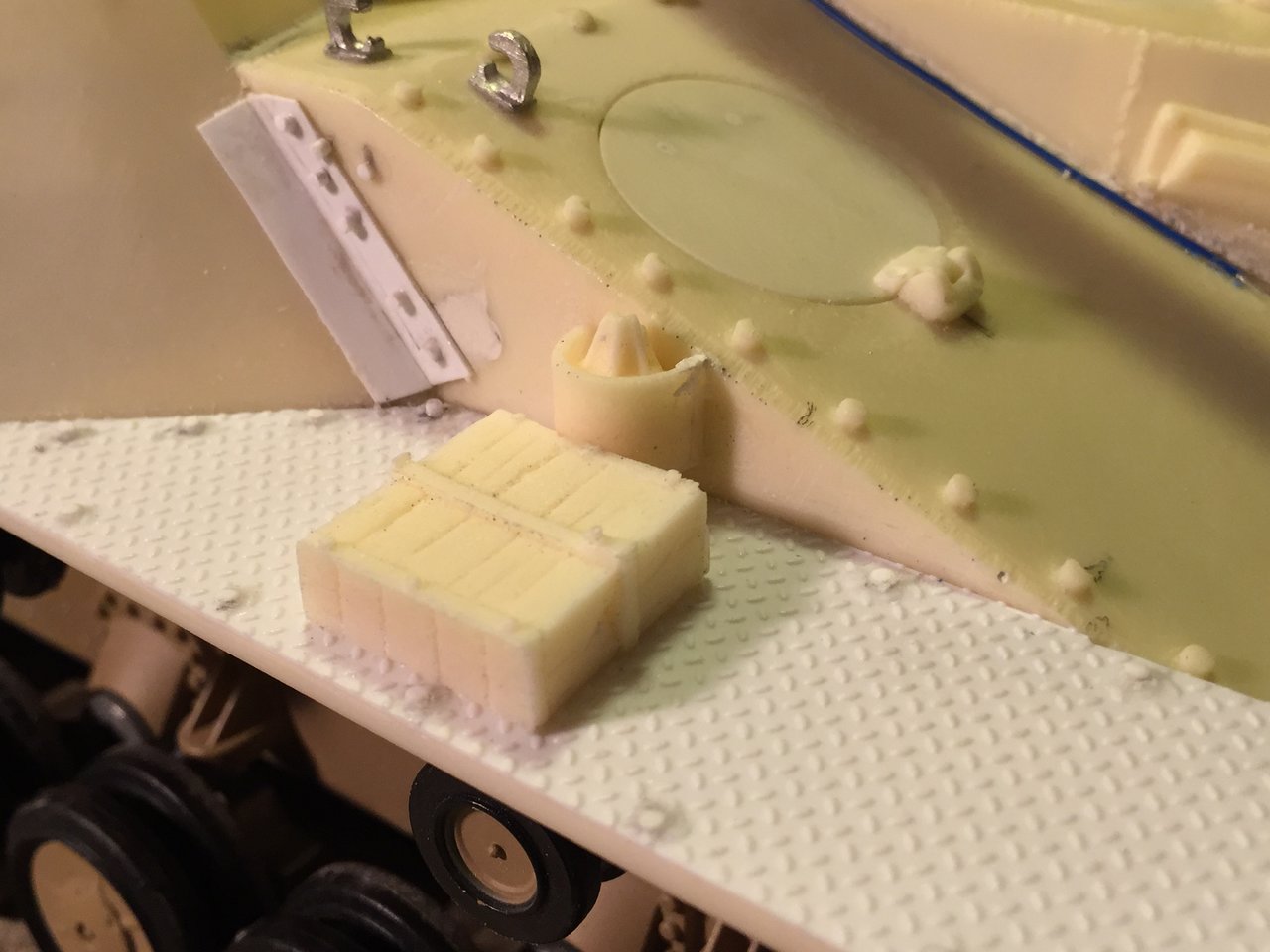

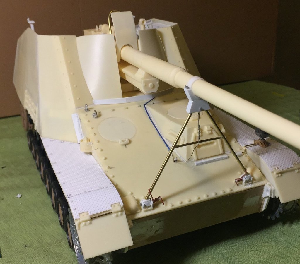

Once released, the clamp falls on the glacis and the gun is let loose. However, you can see that the kit part for the driver compartment is oversized, likely by 20%.

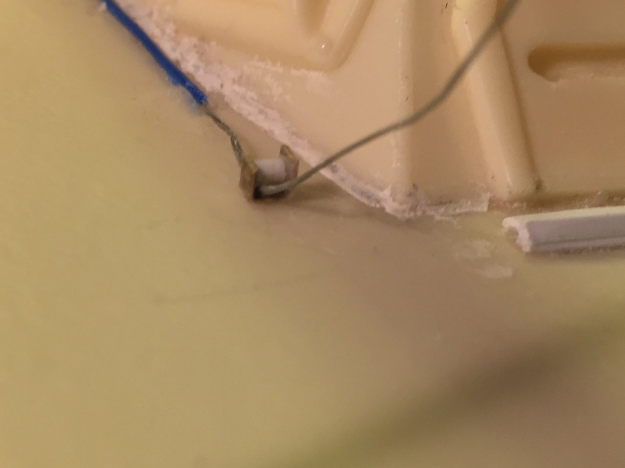

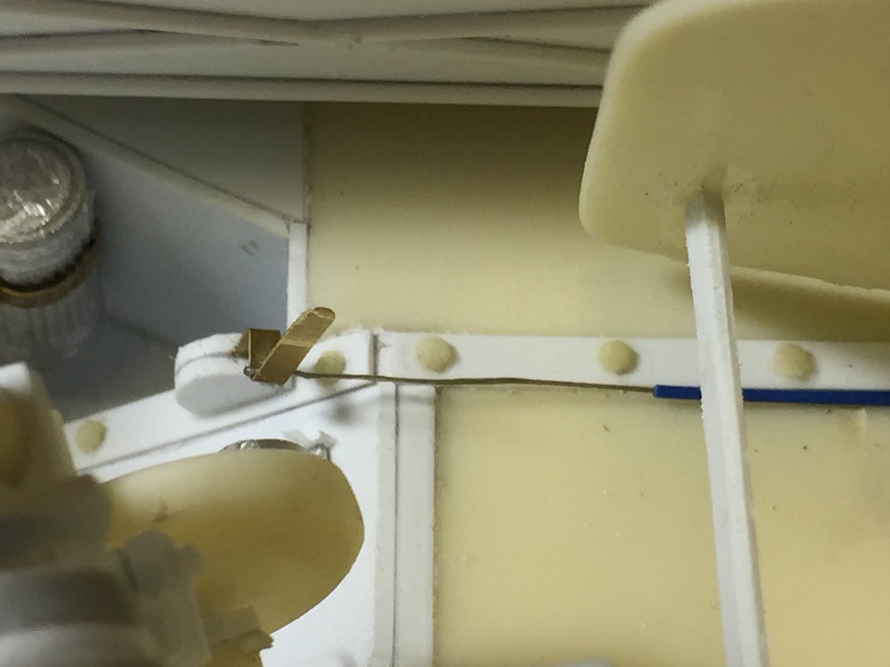

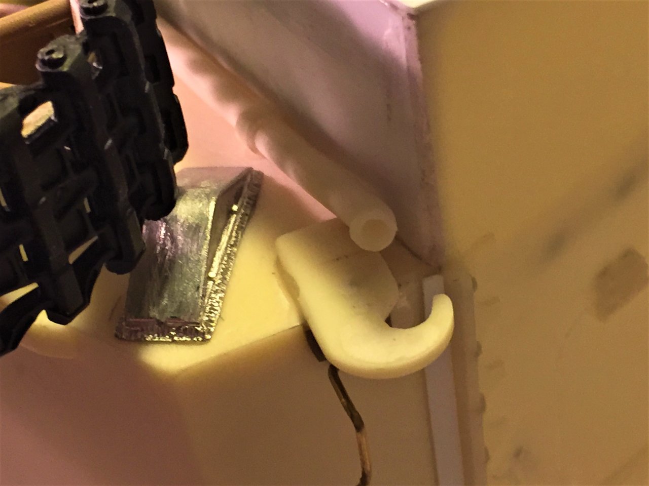

This is the simple release mechanism installed on the left of the gun inside the fighting compartment. it pulls the wire all the way to the tip of the clamp.

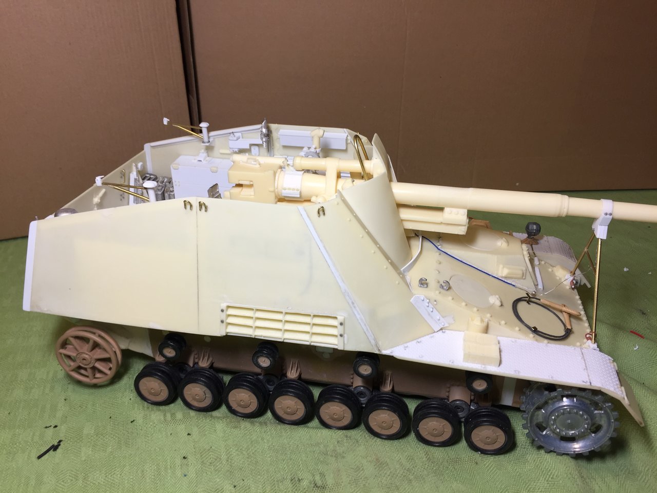

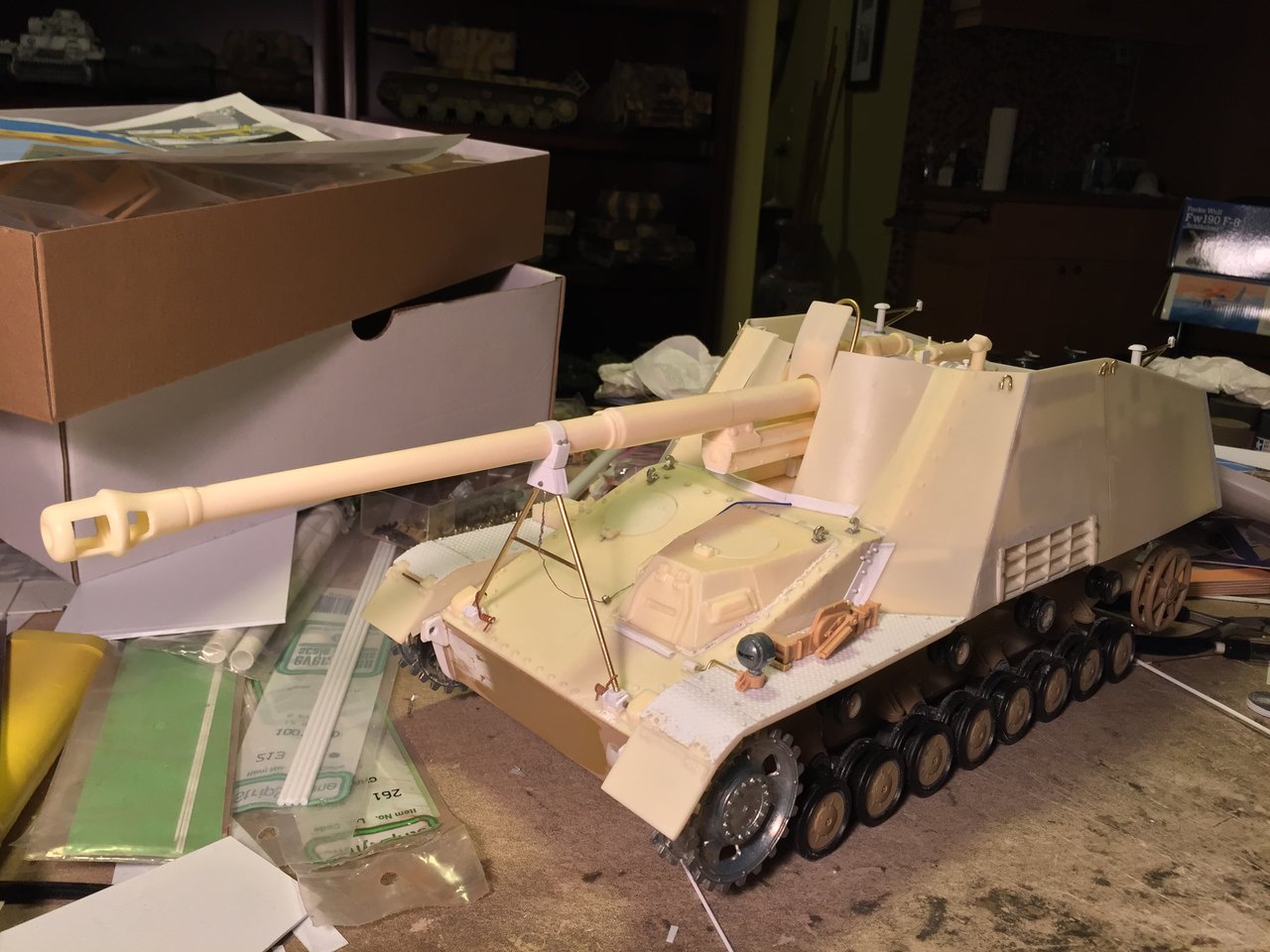

Overview of the Nashorn at this time

Louis that is awesome work
It's so nicely engineered it's a shame to paint it lol...
I might have to take your idea for the gun assembly release for my build. Super job
It's so nicely engineered it's a shame to paint it lol... I might have to take your idea for the gun assembly release for my build. Super job
Tanks alot....
- Posts: 11842
Re: Juckenburg Nashorn
Holy-shit that gun release is magnificent

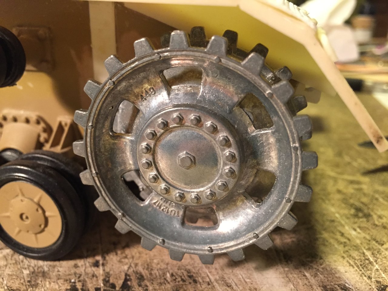

Nashorn have a Panzer III sprocket. Later Nashorns have the Ausf J version with many seen on pictures without the hub cap, which is more interesting. The Mato metal sprocket is oversized I think.

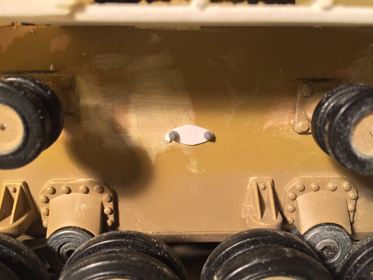

The jacking block. An actual kit part that can be used...

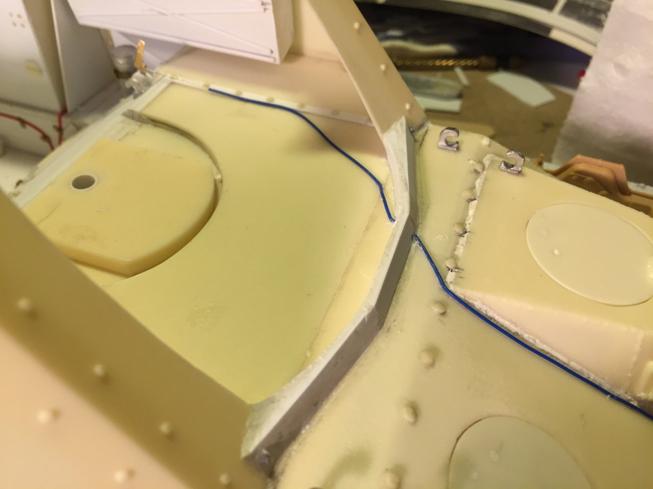

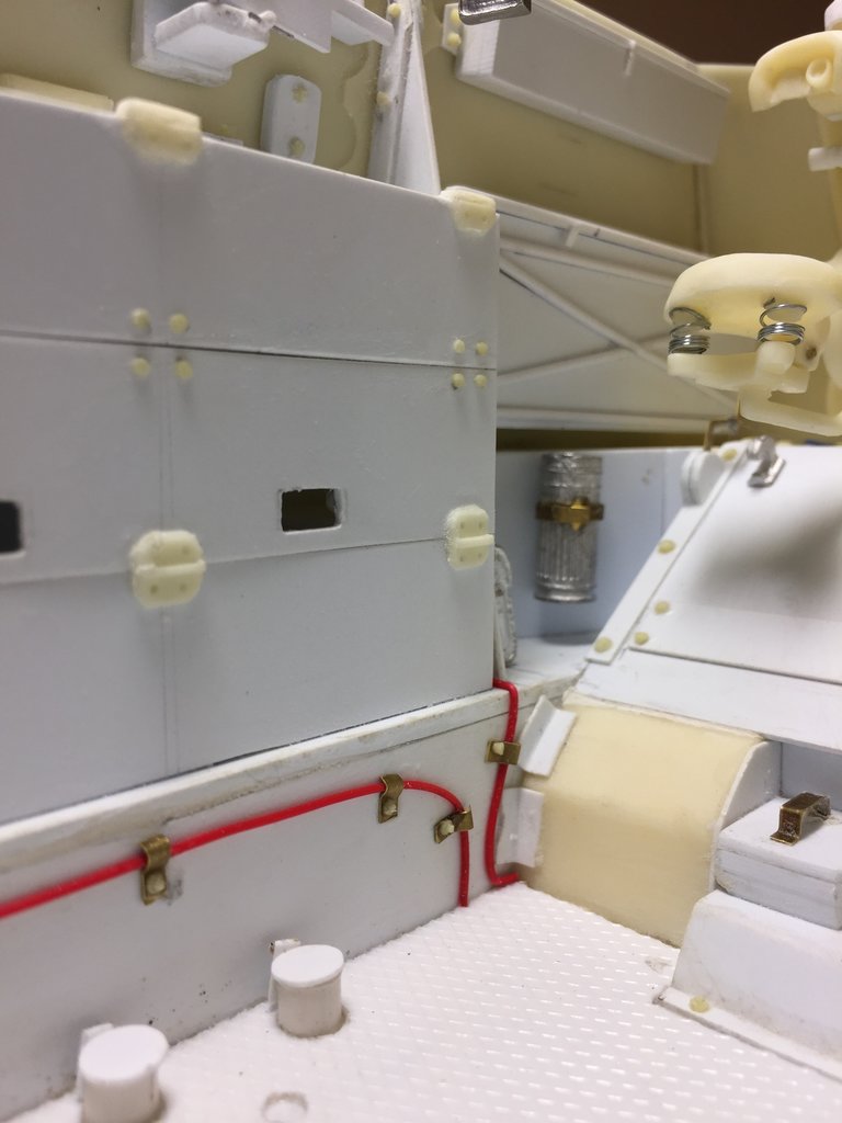

Started some of the interior radio wiring. I think it adds a lot to the look.

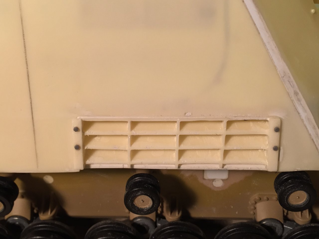

The air intake as they currently stand. I do not think I can do better than this. Sanding them just make more air bubbles come out.

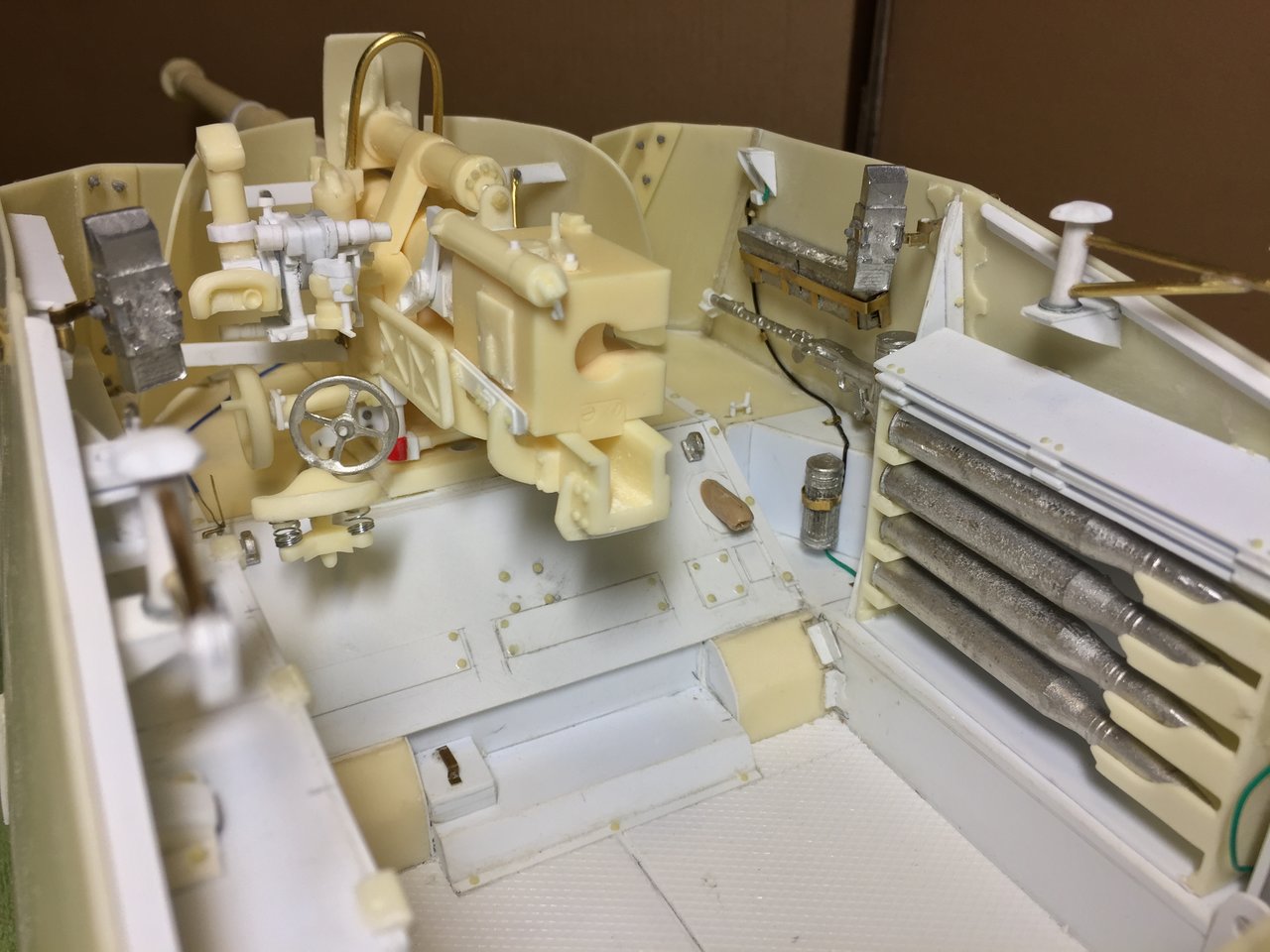

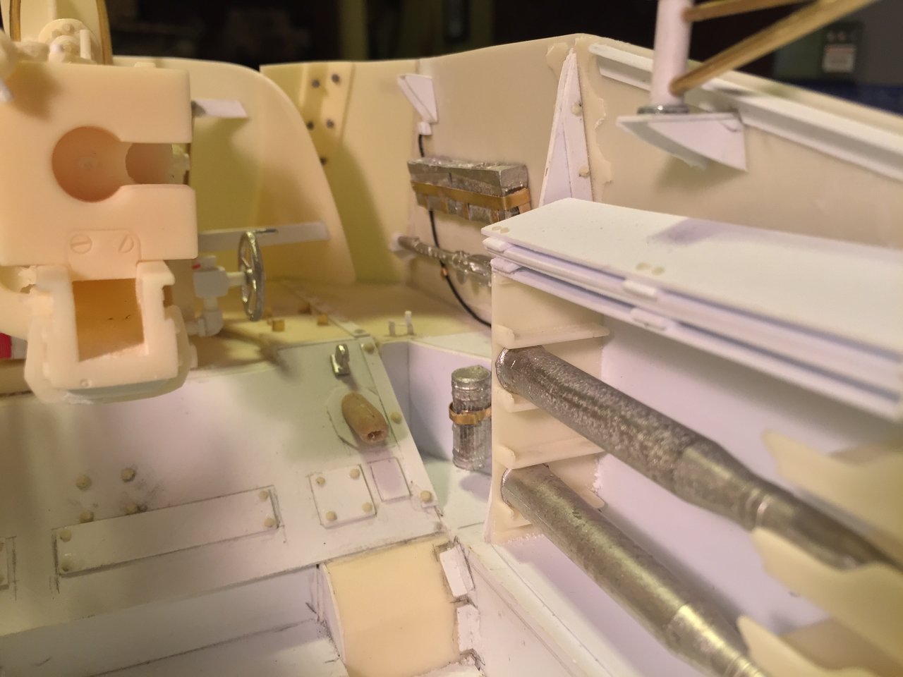

Latest interior views. The periscope were added, one on each side. Their mounting is quite fragile. Telecom wires are in place.
8 rounds will eventually fill the ammo bin on the right.
The cables were positioned as per arrangements seen on the Nashorn at Aberdeen.

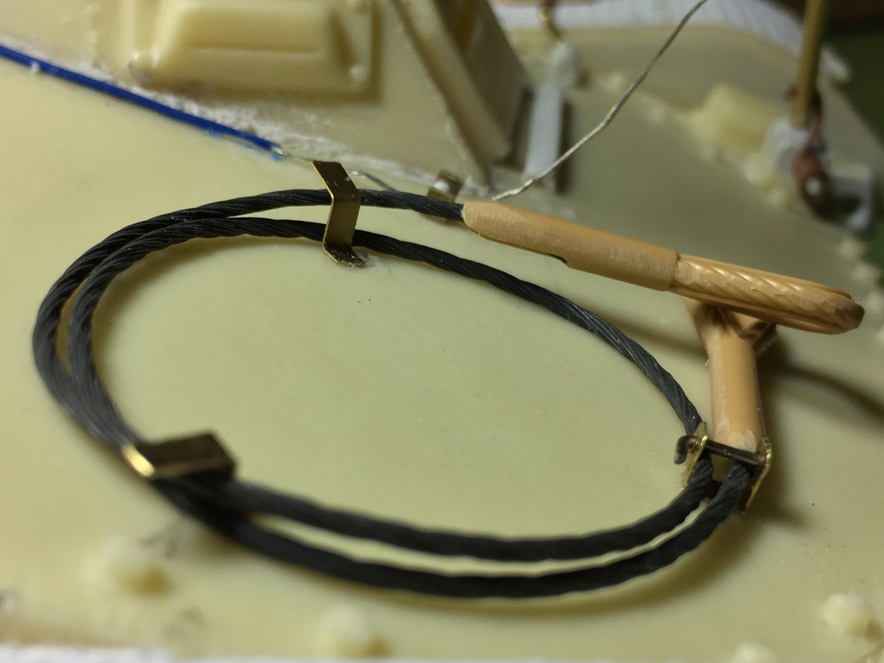

The tow cable arrangement is in place n the glacis.

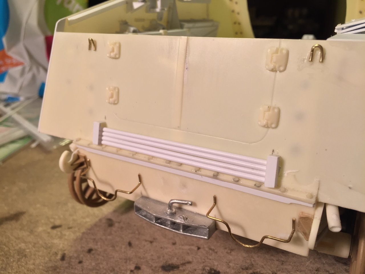

These are the gun cleaning rods. The Nashorn carries these connecting rods at the rear, and not to be confused with the longer "gun aiming posts" carried at the same location by the Hummel SP howitzer.

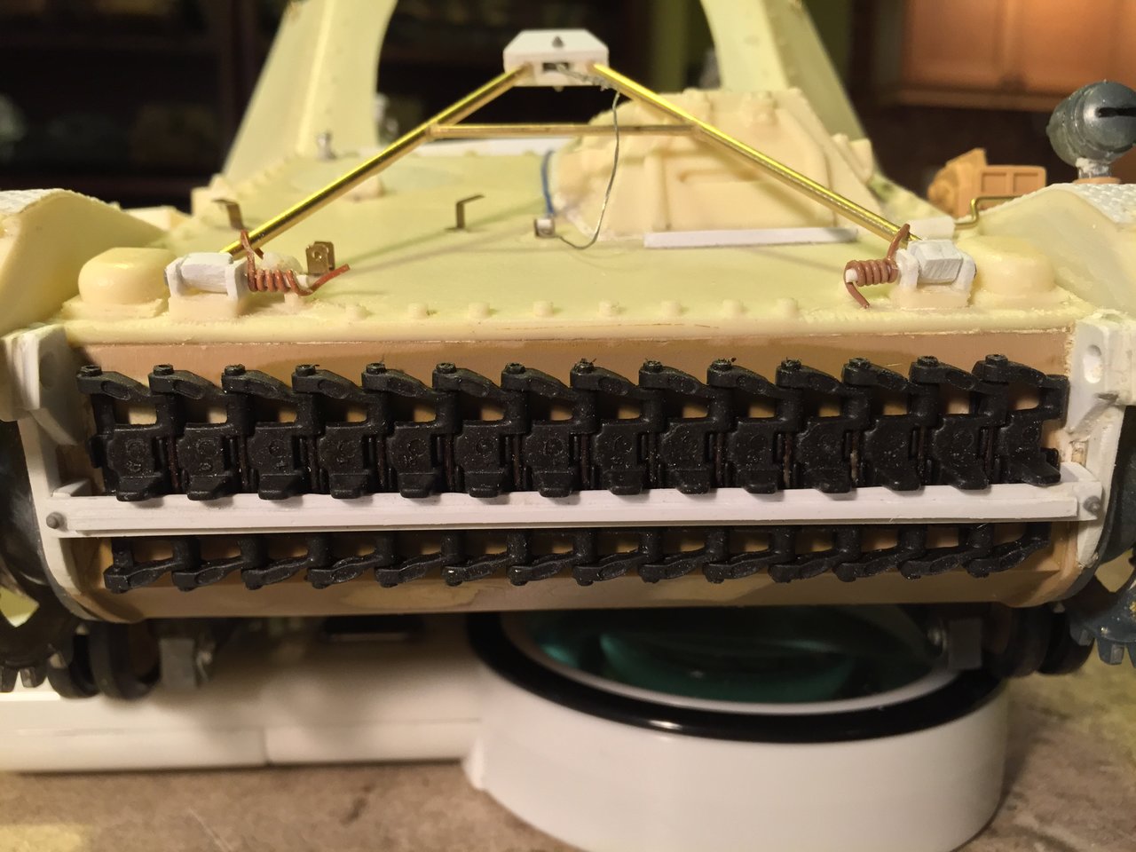

Spare tracks installed at the front, as usual.

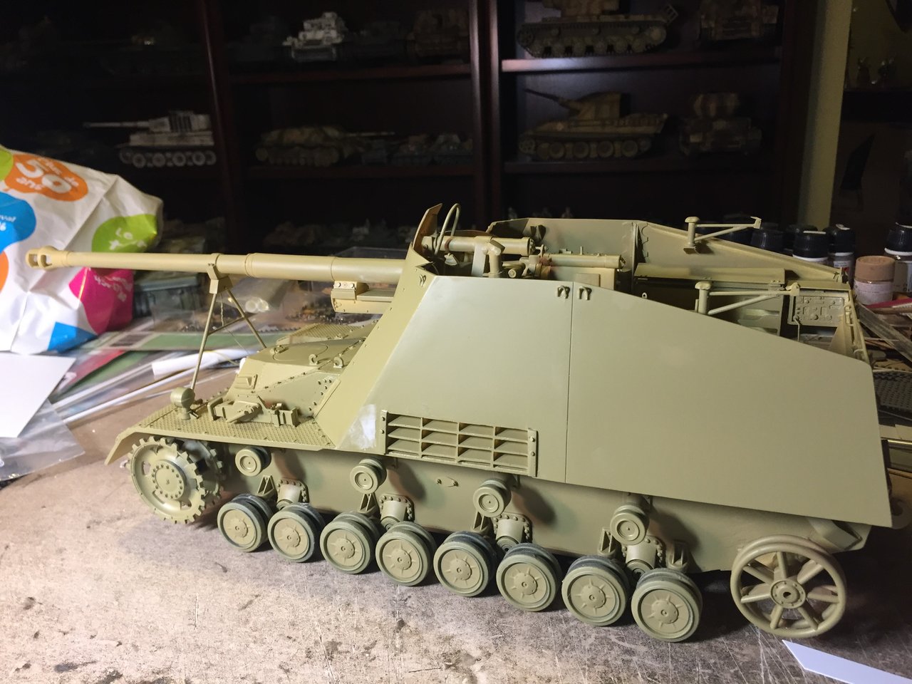

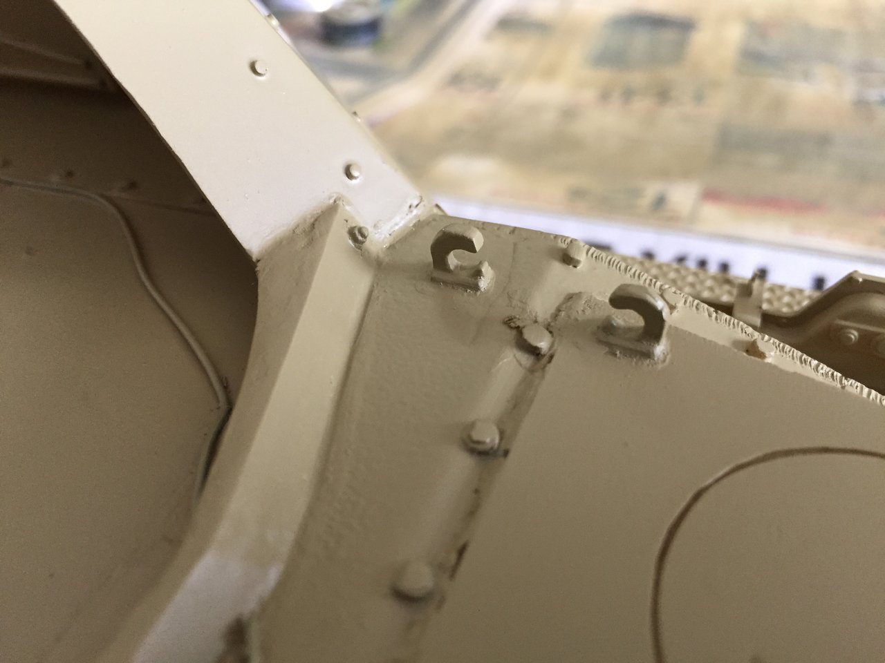

After a good wash (it was so dirty with all the sanding...), a coat of Tamiya Dark Yellow enamel was sprayed as a primer to seal the resin, plasticard and all the putty put on this model during the past month. Otherwise, the putty oil will come through to the acrylic surface after a few months and ruin the paint job. The paint make various issues become apparent as expected (scratches, air bubble, small holes, imperfections of all sorts), and all need to be corrected before going further. These will be sealed again locally with enamel before the following coats which will use acrylics. I will give the Nashorn a three tone camo scheme.
At this point, I bring the model in the sunlight and take close up pictures of everything. It is very easy to spot every little thing that needs to be corrected by zooming at these with a PC screen. As you can see in the picture below, there are residues next to some bolts and hooks. These are present all over the model. A short 20 minutes exercise of cleaning these with a small blade will greatly improve the look. But I always have to remember that this is a rough WW2 vehicle build by hand, not a shiny Ferrari, so it is actually quite realistic to leave imperfections in places.
