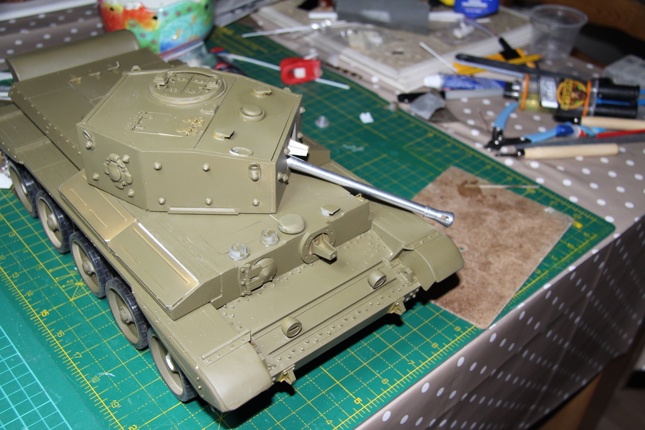

Looks good with paint! Nice work!

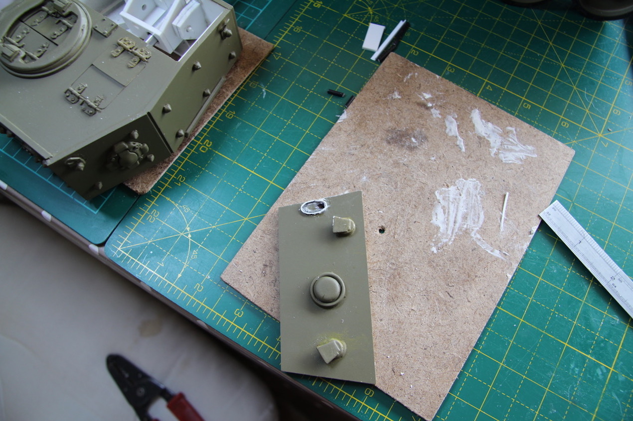

..and after a wee break, to catch up on things I've been neglecting, it's back to 'work'...and it does feel like a proper job sometimes.
Defence portal glued in place, prior to sanding

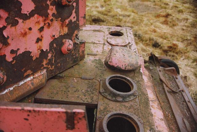

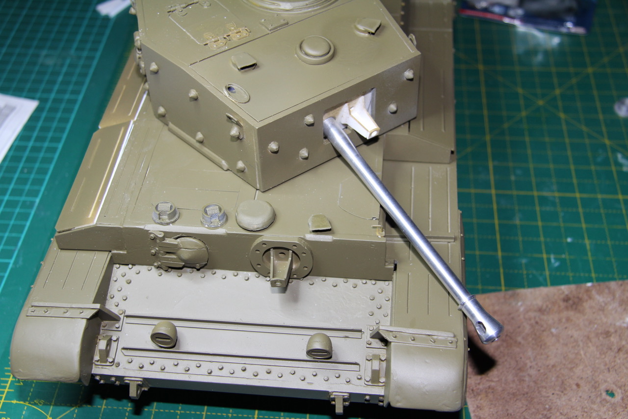

Finding pics of the Cromwell from above has proved difficult. I have a blueprint, but getting the scale of things right can be tricky, and frustrating (fun too, though.. :shh: ). I need to make an air vent for the upper hull, and fit three periscopes in front of the Turret. Placement ideas I got from this battered Cromwell pic. It's been shot to pieces on the Otterburn firing range, where it's in the company, of Comets, Challengers (WW2), Centurions and more. Sadly, some are barely recognisable now; but the site's worth a ghoulish peek:
http://hmvf.co.uk/forumvb/showthread.ph ... ecks/page3
The hull air vent I had to build in laminate form (three different thicknesses of styrene, bonded together):
Layout of periscopes and air vent
Cromwell periscopes and air vent.jpg (51.91 KiB) Viewed 3793 times
Layering air vent
Layering air vent
Base for air vent
Base for air vent

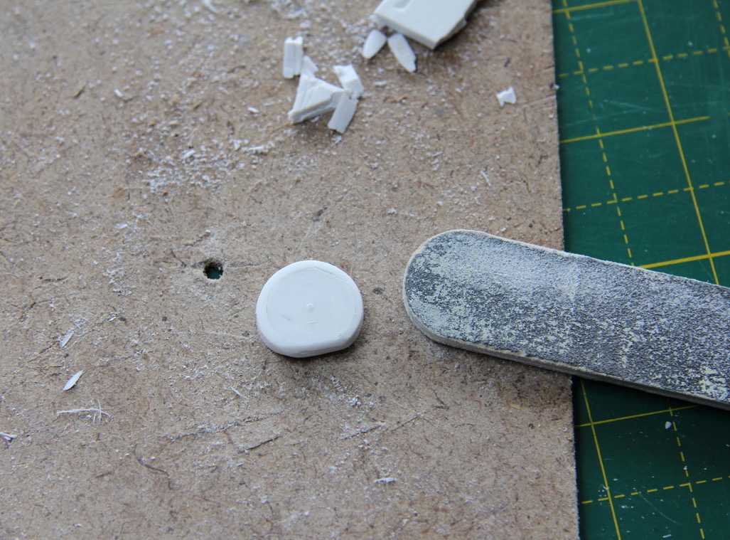

Sanding the whole thing into shape..
Working on the overall shape
About ready for fitting and paint

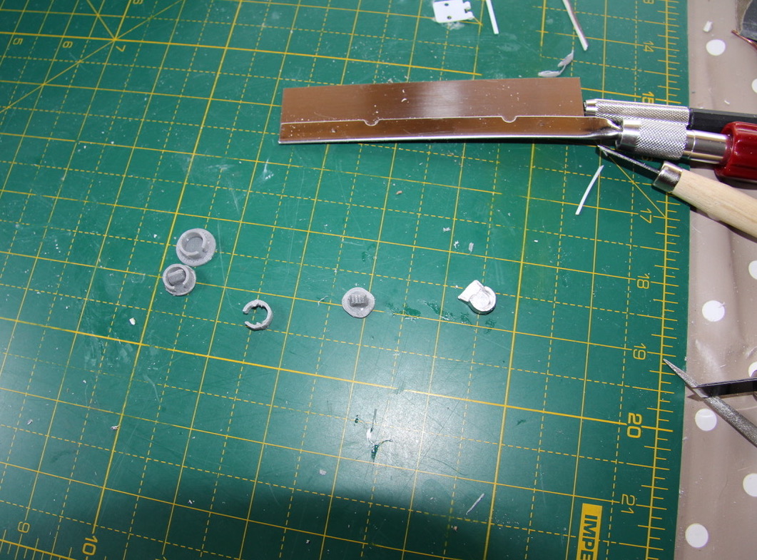

Now for the periscopes. Rob (Wibblywobbly of super Comet renown..) supplied me with these. They're an alternative to the three metal ones supplied by Chris. Unfortunately, they're millimetres too big for the Cromwell, so I had to saw them down to size.
Here you can see Comet periscopes above front armour plate
Exacto saw living up to its name..
This is what they, and the Air vent look like in place..prior to sanding and finishing.
From another angle..
Glueing Periscopes and Vent in place
Front almost complete, apart from headlight protectors
and an idea of what I was aiming for..coming :wave: shortly

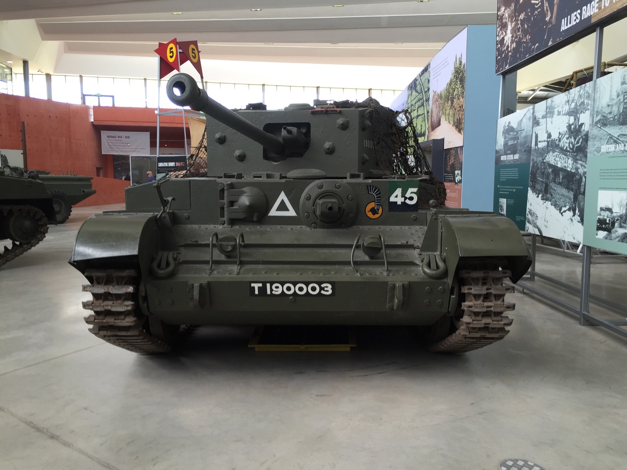

..the inspiration:
Front of the Bovington Cromwell I photographed last year

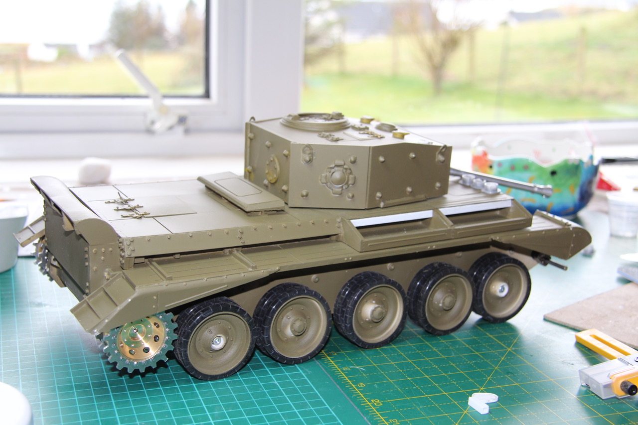

Here you can see an admixture of periscope types. I still have to make some bars to protect the headlights, some handles for the hatches, and inspection panels, as well as some hinges for the Storage bins (that's a tricky one). Apart from all that....phew.. :crazy: the exterior is pretty well complete apart form minor turret details (aerial etc.,) sanding, weathering, and a coat of proper paint: British Olive Drab, not the Yankee Olive Drab she's sporting at present.

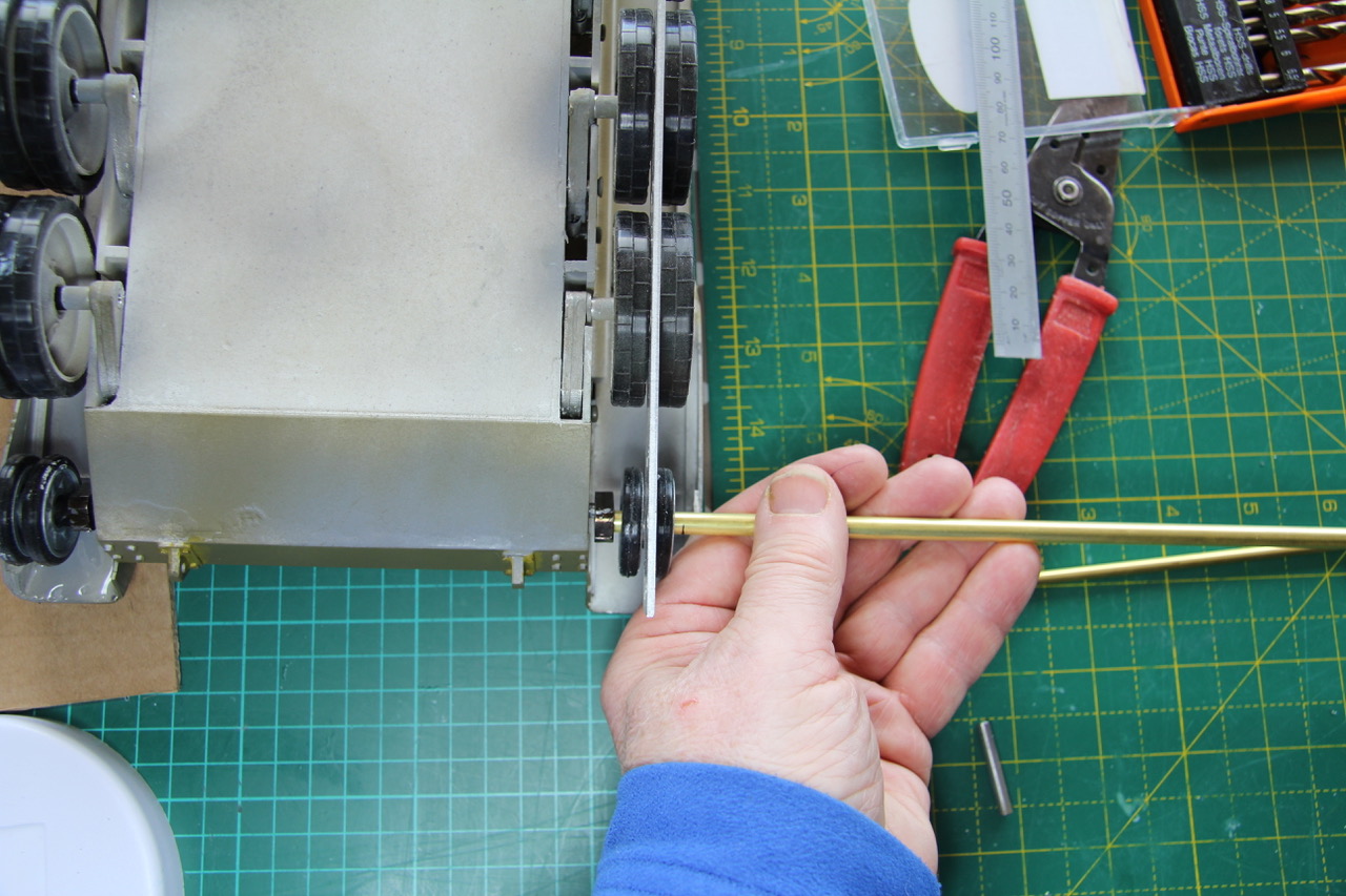

Now for the running gear. Having laboured long over this one, I found that 3mm nylon spacers/ bearings were needed on the swingarms. to line them up with the sprockets. Interestingly, the predictive text/ spell checker on this site wants to change 'swingarms' into 'swingers' >:< Damned thing. Certainly not what I'm looking for :haha: :haha:

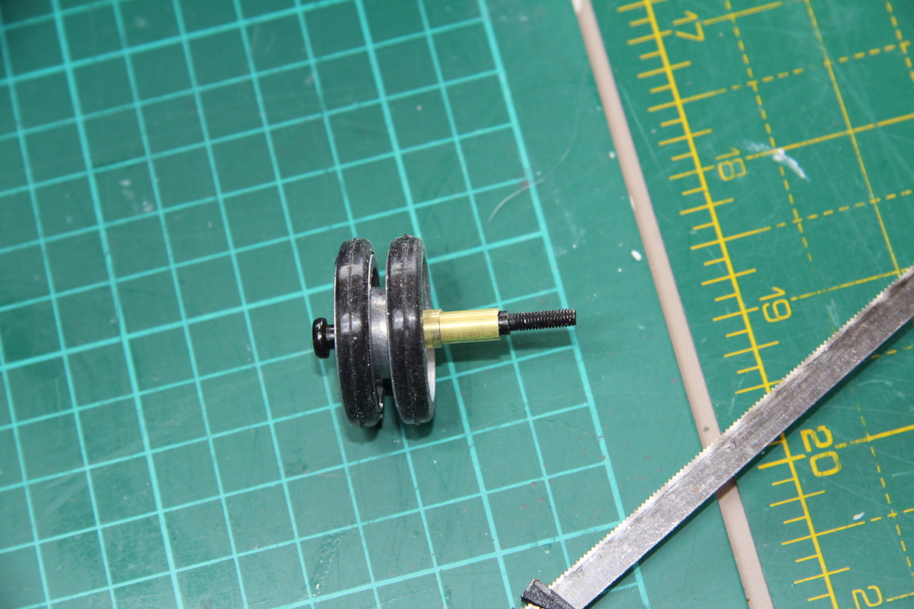

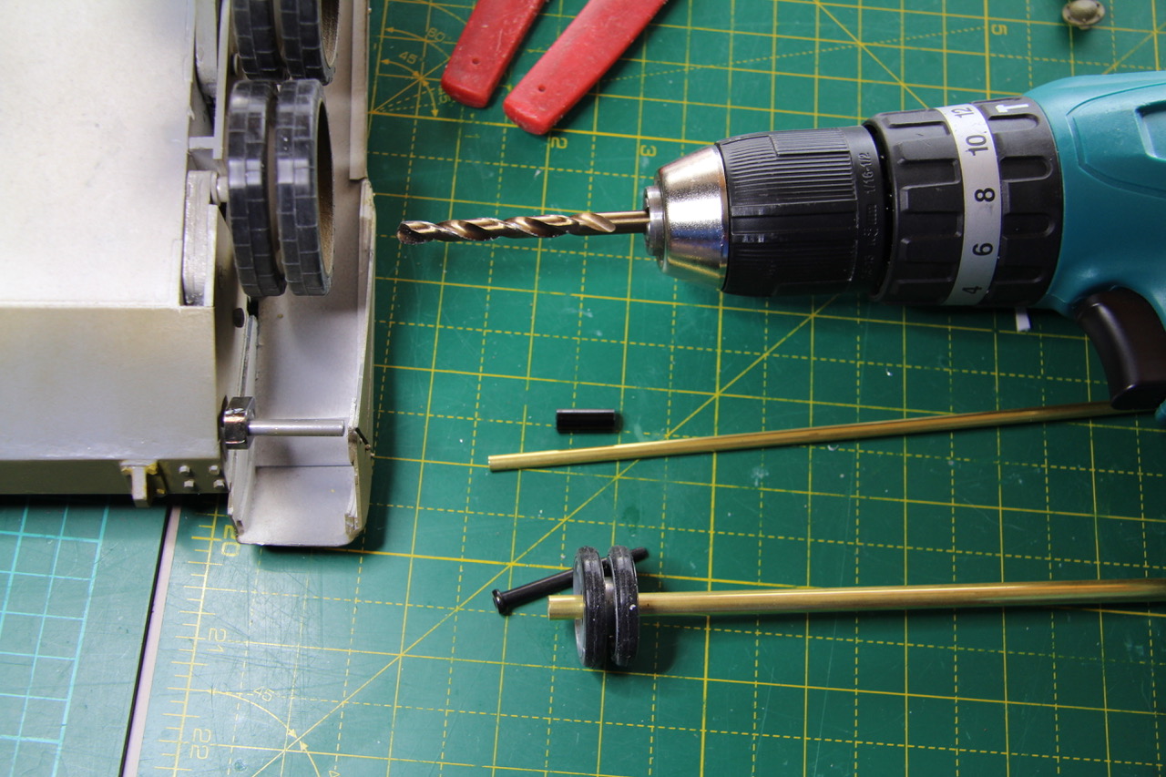

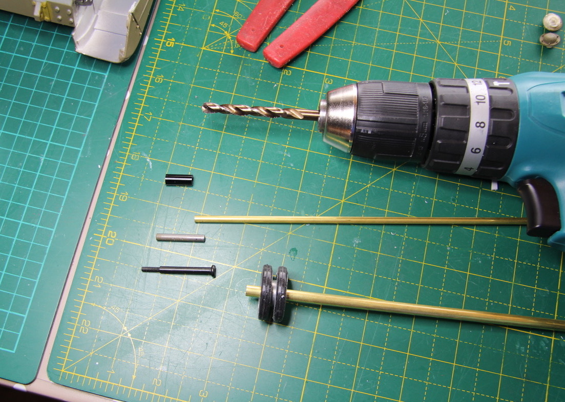

The wheels supplied as idler wheels are off the Pz IV. Unfortunately, they need a 6mm axle, and the Henntec only has a 4mm. So, the Henntec axle is now redundant.There was no bearing sleeve supplied, and so I had to make my own. I fitted 5mm brass (4mm bore) inside 6mm brass tubing (5mm bore)., and then drilled the Panzer wheels out to a precise 6mm bore (they were slightly under).
Trusty Makita cordless to the rescue..

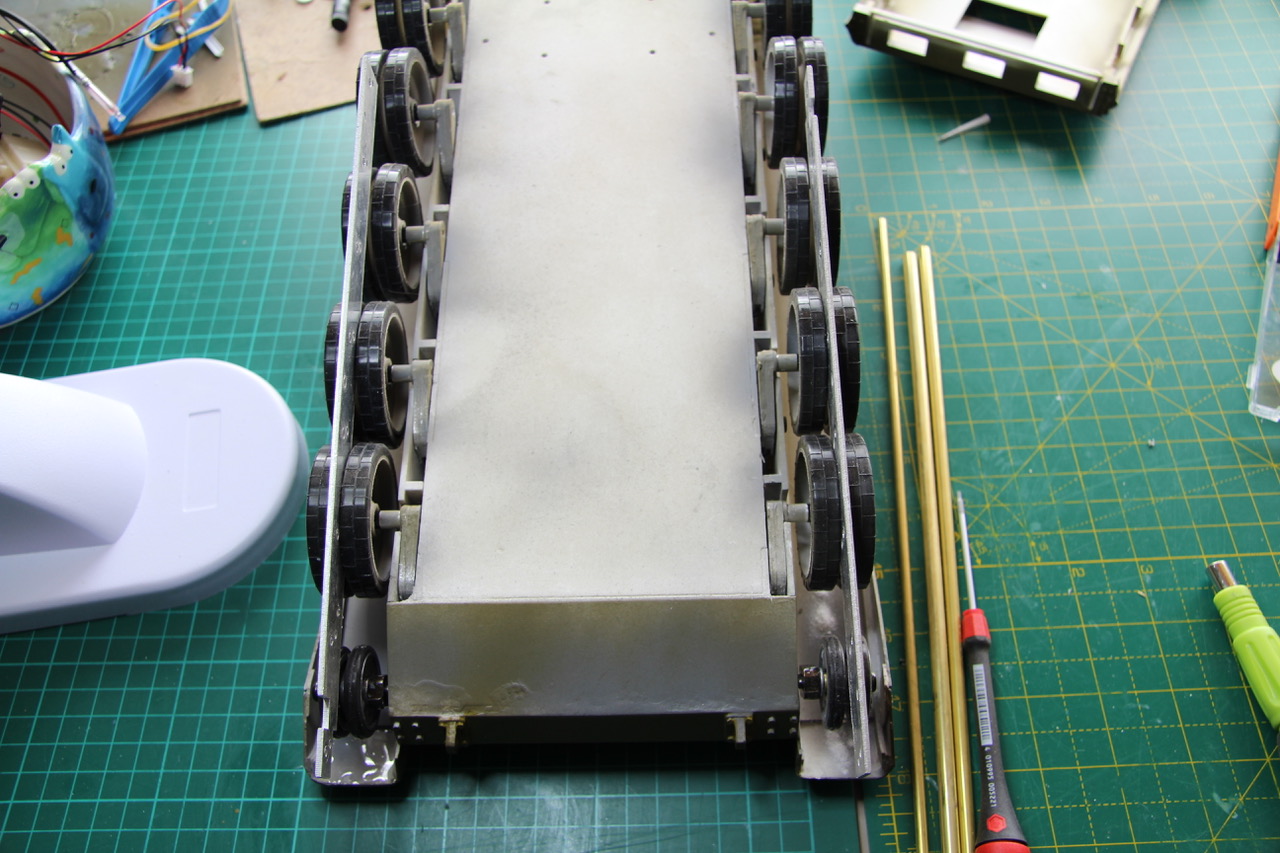

Here you can see the 4mm Henntec axle in place, and the HL Tiger 1 axle I intend to replace it with- along with the brass bearing sleeves.
Parts needed for idler bearing
Assembling bearing prior to cutting
Then lining up with wheel to find cutting point..
Checking alignment of idler before cutting
Idlers fitted. Note the Henntec axle had no 'stub' on it to hold the bearing in place. Another reason why I modified the Tiger 1 axle to fit.
Idler in place
Idler in place

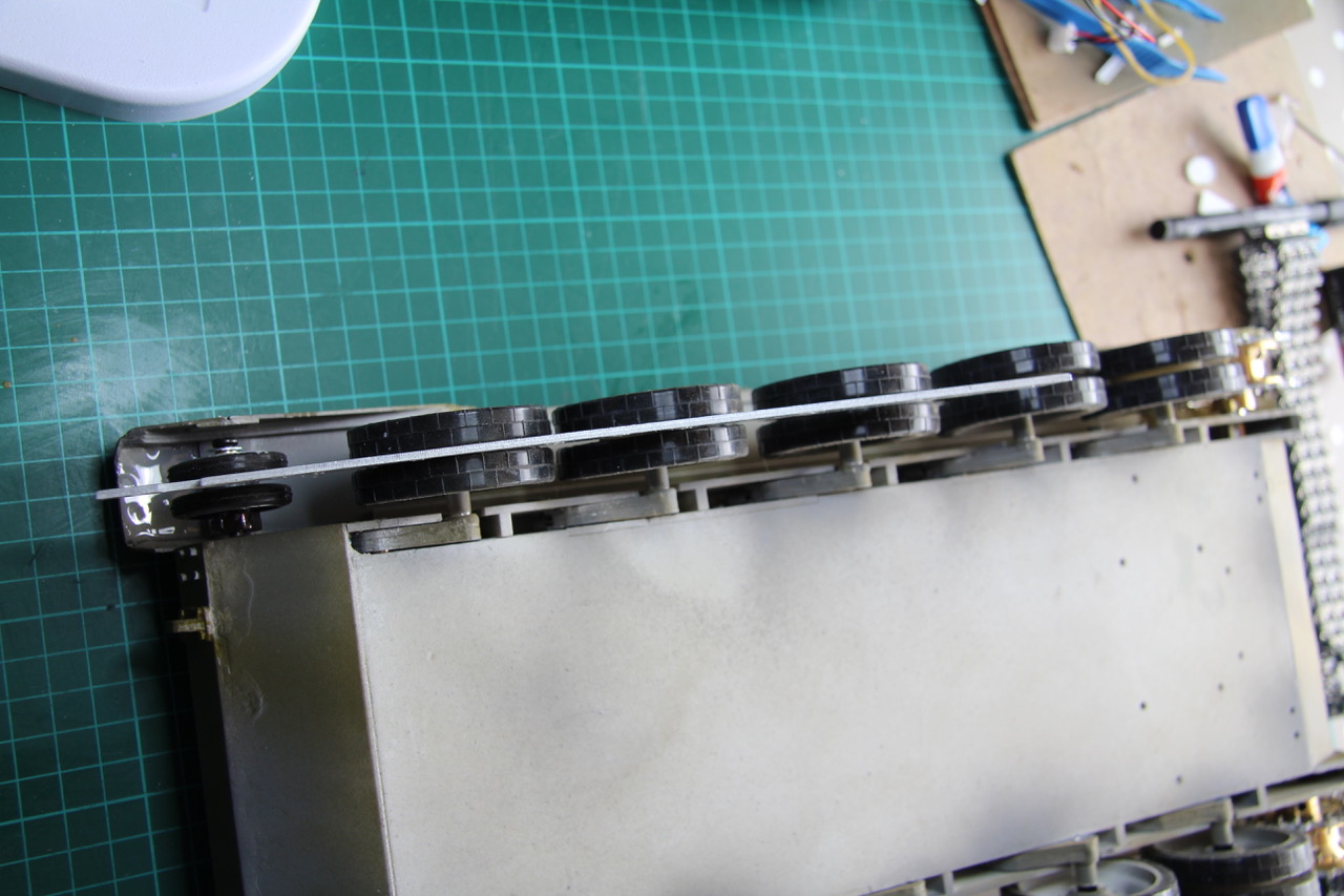

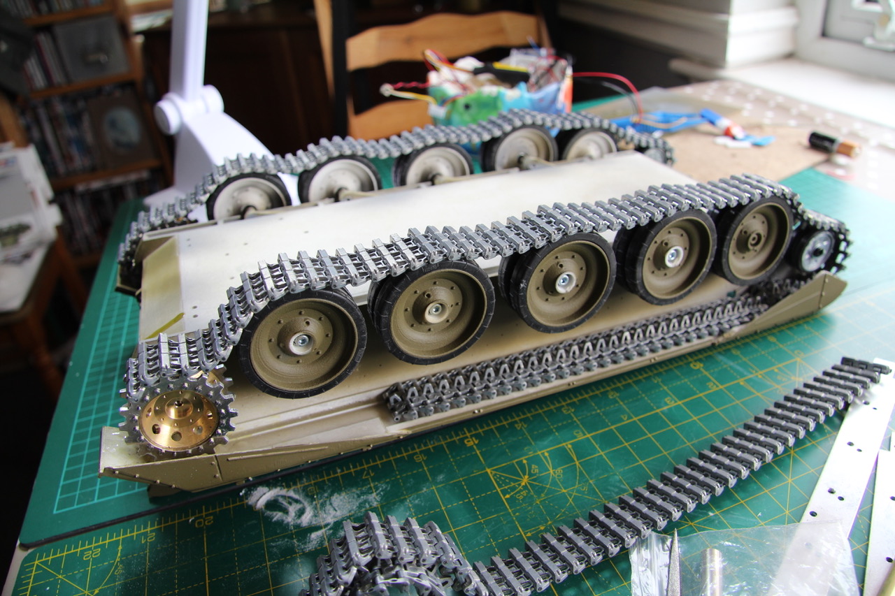

Now checking the overall alignment of the running gear, before test fitting the PZ IV tracks..
Checking wheel alignment..
Next, checking the tracks for clearance:
Testing for clearance..and beginning link count
These PZ IV/ Pz 3 tracks have around 91 links (correct for the real one too), where the Cromwell had around 125 track links per side. Luckily, dear old Forgebear supplied me with enough links to go almost round the Equator once! What a gent :thumbup:

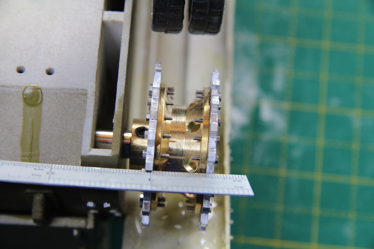

Ah, but what's this new problem. Can my eyes be deceiving me? (Actually, they often do these days.. :haha: ). Those sprocket teeth are asymmetric. When I was screwing all those tiny bolts in, I never noticed that..until now. How can that be? I assumed that this was a precision fitting, and all I had to do was screw it together. Hmmmph. :problem:
The tips of the teeth on one side line up with the middle of the 'trough' of the opposite teeth. The alignment is almost as bad on the left hand sprocket too..
Alignment totally out
For the moment, then, these pretty looking sprockets flatter to deceive. Right now, they're useless. :thumbdown: unless i've missed something...Think I'd better have a word with Chris.... :eh:

Ah mr 43rr you didn't read my build thread thoroughly enough! I kid ;) But I have been through this issue. I can't give you the geometric reason but both rings need to be in the correct positions to align properly. What you need to do is unbolt one side and progressively move it along one bolt position until you find the one where it aligns properly. Mine aren't 100% spot on but within a hairs width and all works ok!
