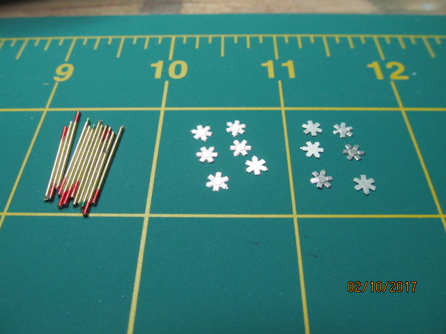

These first pics are of me making bolts for rear exhaust shroud covers, using brass rod and some ABER bolt heads.
Brass Rods & ABER bolt heads

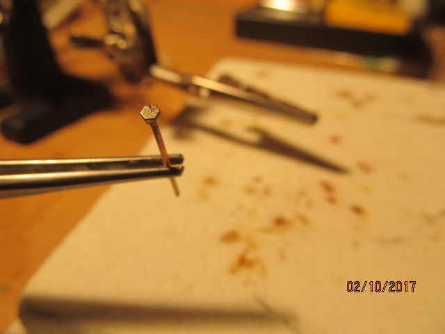

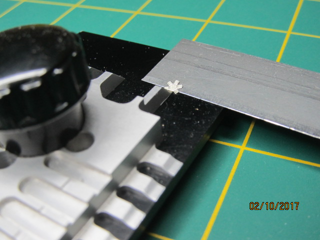

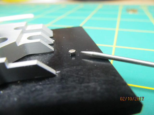

Bending ABER HEX Heads with brake
Completed HEX Head...now for 11 more...

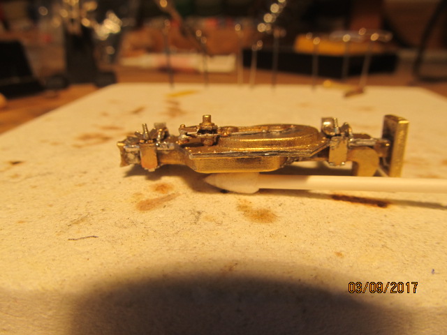

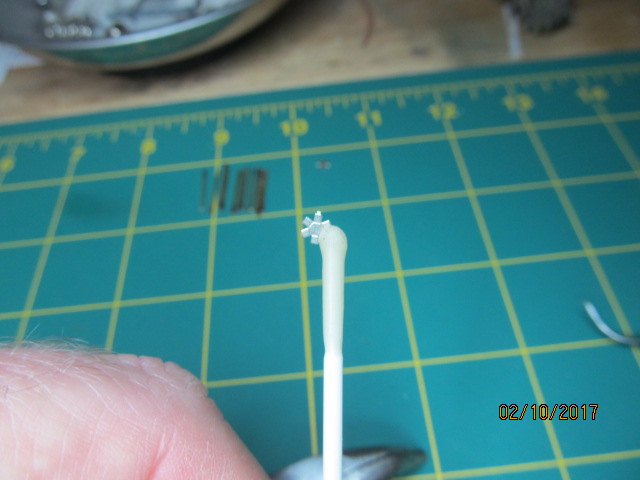

Using Pic-N-Stics helps with small parts

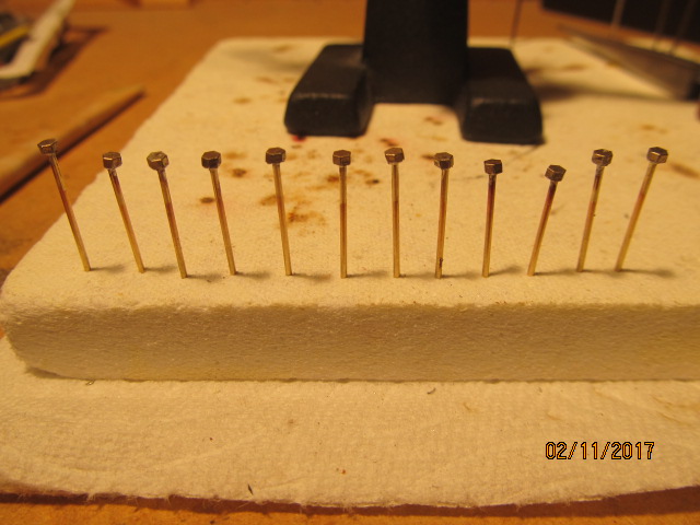

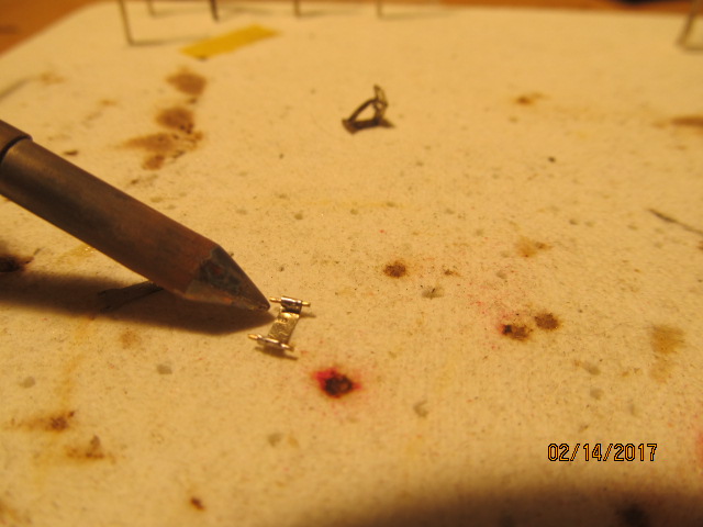

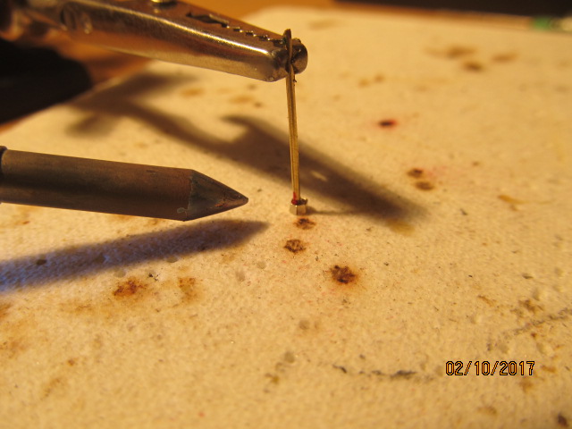

Soldering HEX Head to brass rods
All 12 HEX Heads completed. Will Install at later date.

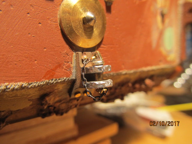

Attached retaining chain to rear hitch pin.

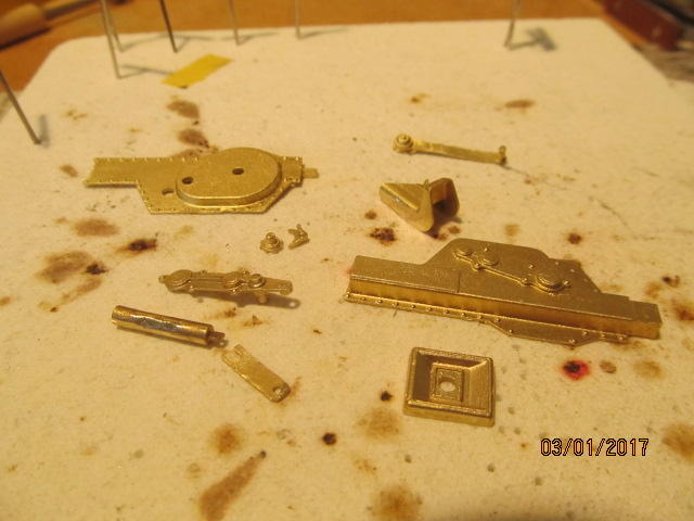

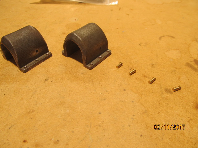

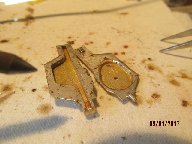

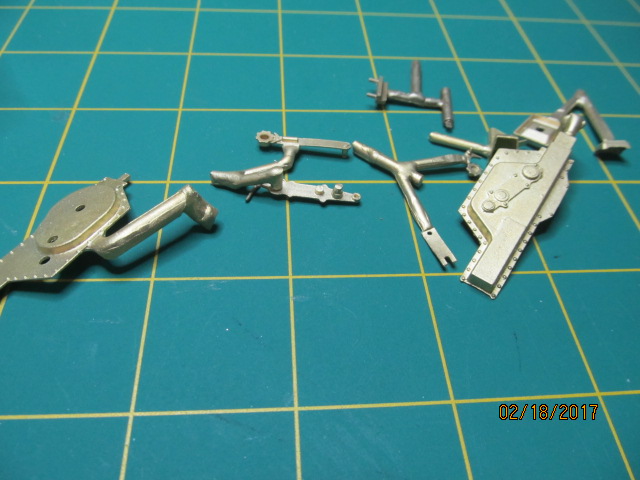

Here are some nice detailed cast parts from Aero-Mate. Exhaust protection pots.

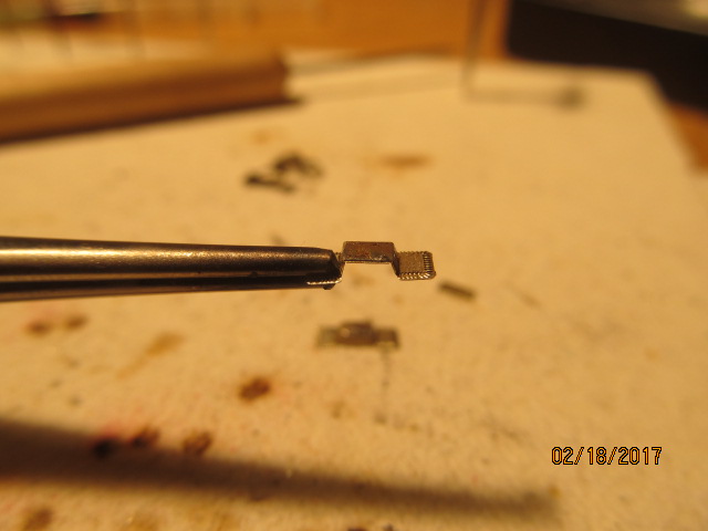

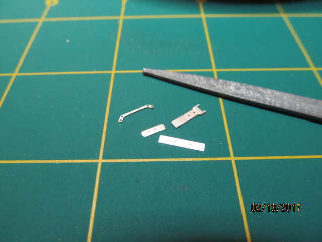

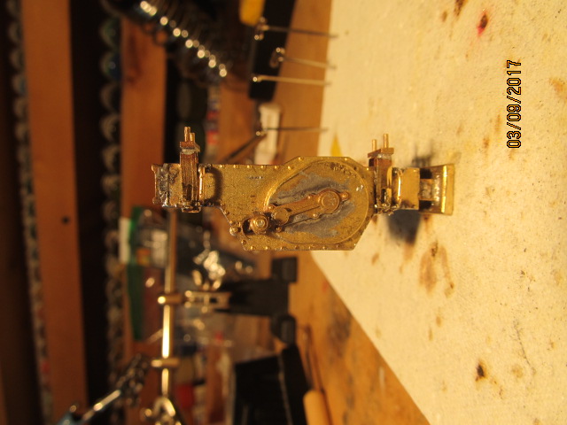

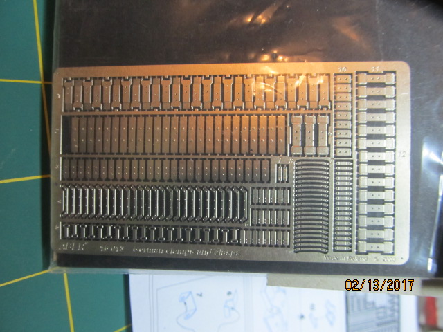

Next I put together some ABER german clamps for rear engine crank handle.

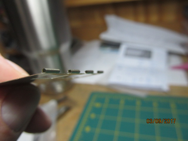

Annealing with a candle for easier bending.

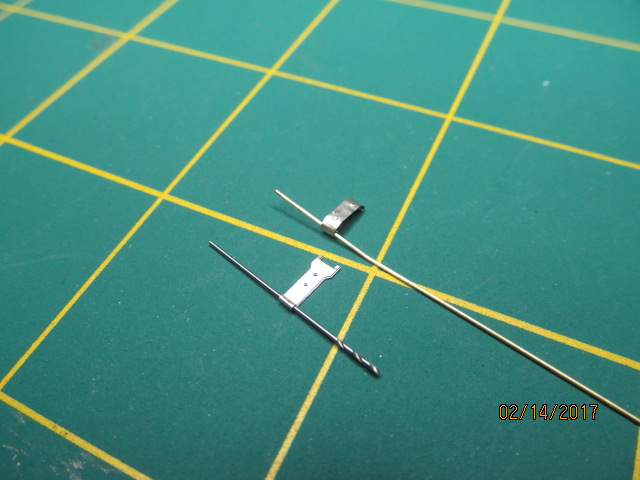

Using micro drill bits to roll brass around for hinge point.

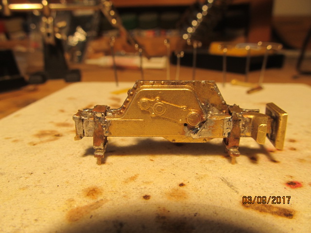

Soldering brass rod in place.

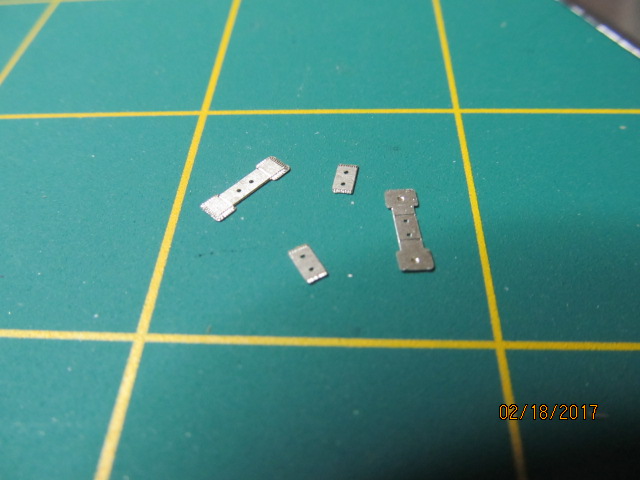

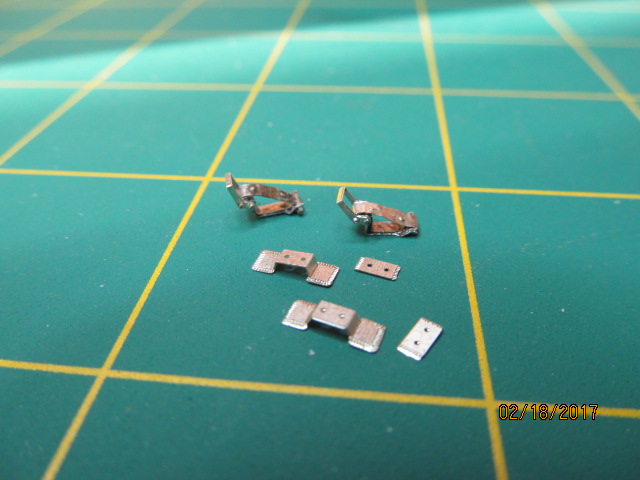

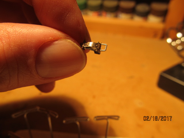

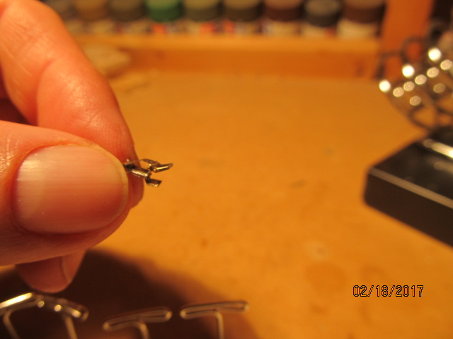

Cleaning up base plates for clamps.

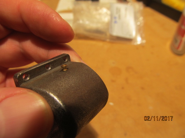

Base plates bending complete and clamps assembled.
Next I got a new rear jack, very detailed!

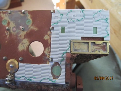

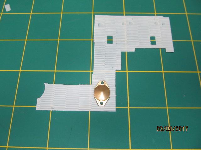

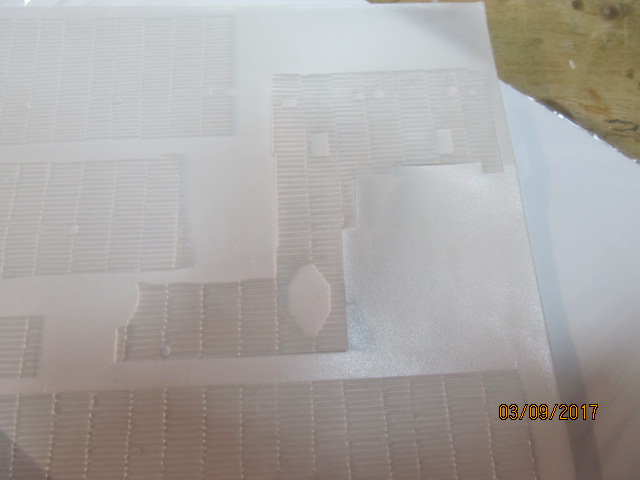

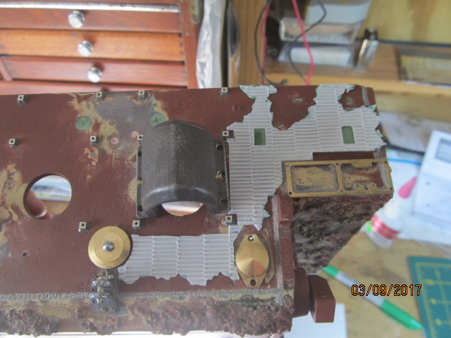

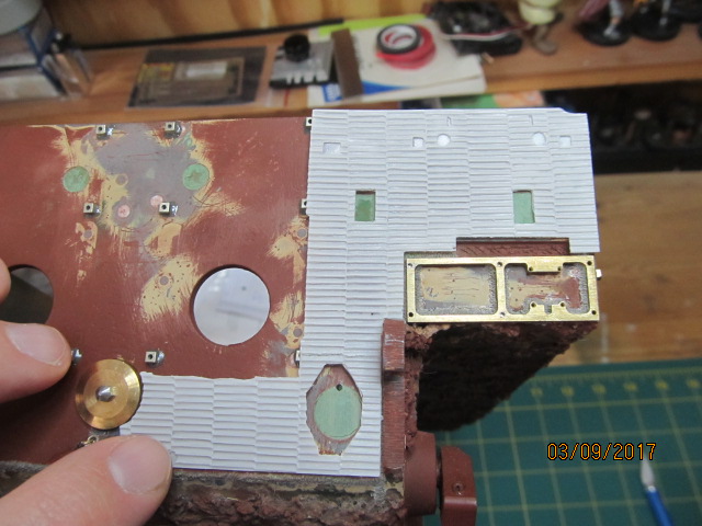

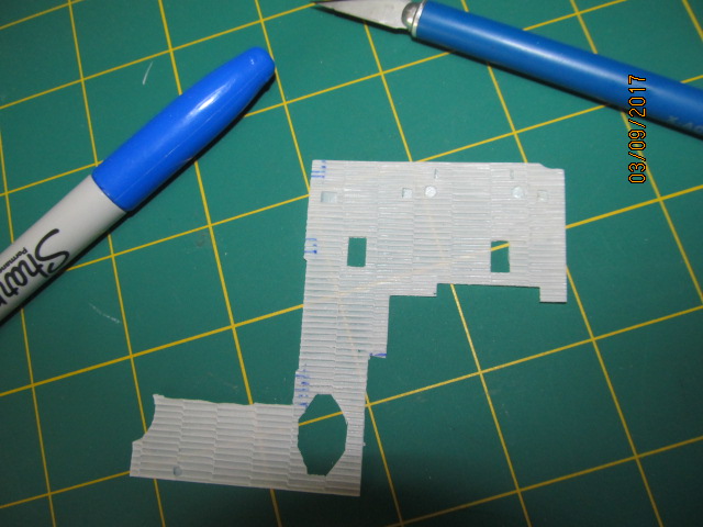

Next I custom fit Atek Zimmerit sheet to rear hull and trimmed around parts.
Trimming zimmerit sheet around idler adjustment cover.
Fitting to rear hull.
Marking cut out areas for exhaust shrouds.
Marking damaged Zimmerit.
Damage always adds some character.

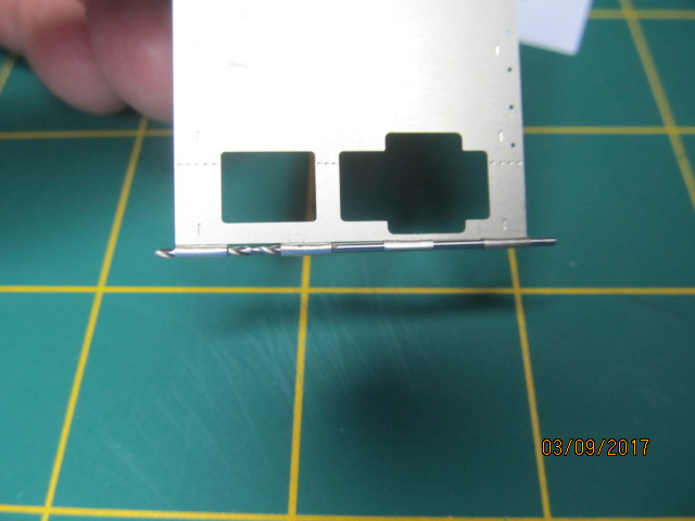

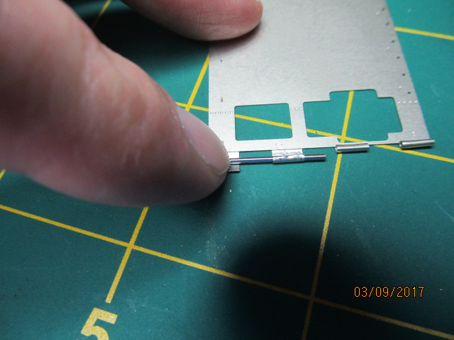

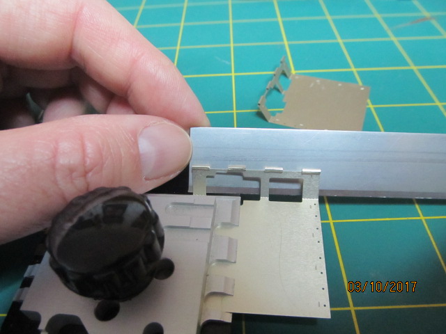

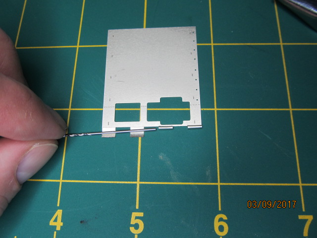

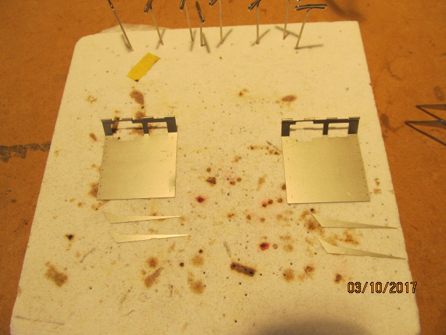

Next working on some ABER rear fenders.
Annealed these tabs and now rolling with micro drill bit.

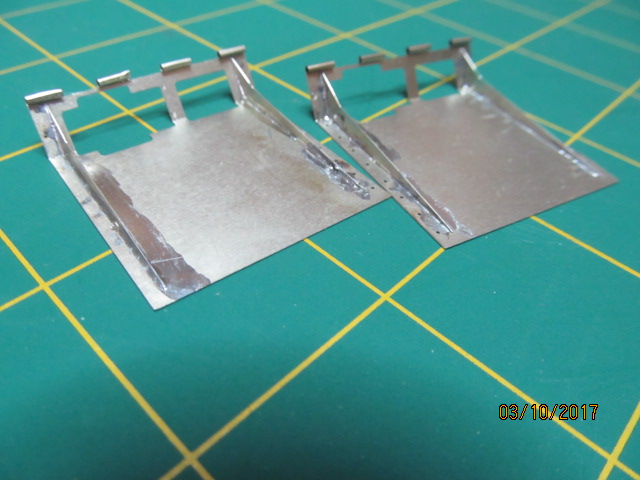

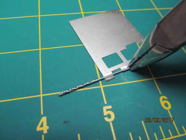

Bending mounting angle on brake.

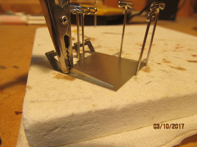

Soldering rear fender support fins in place.
Thats it for now...more to come, as long as I don't have another mishap!!! :thumbdown:
