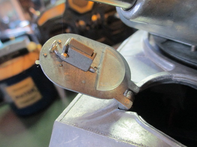

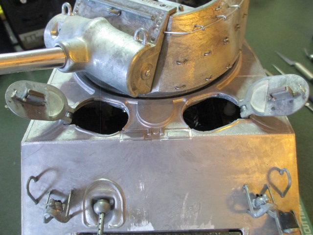

The quarter moon shaped black leather pads were installed on the undersides of the Driver and Radiomans hatches to prevent head injuries. They are standard on the newer large hatch design of the M4A3 Sherman which is why it was surprising to find them missing on photos of the M36B1( which uses the M4A3 Lower hull ) The M10 hull hatches are also missing any leather padding. Interesting...

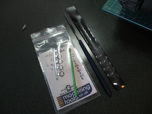

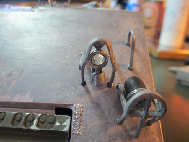

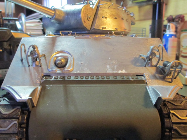

Last night was Laundry Night so I had little time to pursue detailing the M36B1. I did get enough time to file down the face of the headlight leds to fit a couple of neat lenses. I usually prefer Tamiya lenses for this but had ordered these new types last year. They have a chrome backing and look just like real light covers but some prep must be performed to have them work with back lighting. I was going to sand the chrome off but this would have left me with just a plastic lens ( ala Tamiya ) I decided to drill out a bulb space in the center of the backing that goes into the clear area. If I am right, once it is lit by the led behind it, it should act like a bulb in a car lamp and illuminate the rest of the clear lens. I'll see when I test. The back, red leds will get paint on the right hand lamp to make it into the standard rear blackout\convoy configuration once I am doing the detail paint. Pics:

Closeup of mounted headlight cover and lens

John, I'm crossing my fingers that they perform as I hope since they really do look good on the fixtures. Herman, I bought a Tamiya Diamond File to work with brass. It does a great job on this mystery metal as well. No issues drilling where needed tho' the standard Pin Vise drill bits are only used to make starter holes for the carbon tipped ones. To make up for the small amount of work performed yesterday, a great deal more detailing was done up tonight. ;o) Pics:

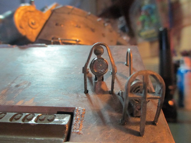

I found a spare HL .50 cal Infantry use base.

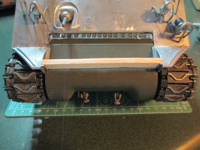

Glued and trimmed a couple of popsicle sticks to make a scale front board for stowage.  It will need a little staining and weathering.

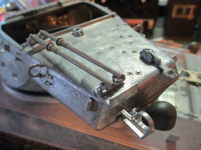

the rear turret barrel stowage rack as detail.

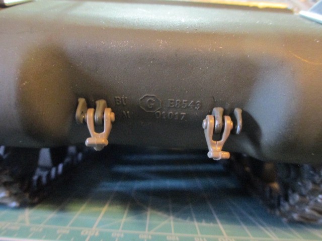

Used 1mm bolts and nuts with some fitted brass handles for the rear tow shackles.

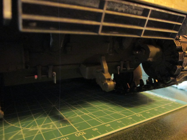

Rounded up a couple of Tamiya sets for the front tow shackles
Rounded up a couple of Tamiya sets for the front tow shackles.JPG (90.62 KiB) Viewed 2764 times
Both installed and awaiting paint.

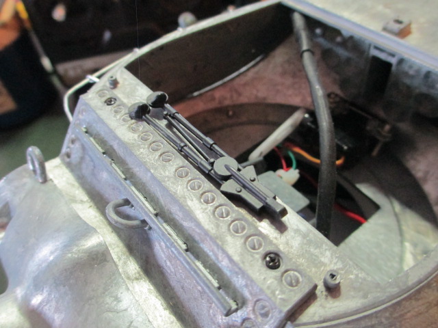

I went ahead with the leather 'pads'  using trimmed self stick dots to stand in for the pieces.

Some great work here Painless, and very informative (for me at least) too! I was wondering what was meant to be stowed on those racks on the rear of the turret - I Didn't think of the obvious of course, spare M.2 barrels (lucky for me I got one or two left over from the Tamiya sprues I pillaged for my M.2, I just need to source those shackles now! :D ). The leather pads on the hatches look good too, give a much more substantial and detailed look I think.
