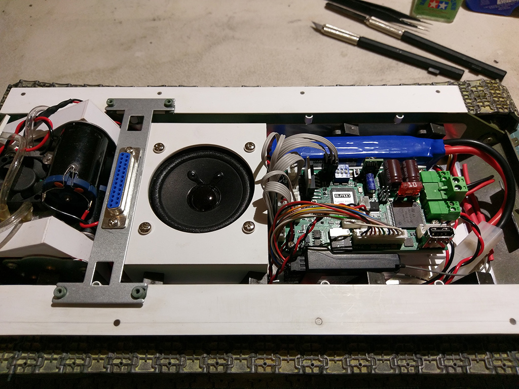

I've been too unwell to get any real work done on these tanks for the last few months, and only managed to start back about four weeks ago. I promptly drilled into my left index finger and couldn't do anything while the digit was bandaged, and now here we are. While recuperating I had one of those "good ideas" that's rapidly become more trouble than it's worth. I thought running all of the upper hull electronics through D-sub connector would be a good way to simplify the connection, since the upper hull needs to be removed to change the battery and refill the smoker. Fitting it to the quick-connect cross-member would allow it to help hold the upper hull in place. So far, so good.
However, in order to fit the plug there, the speaker has to move about 10 mm forward. If the speaker is moved forward, the Elmod board has to move too. If the Elmod is moved forward, it won't clear the power switches. You can see where this is going.
Now that all the electronics have moved forward, there's not enough room for the hull MG servo, so that's had to move down and left to clear the motor connections and battery. I'm running the motor, speaker and smoker wires underneath the suspension towers, kind of like a conduit. There's not a lot of room in the T-34 hull, I've had to make the best use of the space that I can. You guys with your Tigers and Panthers have got it easy!

Mr Raminator I've happened upon this wonderful build for the first time and I must say it's absolutely amazing! It's so well done
your wiring trick is a brilliant idea!
Carl
your wiring trick is a brilliant idea!Carl

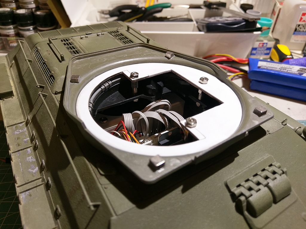

Cheers for the kind words lads, but the praise for the wiring might be a bit premature. While I've endeavoured to make sure that everything fit with the hull closed, I neglected to take the turret wiring into account.
