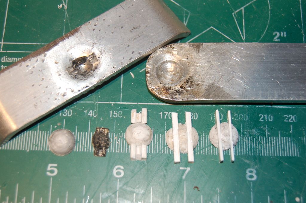

Should have read the rest of these before I started, used a variety of hammers (body repair) ultimately ground down a 7/16 bolt to use a punch in aluminum. Took a few tries (and cooking spray) to get it right, but heating the aluminum and pressing in the styrene gave a pretty good result. Have a bit of shaping to do on the hinge parts, but I think it'll work.

I think your make shift mold worked great! :D ....looks like you got nice consistent parts to work with....opposite from my technique ...probably why they got stuck in the mold lol....might work a tad better with the mold being cold...and the plastic hot :haha: ....plastic is petroleum based so has a tad bit of lubricative properties...and will usually break away easy from a cold mold....that's besides the point....as you have done well. :thumbup:
This puts you one step up on your brother....don't think he has ever done parts in that manner ;) ........... :haha: :haha:

Actually, still working on the armor covers. Tried a few attempts, waiting for the glue on my third batch. But thanks for the thumbs up. Will post a picture of what I come up with.

First one is a cover on a M4A3 we have in the Denver area. Second picture is my aluminum molds and several attempts. Granted, this is a relatively simple design, but it is kicking my rear of how to pull this off. Putty and sanding are still possible on these, but I'm not tickled with my starters.
