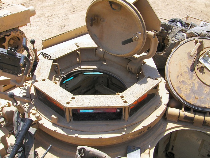

I chose this photo in my research...not for the detail for the cupola...but for the profile of the grab handle in the background
Image :D

Well I made a mistake about how the commanders 50 cal and copula work. The copula base, hatch and periscopes don't rotate.
The ring that the 50 cal and the handles are mounted on does. Just as in the picture you posted of the real thing when you were talking about the nonslip. When I looked at it, the fact that the 50 was off to the side while the copula was stationary didn't register forgive my brain freeze.
Now I will have to go back and redo mine to make it correct. Sure wish I had found this picture while I was doing my build.

This picture is from my research page.
Just like in the photo you have Giant...the Hatch is facing forward....and the gun is off to the side...reason I figured that ring could move
Thing is...I don't think you need to correct yours...the cupola does move...because in this photo
The armor plates have to be in the right position for the view ports to correspond to the lenses hidden behind them...the only way that can happen is if the cupola rotates ;)
Thought of making both the ring and the cupola rotate...but when I thought about it ...realized I probably wouldn't move them around that much ...especially with a figure in it...so facing the gun mount to the rear similarly to the barrel support on my Sherman just seemed like the logical solution :D

But notice that the hatch is still facing the rear and has not turned along with the 50 cal mount. On the M1A1 version the stubby little copula with its remote control 50 mount it rotated and the hatch and periscopes rotated with it. because to close the hatch which just fit into the space at the rear of the periscopes it had to.
I have not been able to find a Picture of a real A2 that has the hatch in any other position then the rear so my guess is that the 50 mount moves on its own ring built into the copula and the periscopes and hatch stay stationary so that the hatch can be closed at any time and it will fit behind the periscopes because neither the hatch or periscopes rotated, only the 50 cal mount and the grab handles are rotated. That's why there are no pictures if the A2 showing the 50 cal pointing straight backward.
That's the only conclusion I can reach unless I can find a picture or at least a description of how the A2's 50 cal is rotated that indicates the whole copula rotates.

greengiant wrote:But notice that the hatch is still facing the rear and has not turned along with the 50 cal mount. On the M1A1 version the stubby little copula with its remote control 50 mount it rotated and the hatch and periscopes rotated with it. because to close the hatch which just fit into the space at the rear of the periscopes it had to.
See under "120mm Gun Tank M1A2 Abrams" down the following link. No pic but has a description as to how the Improved Commander's Weapons Station works:
http://afvdb.50megs.com/usa/m1abrams.html
