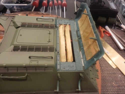

ALPHA wrote:Not bad deal on those hinges Herman :thumbup: ...did think you would hide the bases a little better ...but they work and that's what counts :D ...you got it to open wider than mine another good feature if you plan to do maintenance on the smoker and gearboxes
On the the vents ...yes indeed...good luck on those ;) ...you going to cover the two ..what looks like to be drain shafts under the body vents?,,,When I did mine ...I could find no photos of them open like they are on the model...so I closed them up ;)
Once the welds are put around the hinge sections, and paint applied they should blend in. There is a molded flat section full width of each hinge that I ground off, so the replacements are not to far off the plastic originals. The gap between them is bigger than I would have liked, but having the hatch fold all the way over to the exhausts might be handy.
The vent flaps were manually operated on the real machines, and these will need to be robust enough to move around when lubing the gear sets past them.
As for a tail light, by the last days of the conflict this would surely have been extinguished !
Yup...that tail light is something I overlooked...so it will have to be done during the redo....the two areas I spoke about are right above the vent opening..there are two V shaped openings under the engine vents on the body between the molded on upper hinges of that opening louver deck lid ...I'm not certain if Phil covered his...but it was something I couldn't leave alone...it's a matter of just cutting two V shaped pieces of plastic and bridging the gaps ;)

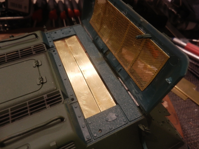

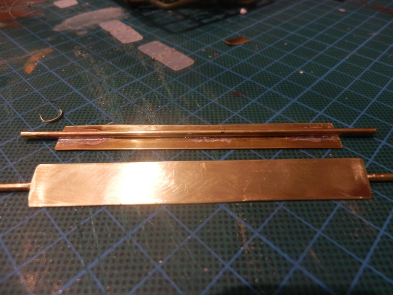

Ive got the louver flaps done just now. Used my solder paste for the first time. Jeez, where has that stuff been all my life ??!! :O
Brass joints made easy.
Plan to mount them under the hull with heavy plastic rails to allow rough handling during gearbox maintenance, a bit like the real ones might have been !

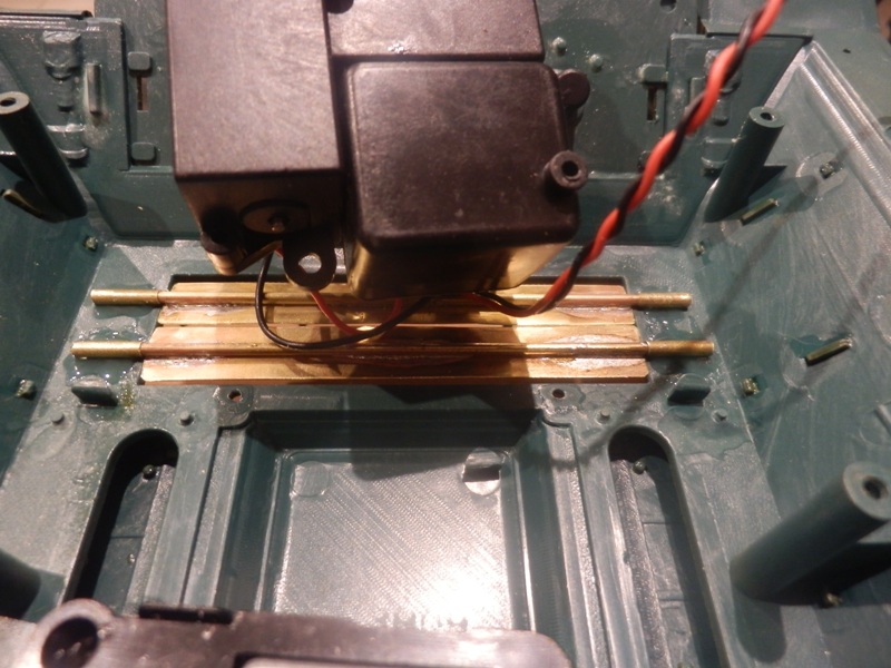

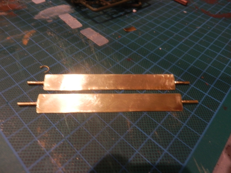

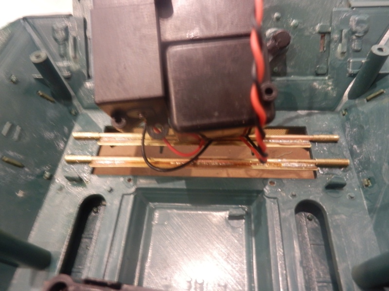

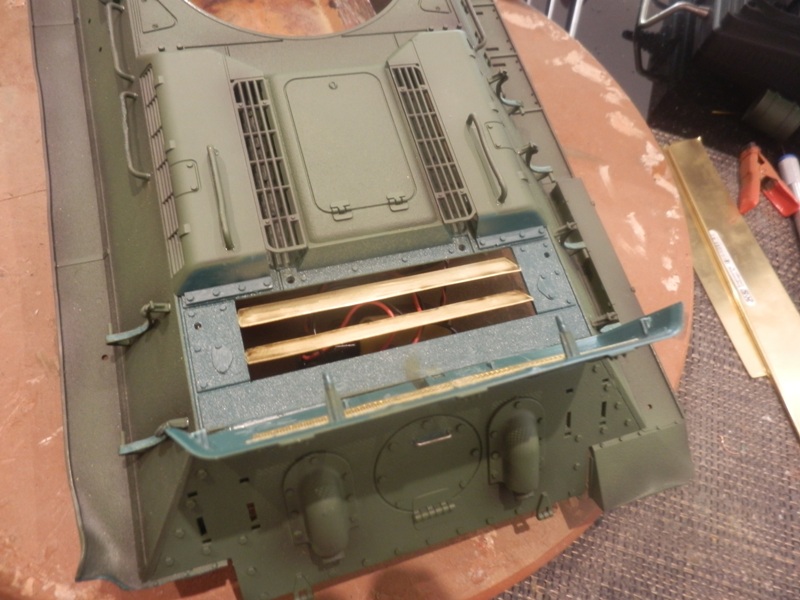

Louvers are done-ski
Used brass "toob" as pivot points for the louver blades. Put a small crimp in each one so as to allow tension in them to hold the position as placed.
They work spot on.
