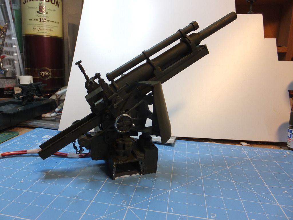

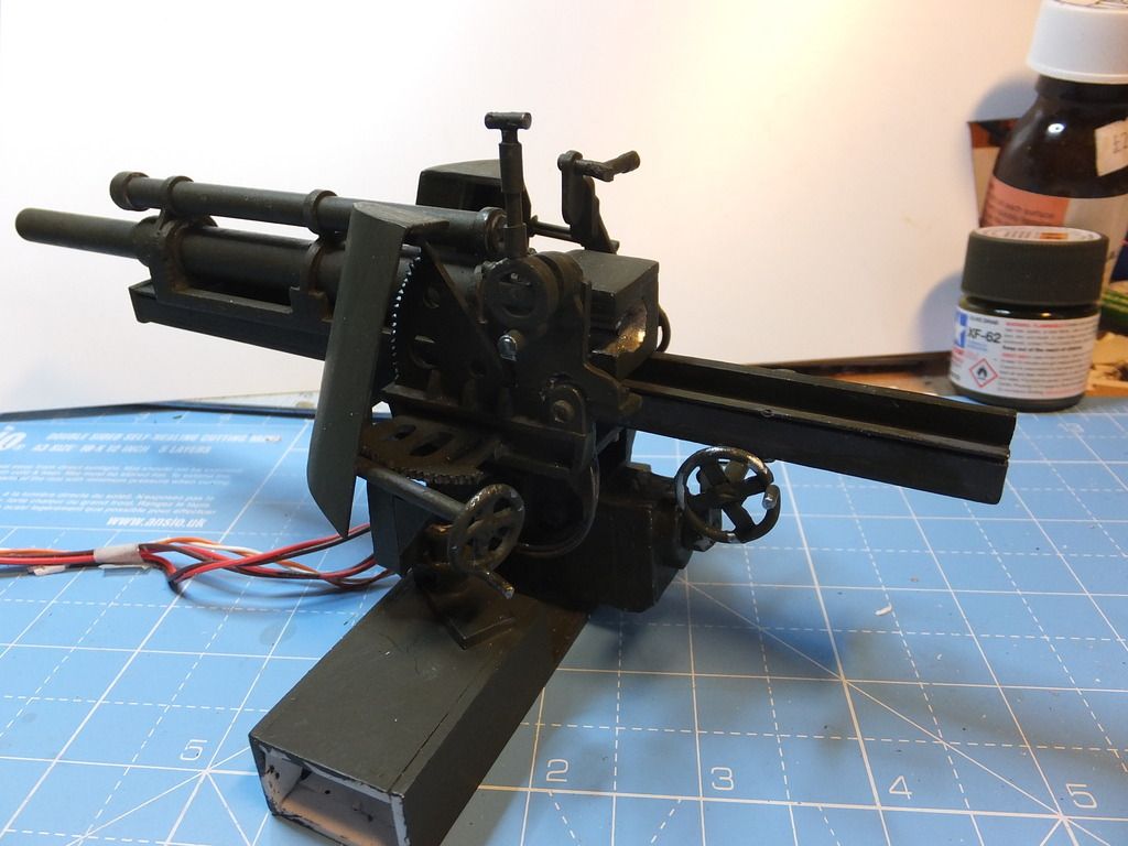

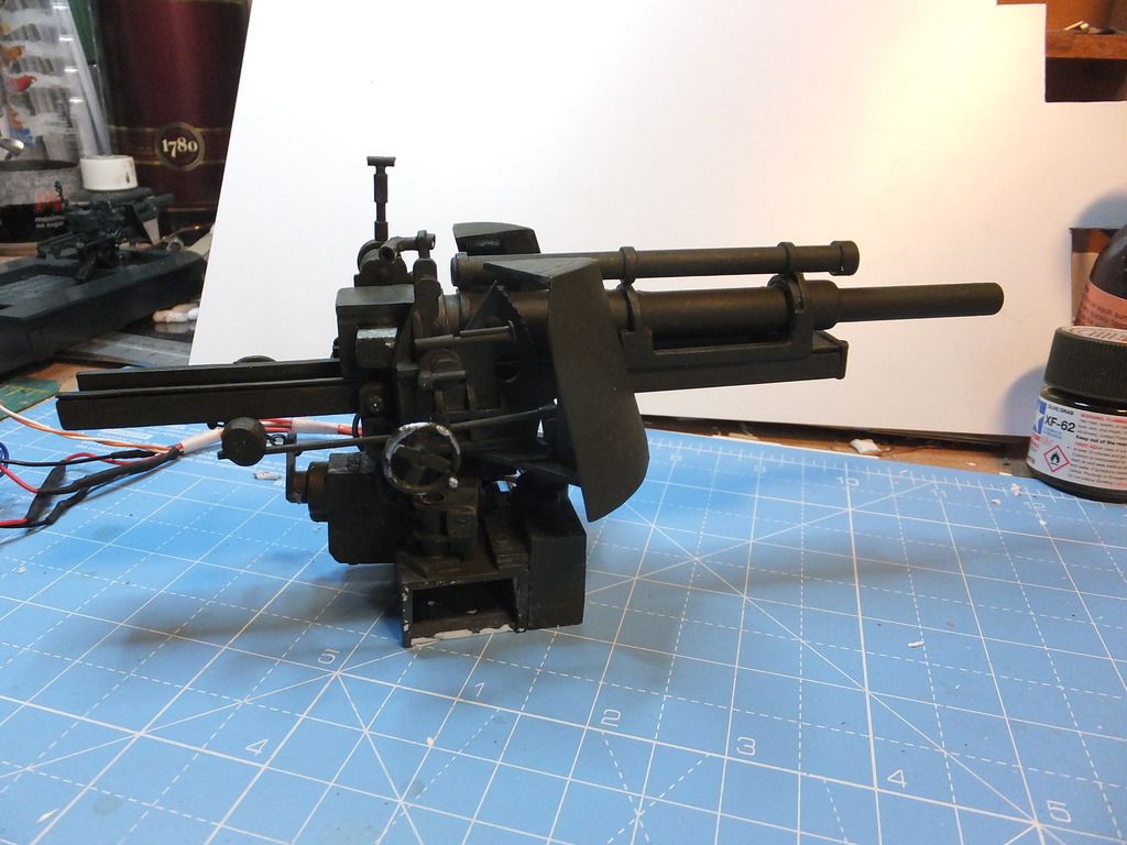

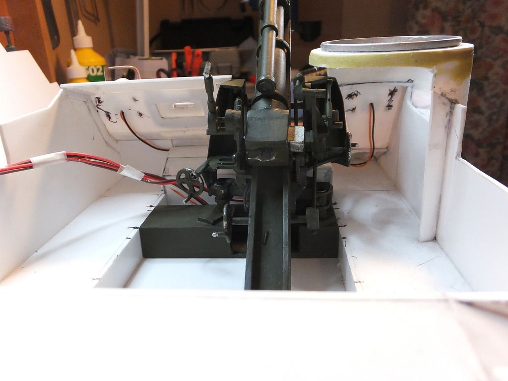

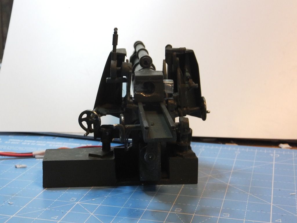

Progress report - I managed to get the electronics working and suspect a dodgy battery in the tank was responsible, as I charged up a new battery, connected everything, and it worked - much relief.
Finally finished and painted the gun. The gunsights and elevation mechanism were a lot of 'fun' but it helped having the 1/35 model to refer to.
Now to work on the mantlet and tank exterior before getting stuck into the cab area.

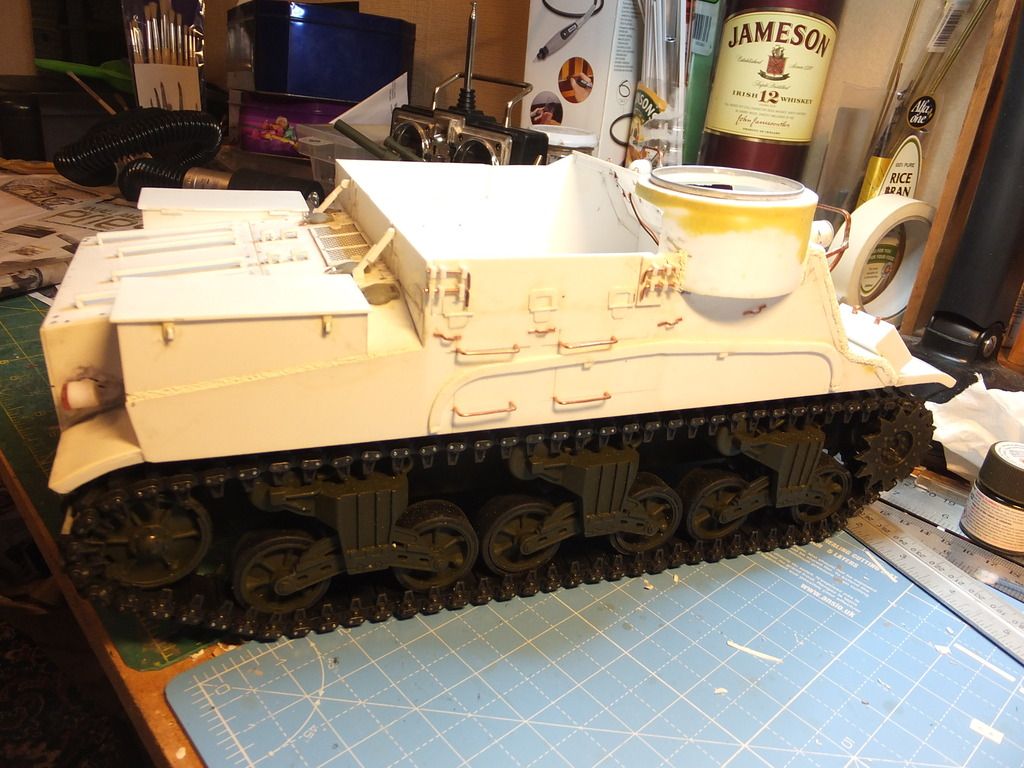

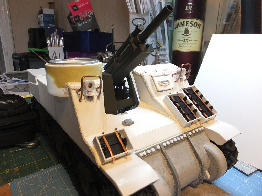

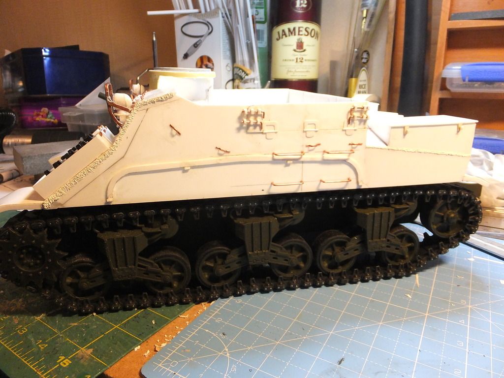

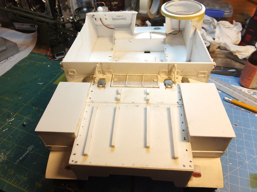

Re: M7 Priest scratchbuild
More progress on the exterior, just waiting for delivery of some hex section styrene rod for the bolt heads. I ordered it ten days ago but the dratted supplier sent it 2nd class and the post office have either lost it or gone into a coma! I'll just have to prime the completed bits and start on the cab while I wait.
Now for the primer paint.

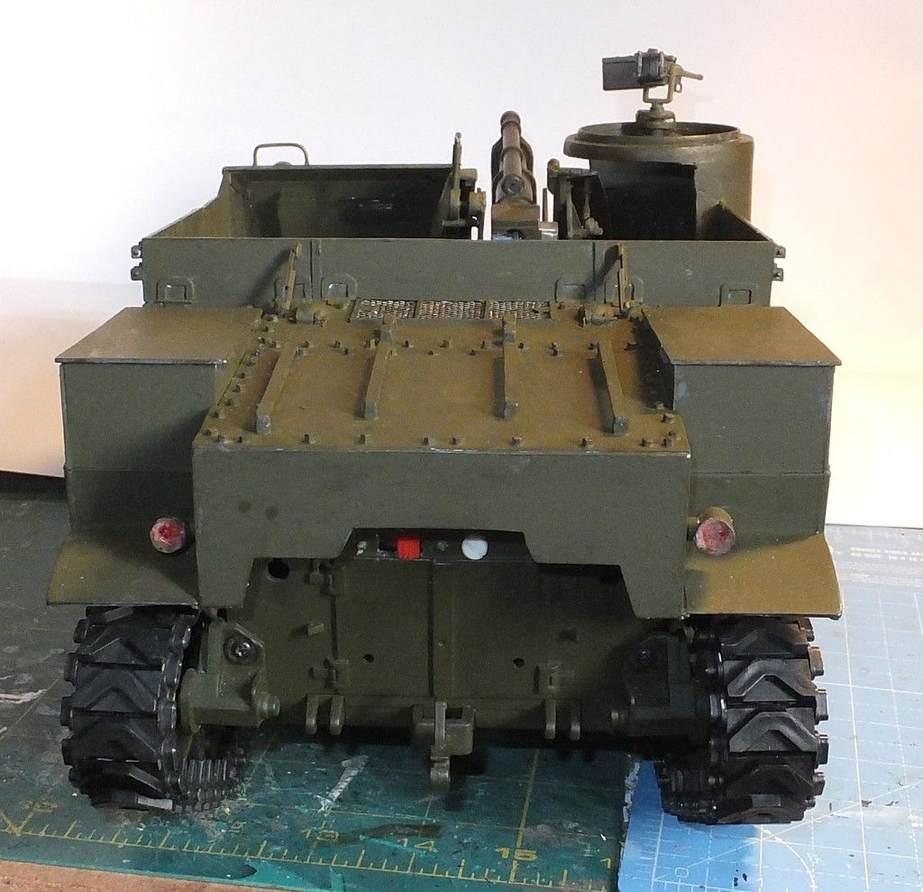

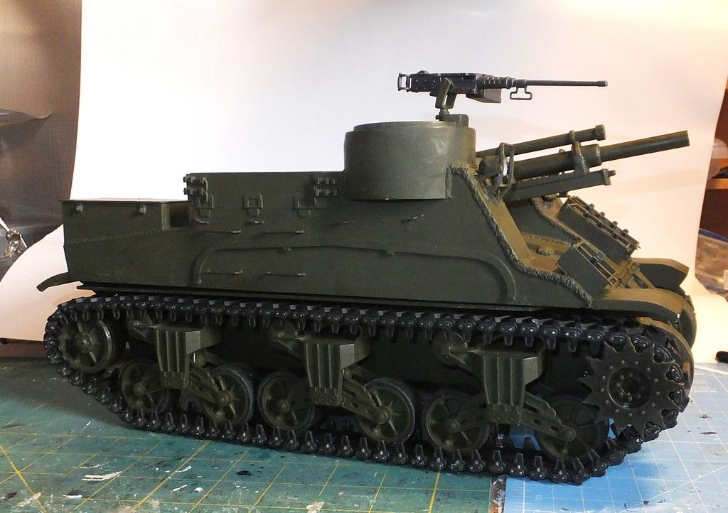

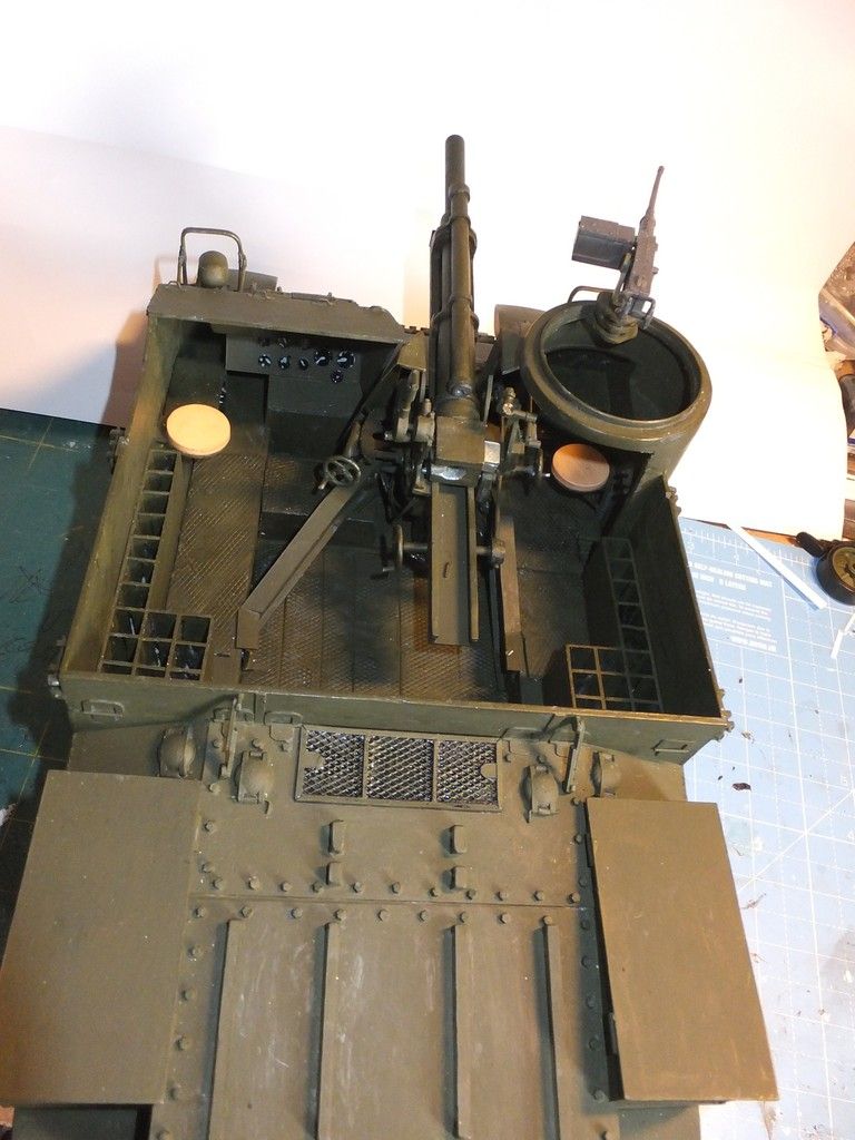

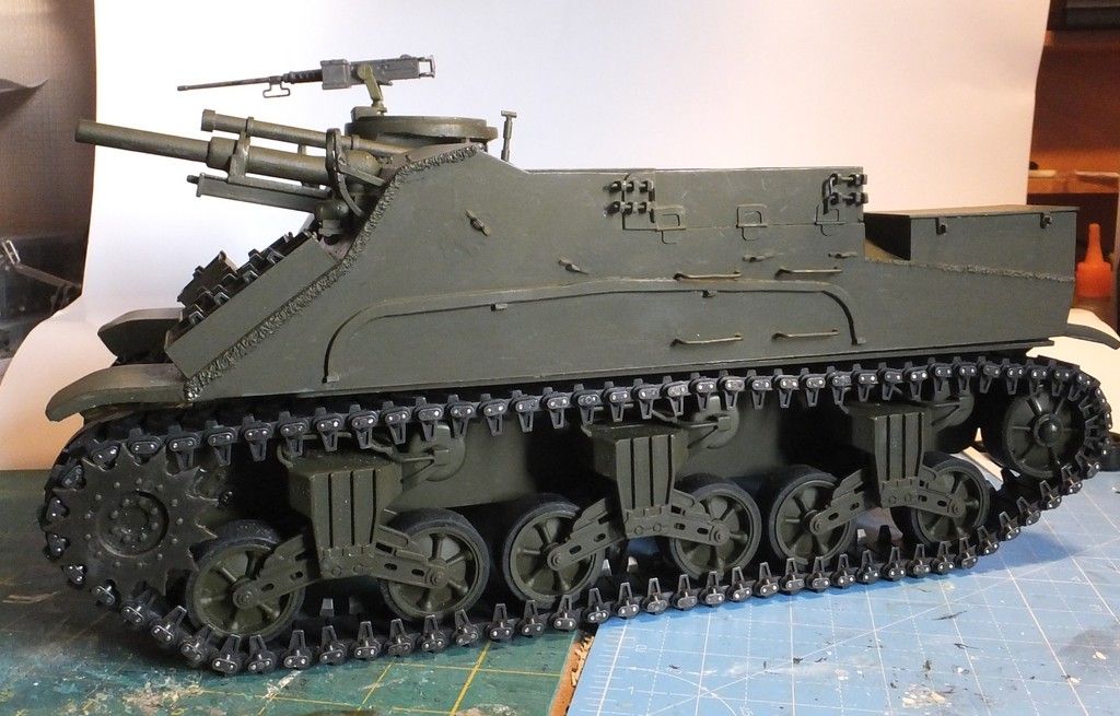

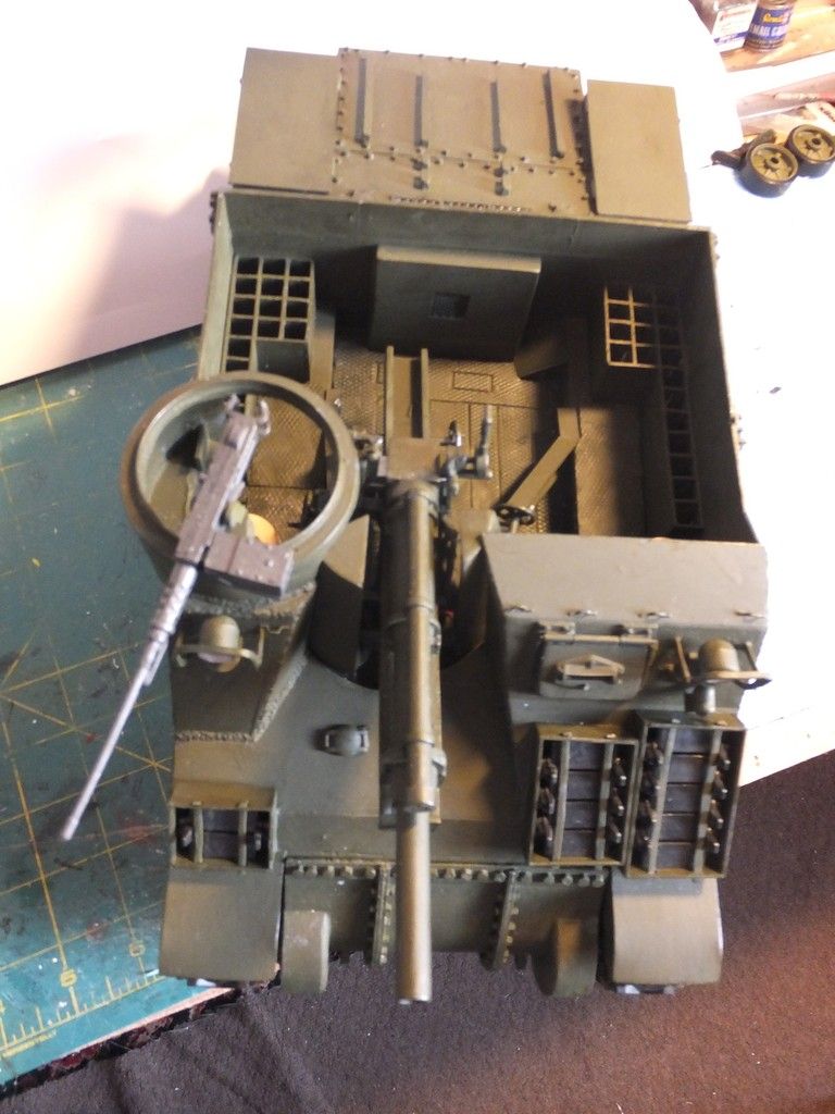

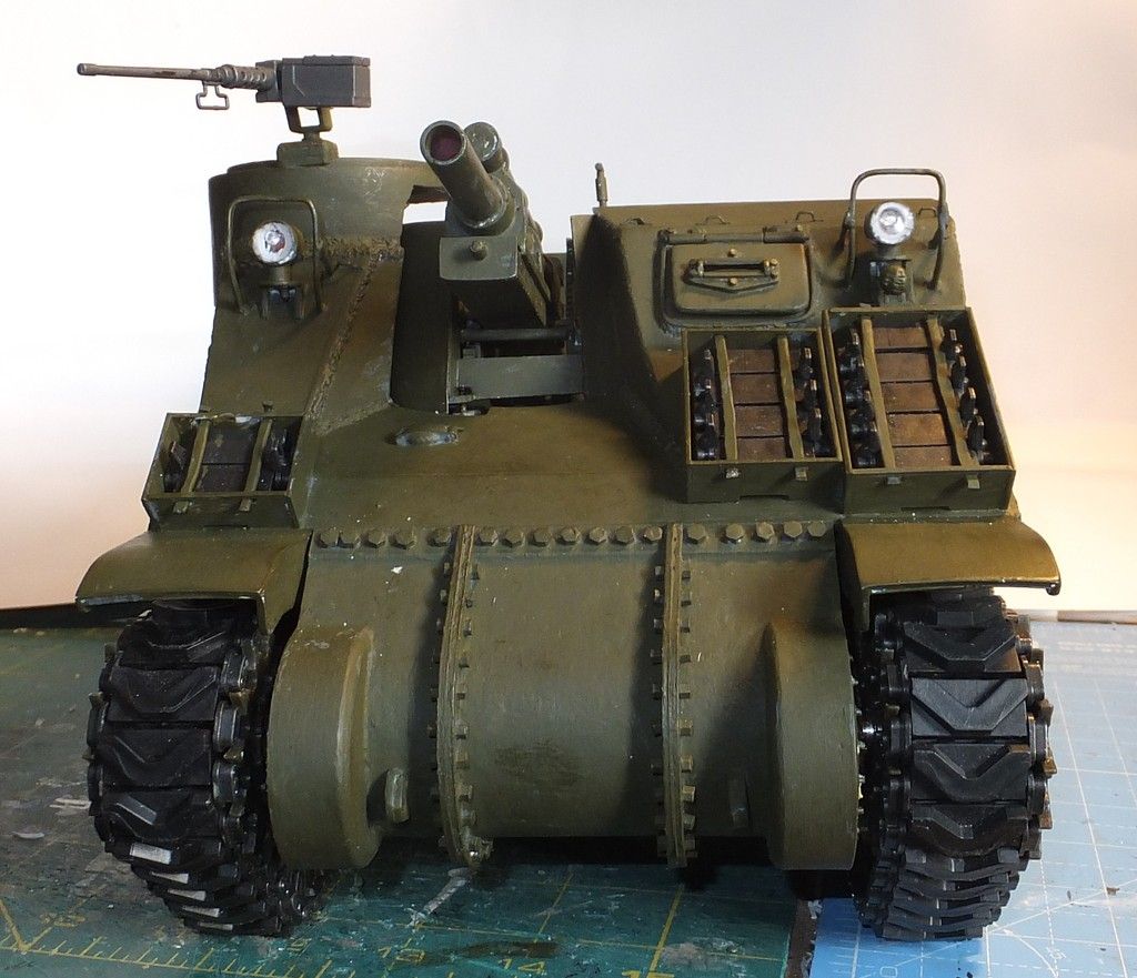

Well nearly finished. Some minor things still to do, tools to mount on rear, ammo to load, crew to paint, sticking gun slew to fix, another coat of paint and lacquer, but otherwise looking like an M7. I used Woz's suggestion on the diamond checkerplate with milliput and diamond mesh and it worked great. It also had the advantage of being able to impress joints into the millput as well (and also cost nothing but the milliput).
Should be at the MAD meeting tomorrow to give it a run.
