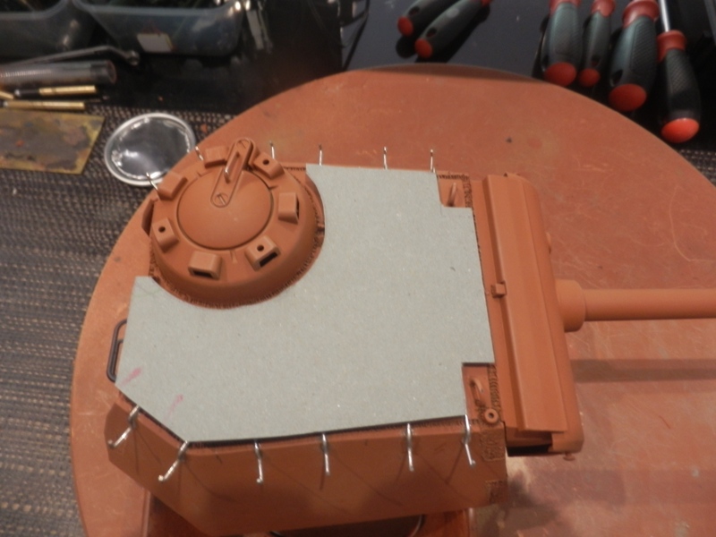

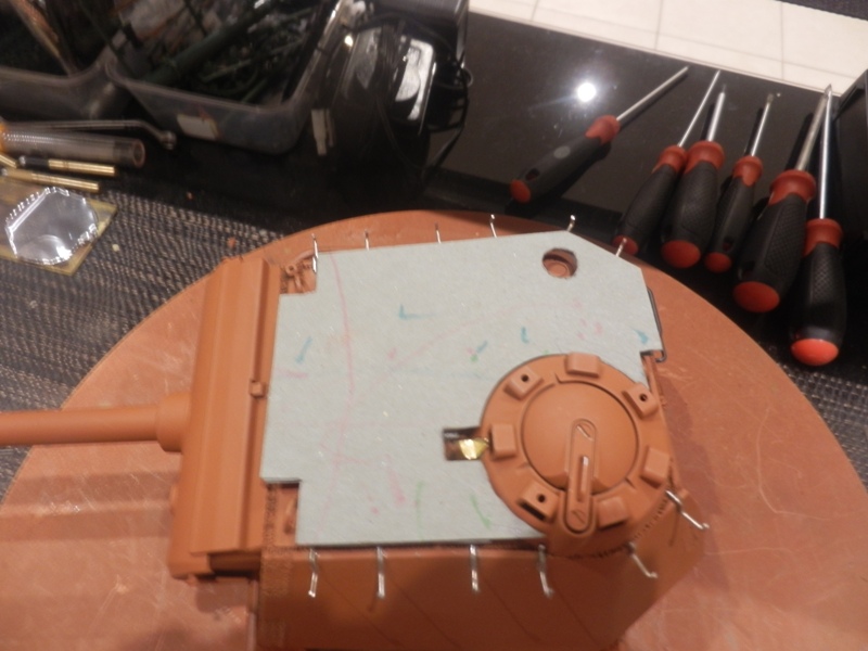

Mounted the commanders "rifle" gun sight & made up templates for the roof AA armour out of cardboard. Be great to just use those & paint them :/

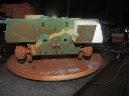

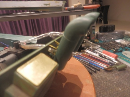

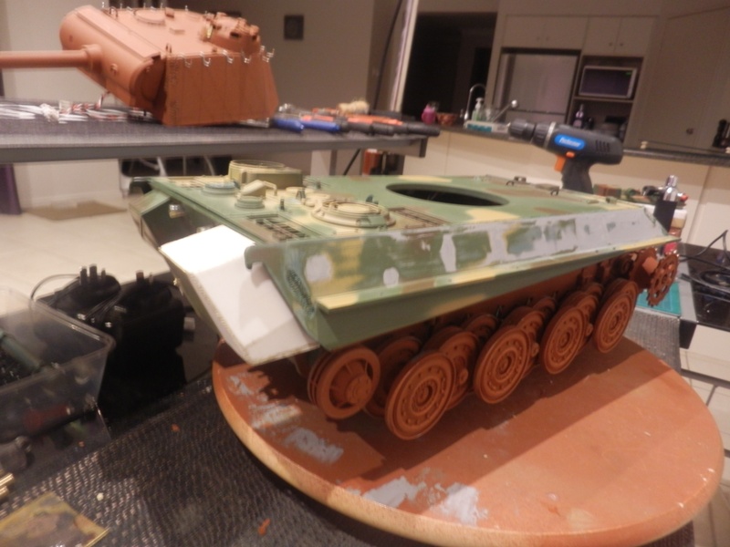

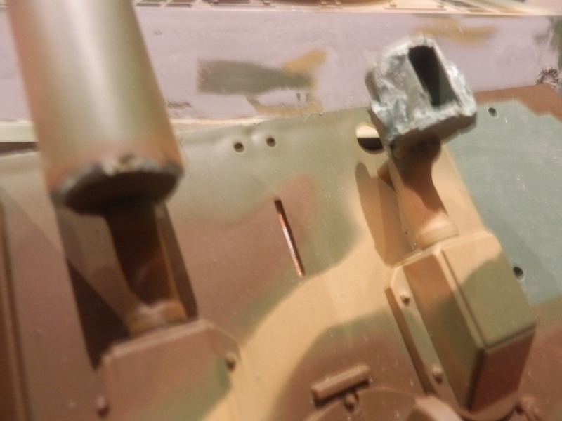

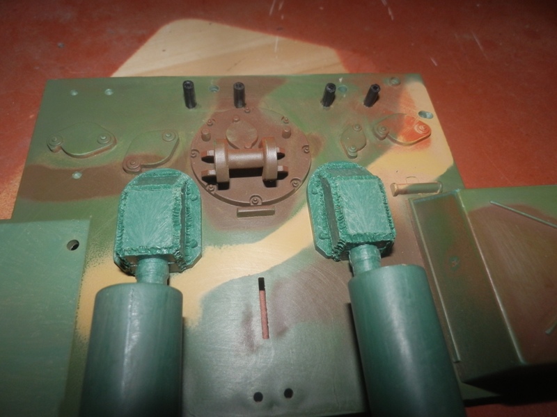

After the ill fated reno job on the exhausts to change the shrouds to hooded type, and the ole H/L glue monkey beat me to death, new replacement exhaust bases arrived for the grand total of $2.50 a pair. I had the new hooded shrouds already, so it was a ten second job to put the welds on the armoured covers & glue the shrouds on.

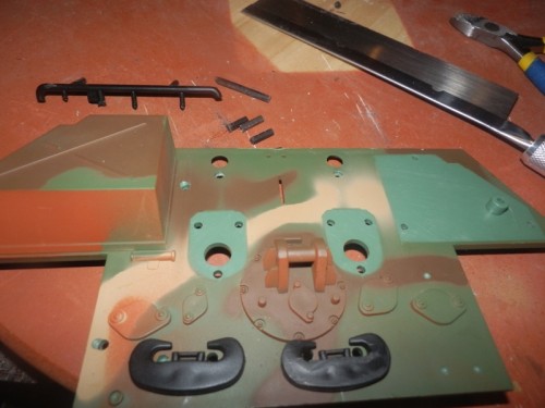

In the same box was my new rear plate. At $10 bucks, it was worth the cost to have the piece of mind to know I can make a balls up of things & keep on going.
Drilled holes to take sprue dowels that will carry the tow clevis hooks on the lower plate, also shallow drilled spots for the crank handle & track pin pliers so I can use the kit ones with no added hassles.

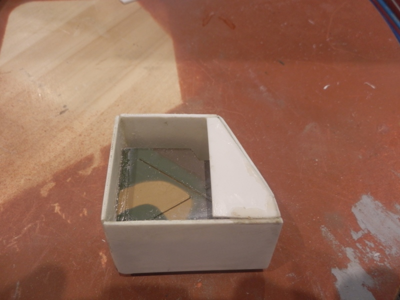

The armoured storage box for the night fighting hardware was an all together different story.
The literature all points to the fact that each night fighting Panther was equiped with a single system for the commanders cuppola only . Other references suggest there may have been as many as three systems (commander, gunner, driver) which really makes more sense to me given the difficulty of target aquisition, designation & simply keeping the vehicle on the path when moving.
I understand the 'Uhu" was supposed to be involved as part of a cohesive night fighting unit, but given the limited mobility & range of the Uhu IR searchlight, it would be far more effective to have the vehicles capable of unassisted combat.
My box has been constructed with the storage of three systems in mind. Just the single sytem lost the tank 3 rounds, so internal storage of three IR systems when not fitted would have reduced the combat effectiveness of the machine further.

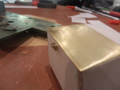

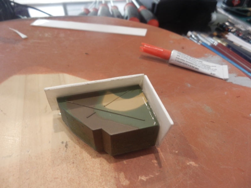

I used the original stowage box as both a support to the new one, and an obvious mounting device to make it simpler to get in the right spot.

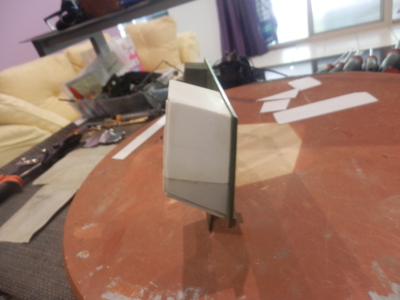

Cut up left over plastic sheet and set to work placing it around the bin as required to get the right look I wanted. All the joints were made "corner-to-corner" so as to allow weld placement.
Used poly-filler as weld material & the jewelers screwdriver to create the texture.
Brass door & lock group, no hinges as yet, and its done.
Cant wait to secure the hull & carry on with other more rewarding tasks :thumbup:

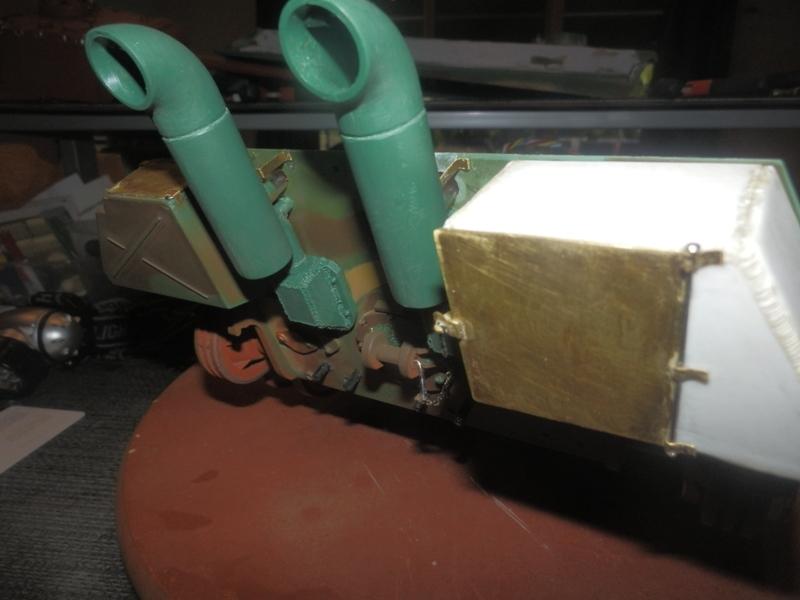

Thanks Lads, the detailing on the rear seemed to take ages for little real "bang" if you get me. But, happy with the result so far.
Still need to do welds where necessary and of course fit the tools in place once the paint is done.
The pin retaining chains on the tow pintle & C-hooks just did not play the game - :problem:
They are on, that will do them.
Same with the exhaust shroud brackets- pain in the ass :/ :-< simple, but annoying.
Made representative hinges for the Night vision hardware storage box out of brass sprue & a couple of shortened dress making pins. No need for the door to work, so no need to flog myself to do so ;)
Will use spare King Tiger engine deck grenade mesh screen material as the mesh infills on the hooded exhausts.
