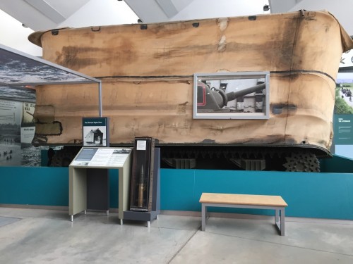

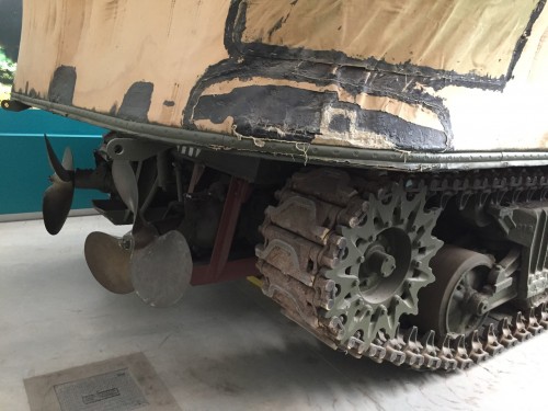

I'd almost forgotten a visit I made to the Bovington Museum a couple of years ago, Freddie. Here's a couple of pics of the DD tank they have there. There's a barrier around the tank, and this made it impossible to get a really. crisp picture of the drive mechanism. Still, it gives some idea of the arrangement.
I don't think I'd want to go to sea in this one; even with all those patches and glue. :lolno:
Bovington Sherman Duplex Drive
Sherman DD tank at Bovington- closeup of drive
Anyway, I thought you might like the pics.
Roy.

I like the pictures, Roy, thank you. I just noticed that the sprocket is in the rear on that tank. Did they also have a drive sprocket in the front?
Re: Sherman Duplex Drive...
Posted: Thu Nov 15, 2018 5:44 pm
by Maccrage
Yes. The rear sprocket was attached to the idler wheel to drive the propellers. But they found it wasn't needed, and tended to pick up packed sand and break/throw tracks.

by FredtheFrench
Hello Max.
The drive sproket is on front. For the rear it was only to help the tracks to not " slip" on the rear wheels. But after many tests, engineers says the rear sproket was not necessary because the tracks don't slip.
Only British army used the rear sproket, if you look the rear wheels on the Americans DD, there isn't gear wheel.
