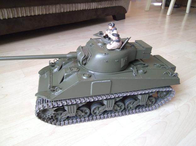

Fynsdad is just putting the finishing touches on his........for now..
Here's a pic
