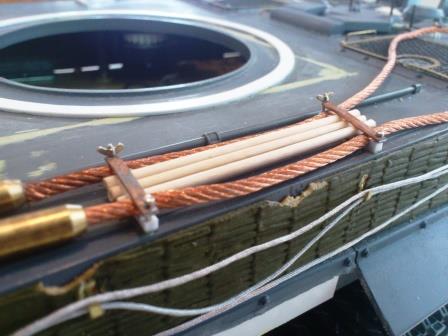

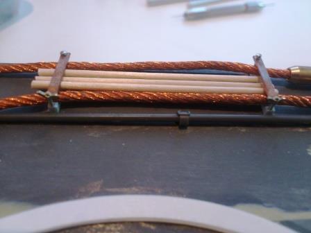

Mid hull clamps for towing cable and gun cleaning rods
The central cable and gun barrel cleaning rod brackets installed with Schumo butterfly nuts and temporary rods from toothpicks.jpg
The central cable and gun barrel cleaning rod brackets installed with Schumo butterfly nuts and temporary rods from toothpicks.jpg (30.55 KiB) Viewed 8283 times
The final part of the towing cable brackets present another challenge. With typical German ingenuity / complexity these also doubled up as clamps for the gun cleaning rods. The latter, consisting of six wooden rods connected by brass screw threads, were stored three on each side of the upper hull. Presumably the brush itself was one of the things stored in the rear turret stowage bin. Since, like the other brackets, I have designed these to be workable, I can leave the rods themselves to a later stage of the build. Mañana, mañana...
The lower part of the brackets was welded to the hull roof. This consisted of a thick strip of metal with five semi-circular depressions cut into it. The larger two on each side were to cradle the cables themselves, the middle three (slightly smaller) the rods. These were all clamped in place by a simple metal bar pivoted on the outer edge of the hull and secured by a trusty butterfly nut on the inside (see photos above).
On the HL (and Tamiya) TIgers the lower parts of the brackets come moulded to the hull roof. I wasn't sure they were in the right place (they certainly don't line up with the HL plastic combined tow ropes and cleaning rods) and they weren't very crisp - so off they came.

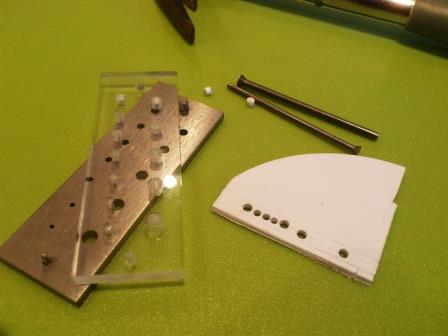

I then thought I would be terribly clever and make new ones using my trusty punch and die set. This is how I did it:
First I punched holes of the correct diameter - two big and three small - into a thick piece of plastic card.jpg
First I punched holes of the correct diameter - two big and three small - into a thick piece of plastic card.jpg (22.88 KiB) Viewed 8283 times
First I punched holes of the correct diameter - two big and three small - into a thick piece of plastic card. This was hard work for this thickness - and as an added bonus I managed to hit my thumb with the hammer. I seem to remember my dad doing this once back in the 70s (no he wasn't using a punch and die set to make clamps for a Tiger) - it was the first time I heard him swear. So I followed suit...

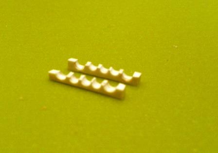

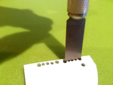

Next I used a chisel blade to separate each into two halves. That way you get two for the price (a sore thumb) of one. Note that the one on the left was a bit wonky so I had to do it again.
Next I used a chisel blade to separate each into two halves.jpg (20.47 KiB) Viewed 8283 times
A bit rough and ready - and blurry - I know but they will be mostly hidden when everything is in place.jpg
A bit rough and ready - and blurry - I know but they will be mostly hidden when everything is in place.jpg (17.51 KiB) Viewed 8283 times

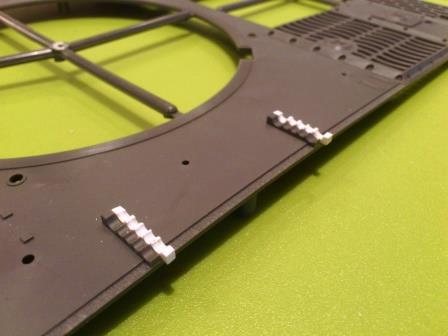

To make myself feel better I test fitted them against a Tamiya hull...
I test fitted them against a Tamiya hull.jpg (24.03 KiB) Viewed 8283 times
As you can see from the shot above the clamps should actually overlap the weld bead which runs around the upper hull, although mine clearly needed a little more trimming. Having looked again at the photos of the original Tigers above I have noticed that the gun cleaning rods must have had a larger diameter than the towing cables - it's the inner grooves in the lower bracket that are larger, not the outer ones. Oh well...

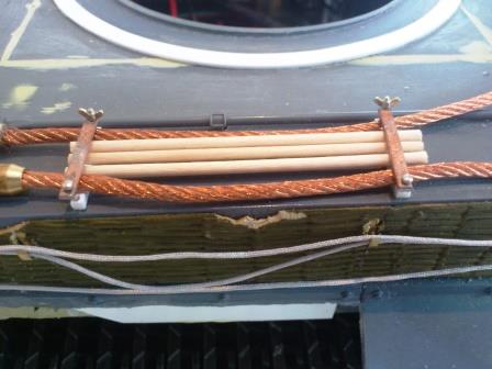

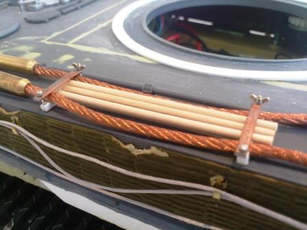

The rest, which followed my procedure for the rear clamps, was relatively simple. Holes were drilled through either end and into the hull after they had been glued in position. The outer hole accommodated a cut-down dress-making pin, the inner hole a Schumo screw and butterfly nut. Meanwhile the upper bracket was made by trimming a postage staple to length, drilling a hole in one end for the pin and cutting a slot in the other (using a fine rotary blade) for the screw. As I have already said, the Taigen ropes are a little too thick - so I expect them to sit better with the Schumo ones.
The central cable and gun barrel cleaning rod brackets installed with Taigen cables.jpg
The central cable and gun barrel cleaning rod brackets installed with Taigen cables.jpg (31.83 KiB) Viewed 8283 times
Another view - again the dress making pins come in handy. The missing mudguard beneath is work-in-progress battle damage.jpg
Another view - again the dress making pins come in handy. The missing mudguard beneath is work-in-progress battle damage.jpg (33.1 KiB) Viewed 8283 times
The view from the other side.jpg (22.5 KiB) Viewed 8283 times
