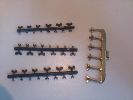

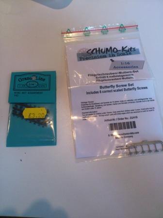

There are two ready sources I have found for these: Schumo and Grandt Line.
The Schumo ones I have already discussed above. They certainly aren't cheap, but the beauty of them is that they are long, metal and strong - so they can actually be used to clamp the wire ropes in place.
The Grandt Line ones come as part of an assortment. Confusingly they are stated to be 1/48 scale, but obviously some are the right size for 1/16. The only drawback is that they are plastic and come with no screw thread attached - making them vulnerable on a R/C tank. Still they might come in handy, e.g. if you are making your own C-hook clamps.
Grandt Line on the left, Schumo on the right.jpg (20.58 KiB) Viewed 8325 times

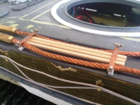

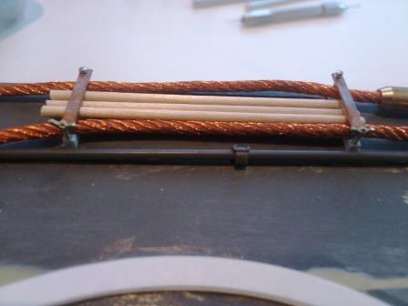

The central cable and gun barrel cleaning rod brackets installed with Schumo butterfly nuts and temporary rods from toothpicks.jpg
The central cable and gun barrel cleaning rod brackets installed with Schumo butterfly nuts and temporary rods from toothpicks.jpg (30.55 KiB) Viewed 8273 times

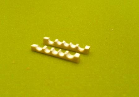

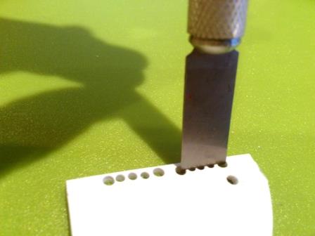

I then thought I would be terribly clever and make new ones using my trusty punch and die set. This is how I did it:
First I punched holes of the correct diameter - two big and three small - into a thick piece of plastic card.jpg
First I punched holes of the correct diameter - two big and three small - into a thick piece of plastic card.jpg (22.88 KiB) Viewed 8273 times
First I punched holes of the correct diameter - two big and three small - into a thick piece of plastic card. This was hard work for this thickness - and as an added bonus I managed to hit my thumb with the hammer. I seem to remember my dad doing this once back in the 70s (no he wasn't using a punch and die set to make clamps for a Tiger) - it was the first time I heard him swear. So I followed suit...
Next I used a chisel blade to separate each into two halves. That way you get two for the price (a sore thumb) of one. Note that the one on the left was a bit wonky so I had to do it again.
Next I used a chisel blade to separate each into two halves.jpg (20.47 KiB) Viewed 8273 times
A bit rough and ready - and blurry - I know but they will be mostly hidden when everything is in place.jpg
A bit rough and ready - and blurry - I know but they will be mostly hidden when everything is in place.jpg (17.51 KiB) Viewed 8273 times

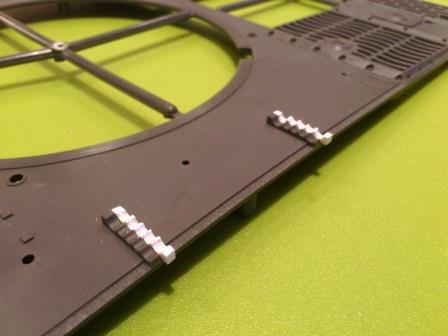

To make myself feel better I test fitted them against a Tamiya hull...
I test fitted them against a Tamiya hull.jpg (24.03 KiB) Viewed 8273 times
As you can see from the shot above the clamps should actually overlap the weld bead which runs around the upper hull, although mine clearly needed a little more trimming. Having looked again at the photos of the original Tigers above I have noticed that the gun cleaning rods must have had a larger diameter than the towing cables - it's the inner grooves in the lower bracket that are larger, not the outer ones. Oh well...

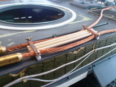

The rest, which followed my procedure for the rear clamps, was relatively simple. Holes were drilled through either end and into the hull after they had been glued in position. The outer hole accommodated a cut-down dress-making pin, the inner hole a Schumo screw and butterfly nut. Meanwhile the upper bracket was made by trimming a postage staple to length, drilling a hole in one end for the pin and cutting a slot in the other (using a fine rotary blade) for the screw. As I have already said, the Taigen ropes are a little too thick - so I expect them to sit better with the Schumo ones.
The central cable and gun barrel cleaning rod brackets installed with Taigen cables.jpg
The central cable and gun barrel cleaning rod brackets installed with Taigen cables.jpg (31.83 KiB) Viewed 8273 times

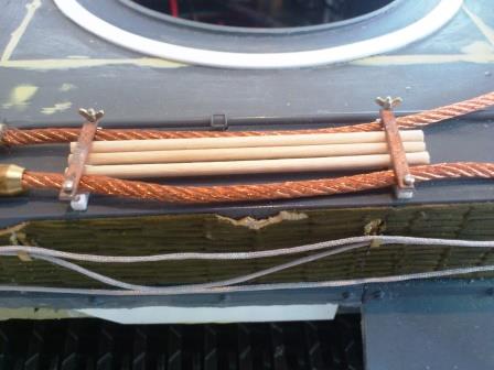

Another view - again the dress making pins come in handy. The missing mudguard beneath is work-in-progress battle damage.jpg
Another view - again the dress making pins come in handy. The missing mudguard beneath is work-in-progress battle damage.jpg (33.1 KiB) Viewed 8273 times
The view from the other side.jpg (22.5 KiB) Viewed 8273 times
So did I do it right?
Well, to be honest, having made the rear clamps since I think I could have saved myself a bit of trouble (and a lot of pain) by just using a round file (and a good eye) to carve the semi-circles into the lower bracket rather than using the punch and die set. Mais, c'est la vie!

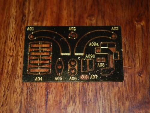

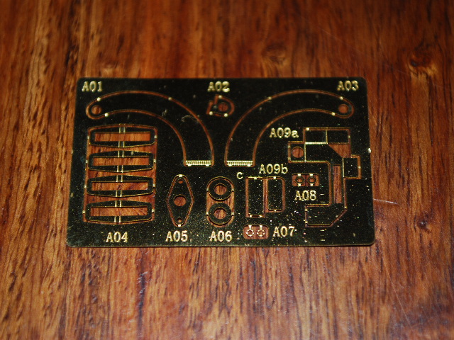

Just when I have finished most of the up-grades to my HL Tiger 1 - along comes this very nice looking photo etch up-grade package from Voyager.
Slightly bizarrely they say this is for the Trumpeter Tiger 1 - in fact it is clearly the Hobbyboss (Hobby Boss?) 1/16 Tiger - perhaps they are the same company. Of course it will do for HL Tigers just as well. It looks absolutely fantastic and, since it is by Voyager, I am hoping that it will be a lot cheaper than Aber as well as easier to put together (that is certainly true of their clamps).
It's not a complete up-grade answer of course - the turret spare track holders are not included (what you see are those which come with the Hobbyboss kit, which are barely adequate). Also, because the Hobbyboss kit has non-opening front and loader's hatches there is nothing to detail them. That's a particular problem for the loader's hatch because the Tamiya parts won't fit (the hatch is smaller) - so it looks as if the only source (for now) is the excellent PE detailing that comes with the Hachette Build Your Own Tiger (issue 4).
[Correction: having now purchased the Voyager sets I am glad to confirm that they DO come with the internal locking mechanism for the front hatches and loader's hatch - but you will still need to source the hand wheel and curved 'slam stop' bracket for the latter from somewhere else...]

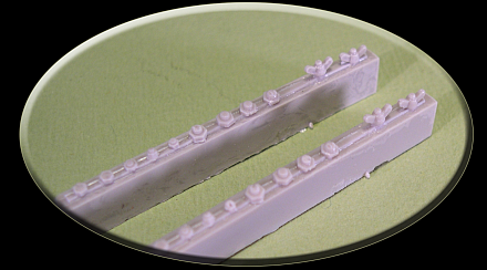

Just discovered another alternative from Panda Plastics. I don't think these are the same guys who have brought out the 1/16 38t, but I could be wrong.
Panda 1 16 German Nuts and Bolts Set.png (136.96 KiB) Viewed 8196 times
Anyway, according to their blurb: "Panda has started a new line of 1/16th scale super detailing products. The first in the series is a set of 1/16th scale German nuts and wing nuts that were developed in conjunction with the internationally known resin casting firm of Formations. A variety of different styles of nuts as well as the wing nuts enable the modeler to detail just about anything on a German tank from road wheels to clamps. 45 assorted nuts and 10 wing nuts in each set."
They can be ordered direct here: http://shermantracks.com/catalog/german_nuts_bolts.html
At $18.30 including postage to the UK they are certainly good value. It looks like the set will provide a good variety of nuts and bolts for Tigers and other panzers. Despite their name it is resin, not plastic. The butterfly nuts could be drilled to accept a wire bolt, I guess.

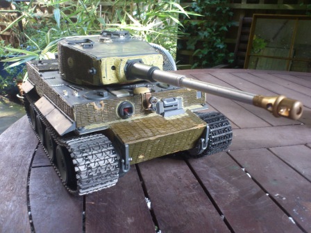

After finishing work on all of the cable clamps and mantlet fix my Tiger finally has a face again....jpg
After finishing work on all of the cable clamps and mantlet fix my Tiger finally has a face again....jpg (71.18 KiB) Viewed 8133 times
Well another Summer holiday has come and gone. I am painfully aware that I am approaching the second anniversary of the start of this build diary - but I have long stopped making false promises to my eldest son (who at least now has a 1/6 Stuart to keep him occupied) and myself.

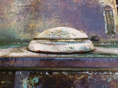

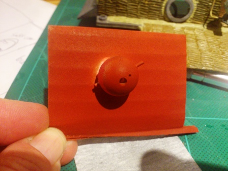

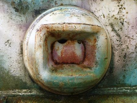

Replacing the armoured cover for the kugelblende (bow MG mount)
Front view of the MG mount on the Vimoutiers Tiger - taken a couple of months ago.jpg
Front view of the MG mount on the Vimoutiers Tiger - taken a couple of months ago.jpg (42.05 KiB) Viewed 8133 times
Top view of bow MG mount on the Vimoutiers Tiger.jpg (47.06 KiB) Viewed 8133 times

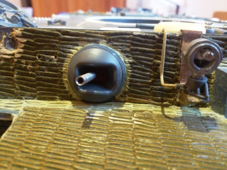

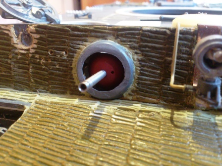

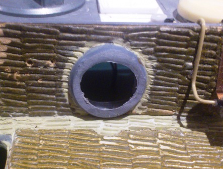

I dealt with scratch-building the ball mount for the the kugelblende ("ball shield") earlier in this post. However, having seen the real thing I realized that the external part of the HL part was lacking in definition. Basically there should be an obvious recessed join around the rim of the armoured shield - on the HL one it is only a vague indentation. On the actual tank this was another legacy of the submersible capability of the early Tiger 1s (e.g. the one at Bovington) - a rubber cap was clamped over the aperture.

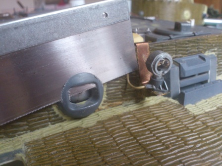

The old HL armoured cover for the kugelblende just had to go....jpg (64.49 KiB) Viewed 8133 times
The aperture was then enlarged to take the Tamiya part.jpg (66.38 KiB) Viewed 8133 times
Cutting off the HL part was simple enough with a razor saw - but would have been a hell of a lot easier had I done it earlier! The hole was then enlarged and the Tamiya part glued in place. My old plastic ball mount still fitted snugly behind it and I also took the opportunity to spray it a more convincing red primer colour.
I took the opportunity to respray by home made kugelblende the appropriate shade of red primer.jpg
I took the opportunity to respray by home made kugelblende the appropriate shade of red primer.jpg (67.8 KiB) Viewed 8133 times
The ball mount back in place ready for the Tamiya cover to be fitted.jpg (89.84 KiB) Viewed 7837 times
The Tamiya kugelblende armoured shield in place.jpg (93.94 KiB) Viewed 8133 times
