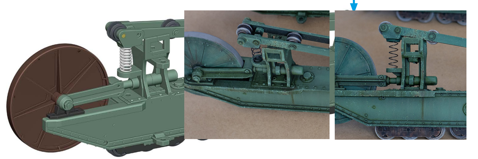

If it's your first model and you don't have much experience with scale modeling, I would recommend focusing on building it as it is. For some intricate small parts, you need an SLA resin printer.
I'm not doing 'rivits counting' but still trying to match model to real prototype as much as reasonably possible. You probably wouldn't notice the difference between my mods and the original model.
Can you see much difference between the model and the photos? :)

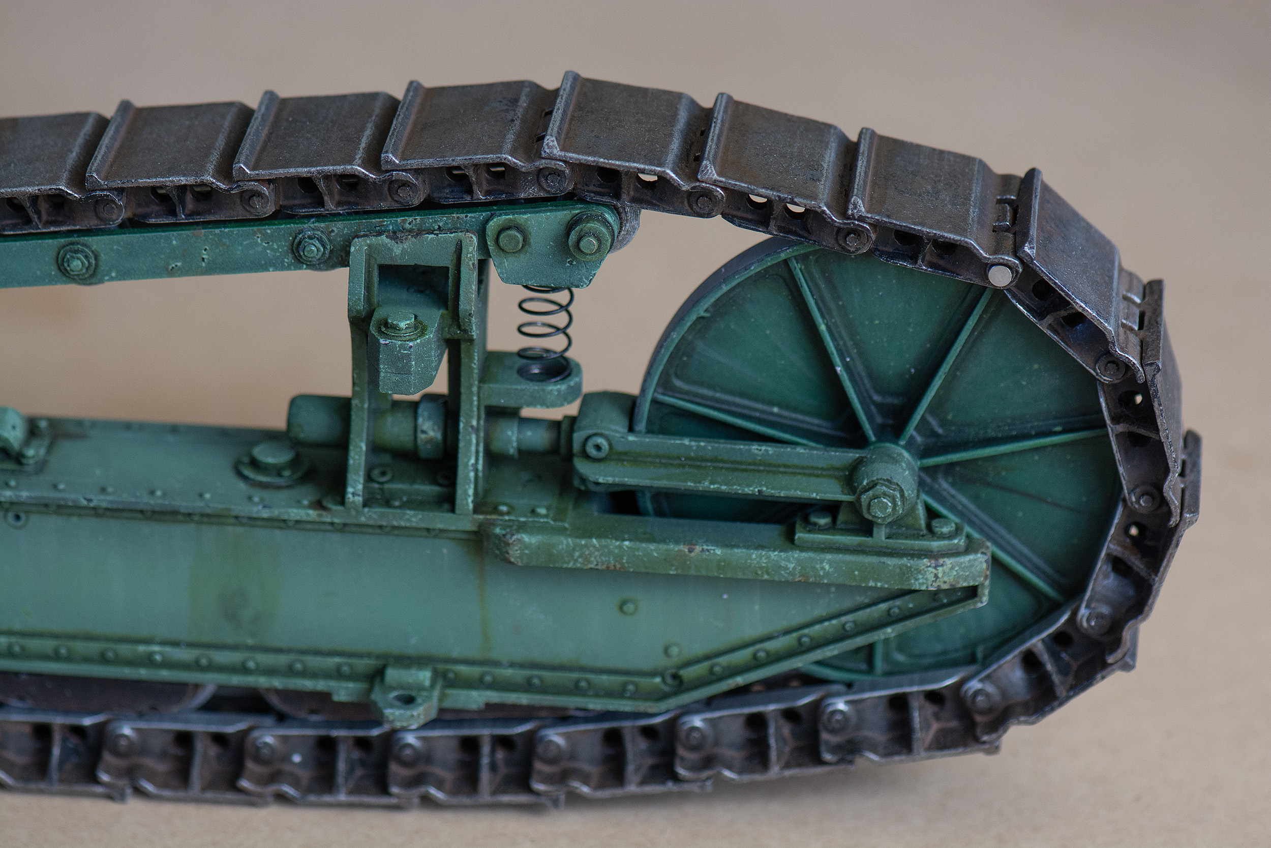

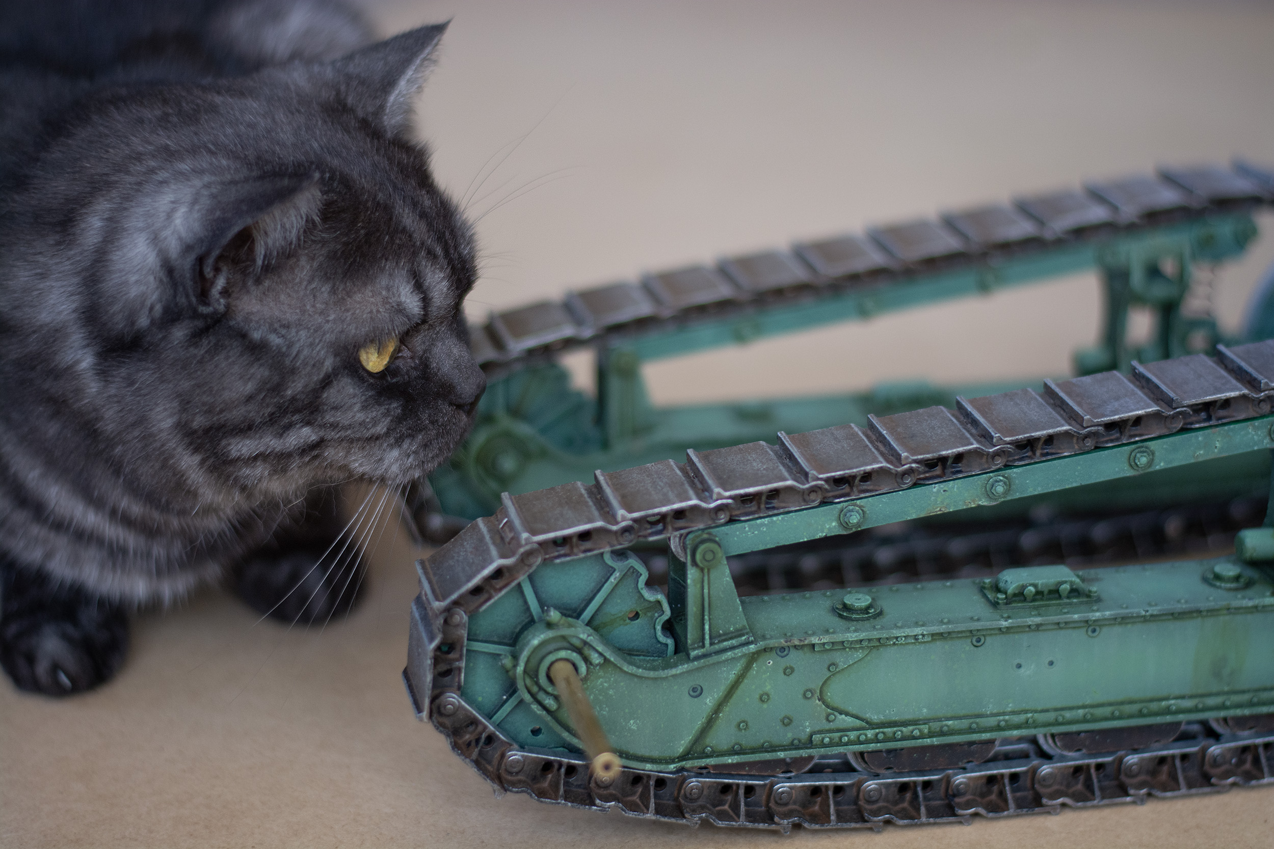

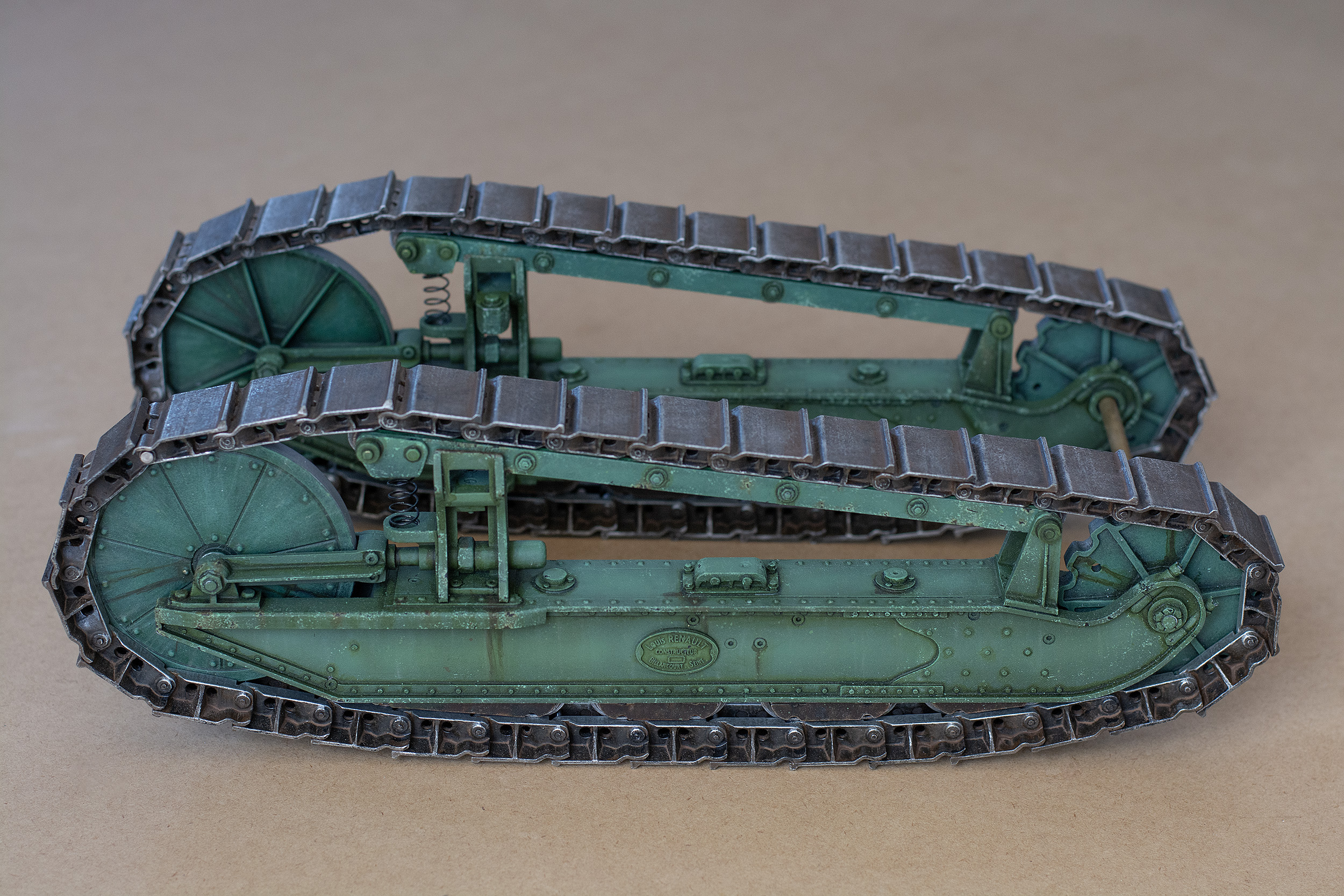

Drivetrains are fully assembled, so I can now focus on finishing the hull.
DSC_1667 copy 2.jpg (1.48 MiB) Viewed 358 times
DSC_1663 copy 2.jpg (1.37 MiB) Viewed 358 times

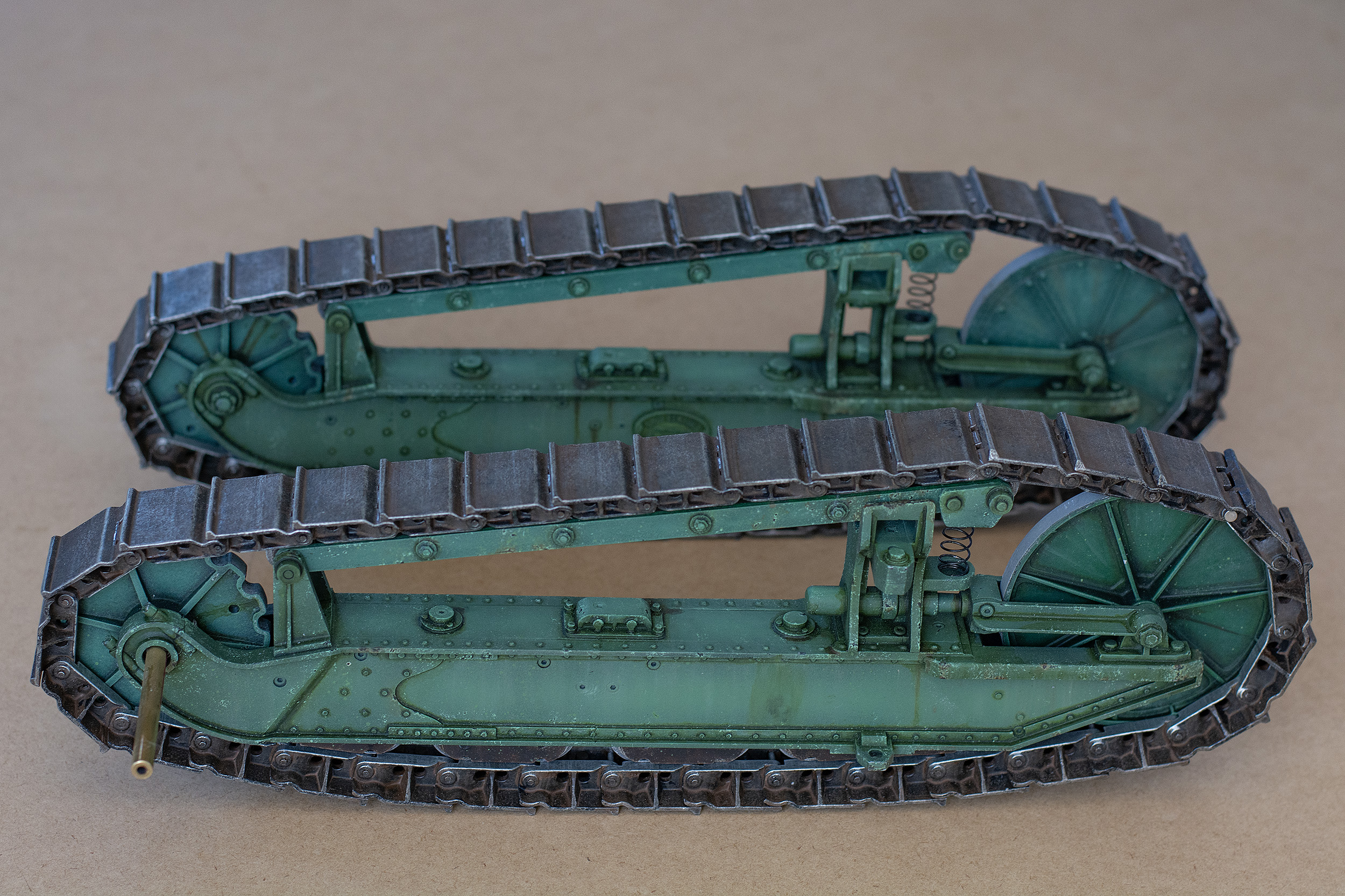

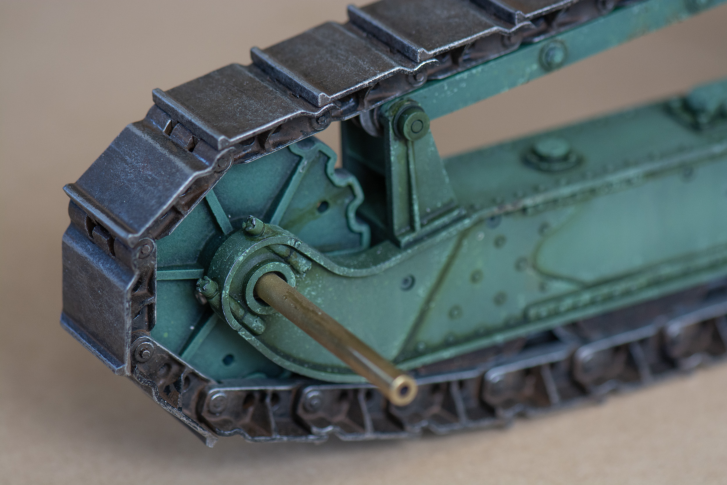

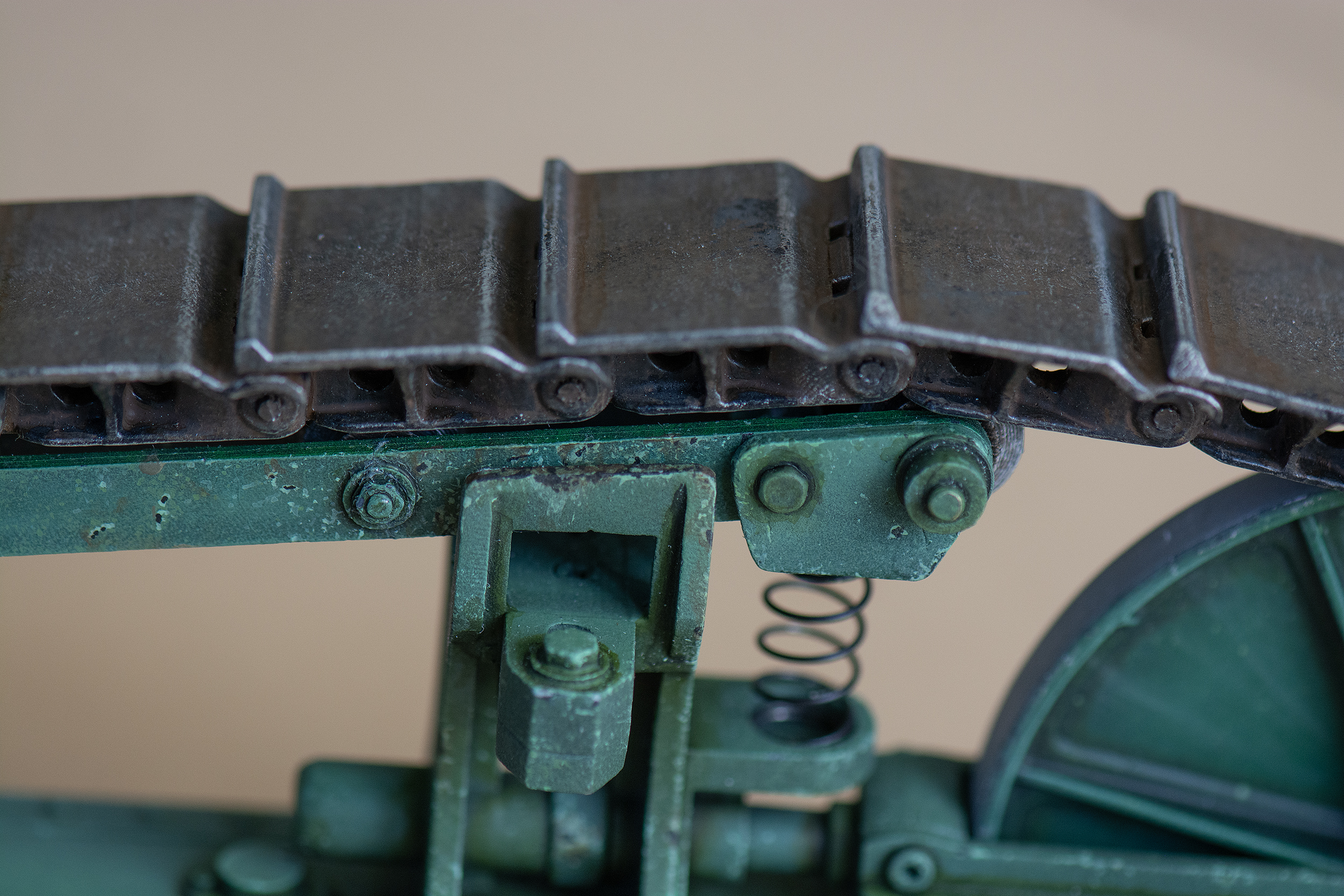

Some small details
DSC_1675 copy 2.jpg (1.18 MiB) Viewed 357 times
DSC_1674 copy 2.jpg (1.22 MiB) Viewed 357 times
DSC_1672 copy 2.jpg (2.8 MiB) Viewed 357 times
