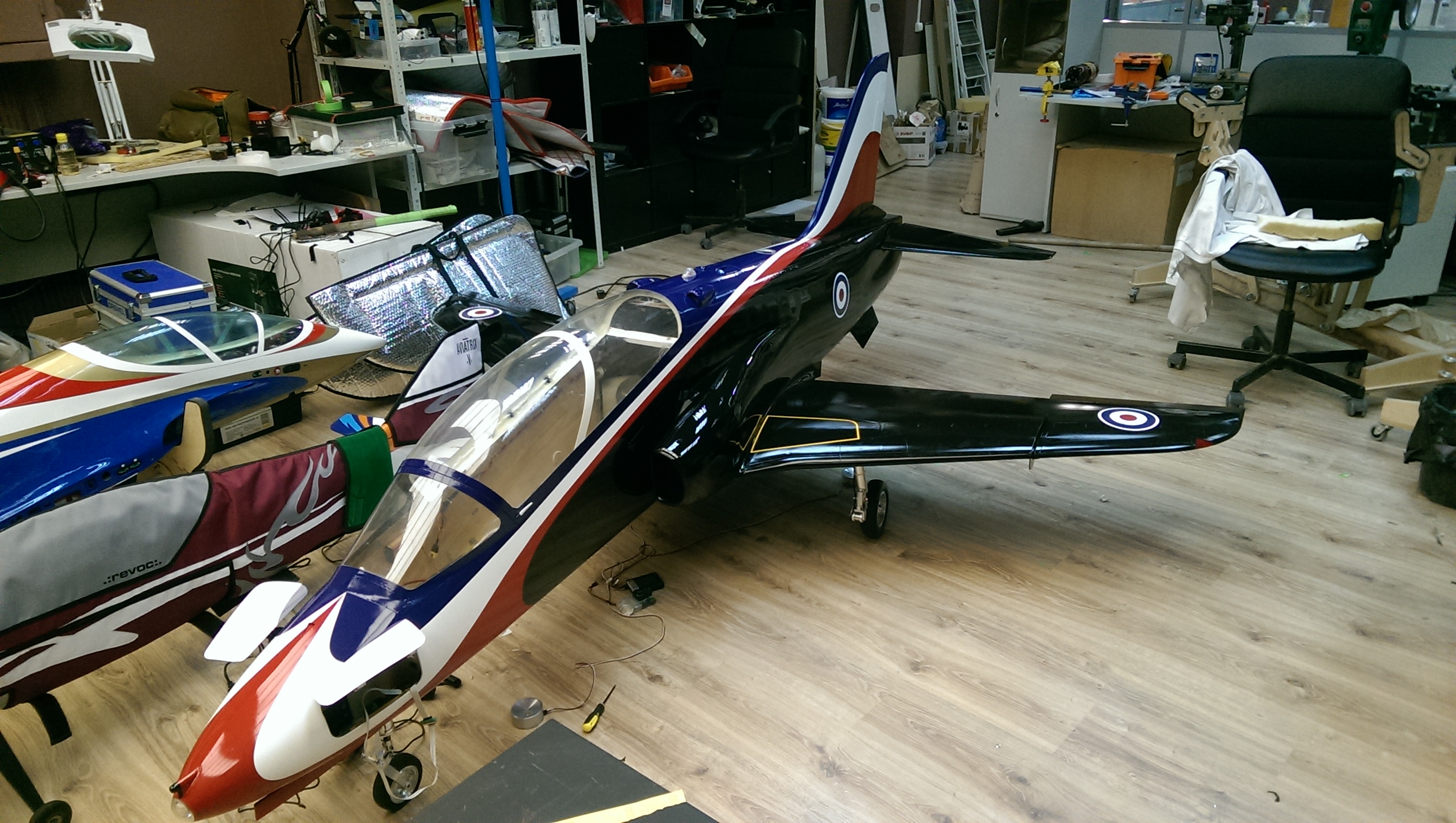

This is ONE of my planes......

Nice to see the Hawk Pavel.
We used to live close to an RAF base that had 63 squadron and 151 squadron Hawks based there and enjoyed seeing them every day.
Lovely looking aircraft.
