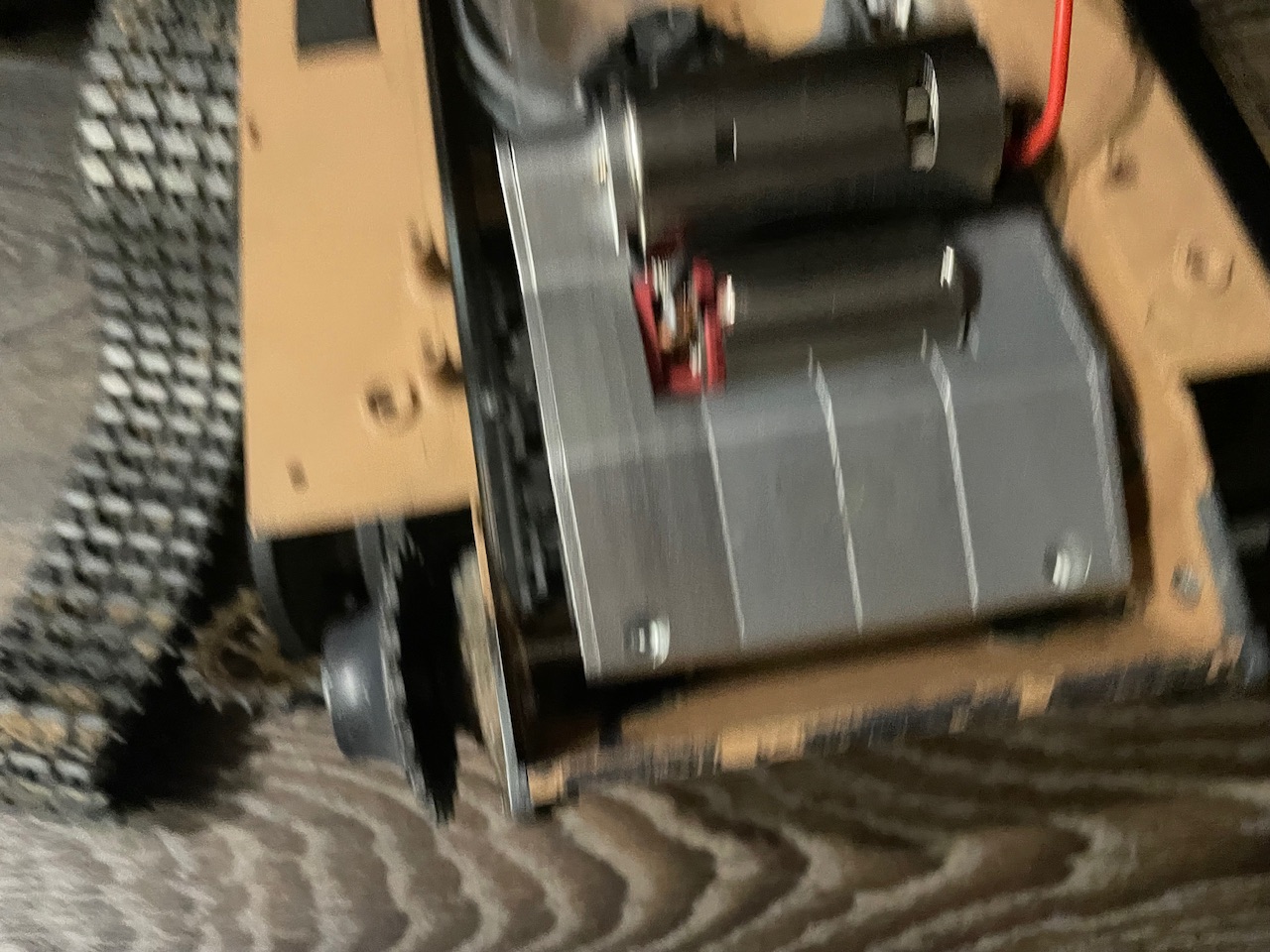

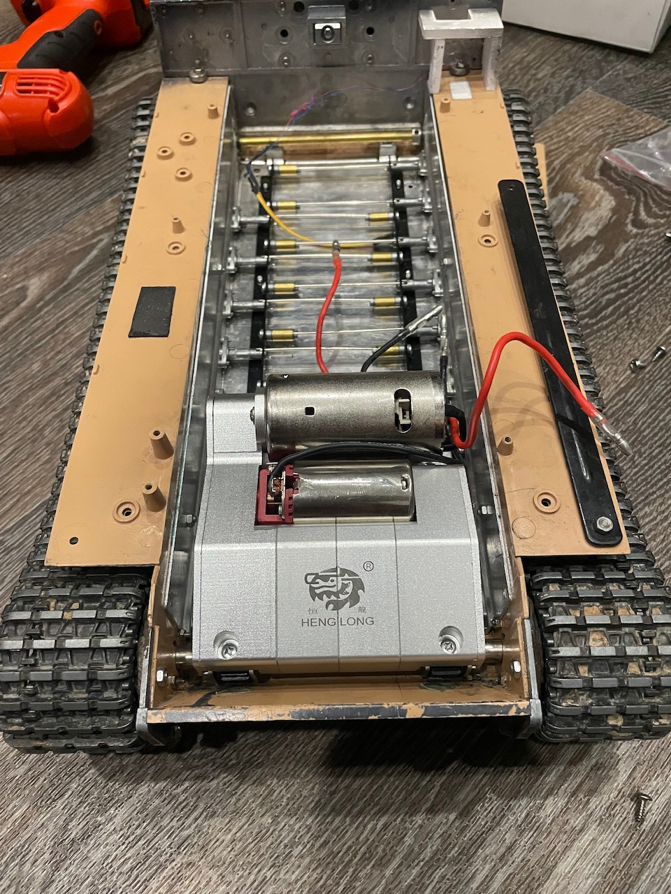

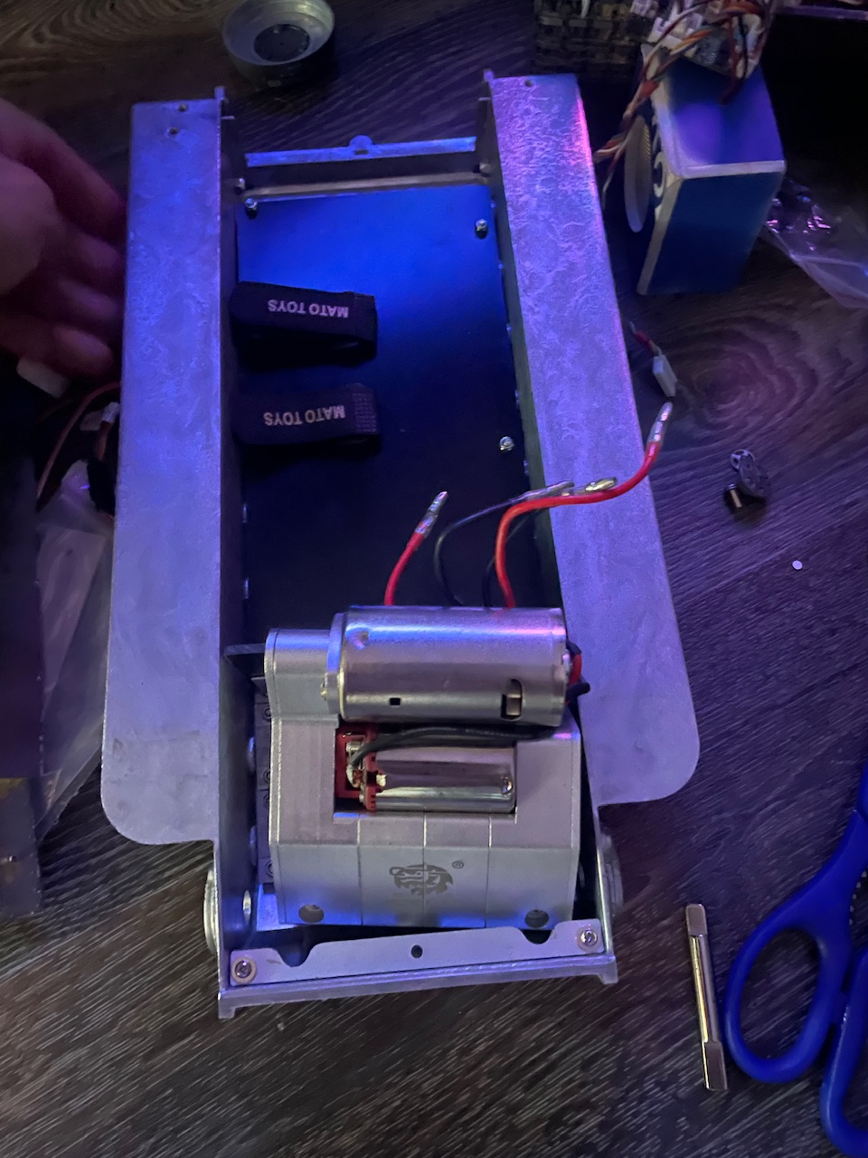

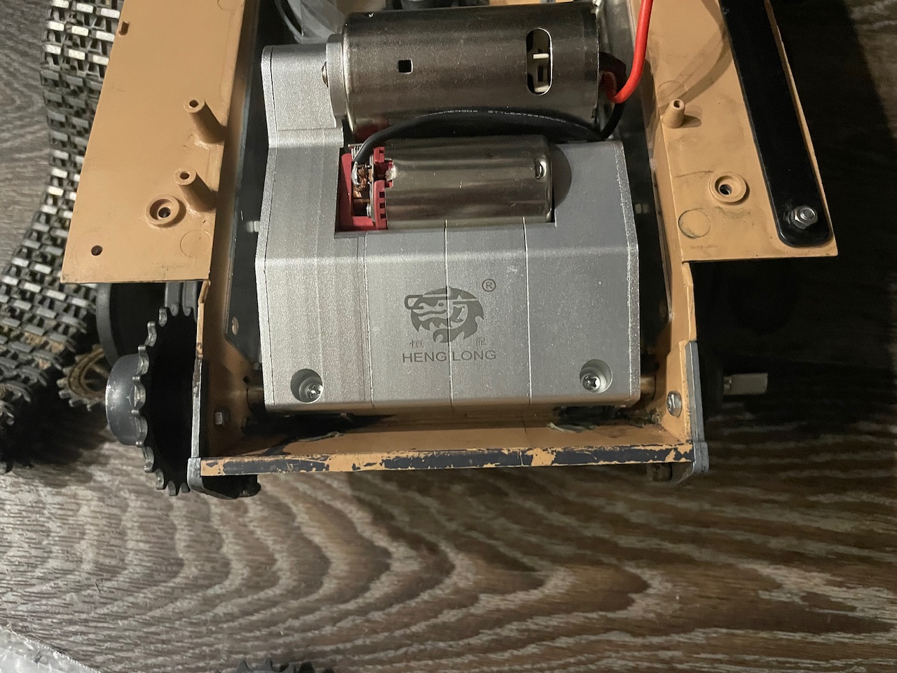

i bought mato tiger 1 low hull and heng long dual current gearboxes. and its not fit to mato and also to taigens hull /facepalm
For taigen, the shafts are too long, and for mato, the mounting pad has to be lowered somehow, but it conflicts with the torsion mounts.

velthal, I am sorry for the expense of the Mato Hull and the HengLong Dual Current gearbox if you cannot use them. I have two really dumb ideas. Might there be some shorter axle shafts for the HengLong Dual Current gearbox? Or, might the gearbox be fitted to the Mato lower hull (and nonetheless fit under the upper hull) with the rear tipped a bit upward?

Herr Dr. Professor wrote: Fri Sep 20, 2024 1:18 pm velthal, I am sorry for the expense of the Mato Hull and the HengLong Dual Current gearbox if you cannot use them. I have two really dumb ideas. Might there be some shorter axle shafts for the HengLong Dual Current gearbox? Or, might the gearbox be fitted to the Mato lower hull (and nonetheless fit under the upper hull) with the rear tipped a bit upward?
Herr Dr. Professor, yes. Both of your options work. The seller promised to send me the short axles (originally we agreed on 49mm, but he sent 60mm). So this gearbox fits perfectly in the Teigen.
And about the mato - you can make it at an angle, or cut the mounting plate off a little bit of the housing.

The axle is removable. the gearbox is very well thought out. you can simply enlarge the mounting area for the pinion on the machine and push the axle in rougher. you don't even have to cut it.

The hl gearbox has won me over. I love it. Very smooth operation, even with the tk60. However, to go straight, the sticks have to be deflected diagonally. Very uncomfortable.
