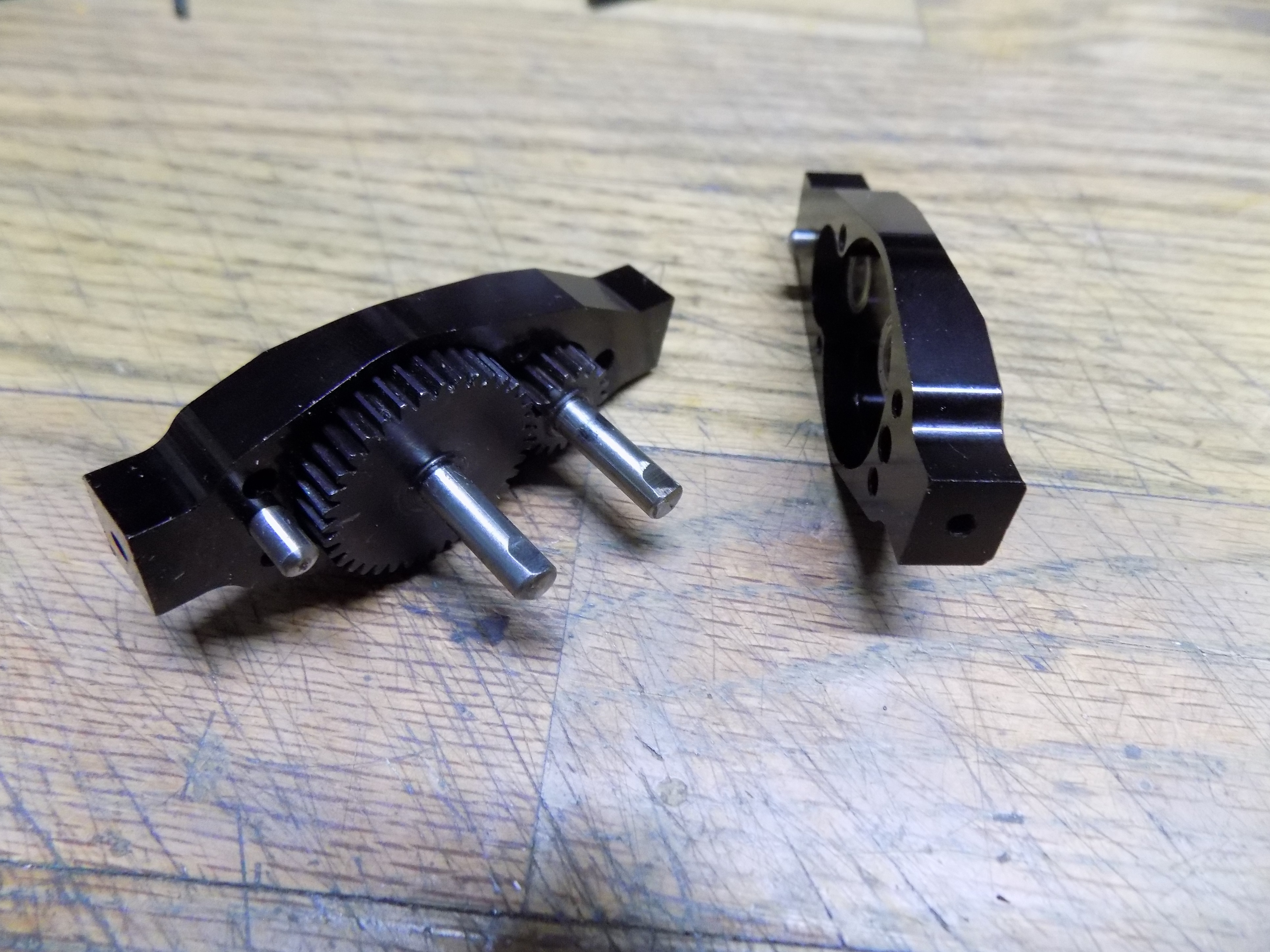

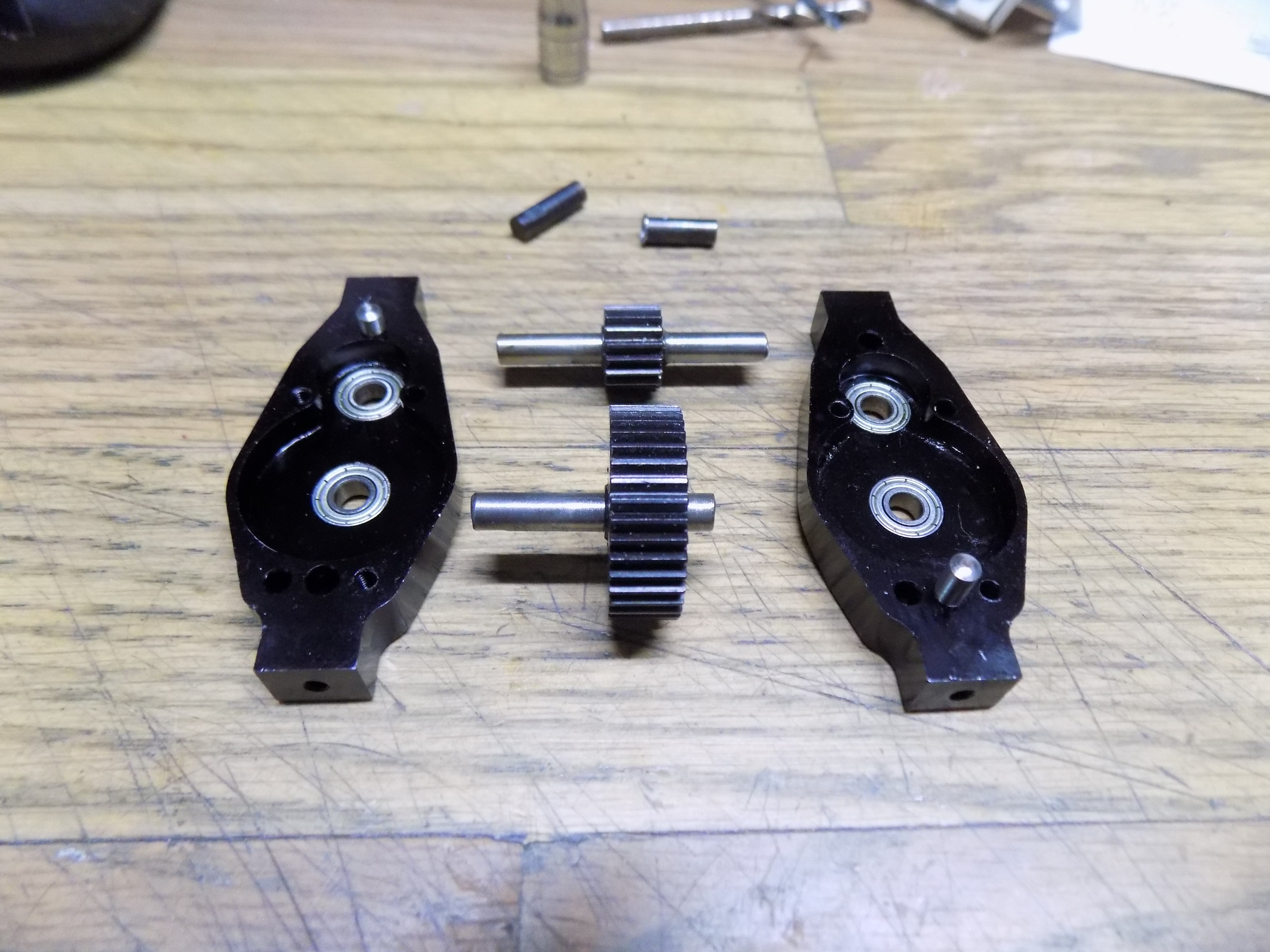

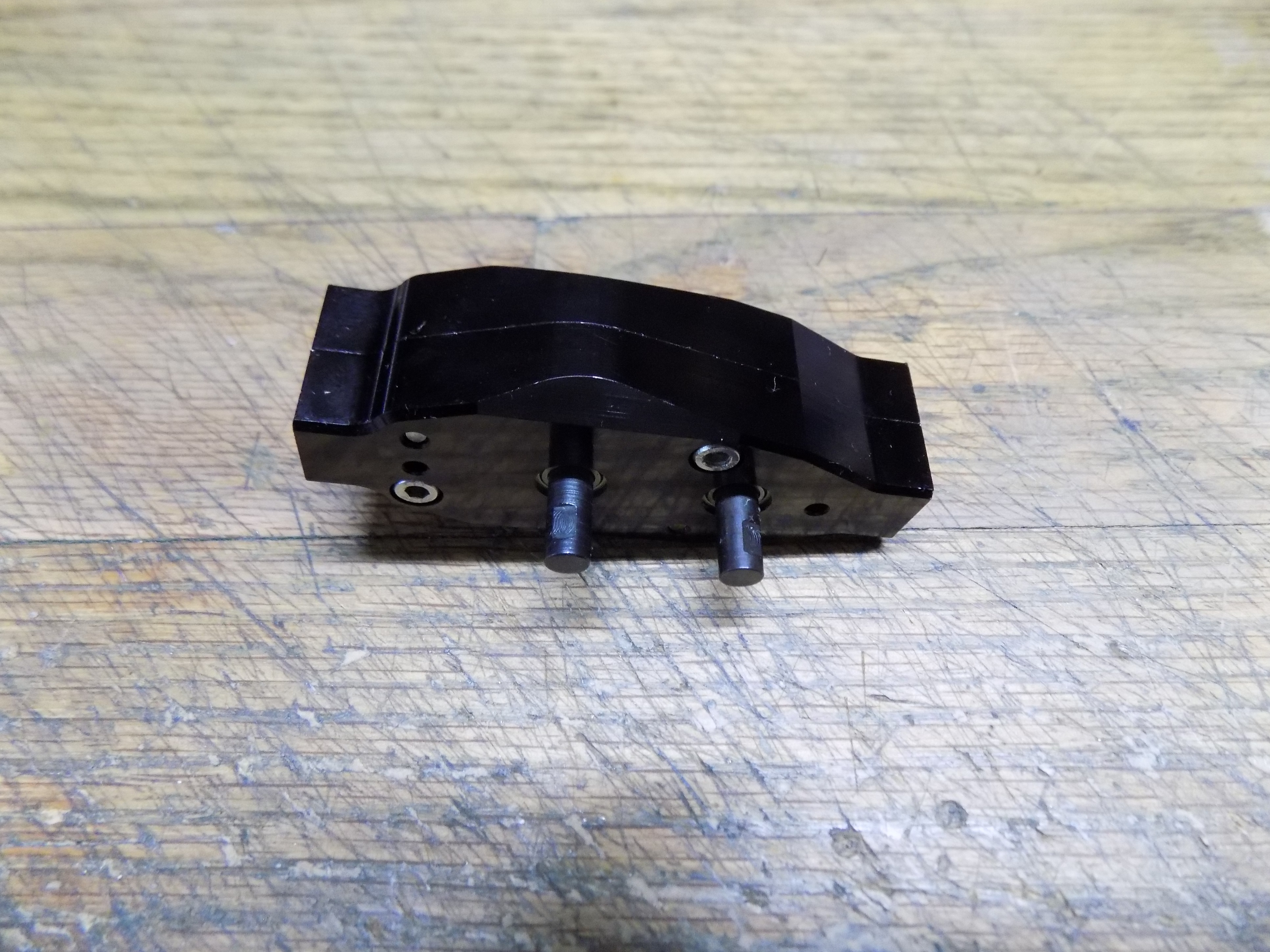

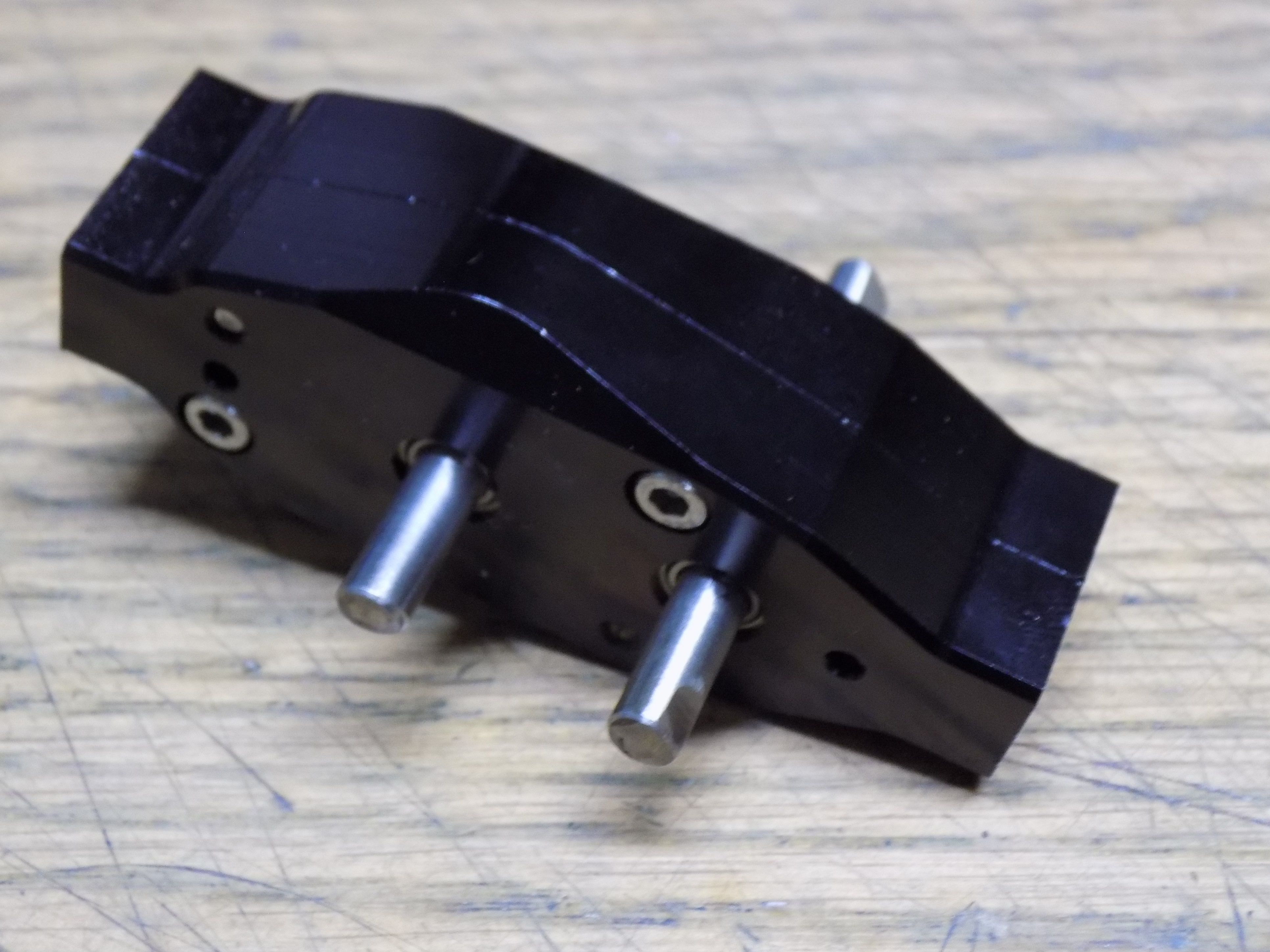

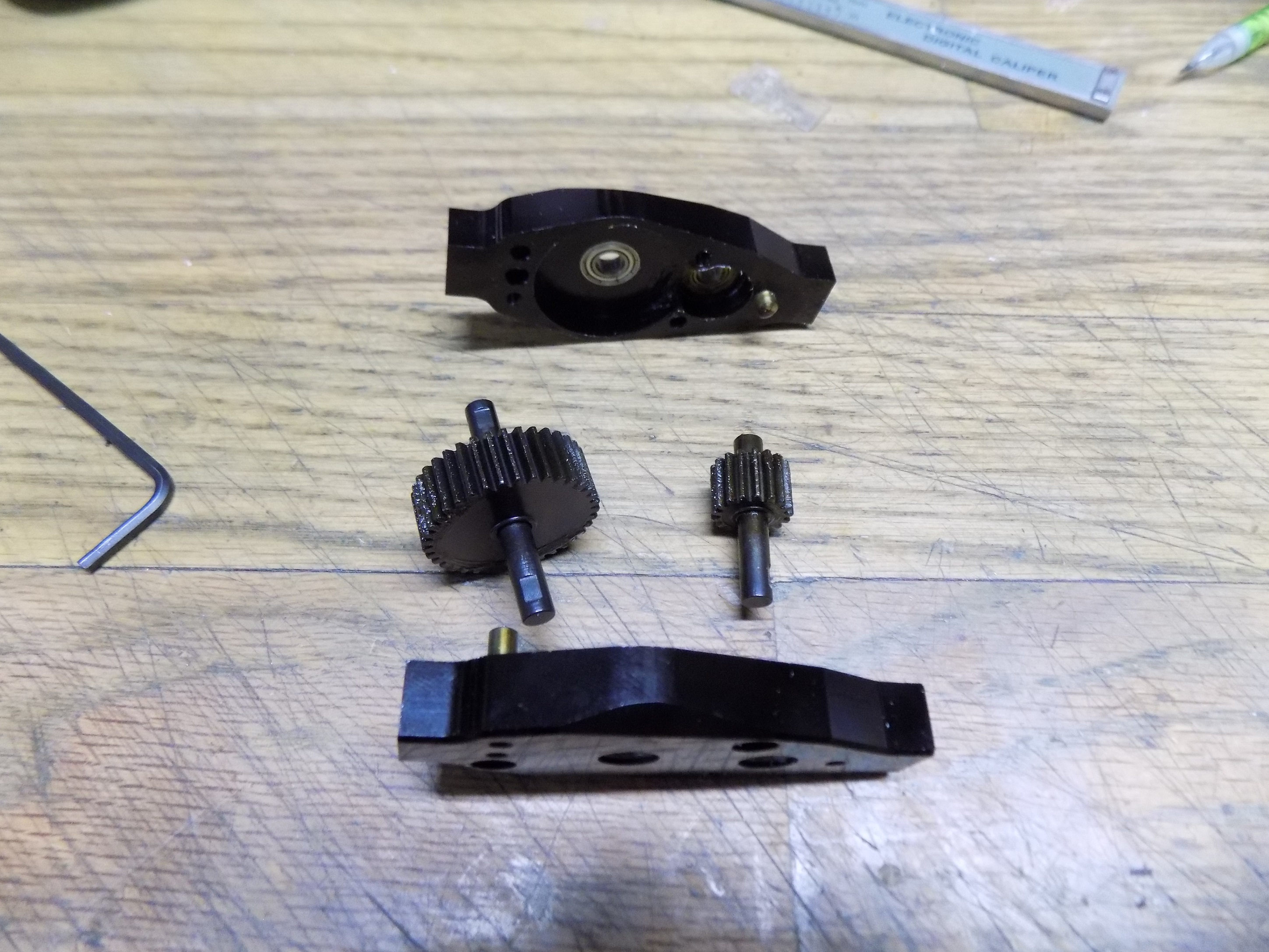

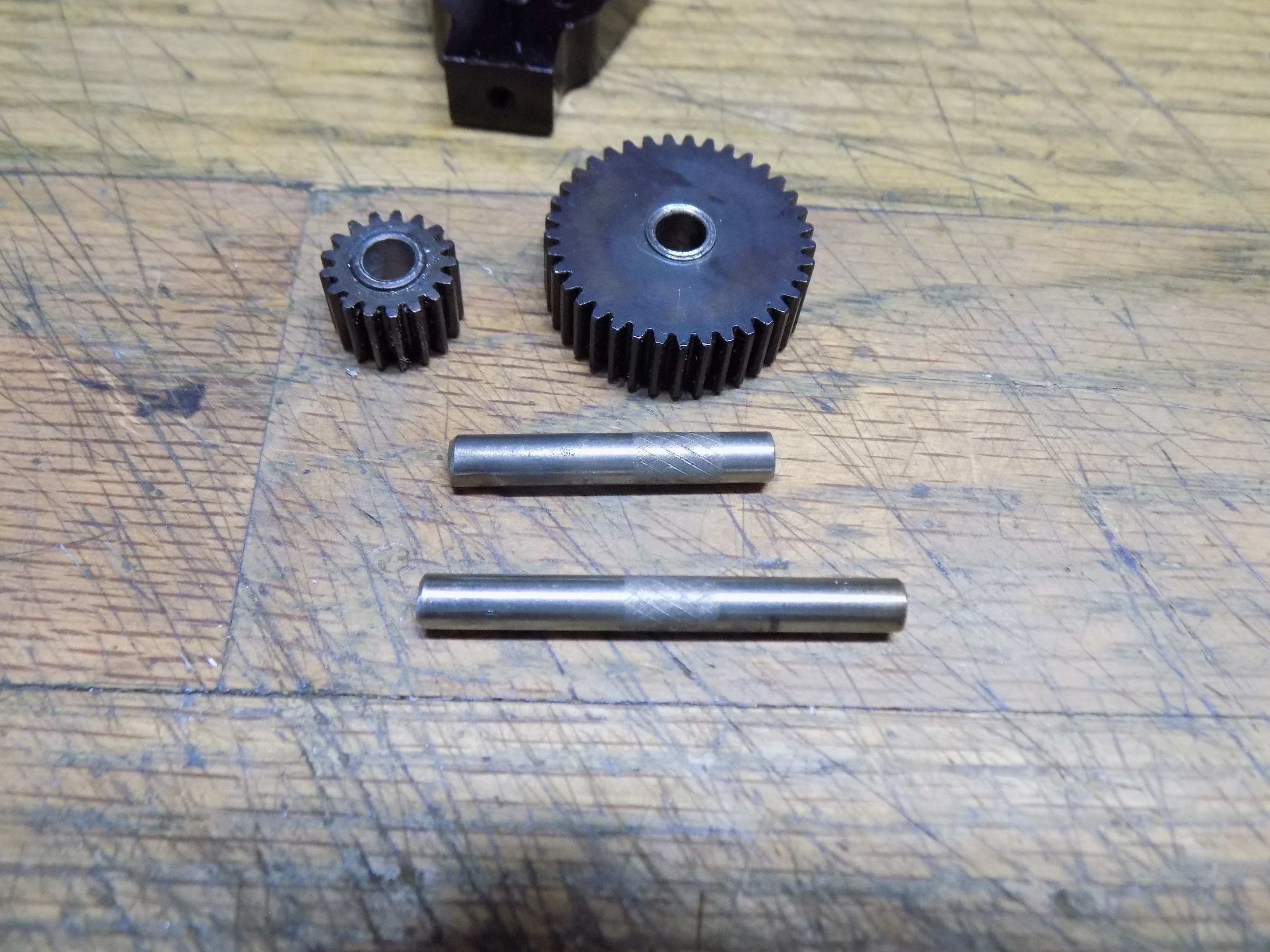

Well one of the big issues solved. This is the fourth attempt at a reduction transfer case. Two were advertised as reduction units and specified as 2:1 but turned out to be closer to 1.2:1, both returned. This one was ordered twice, after waiting for more than a month for it to arrive it was credited back. Found this one from a different supplier and it arrived about 10 days after ordering.
As delivered. 17 tooth input gear and a 37 tooth out (2.176 : 1 or so).
The front and rear axles are the same ratio, but the rear chain drive is is 2:1 reduction on the real Dragon Wagon. To get the front wheels to turn at the same rate I need to slow the front driveshaft to about half the speed of the rear's. I tried to press the shaft out of the input gear but ended up mushrooming the short side of the shaft (no workie). Remedied by drilling out the gears and installing new 5mm shafts with a little knurling and epoxy.
Still looking for the appropriate chain and then fabricating sprockets. It appears the real M25 uses 21 and 42 toothed gears for the rear drive. So using 17 and 37 should look pretty scale (and potentially work).

Because this T-case has just two gears the output to the front and rear differentials will turn in opposite directions. The simple fix is to invert one of the diffs. Like the Tamiya semi trucks and the HL 6WD vehicles the most rear axle's drive shaft turns in the opposite direction.

If it helps, the first two pictures were taken about 20 minutes after arrival. The rest about an hour later. Warranty ruined a half hour after it was in my hands...

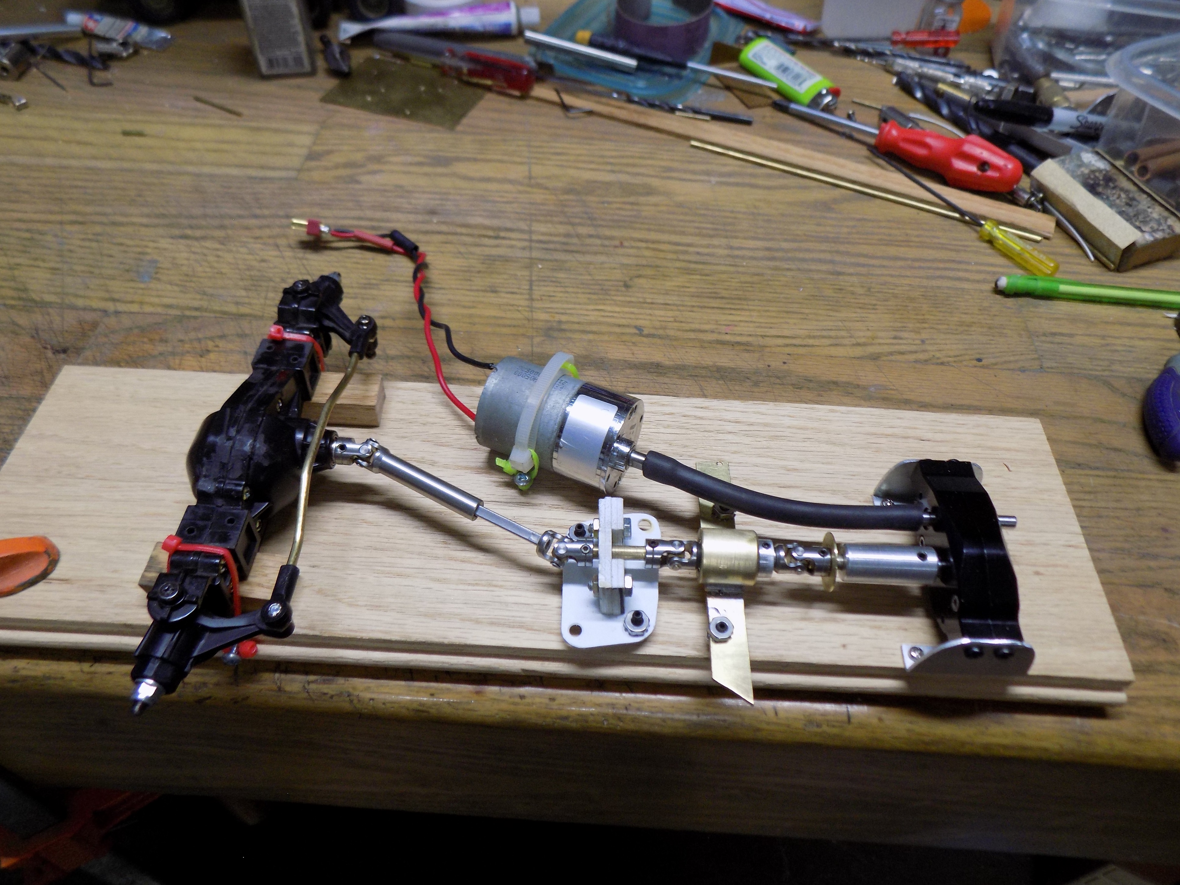

Just for fun...
Why do we do this hobby? To enjoy ourselves. First test of a front axle disconnect. The pillow block will not be used (white styrene part). Instead the drive shaft will run from the brass piece to the diff. I can possibly shorten it up by an inch (25mm) if needed.

Posts: 6145
Re: [Support] M25 Dragon Wagon
Talk about CLEVER! Look at that drive shaft from the motor to the tranny! Geepers! Is that shrink tube? ...some kind of tubing? And the clutch! I can't wait to see the shifting for in action? Will it use a little servo. Geepers this is just such ingenuity!

I borrowed the driveshaft from the pillow block to the diff from my little DUKW. And instead of borrowing the second I just used some vacuum hose from the garage. Yes, I intend to have a servo with a "fork" run the disconnect. The reason I made the display is in reality in action it would go unnoticed unless the rears were spinning in mud.
