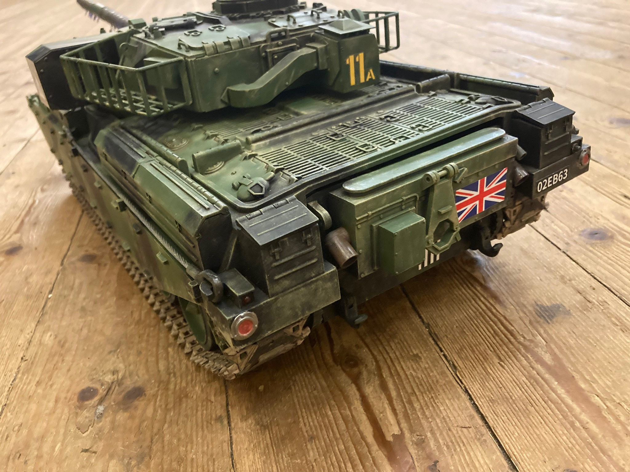

My HAYA Chieftain was running around nicely on its plastic tracks at the club this evening.
The tank runs and steers much better without the weight of the metal tracks to drag around, but I think the red motors will take care of this power shortage OK and then I will refit the metal tracks.......later........these plastic tracks work really well !
Now I can concentrate of getting the paintwork and weathering looking a little better - but that is dependant on my skills improving - something I am working on next!
Strange thing - I put some Tamiya "Clear" in the areas that I was going to place the decals and then I also put some on the exhaust to see if it could enhance my rust effect - but it has removed the rusty look altogether......so that experiment didn't go well !
Bob.
Bob.
