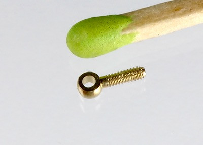

I am looking for hinges I can use for the toolbox doors. The smallest I can find are 8 mm x 10 mm, perhaps small enough, but I’m open to tips.

Thank you! I am also considering attaching the tool box doors with magnets, but the right hinges would be better because then I could display the boxes on the forward outsides of the FAMO open with tools, etc.inside. In fact, I would like to hide all the electronics, battery, etc. along the frame, under the hood, or under the seat bottoms so that I can fill the box with all kinds of nifty stuff as you did.

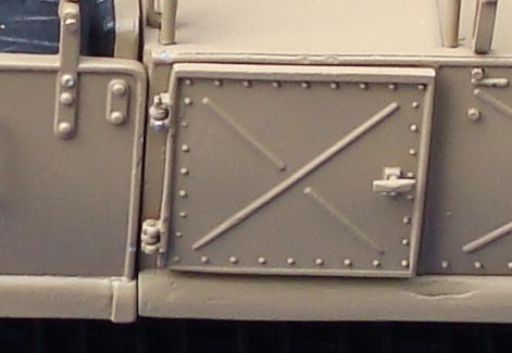

Hello Mr.Doc,
you don't need hinges!
What you need is a drill with Ø0,8mm, with it you drill through the existing hinges.
Additionally you need 2x eyebolt and suitable wire.
Works perfectly:

Herr Hamm comes to my aid yet again! Now the only hard part will be finding that eyebolt. This will be nifty. THANK YOU THANK YOU THANK YOU

Doch, haben Sie mich geholfen, denn es scheint mir als ob ich tagelang so einen Augenschraube/Ringschraube im VS online zu verkaufen versuchen habe. Danke!
Oh, you’ve helped; it seems as if I have been looking online all day for that sort of miniature eyebolt for sale here in the US. Thank you
