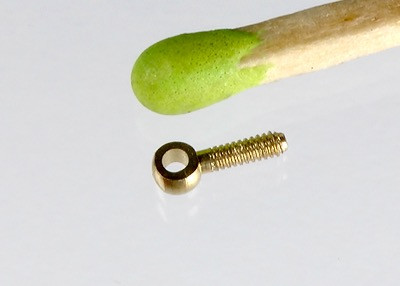

I am looking for hinges I can use for the toolbox doors. The smallest I can find are 8 mm x 10 mm, perhaps small enough, but I’m open to tips.

Thank you! I am also considering attaching the tool box doors with magnets, but the right hinges would be better because then I could display the boxes on the forward outsides of the FAMO open with tools, etc.inside. In fact, I would like to hide all the electronics, battery, etc. along the frame, under the hood, or under the seat bottoms so that I can fill the box with all kinds of nifty stuff as you did.

Hello Mr.Doc,
you don't need hinges!
What you need is a drill with Ø0,8mm, with it you drill through the existing hinges.
Additionally you need 2x eyebolt and suitable wire.
Works perfectly:
Works perfectly:

Herr Hamm comes to my aid yet again! Now the only hard part will be finding that eyebolt. This will be nifty. THANK YOU THANK YOU THANK YOU

I have a Link for buying eyebolt:

Doch, haben Sie mich geholfen, denn es scheint mir als ob ich tagelang so einen Augenschraube/Ringschraube im VS online zu verkaufen versuchen habe. Danke!
Oh, you’ve helped; it seems as if I have been looking online all day for that sort of miniature eyebolt for sale here in the US. Thank you
