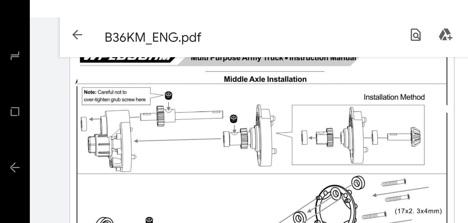

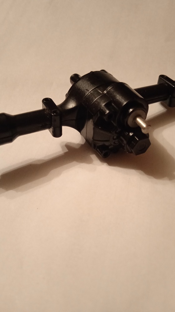

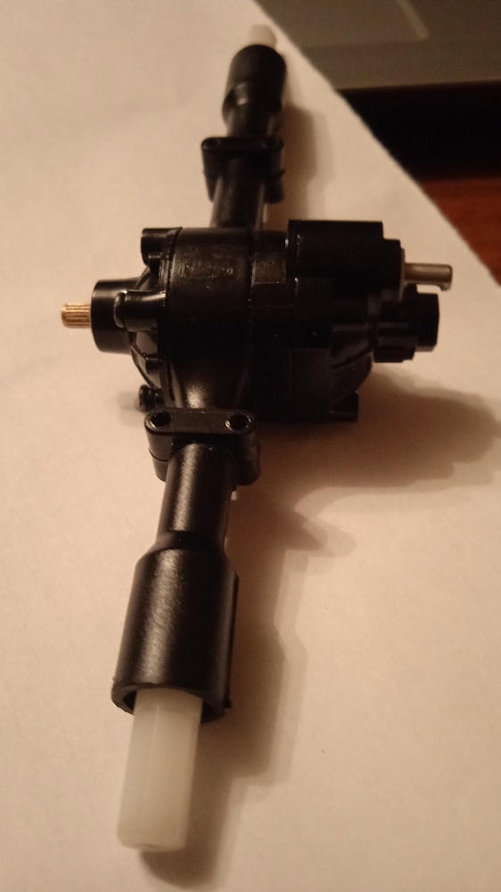

Re: BTR-152 3D printing 1/16
Purchased set has been installed....
But......
The supplier gave only three parts, but you need 4 (four)
The intermediate cardan is too long, I had to cut it and shorten it ....
These covers are designed for a different way of the through bridge and even have gears, but I repeat there is not one bevel gear, for this option ...
but I had a stock set, I used the covers as a donor and one gear, it almost fit into the gearbox.
In principle, it’s impossible to simply take and put an upgrade on a 6x6 chassis ..... if you don’t have the tools ....
Here is an option with covers from the kit, but there is no bevel gear .... fourth ....
But......

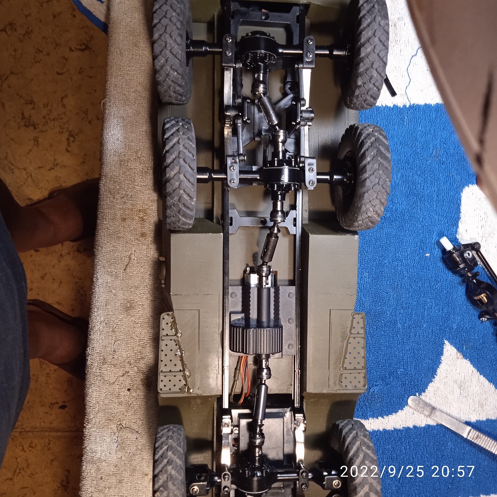

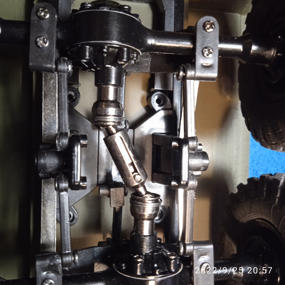

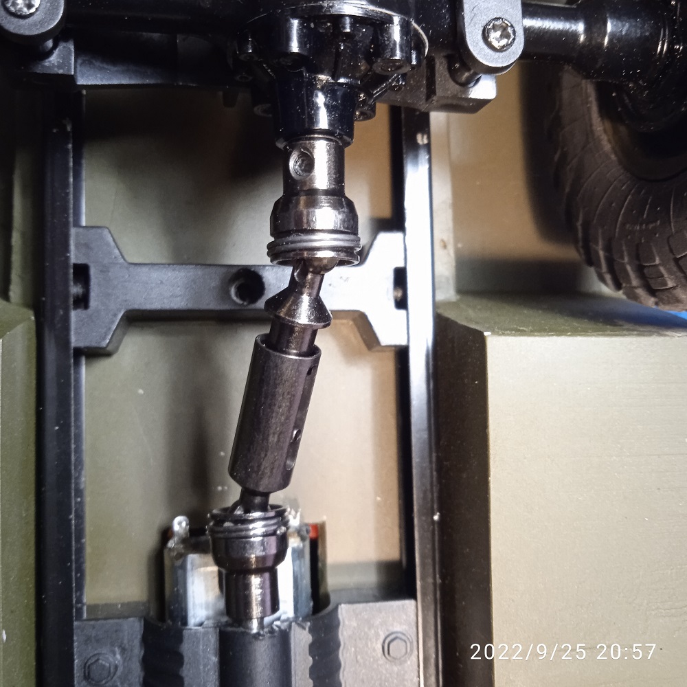

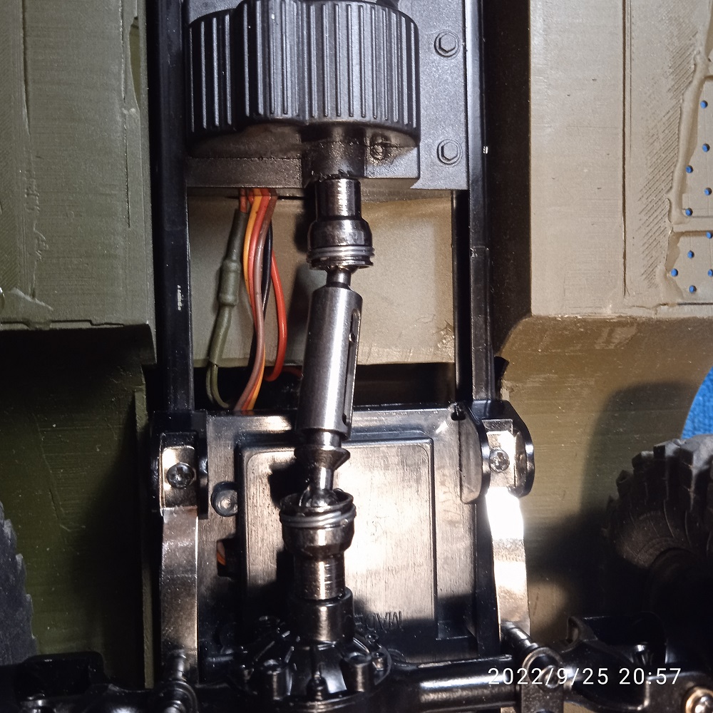

I assembled what they recommend with donors from the stock kit, cut the existing shaft to the right size ...
I installed plastic bushings.
After all, in a set of metal bearings are not enough ....
As a conclusion .... we were deceived .....
