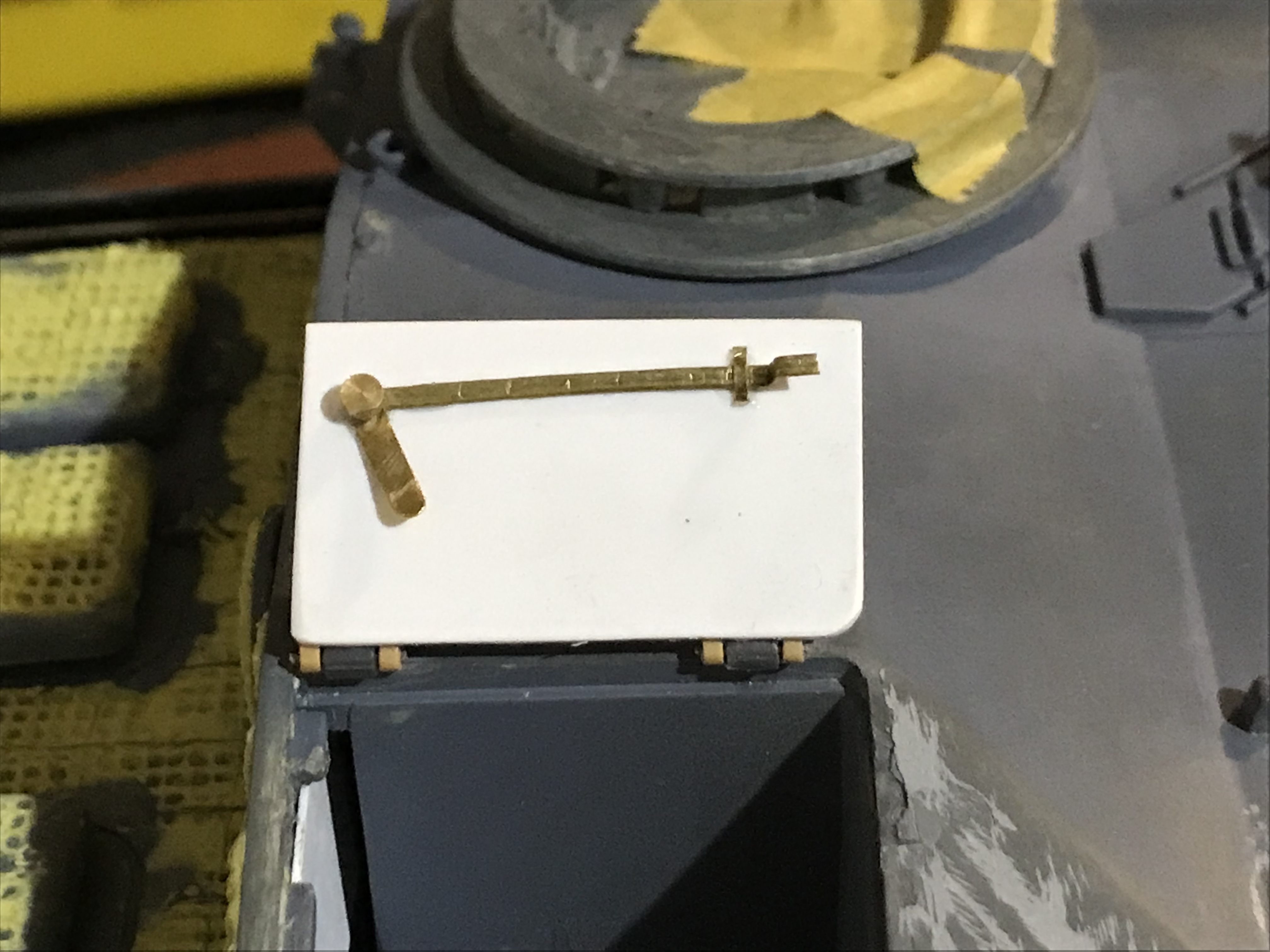

The inside o the loaders hatch needs something.
Made up a near enough latch just to keep moving on it.

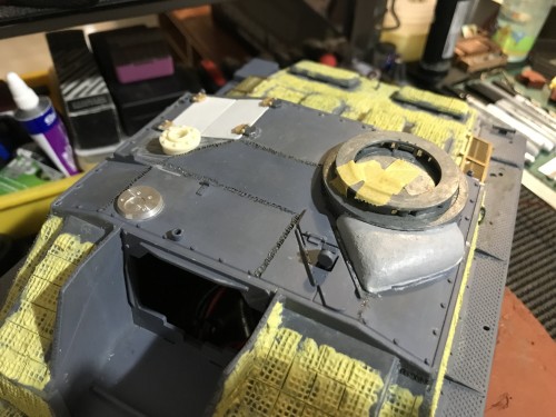

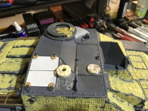

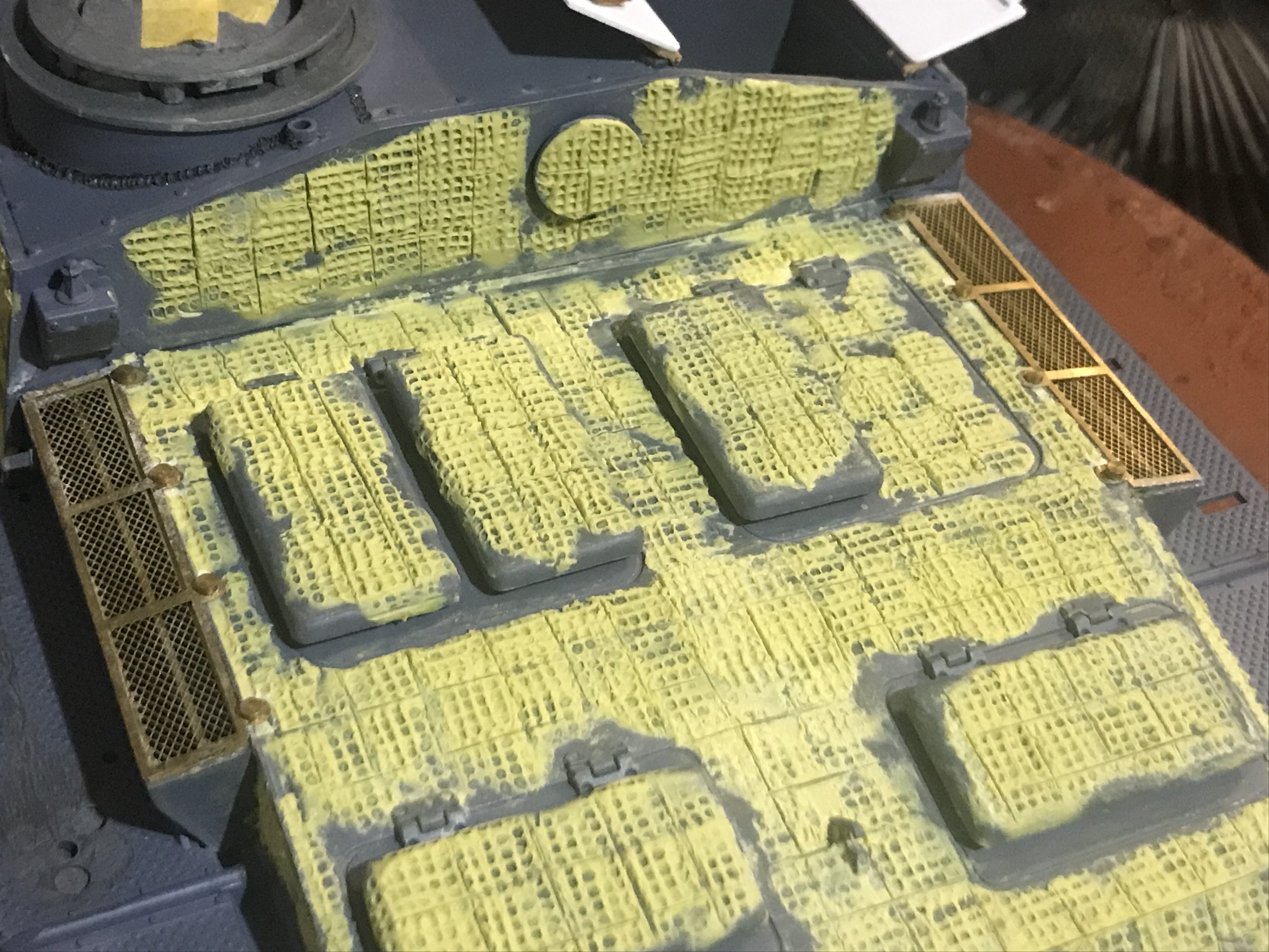

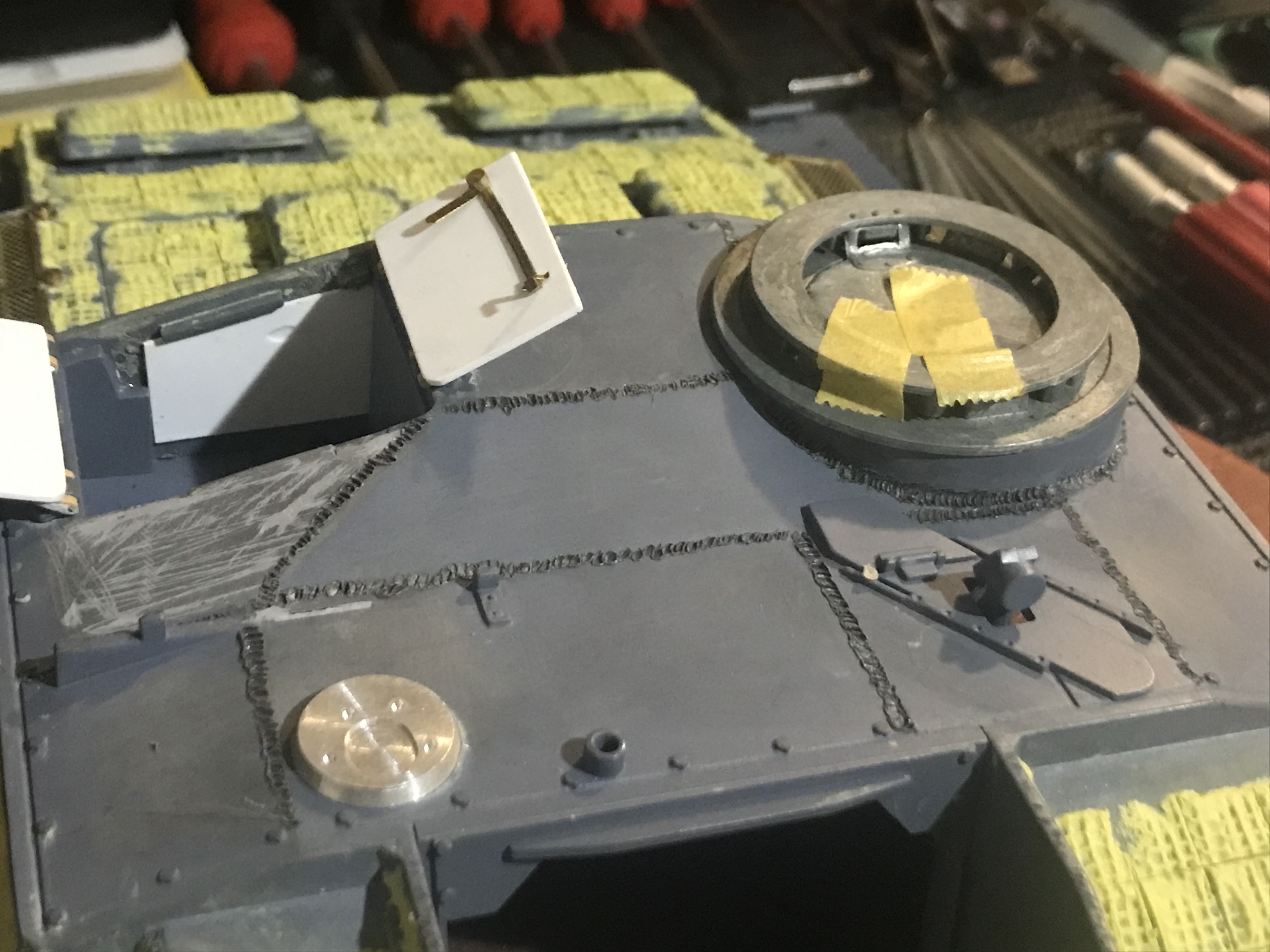

Very minor progress, really just trying to do something other than shove it in a box & start something else :/
Ran the weld texture over the casemate roof, and added the brass mesh screen on the air intakes.
I suppose I could make tool handles and get the jack ready & stuff like that, but that is not really the order I like work work in .
Oh well, we wait............... :problem:

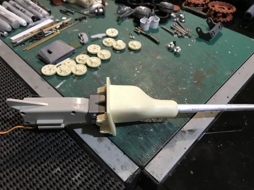

Once the flash was trimmed off the parts & then cleaned up, fitting them was a 2 minute job.
The frontal section of cupola armour and remote M.G. mount(M.G. not used in my subject picture)went on in a flash.
The Topfblende needed a bit of a clean up through the barrel hole, but went together a treat and is ready to mount tomorrow after priming in the right places.
The Mato barrel is an easy interchange for the H/L one and once my option of muzzle brake is fitted, will be a good representation.

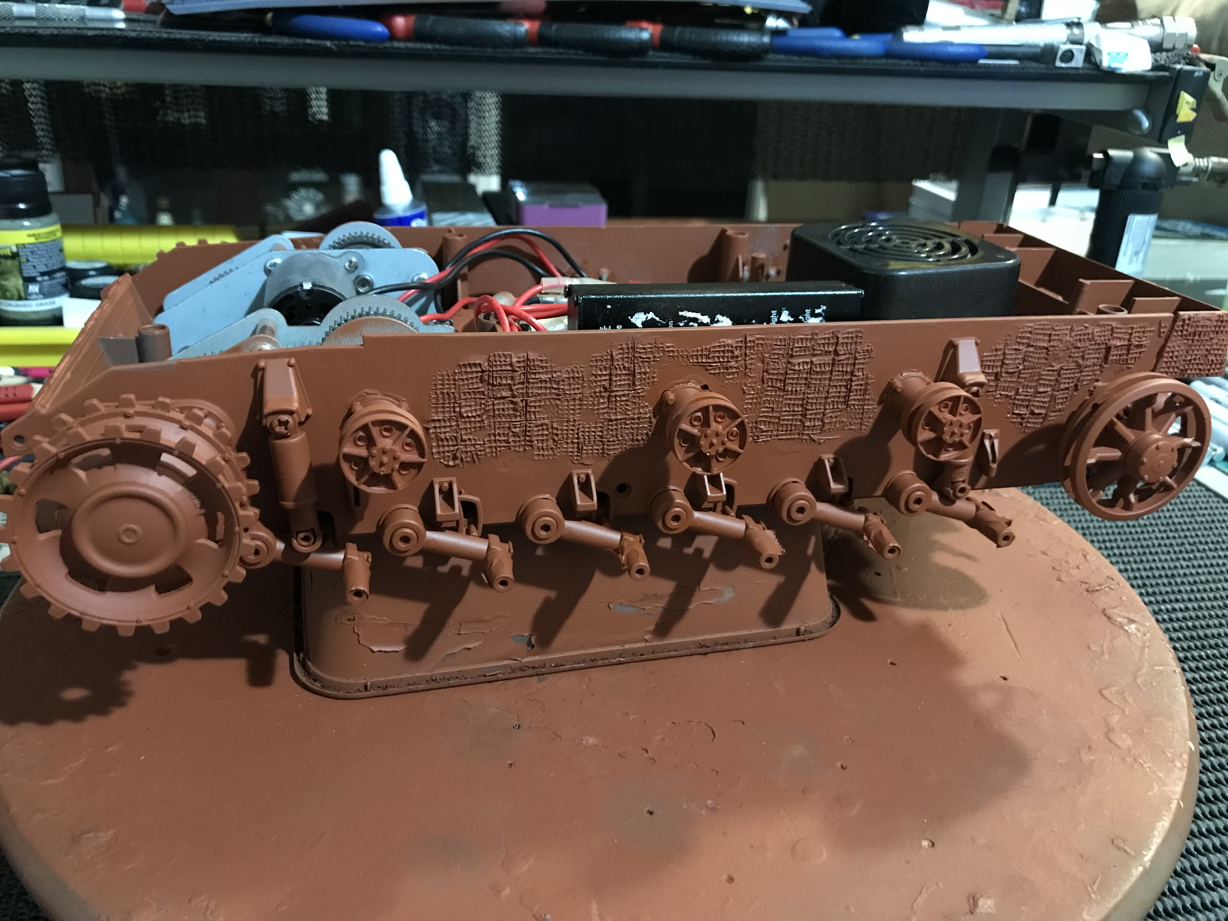

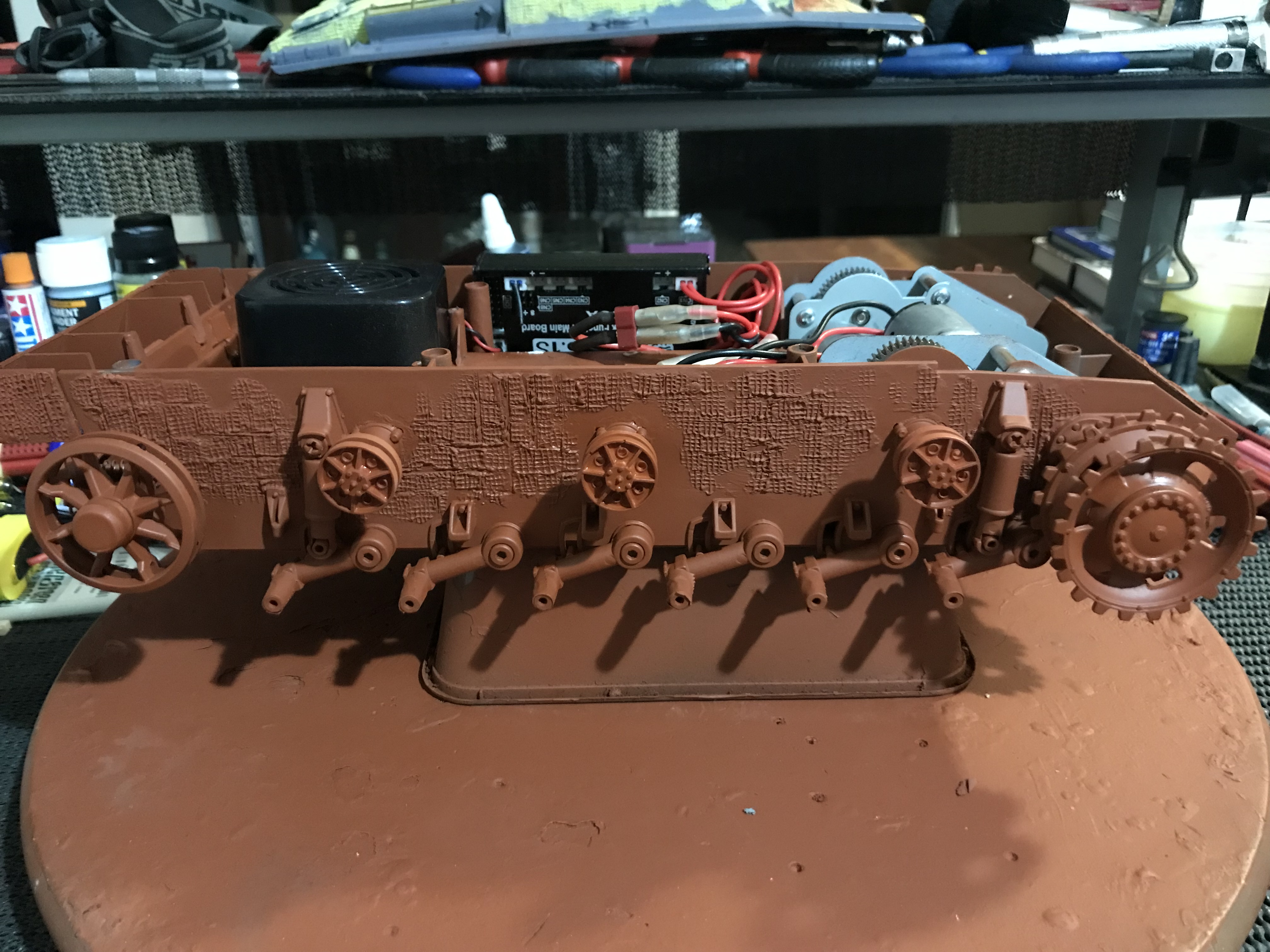

Not so easy is the method of getting the resin return rollers(with no rubber tyres) to go on the axles & mounts.
They need bushes or some such support.
I will use brass tube(thats 'toobe' to you left -hand-drivers ;) ) to allow the resin rollers to run safely over the 3mm stainless pan head hex bolts.
Not sure exactly how or what I will use for that, but at least I have a plan.

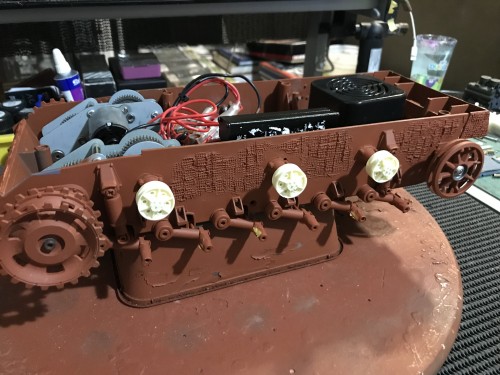

Got the return rollers fitted as well.
They are a bit light for heavy use but for the amount of work I expect this will see, they should be sufficient.
A quick drill out to take a short section of brass tube as a bush & on they went.
They won’t be visible behind the skirts anyway, so I actually could have used any rollers.
But I know they are there!
