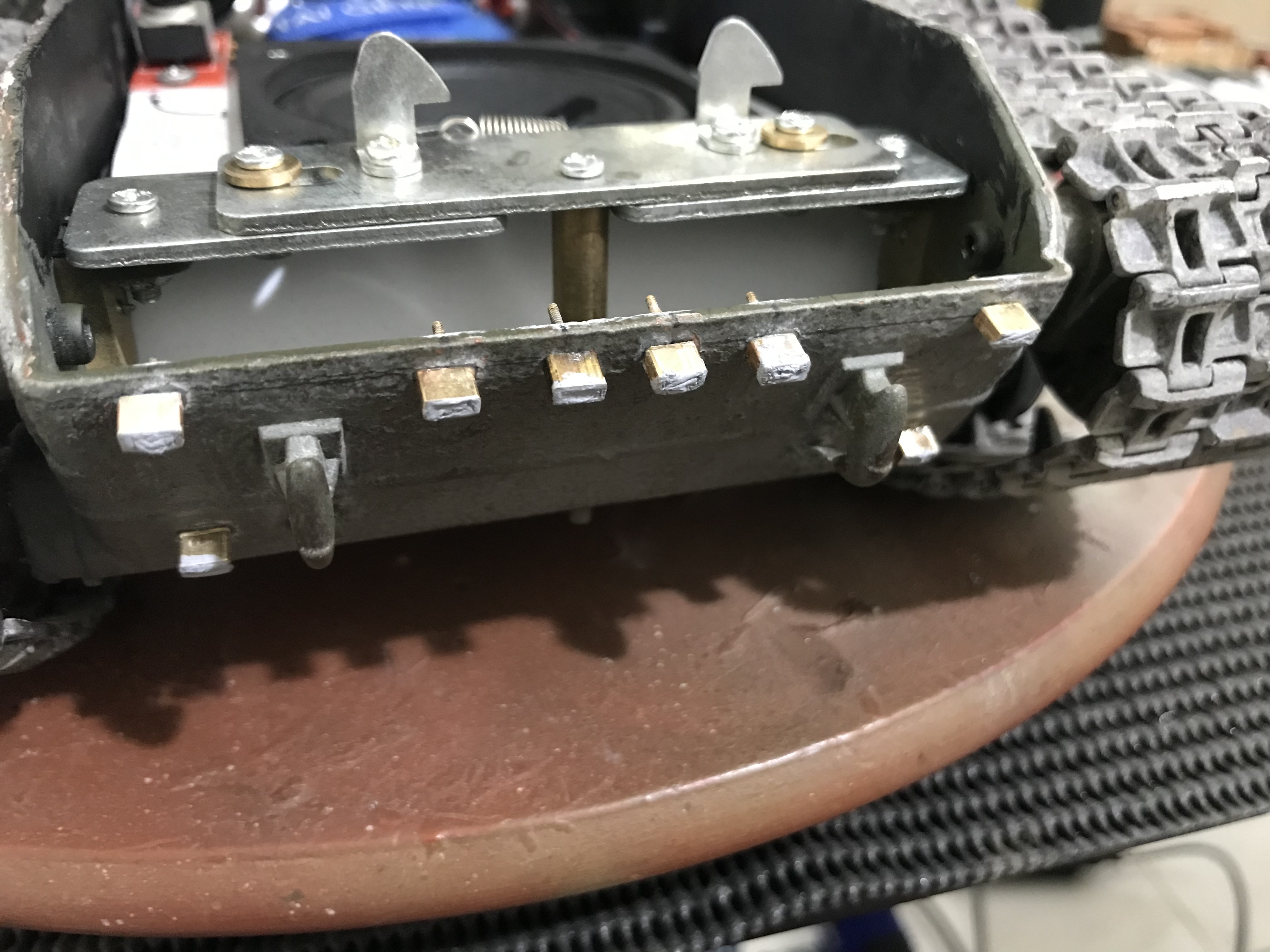

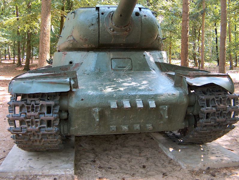

Now heres a moment when I look back on the build and realise I have underestimated the importance of some basics.
Spare tracks mounted on the lower front glacis plate on the JS-2 are very specific, and in the case of a 16th scale model, need to be robust.
Hindsight being what it is, I really should have left the plastic ones as they were. Add to that, that mounting them now is a lot harder to get right. :problem:

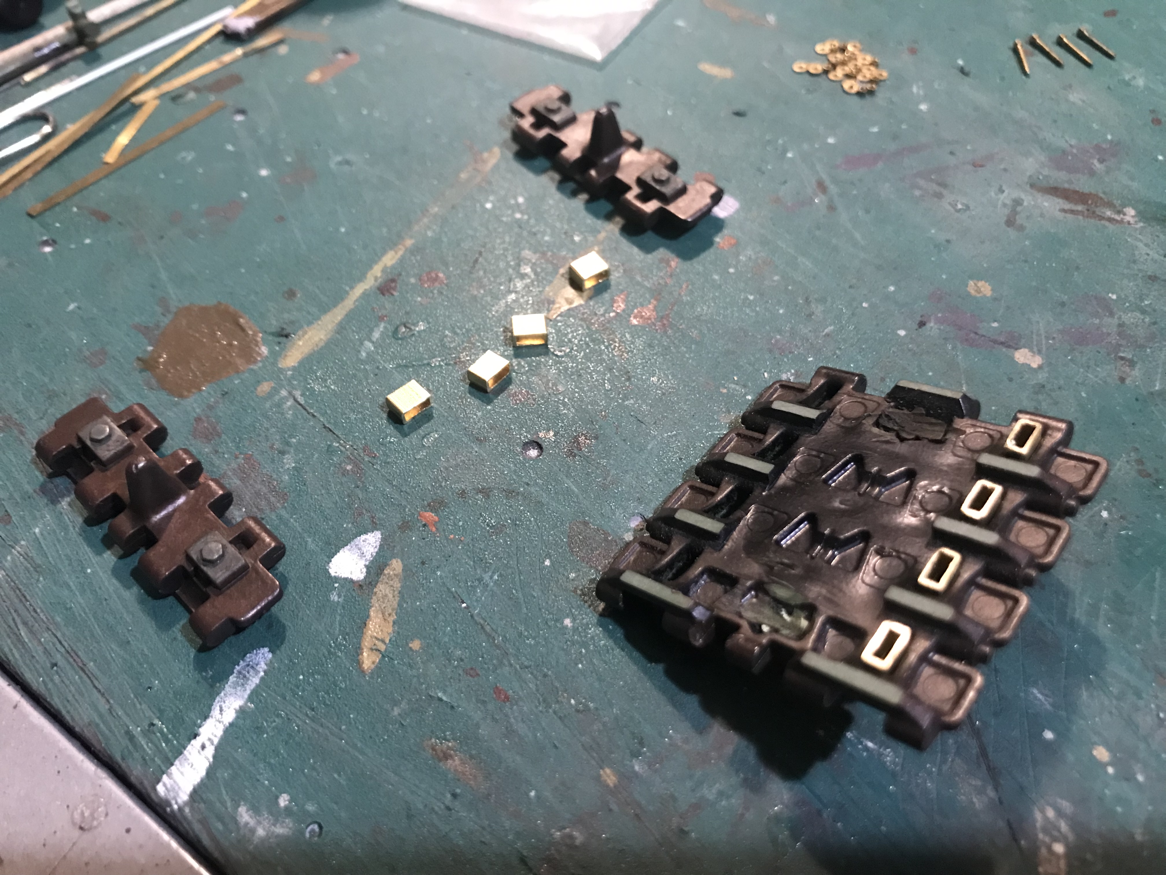

I went on a chauffeur driven trip to our nearest hobby shop & got some brass stock to try to replicate the mounts.
Not having been able to get hold of small bolts without doing the import thing, a plan 'B' is required.
The plastic links will be reused, but secured on to brass rectangle with small bolts soldered inside the section, which is then anchored through 1mm holes drilled into the hull.
The plastic will then be epoxied onto the brass mounts and the lower hull plate to aid smash resistance!
Later versions had the outer two links of course, mounted the same way to the hull.
The early model JS-2's spare track retaining mounts looked like this, but the outer links came later.

I'm just now learning about the nuances of the JS-2, never paid very close attention before. :{ I find the tank hull interesting given it's early "broken nose" glacis plate versus the later angled glacis. The picture of the track holders is interesting too, mostly since I just started reading one of the "Duel" books about the KT versus the JS in the last stage of the war. Your amazing build is bringing things more clearly into focus than just the pics in the book can.

The different glacis plates or frontal profile has also been called "the Roman Nose" version by some Russian writers. :eh:

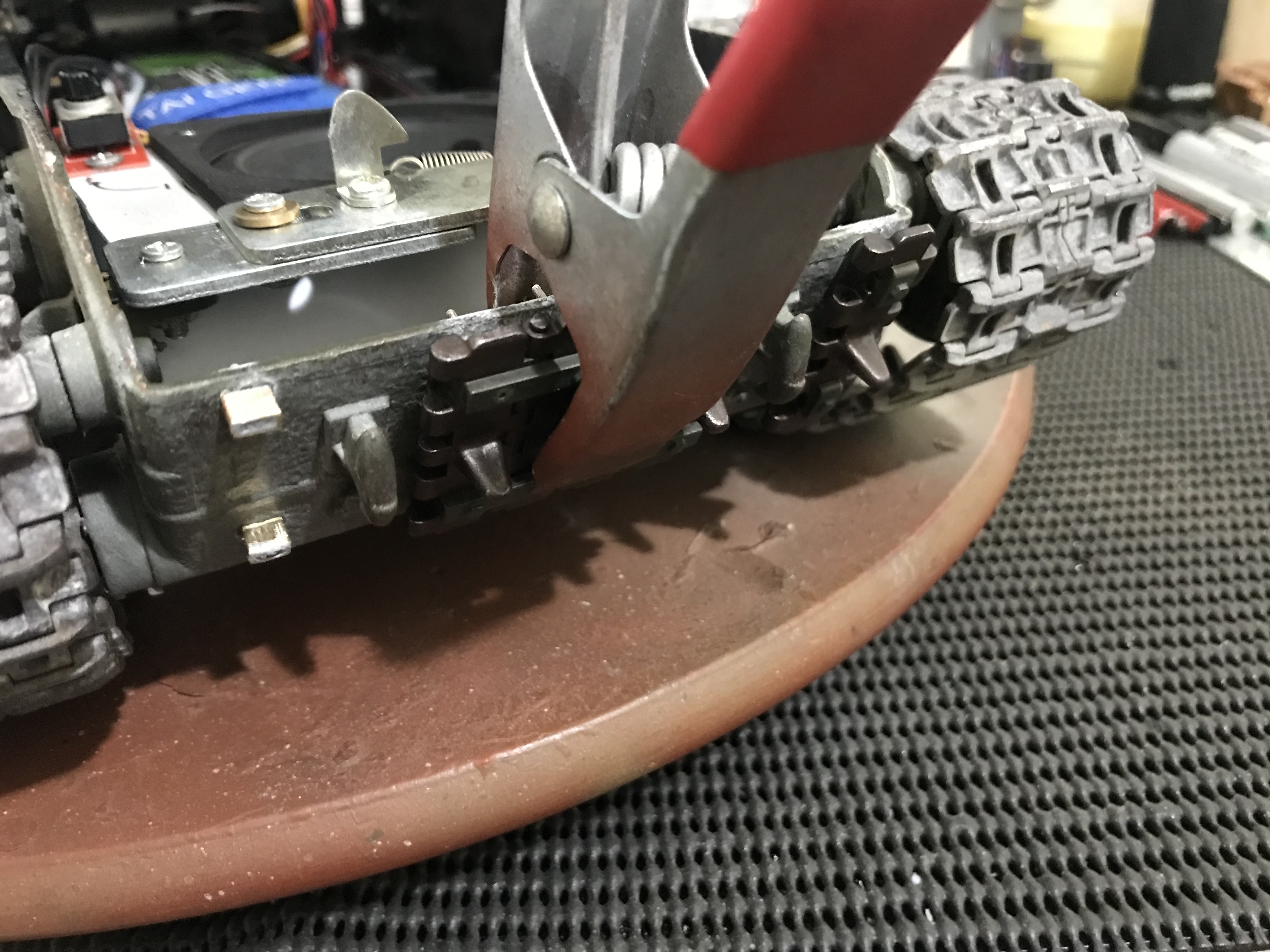

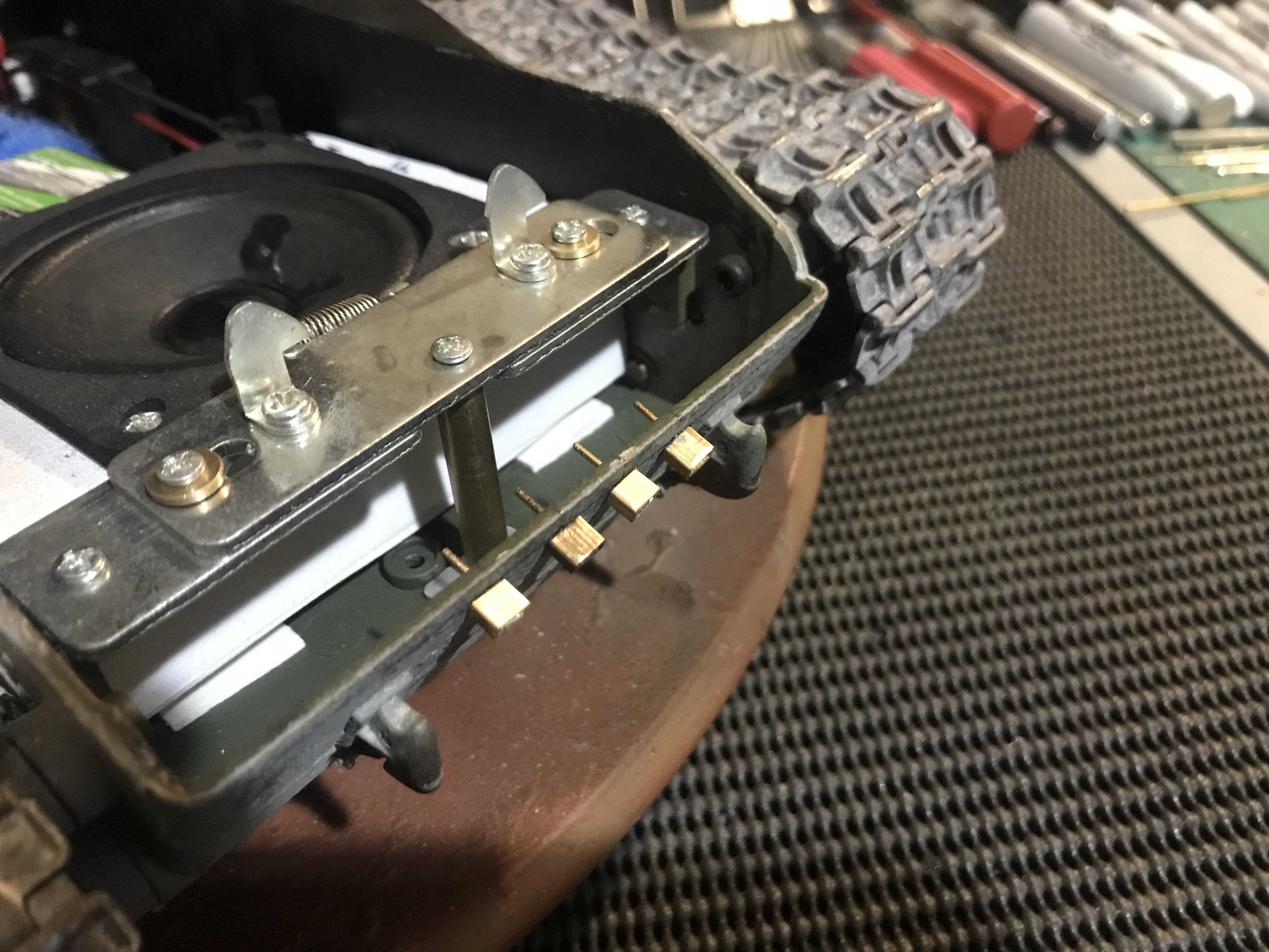

The mounts are all on, well at least the ones that matter, and are now setting with epoxy and super glue.
All except the lower-middle 4 have 1mm bolts drilled through the alloy hull and super glue, and the 1mm nuts & a washer on the bolt, again super glued in place.
If it busts off, fair play-so be it.
Putting 1mm nuts on the threads is a test in dexterity and patience I hope to minimise from now on :/
Once all dry, a bit of a touch up with paint & weathering to blend it together-job done.

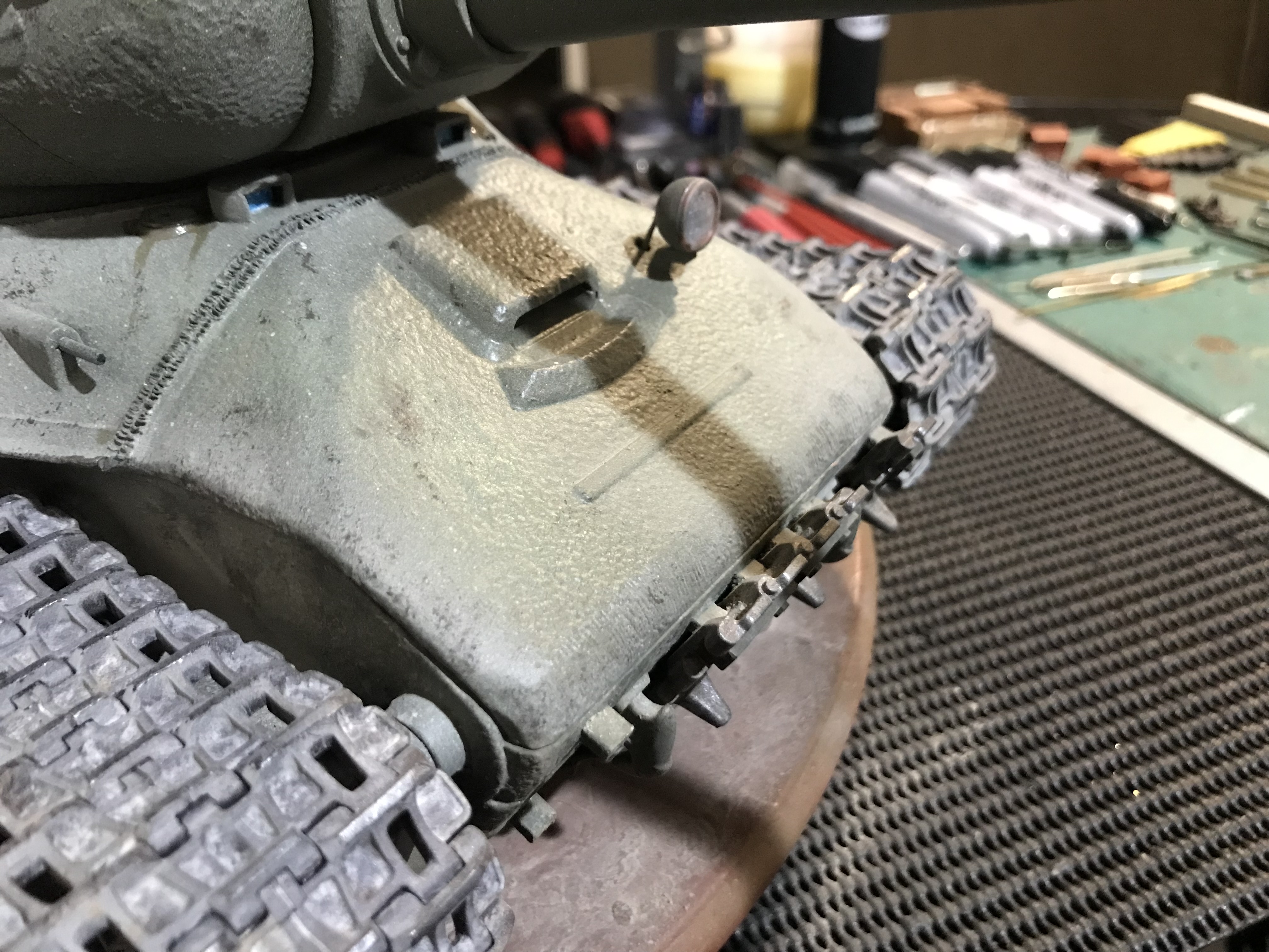

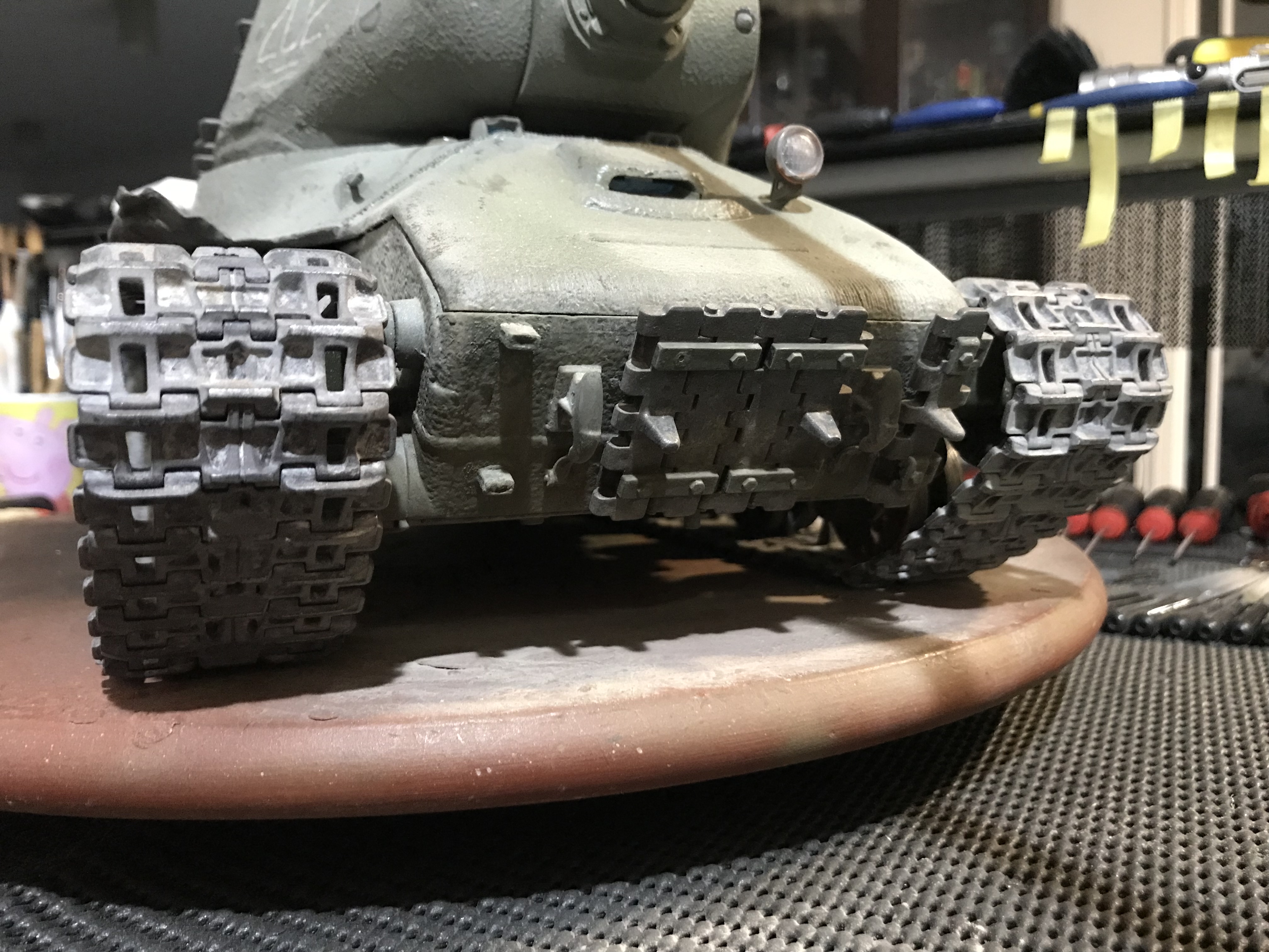

All dusted & looking way better.
I may do a bit more work to get the plastic track links looking a bit more 'metallic' but for what they do, these will do.
