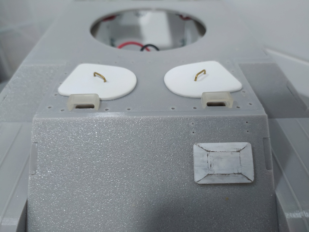

The driver and radio operator hatches are made with 2mm styrenne and brass wire for the handle. The periscope guards are printed in resin:
