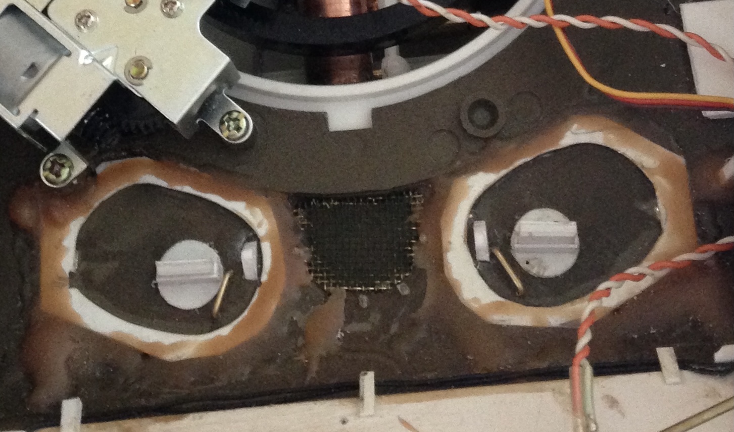

I got these a while ago on eBay and are taking forever to arrive.
They are MATO so does that mean they might not fit? Also any ideas on how to attach them to my HL hull to make them openable?

Hello
you must already remove the existing ones, to do this, mini drill and drill 0.8 or 1 mm maximum, be careful of breakage, then make a succession of holes in the existing one, to be able to then blow up with an Xacto or Cutter, then file to the dimensions of the metal hatch, and glue a piece of plastic or ABS card under the upper frame in order to prevent the hatch from passing through, plan to be larger in the roundness of the axis of rotation to drill the fixing hole , I hope to be clear enough, for understanding?

Ok thanks. Any pics of how I need to mount the plastic?

Also any recommendations from Amazon on what plastic sheets to buy? Or maybe it's better to get them from a local hobby shop? I've never used plastic sheets in modelling before.

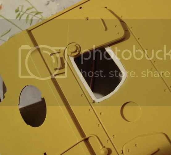

NAB wrote:Ok thanks. Any pics of how I need to mount the plastic?
here is a photo for a Sherman, but the principle remains the same (in white) ? thickness 0.8 / 1 mm maximum,
