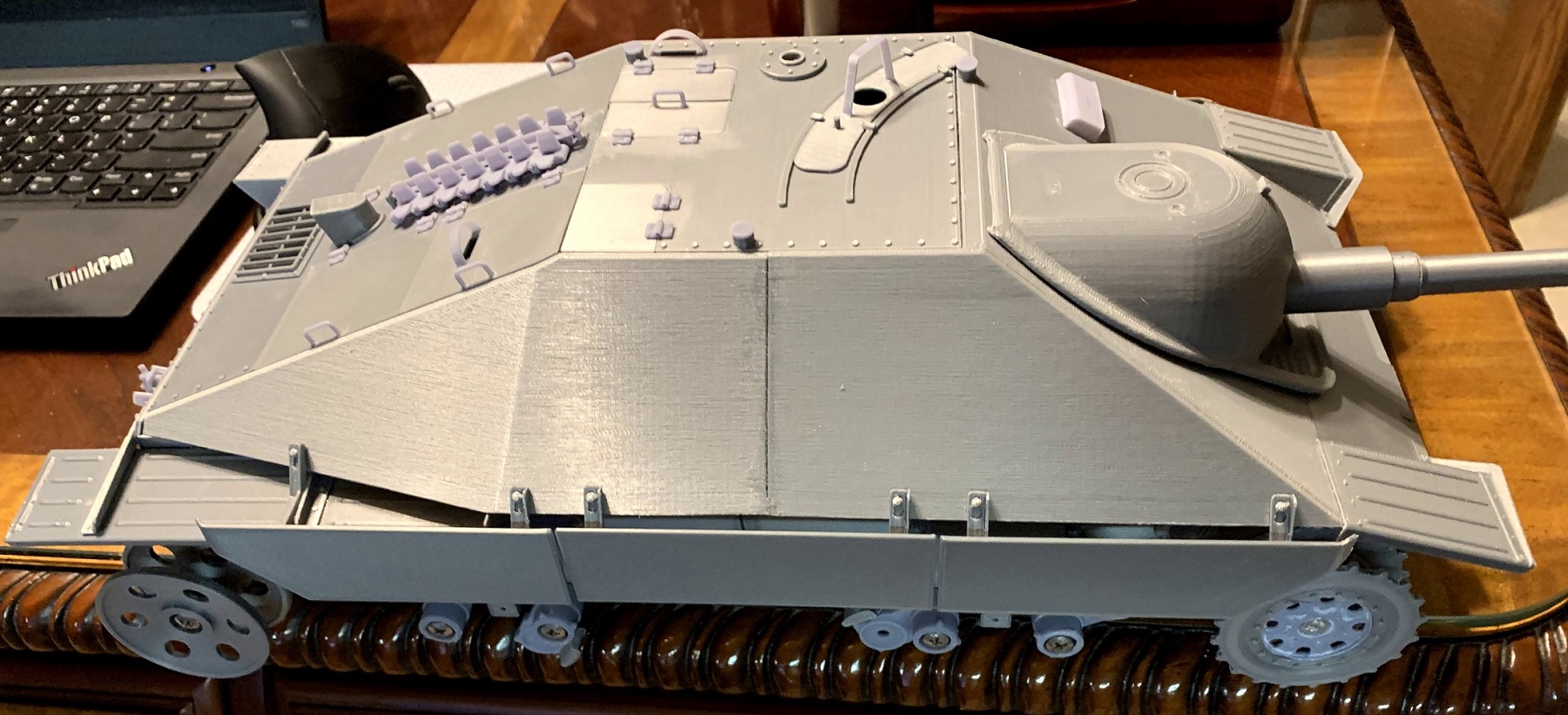

Did a few tweaks to the front fenders, printed and installed. Also made the Schurtzen and the brackets and got them installed. Only had to make those twice - first batch didn't have quite enough standoff from the hull and rubbed the tracks. Doh! Wasn't too bad to tweak the design, reprint, and reassemble. The Schurtzen install as full scale dropping over the studs on the hull and sliding into place, so they are all easily removable and re-installable. Also got the toolbox made, if I can get it off the print bed. The pile of bits that aren't on the model keeps getting smaller!

"The Schurtzen install as full scale dropping over the studs on the hull and sliding into place, so they are all easily removable and re-installable." Yours is such amazing work. It looks to me as if you were able to print the brackets attachhed to die Schürzen. Are the brackets a bit delicate? Or do they swing some on the studs?
Re: 1/12 Scale Hetzer

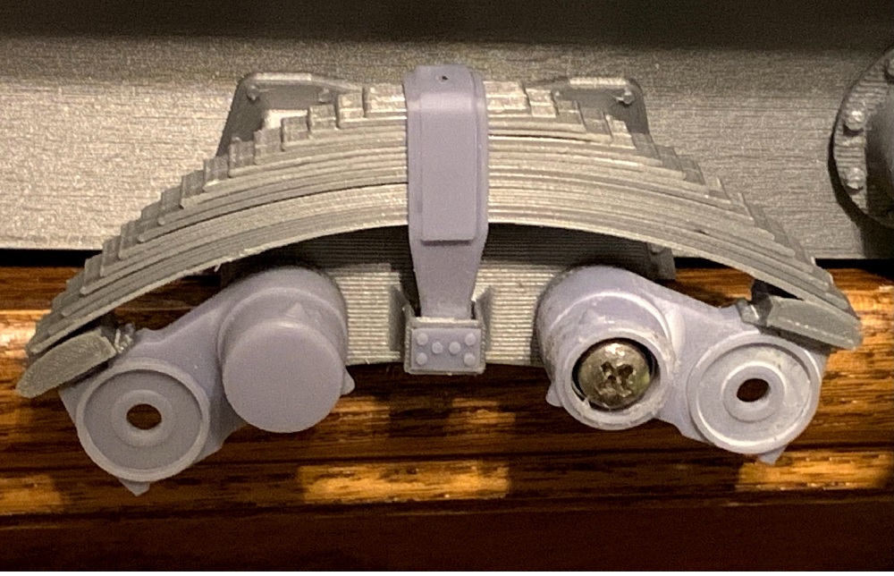

The brackets are maybe a bit delicate but have enough "give" that they don't show any signs of breaking; I can always use something like PETG if they don't hold up. I printed them separate from the schurtzen, then glued them on. they do "hang", but don't swing freely. I suppose I could make the hanger holes a bit bigger so they could flop around more, but kinda like them better as-is since they have so little mass. Next up is to try a couple different springs for the bogeys. I can't find reasonably priced spring steel, and my SLA printed spring leaves are a bit brittle and have sagged over the last few months. I'll try FDM printed ones and see what happens. Maybe PETG would be good for those. Soon as I sort that, the suspension can go back together (all the other suspension parts are done).Herr Dr. Professor wrote:"The Schurtzen install as full scale dropping over the studs on the hull and sliding into place, so they are all easily removable and re-installable." Yours is such amazing work. It looks to me as if you were able to print the brackets attachhed to die Schürzen. Are the brackets a bit delicate? Or do they swing some on the studs?

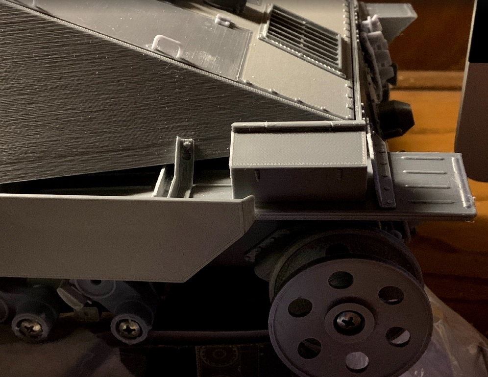

Made up the toolbox, which of course opens so you can put itty-bitty tools in it. Interestingly, I couldn't get a decent print with my SLA printer, but was able to with the FDM (Prusa) printer, including the 1mm hinge. Never know I guess!
I also printed up a FDM set of springs to try out in place of the SLA printed springs. If these don't work, I'll switch to brass or spring steel.

I have successfully used alot of 3d printed pla springs on many models, however with such a spring pack, i would expect the give in them to be very limited and maybe stress weaker points more than bending the spring pack.Spinnetti wrote:Made up the toolbox, which of course opens so you can put itty-bitty tools in it. Interestingly, I couldn't get a decent print with my SLA printer, but was able to with the FDM (Prusa) printer, including the 1mm hinge. Never know I guess!
I have however been ordering alot of very thin flat spring steel ribbons which can be bought in many different widths. That would i think work better for your needs, but it would be interesting to see how you get on.
As for the toolbox with working hinge, i find more or less the exact same thing. although resin printed boxes look much cleaner, their hinge areas are very weak compared to fdm printed parts. The fdm parts with hinges definitely tend to have more strength and give to them which works better in the long run.
