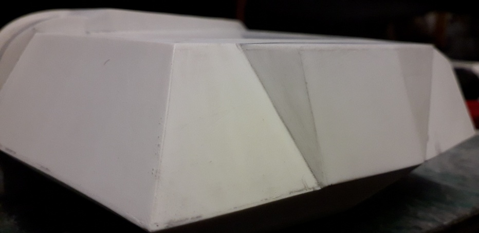

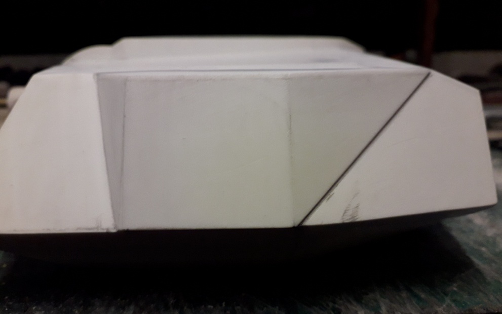

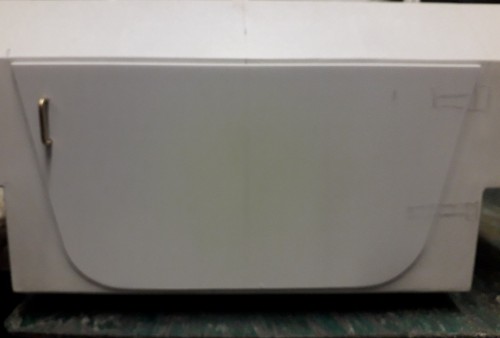

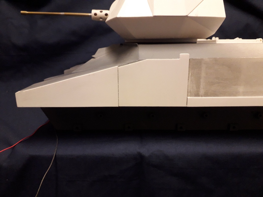

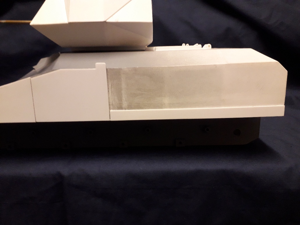

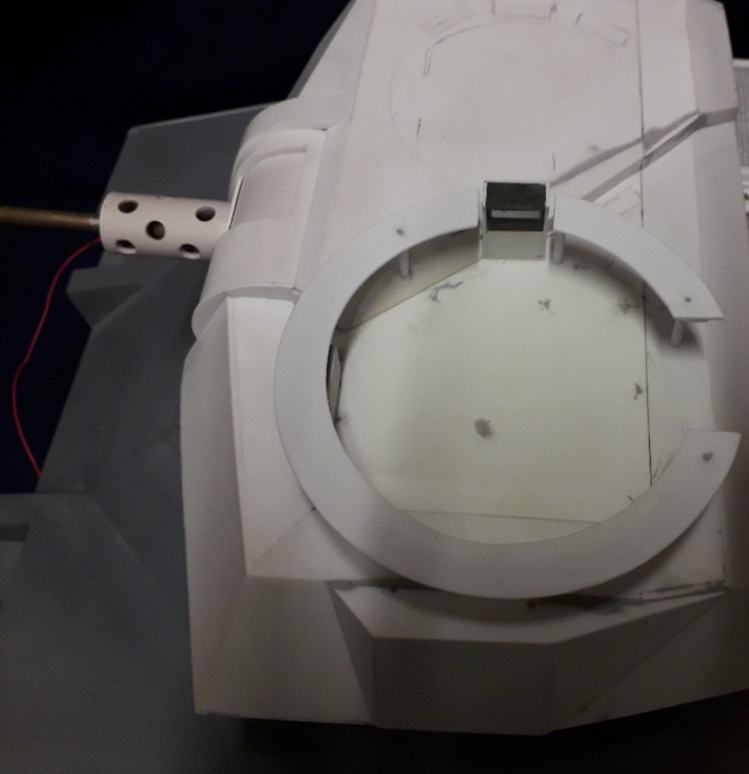

Added the additional gunners turret side armour and the hull front additional armour plus the 2 side opening doors
( concealed hinges are all on the inside.)

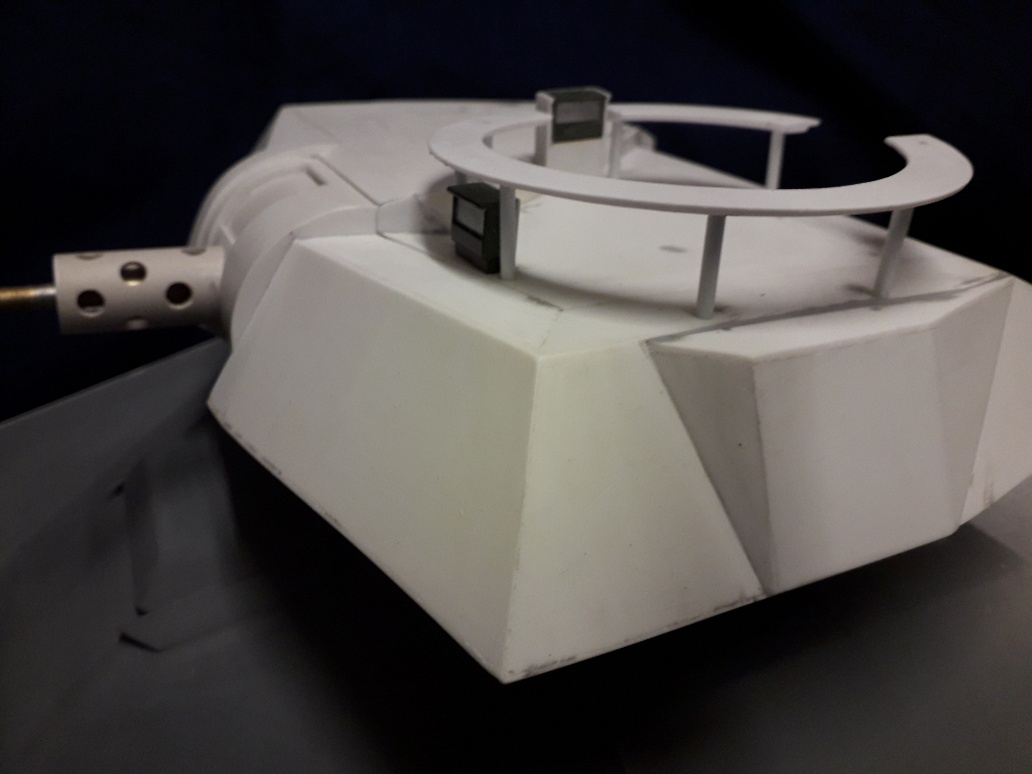

Also added 360 degree rotaion to the turret.
Now to work out the secondary armourment of the gunners MG, this is on a circular raised platform above the hatch, it will have to be in 3 pieces as there is a commanders periscope built into it plus the gunners hatch hinges pass through the ring when the hatch is opened.
Then the 2 hatches, these are huge and dome shaped, so will have to cast these from resin i think to get the shape.
Sub.

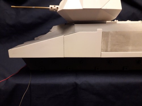

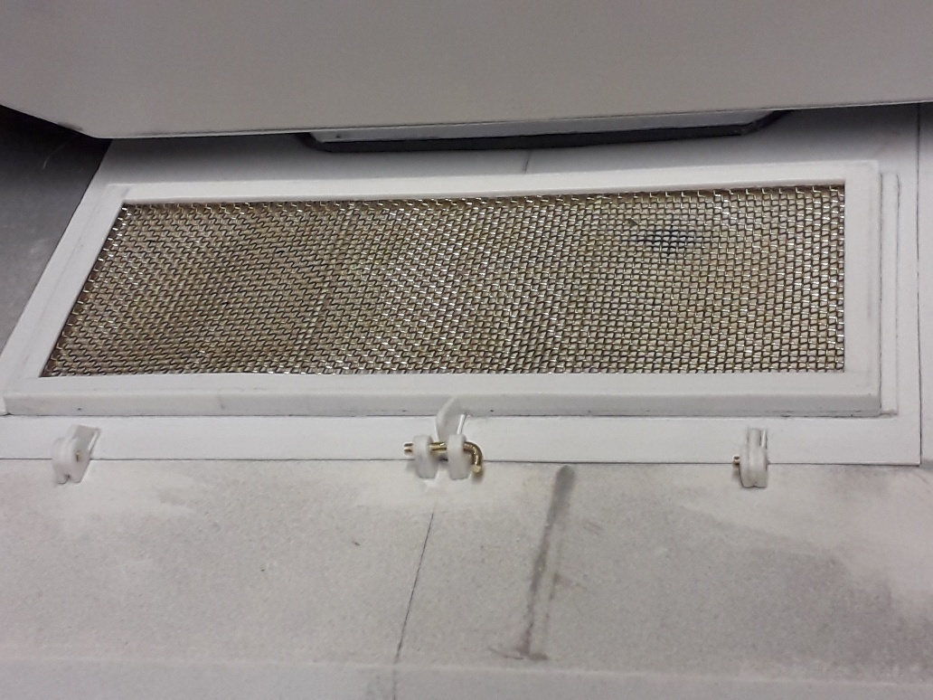

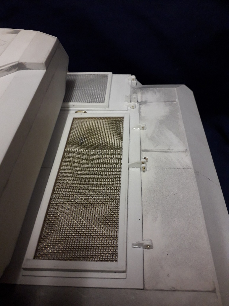

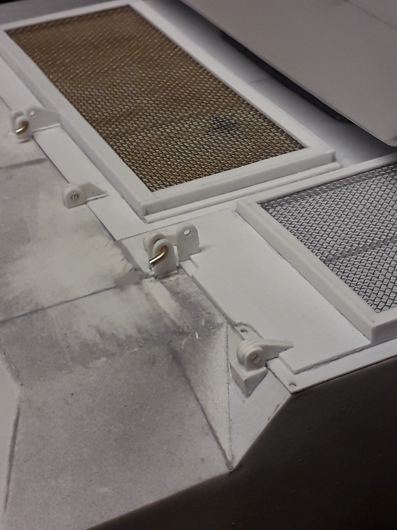

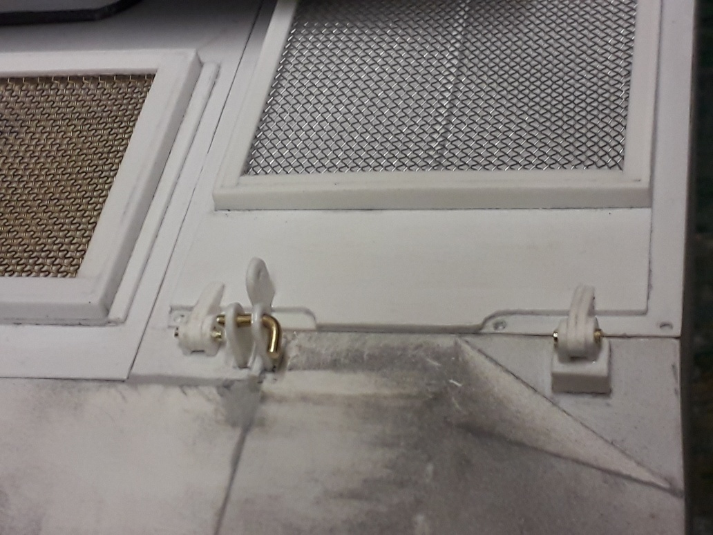

Engine deck and cooling grills started.

What mesh did you use for the covers ? One type has a very tight & wave’y weave.
Sub
Posts: 733
Location: UK
Re: Scratch build US Army "Scout" Armoured recon vehicle XM8
Post by Sub »
Hi Mr Bix.
Thank you for your continued interest and feed back.
Which mesh are you refering to plse.
The brass one is well brass mesh picked up at a model engineering show, the silver one is stainless steel mesh.
Cheers.
Sub.

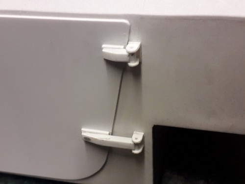

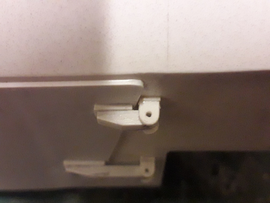

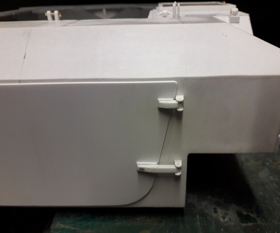

Rear troop door started, it is quite large.
Sub
Sub
Posts: 733
Location: UK

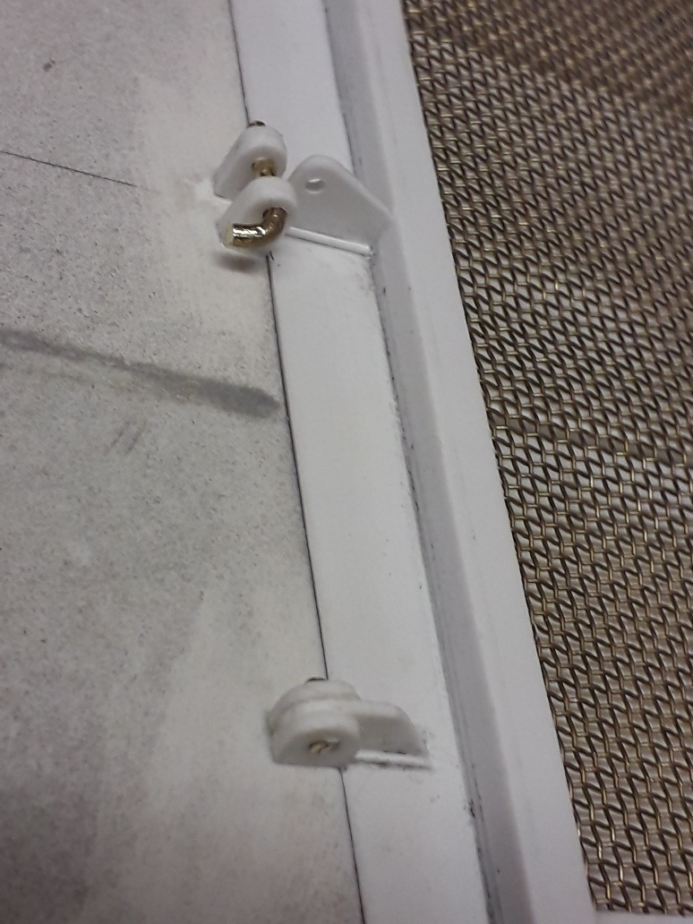

Post by Sub »
Door hinges added
