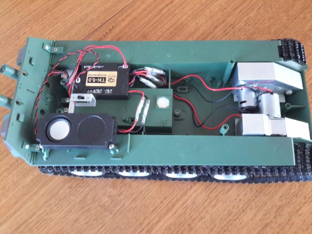

Considering the hull construction of the Panther. To keep the smoker. Fitting the TK-6 upright to the left side of the hull. Having the ON-OF switch under the engine hatch. The smoker would have to be moved still backwards where the studs holding the two hull parts together. Just to much to keep the smoker. Having all that space up front though, a special smoker could fit there.
But that would be another project.

Re: Metal upgrading new Heng Long Panther G
Is that funky slimline speaker the one it came with ?

Post by walter »
Yes the Heng long PantherG came with that slimline speaker.

Post by cashybai »
Cracking job there. Just a thought, did you consider cutting out the battery box? That would have freed up a helluva load of space inside the hull? I'm asking & following with interest as a Normandy/Ardennes Panther is high on the list of to-do's....

Post by walter »
Hi cashybai,
frankly speaking, cutting out the whole battery box has not occurred to me at all. I must admit it is a very good idea.
