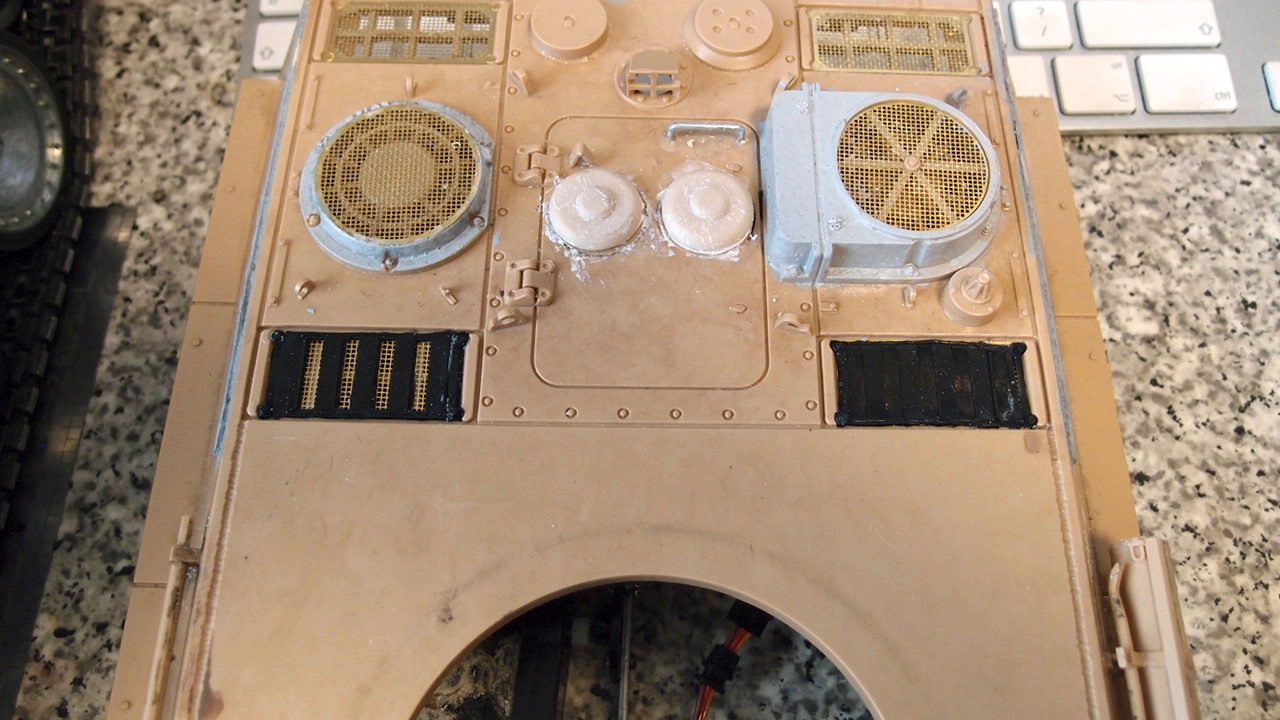

Fitted covers at front grills , will try a different resin next this stuff is elastic if very thin.
The open vents turned out better.

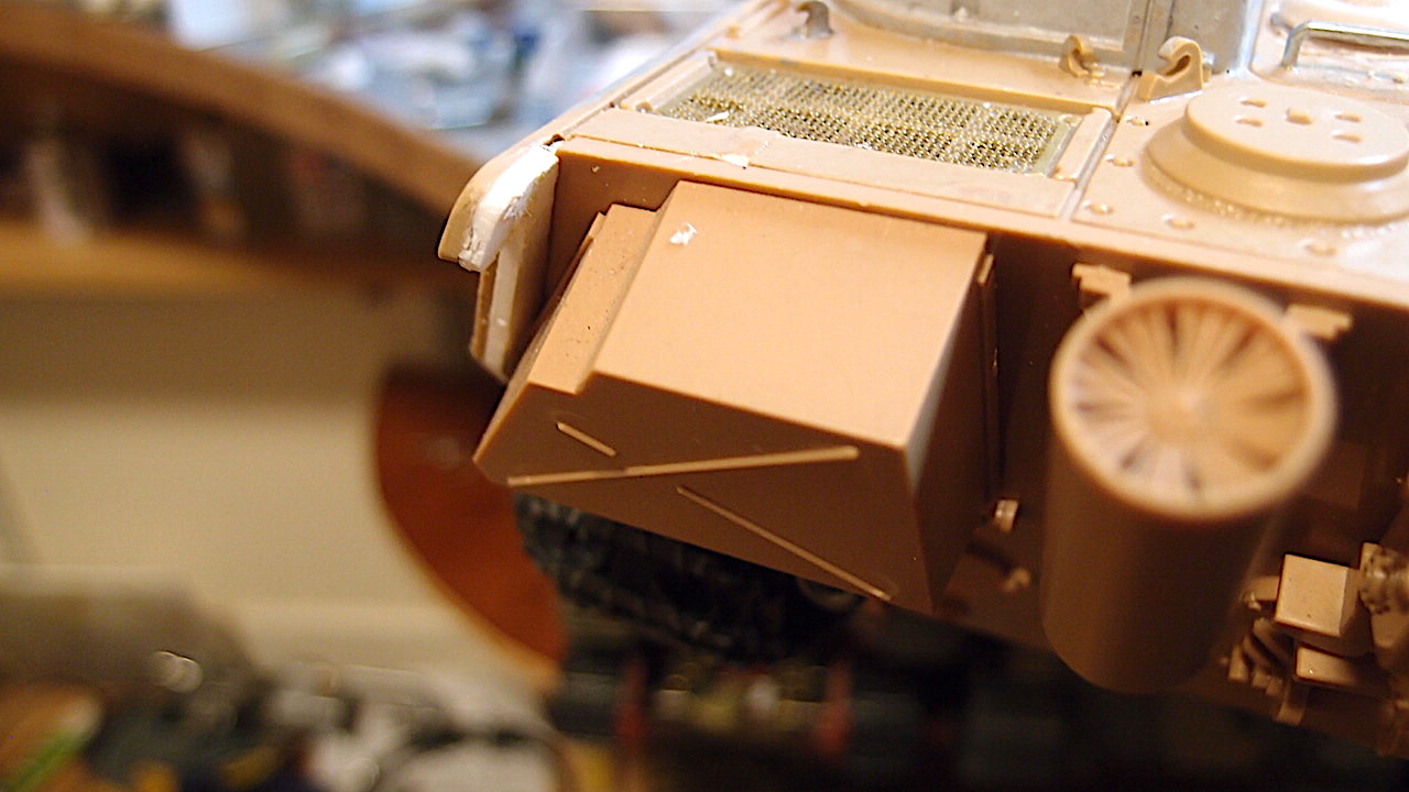

Onto the little changes , cut off the stubs and made handles with chain for the gun cleaning tube.
A bit more realistic now.

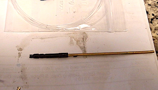

1mm fibre optic for the mg wrong size too big.
tight will buy 0.75mm dia  fibre optic .

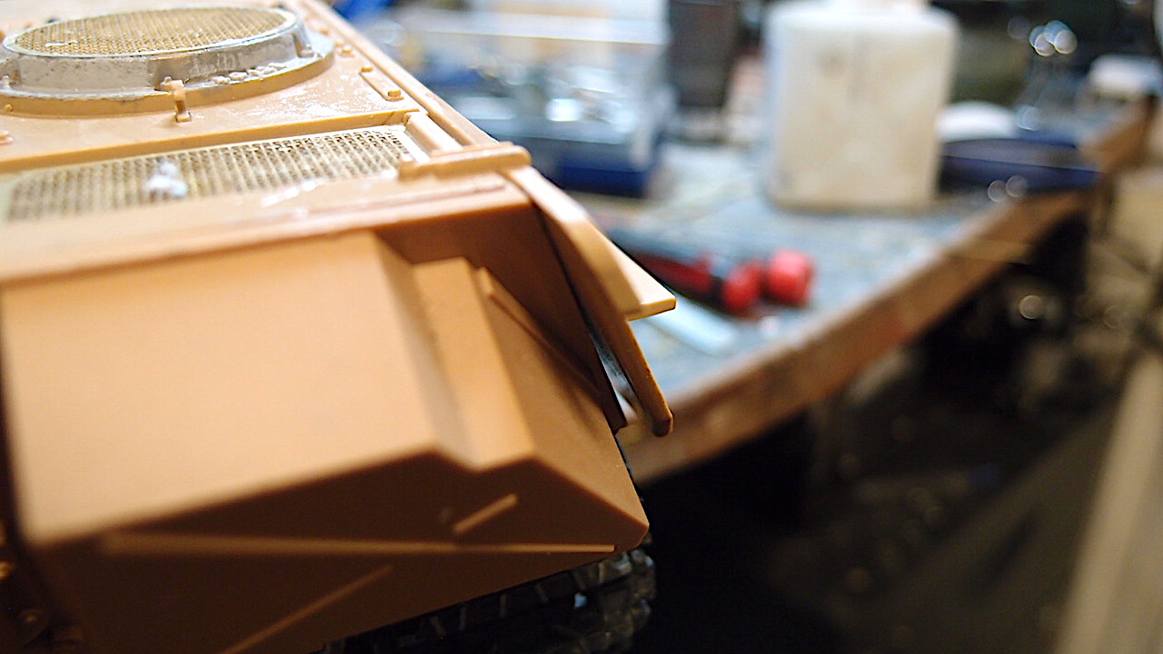

Giving the rear scale armour effect, the hull plastic has not been made scale at rear .
Too thin for scale 50mm armour plate
Plasticard to beef up
One side done, cut marks next.

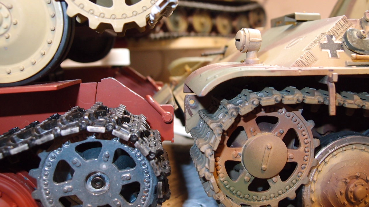

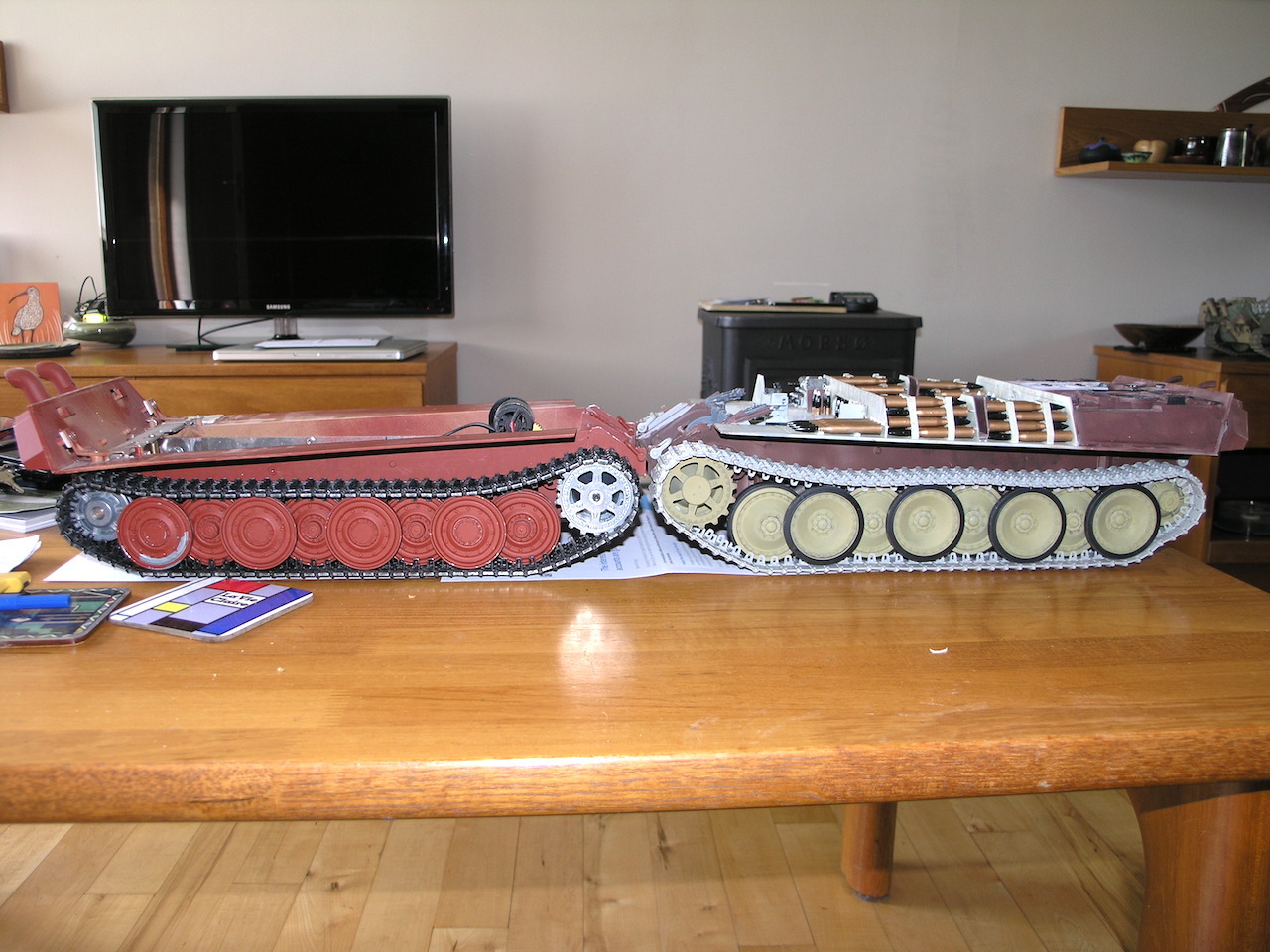

Need to find out if someone fixed the Taigen hull ,front is wrong. HL was easy as its plastic :D
Sprocket is low and too far back
Trumpeter sprocket and chain further forward , HL after the fix. Found the fix on a rc forum

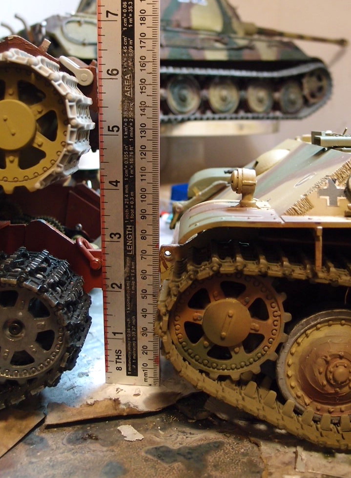

Think i might have to buy the stronger wire upgrade for the suspension it looks as if the hull has sagged. The HL panther was easy as the hull is plastic , changing the sprocket position on the Taigen will not be an easy fix due to the metal front.
Hull is lower compared to the Trumpeter and sprocket needs to go forward and up.

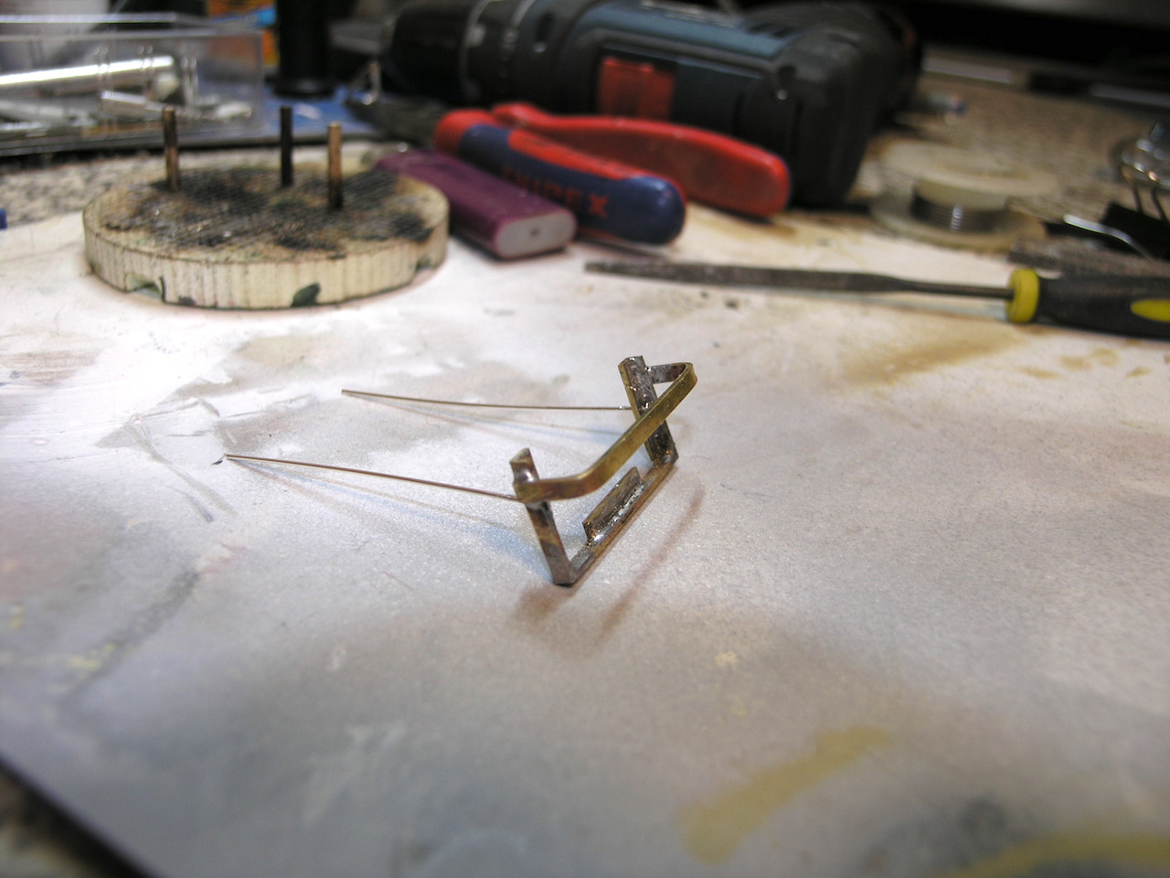

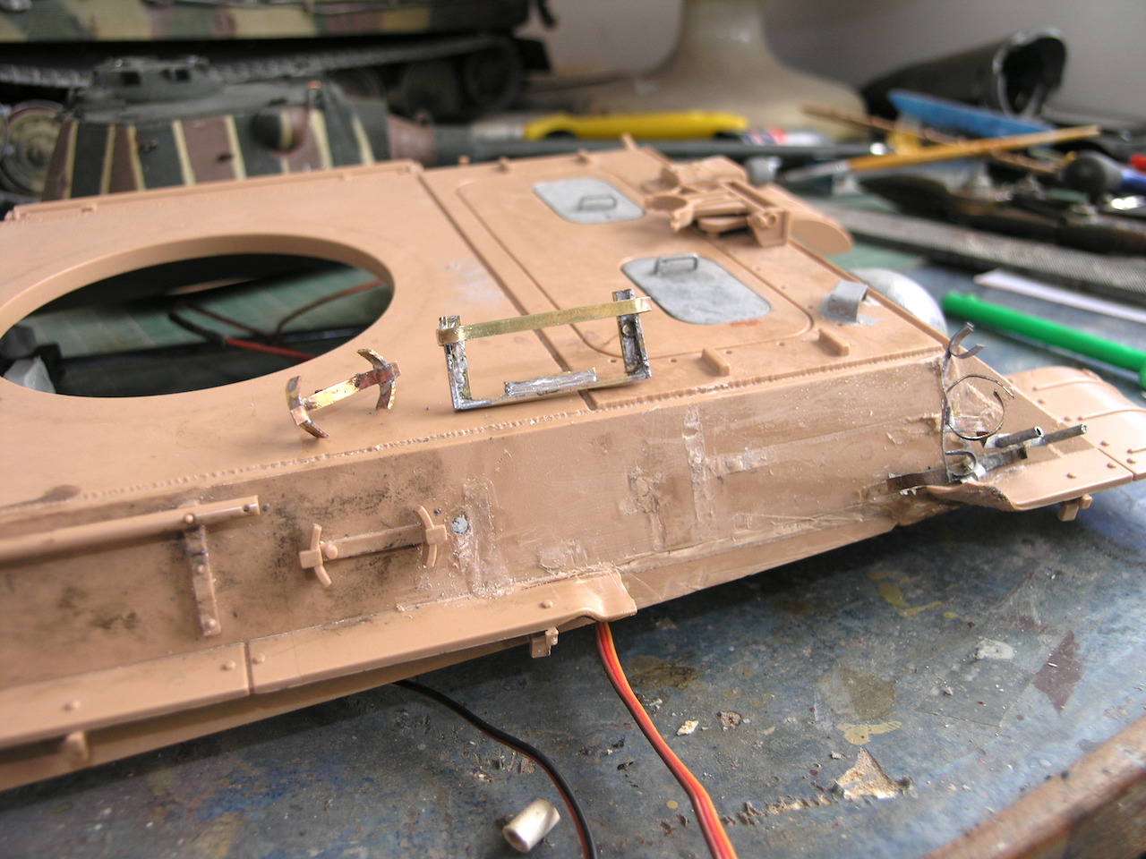

The PE sprue was too fragile so started to replace the block holder and the tool rack, was easy to bend out of shape . Found some brass strip the correct size much stronger.
Block holder
Block holder

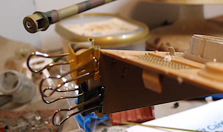

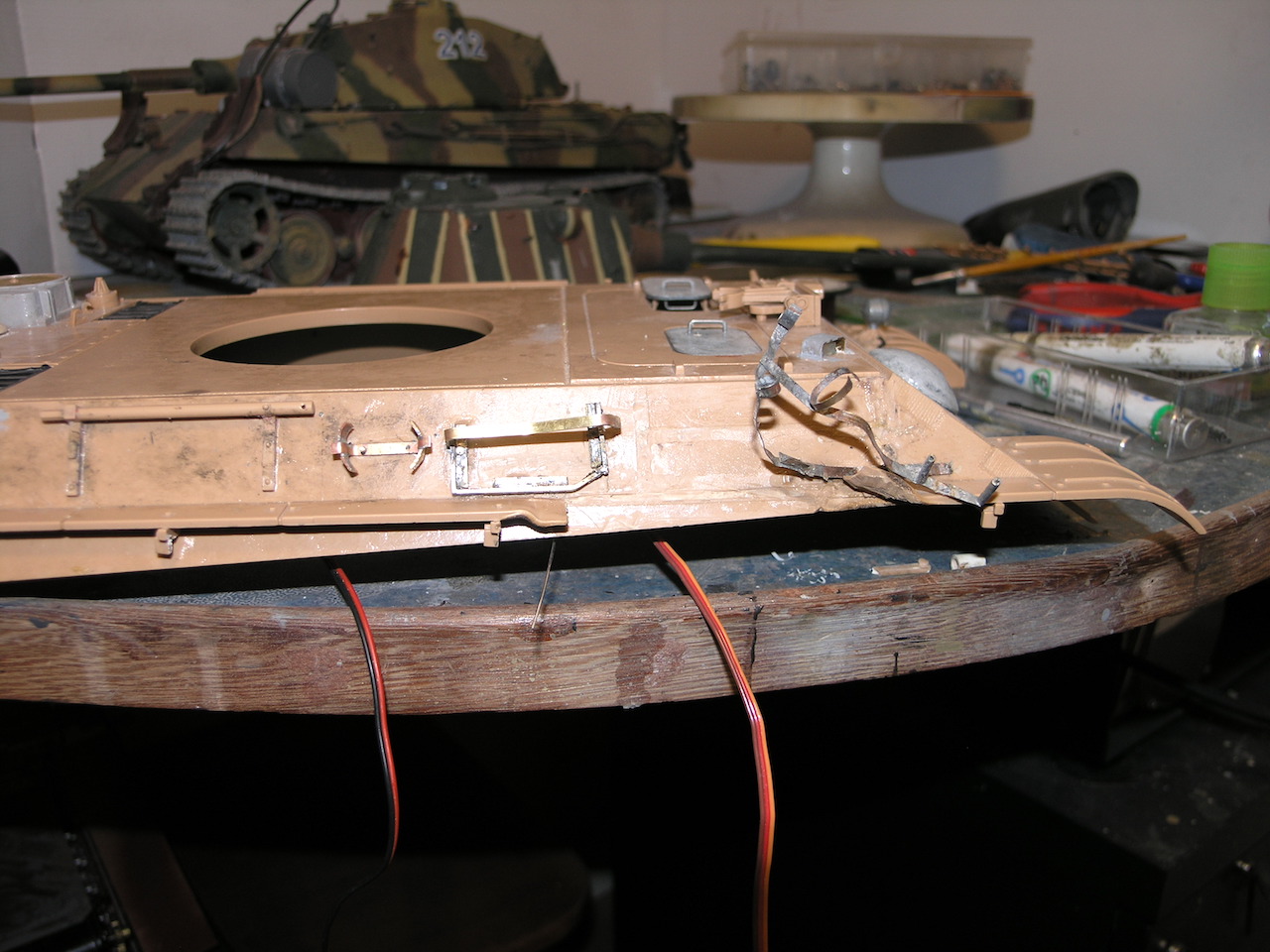

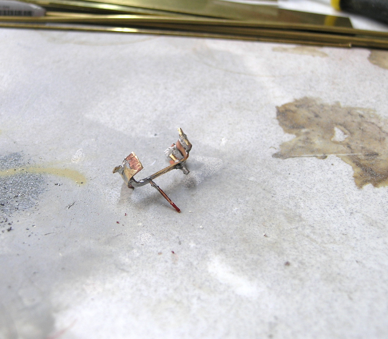

Track puller cable holder done , found some more brass rod/ strip in various sizes for the cable eyelet holders.
This lot should do for everything.
Holder for track puller cable
Brass strip is easier to use than the copper/PE sprue holds its shape when soldering.

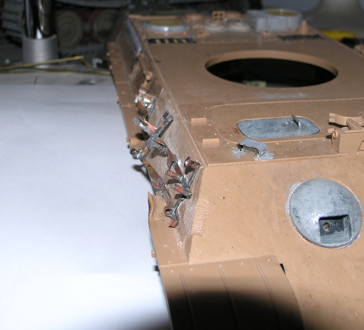

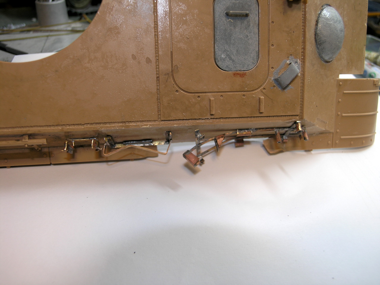

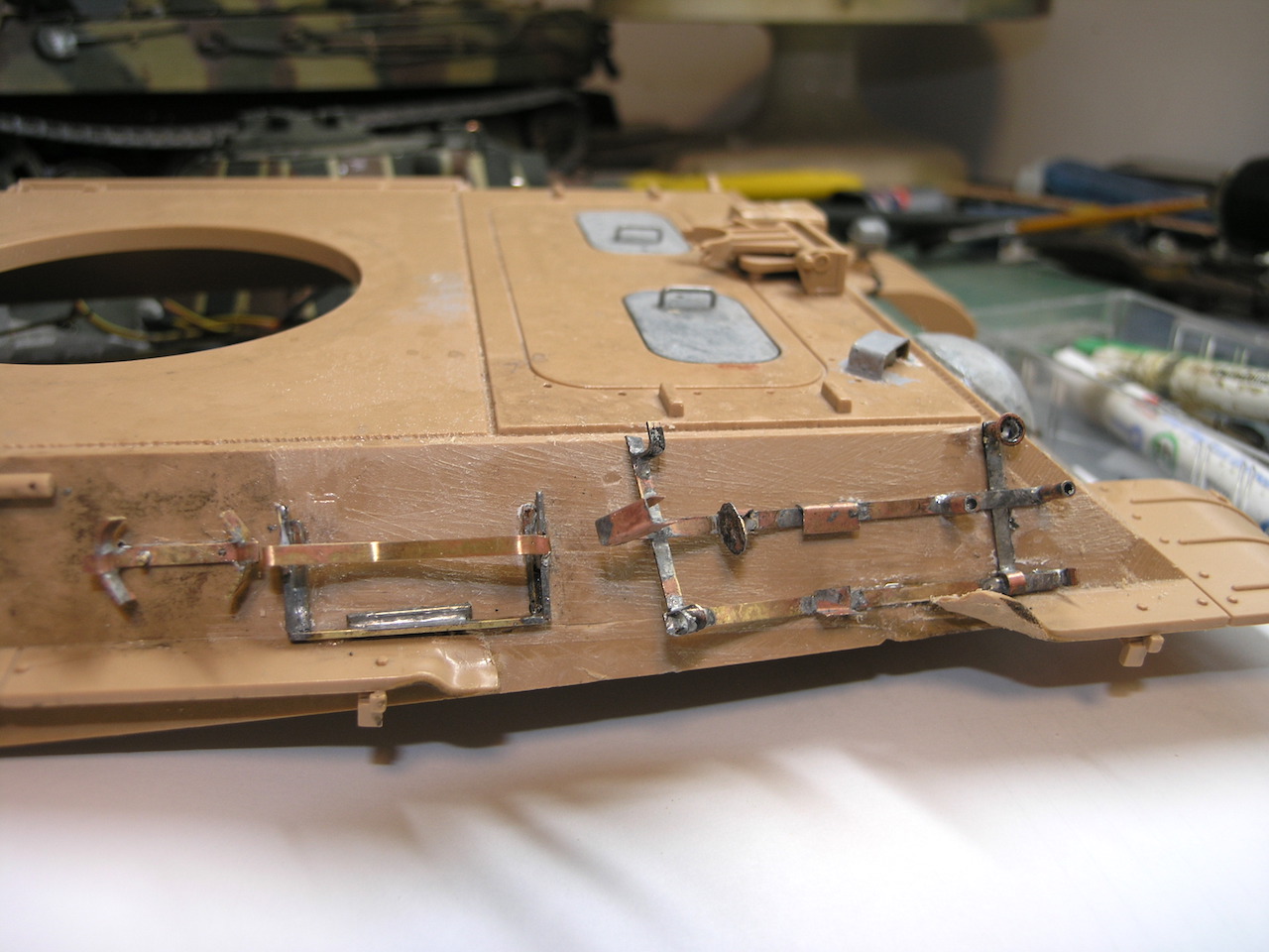

Thanks Wildboar The damaged tool rack has been improved and the block housing has thinner brass work to match rack and track cable fitting.
Block holder and tool rack 1st attempt
Final version of damage
View from above.
View from above.
. Next up the track holders.
