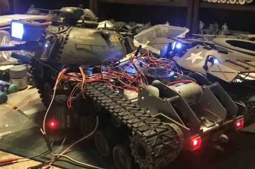

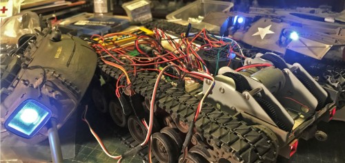

A short post for the finalization of the electronics.
Now, I was supposed to install a new Clark Leopard 1 TK40 ordered from eBay but it never arrived and I might have to file a Paypal claim. Very annoying but tired of waiting and i want to finish the model, I decided to install a TK60 that I had available. It is rich with the needed RC features, but the engine will sound like an WW2 Elefant. For sure, the Leopard 1 MTU MB 838 CaM 500, ten-cylinder, 37.4 liters, multi-fuel engine would have been closer to the Continental AVDS-1790-2 V12, air-cooled Twin-turbo, but I wont wait. Not sure I am actually able to notice the difference. Engine sound is not the highlight of the model.
There is a tremendous volume of cables to connect and configure with the TK60 and RC channels. Because I need the VRA and VRB knob for the cupola, I also had to reassign many items to available switches. So, there was a lot of trials and tests needed but I managed. Also had to add resistors to the Mato tail lights in order to be compatible with the other lights. The model RC features are;
- Gearbox
- Turret rotation
- Main gun servo elevation
- Main gun recoil servo
- Main gun flash
- Coax Mg flash
- Cupola servo rotation on VRA knob
- Cupola servo Mg elevation on VRB knob
- Cupola Mg flash
- Headlights
- Tail lights
- Xenon search light
I think that's it.

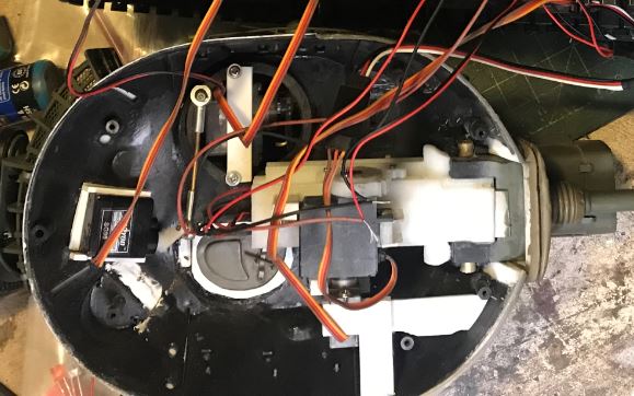

Turret interior

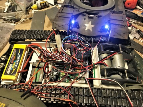

Overview of the hull electronics. Removable trays were created for the gearbox, main electronics and the battery and they sit on top of the suspension without touching it. What you see are;
- Heng Long metal gearbox
- Clark TK60 control board
- Flysky FS-IS10B 10 channel receiver
- Small Heng Long speaker and manual volume control
- Zippy compact 1800 at the front with Heng Long switch
Now, all that cabling will be soldered, placed and the hull closed for the test runs.
