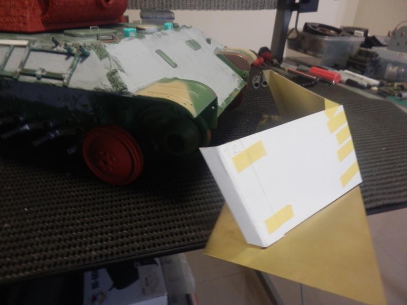

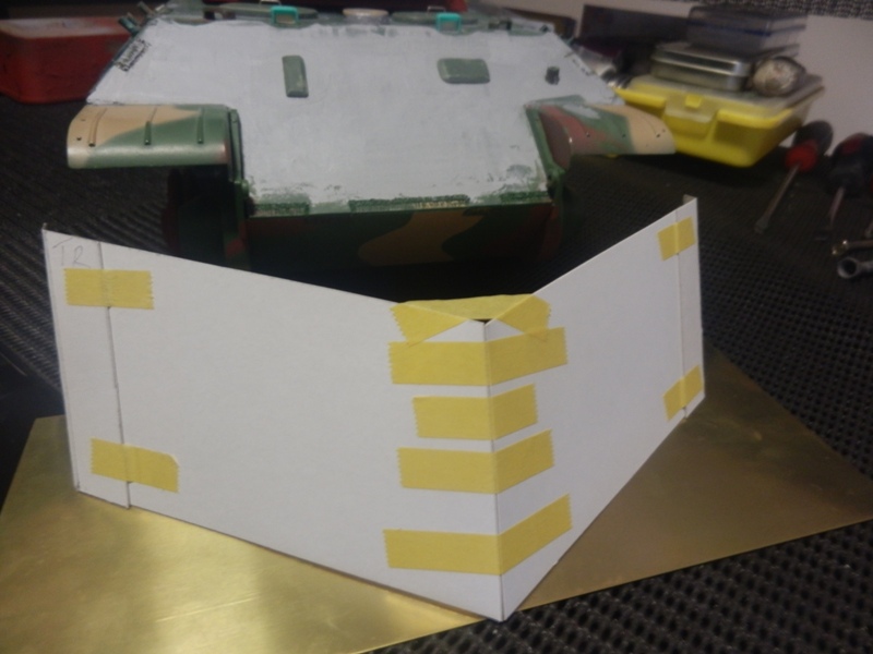

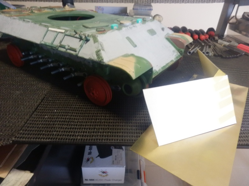

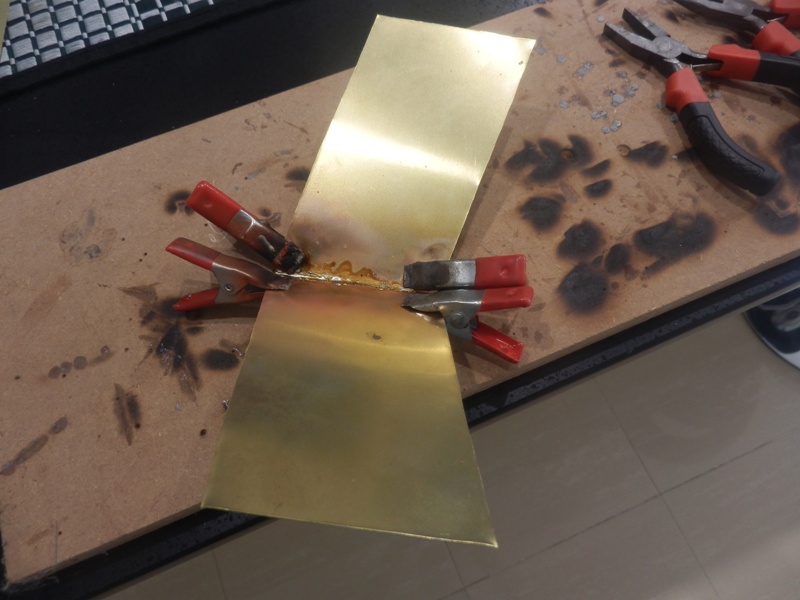

I got a few moments before the qualifying session to get the template made for the blade on this "D9"
Using the pictures for reference on height, then cutting the cardboard to suit, trialing a few angles & securing it together with Tamiya masking tape, seems to look about right.
The angled section that runs along the top edge of the blade is yet to be made, but will not be overly difficult.
I plan to solder the lot together using the reinforcing plates quite visible in the period pics to stiffen and beef up the structure.
The inside of the blade can then be tested for various mounting methods to join the blade to the tank.

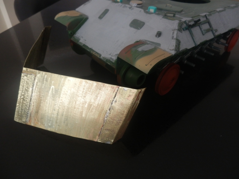

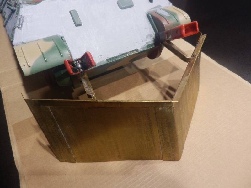

Rugby world cup has absorbed a lot of my focus recently.
Basking in the glow of an All Black victory, I got the 'dozer blade almost fully formed out of brass.
The cardboard template worked a treat and I had only minor trimming to do before using solder paste to secure each part.
I roughed up the mating surfaces with a sanding drum on my Ryobi tool to ensure maximum 'keying' for the solder.
Bunged on the paste and hit each section with my Brulee burner.
The top angle section will be done soon.
I did deviate from the picture a wee bit by making the centre plate bigger, just to add further assurance that the thing can take a hit without failing.
Once I settle on the arm material, I will get the mount supporting frame on the back done.

Now the distraction(and depression) of sport has reduced(not the depression bit) I can get on with the dozer.

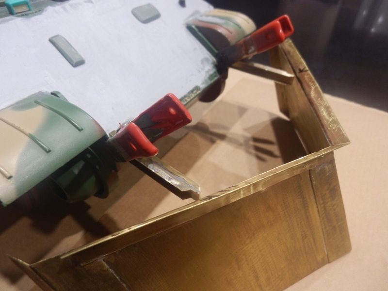

Found a very small stash of brass C-channel in a far away hobby shop, bundled the family into the car under the pretense of a "day out for a drive" and sauntered off to secure said brass material.
Using new solder paste to bond two lengths back to back to give me a profile of 8mm web, & 6mm top flange in the shape of an 'I'-beam.
Each end was shaped to allow the mounts to have limited travel up & down.
Scale length of 1050mm long X 100mm wide top flange X 128mm high centre web.
Enough strength to cope with the load I reckon.
I've still to do the lower mounts that will attach to the final drive housings on the lower glacis plate.
These I think I will screw directly into the inside of the final drive housings to ensure as much strength as possible with an all plastic hull structure.
Of course having a Taigen metal lower hull would be much betterer !
Small steps in a forward direction.................
