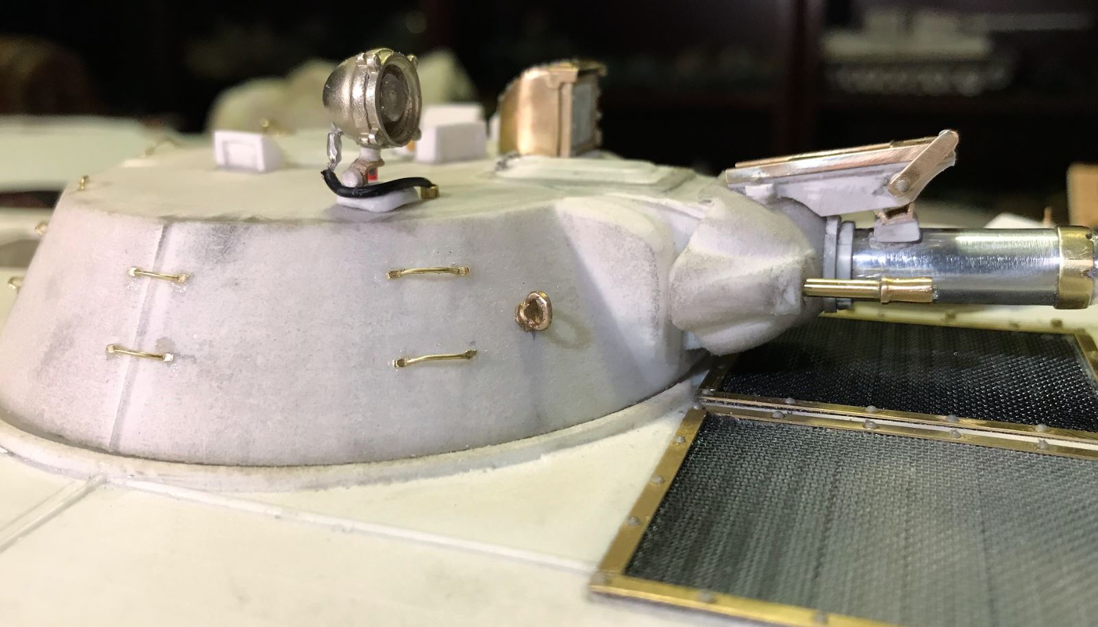

Here presenting the finished turret exterior.
The Ludwigs kit only provides a skeleton turret shape and a couple of plasticard plates so everything else needs to be studied and scratch built. The Topshots book on the BMP1 is therefore essential with close ups of most components to fill the gaps.
Ludwigs BMP1 BMP-1 RC 1/16 IFV

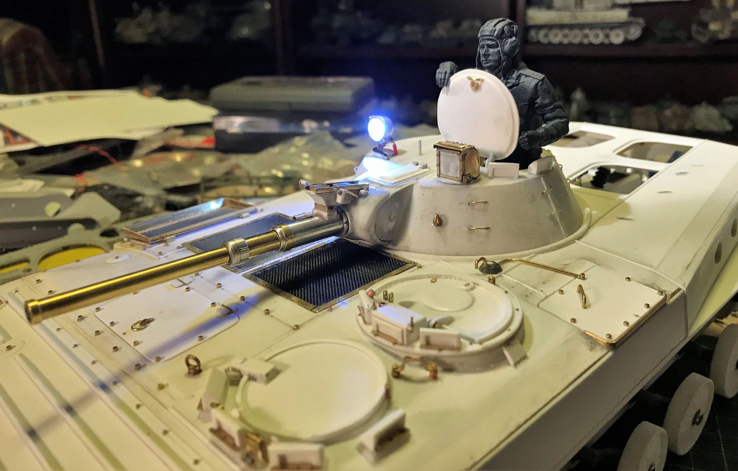

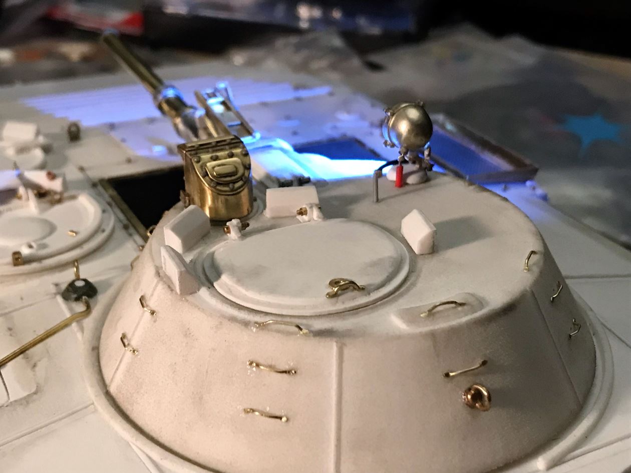

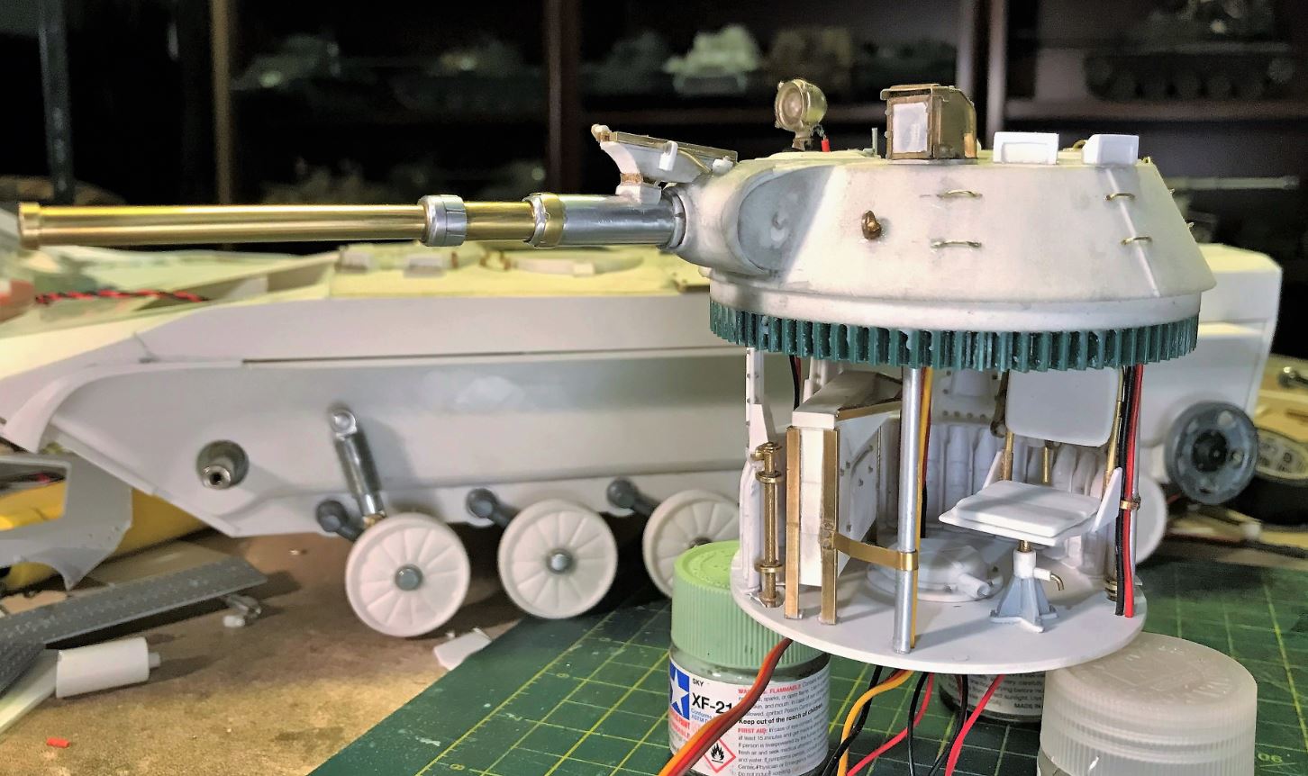

The completed turret. It is small but I equipped it well. I was previously able to give it a turret basket interior, turret rotation, gun elevation, gun recoil, gun flash, coax MG flash. Now it also has a working spotlight and a manually opening gunner's hatch. There is a large number of electrical cables coming out of the bottom.

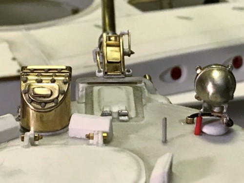

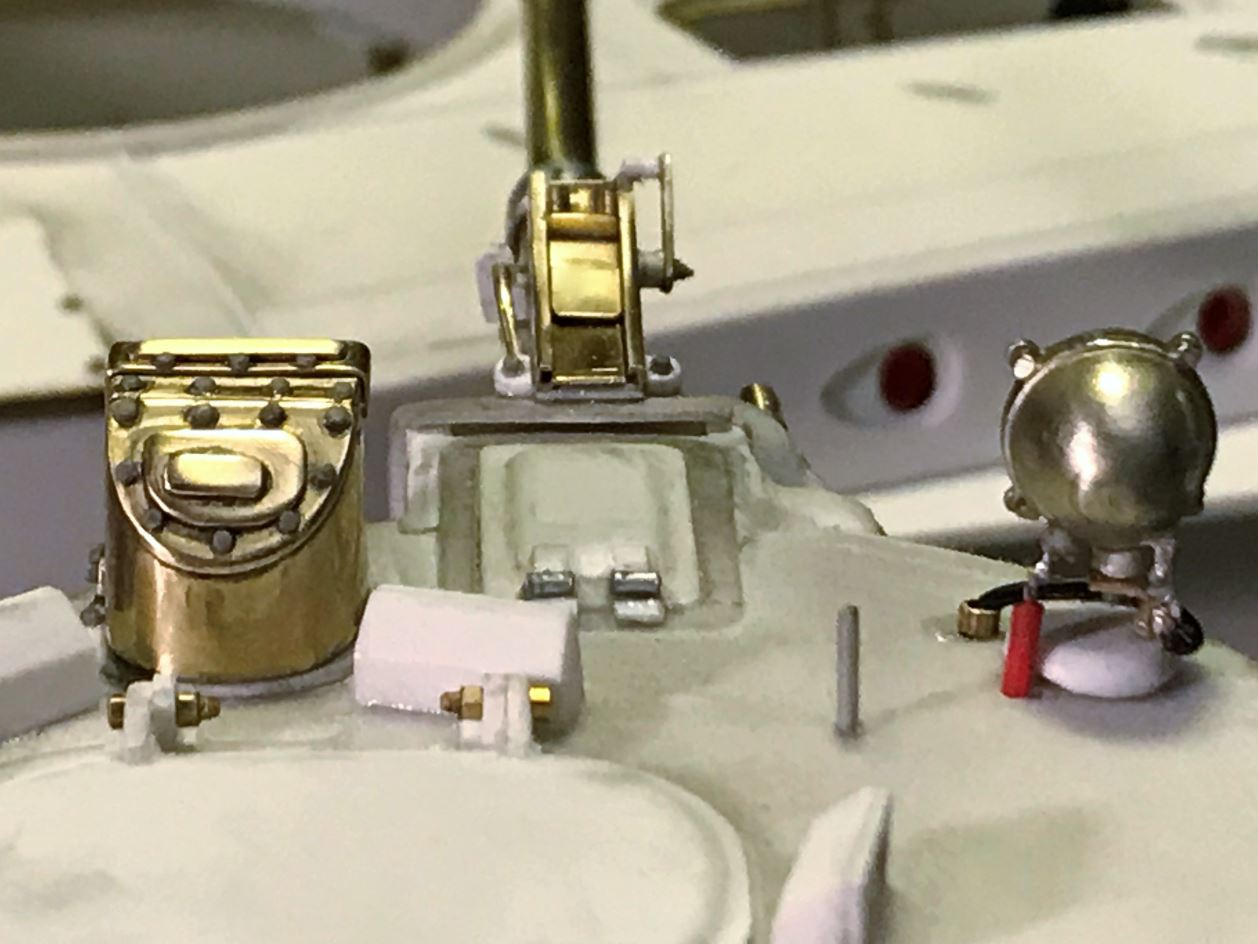

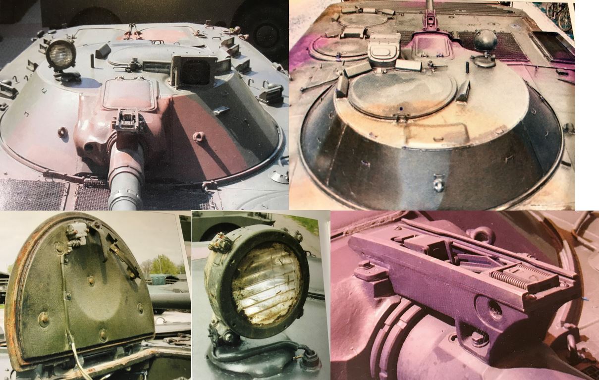

I had to study all references to recreate the exterior. The spotlight is an T55 item from AFV_Model, the rest is scratch built the best I could with what I had in material, with the couple of days I wanted to spend on it. The optical device was fun to build in brass.

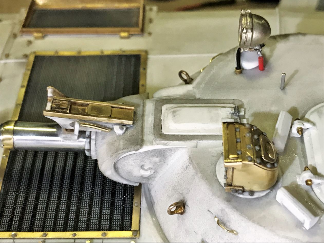

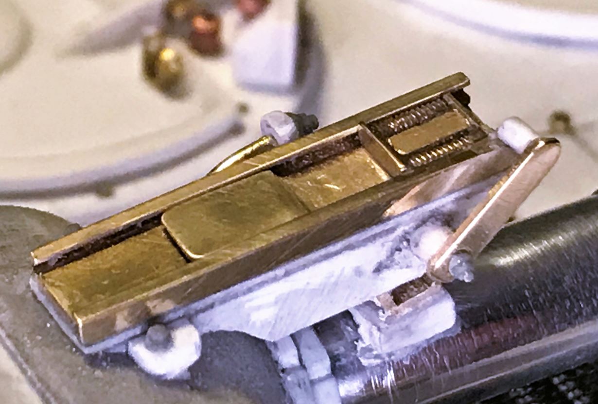

I decided to create the Sagger missile launcher ramp on top of the gun barrel although I did see that it was sometimes removed completely. No short cut...
The long trap door behind the Sagger missile ramp is for the gunner who opens it in order to manually slide a new missile on the launching ramp without being too exposed.

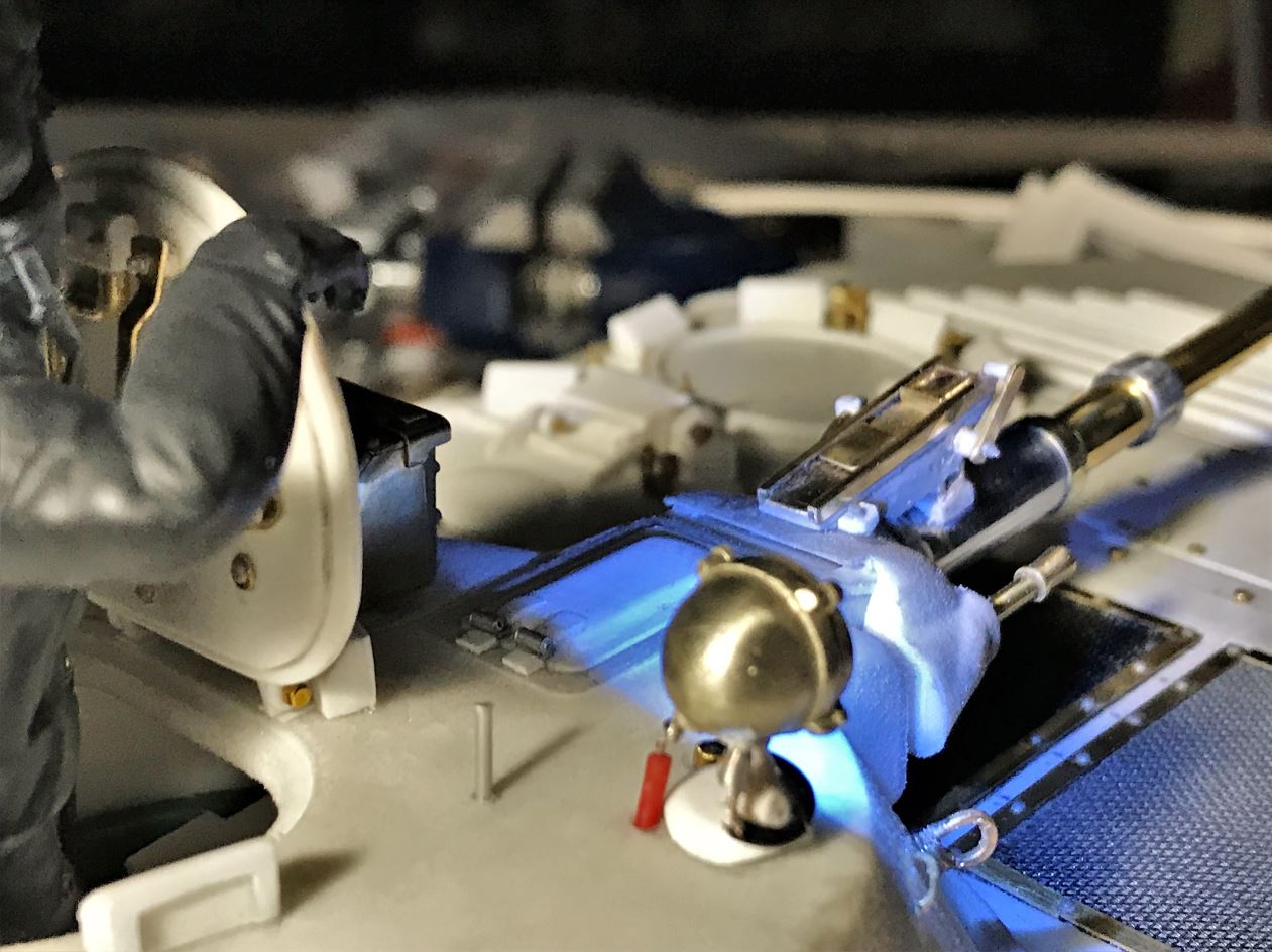

The 1/16 Maim 3D printed Russian gunner figure shows how small the BMP one man turret really is.

The inside of the gunner's hatch was given details because it will remain opened.

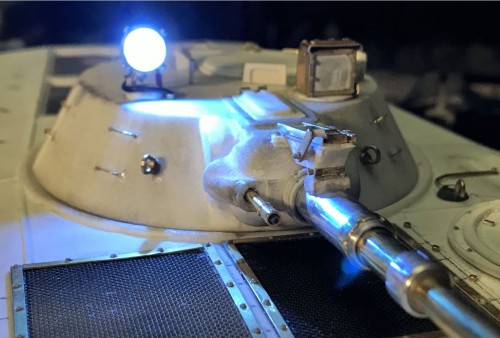

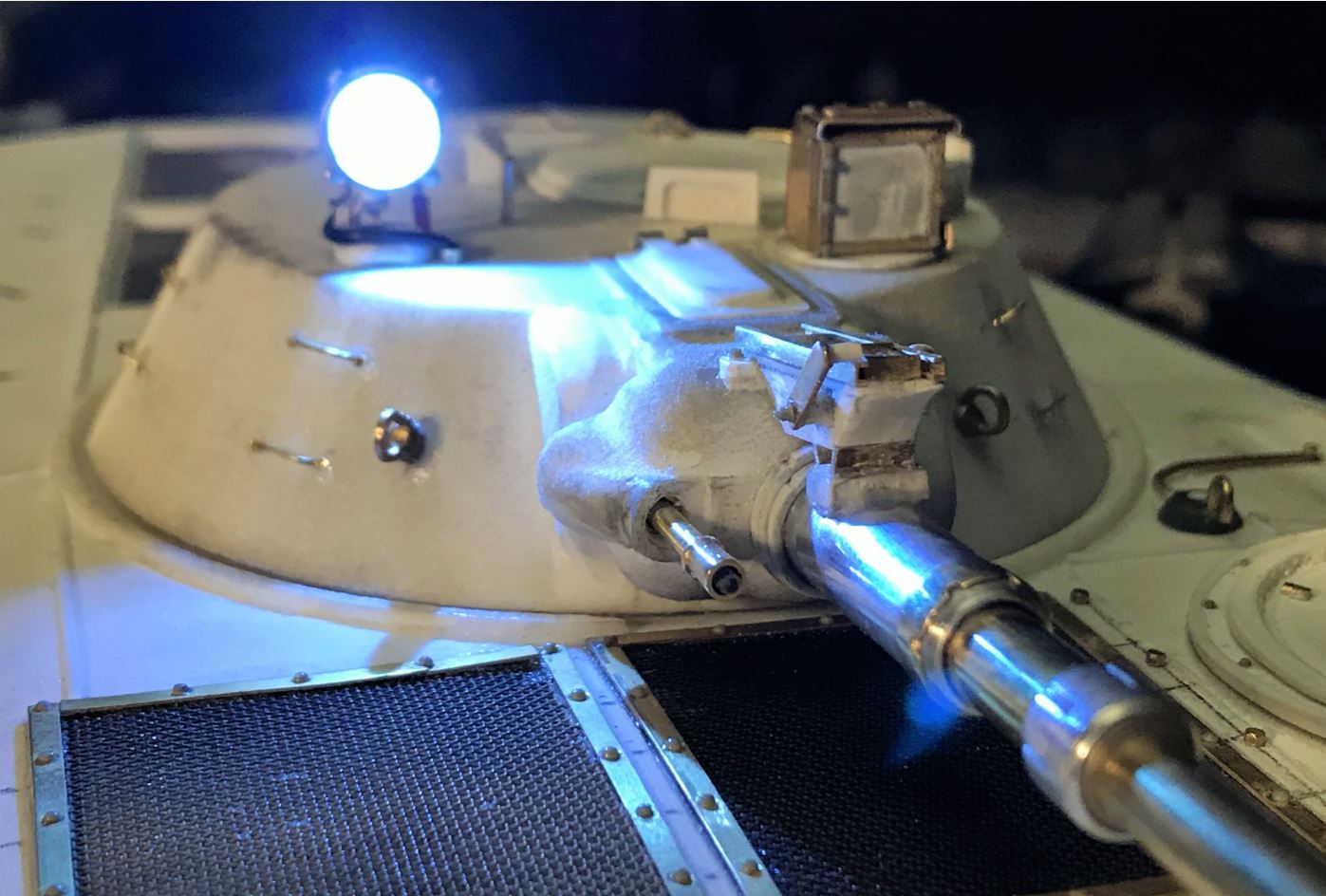

A 5mm LED was inserted into the AFF-Model spotlight. I saw some BMPs with a infra red lights instead of the provided white spotlight so it is an alternative. The clear lens will be installed only after painting.

Close up of the Sagger missile ramp. I kept the detailing to a medium level.

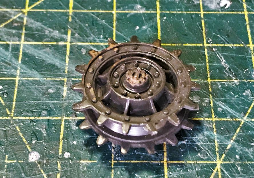

Presenting the BMP powertrain.
The nature of scratch building on a non commercial RC chassis is that the drive train elements are usually non existant and have to be figured out. I am not yet into 3D printing so there are limitationss. Below is what I put together, awaiting one day something better to put on the BMP.

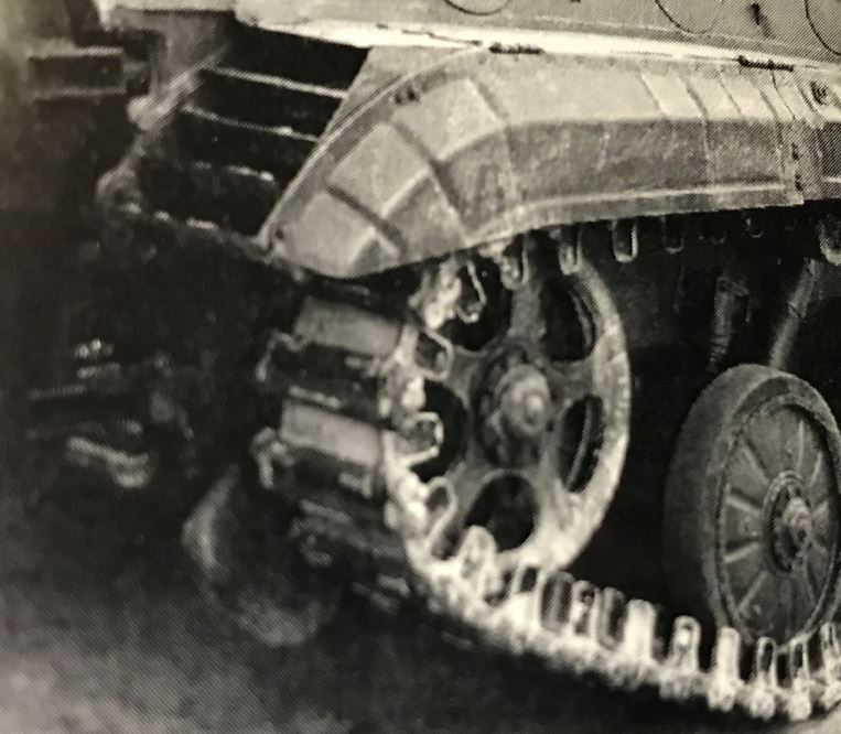

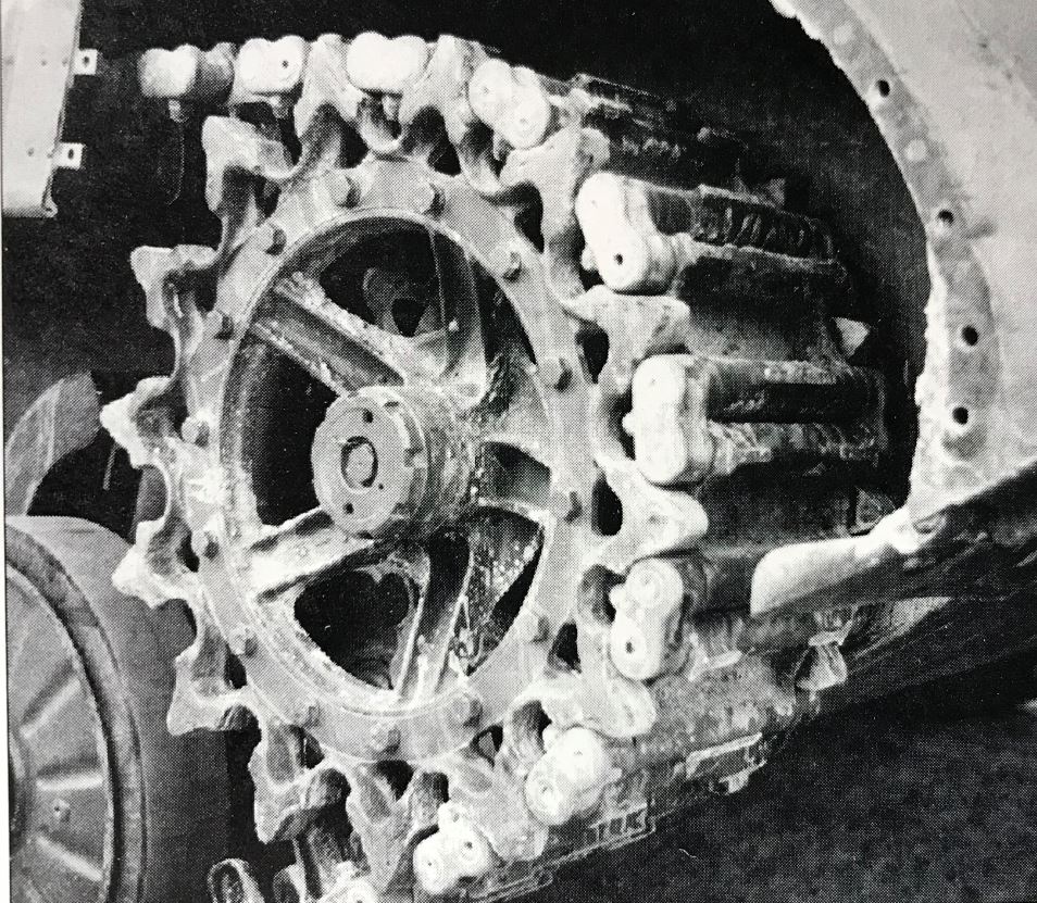

This is the sprocket I had to get as close to as possible.
BMP 1/16 RC powertrain

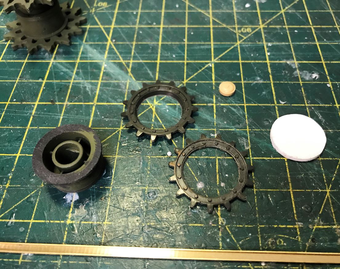

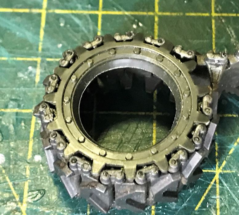

I previously tested a modified (highly reduced) HL Sherman sprocket to fit the 1/24 tracks but it ended up being too small and it did not look good. While going through the bone yard, I picked up old Tamiya 1/25 Centurion sprockets with teeth that seem to fit the Sherman 1/24 tracks quite well.
Here, the Centurion teeth wheels have been separated and tested on the tracks. Perfect fit.

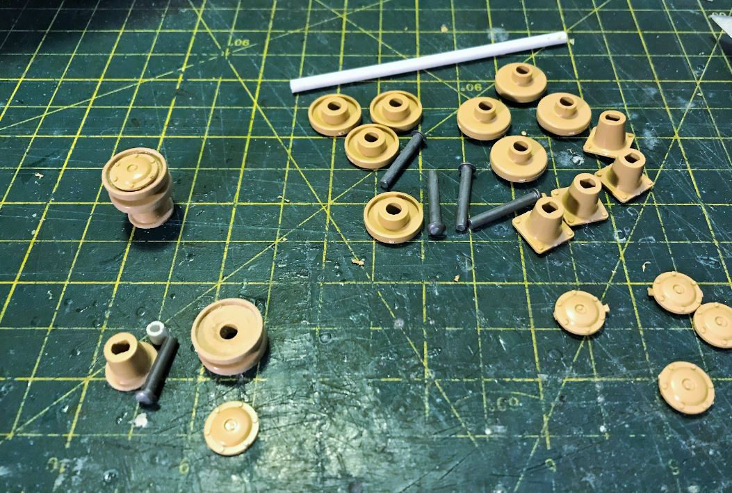

Here are the components of the new BMP sprocket before assembly. A Heng Long Sherman sprocket has been cleaned up of all features and cut in half to become the core that will connect to the gearbox.

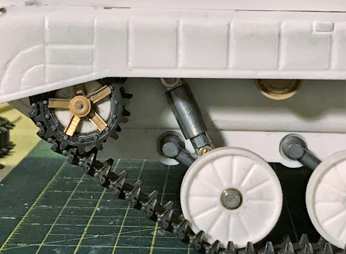

The assembled BMP sprocket. It looks a bit weird like this but it has some basic features of the real one and it runs well in testing. The 1/24 plastic tracks are very light so the plastic sprocket should not have problems running the BMP inside the house at least. Once provided with a hub cap, it should look better. It will have to do until something better becomes available on the market.

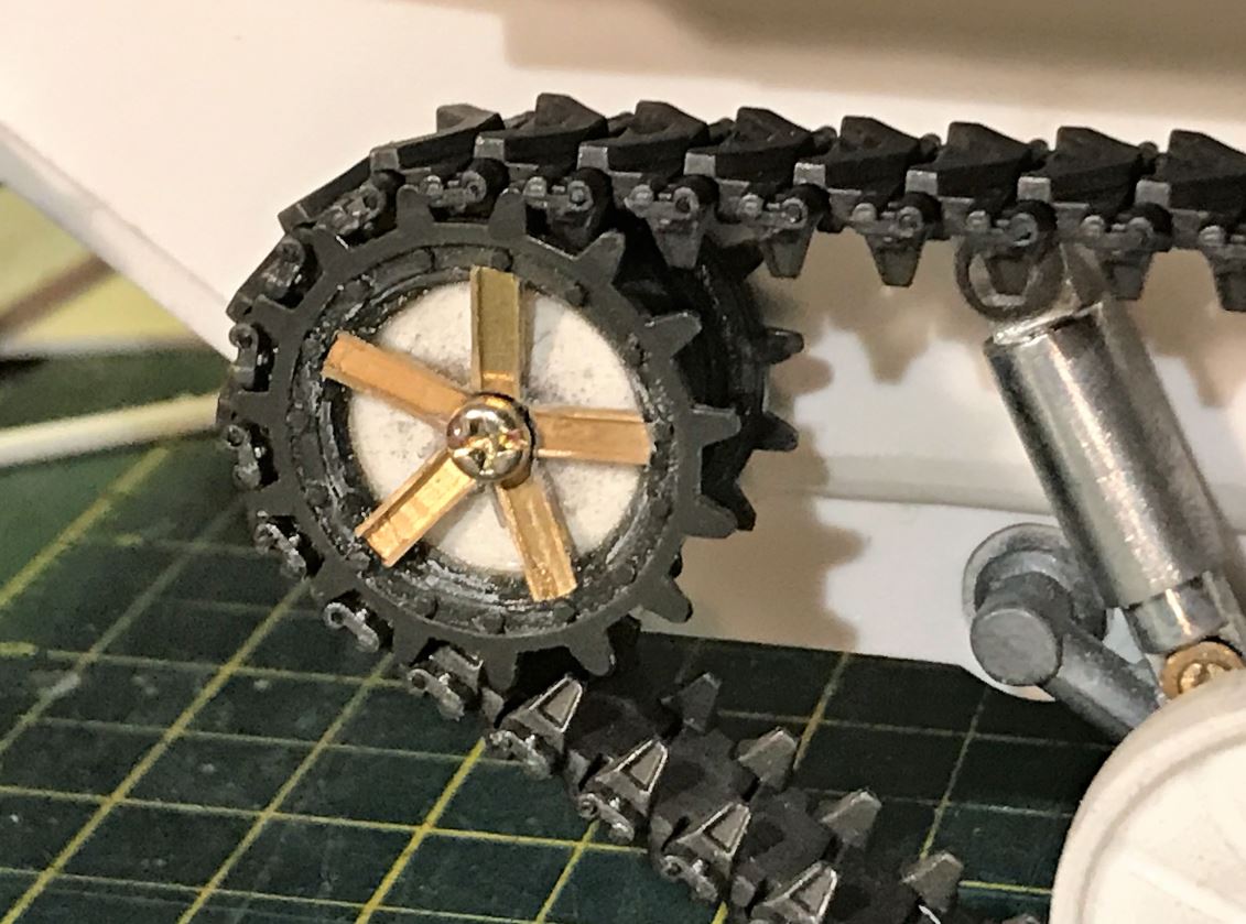

This is the BMP idler with 5 spokes
It was previously done using half of a T-90 sprocket and ball bearing inside. It looks ok and works well.

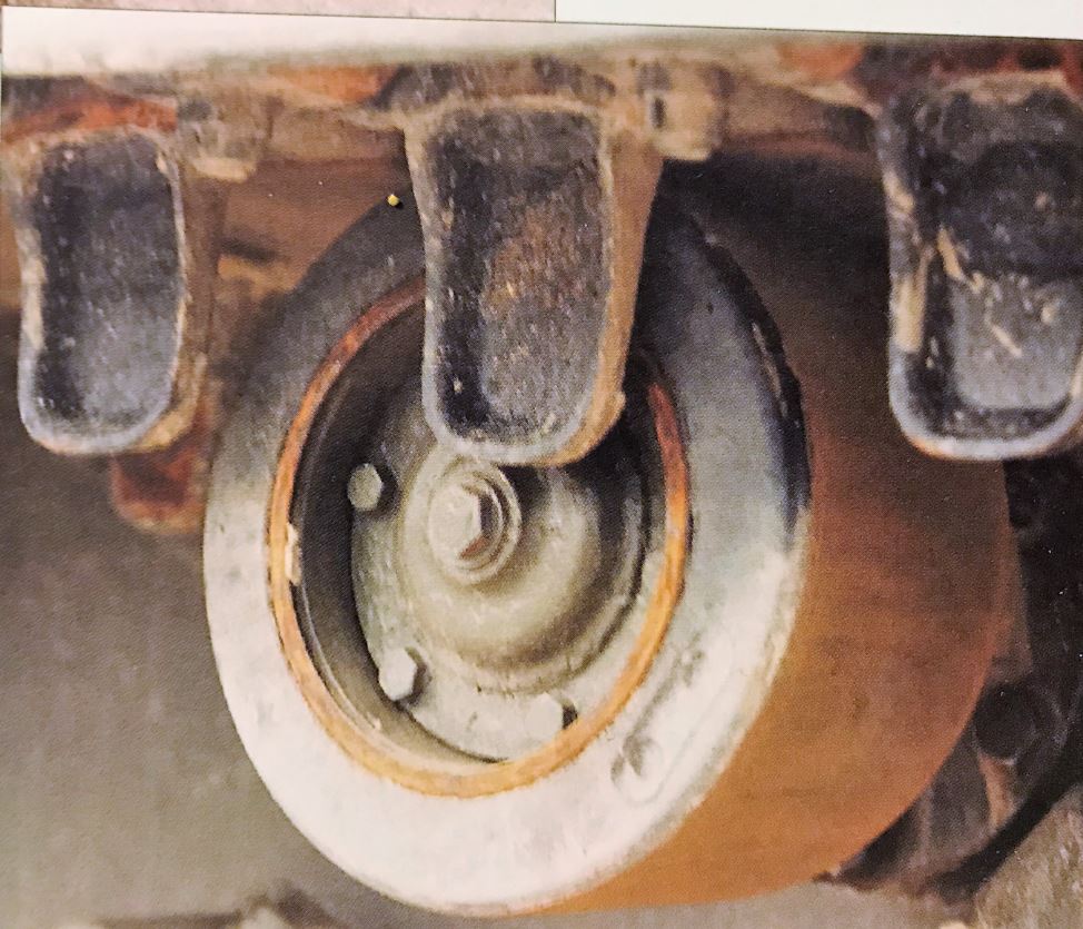

This is the real BMP return roller.

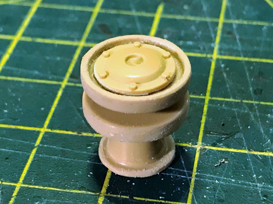

Scavenging the spare parts reserve, I ended up selecting Tamiya PZ-IV return rollers that I did not use on a previous project. Although the real roller is a drum type, the basic components were there to recreate something close enough, most of it will be hidden behind the side skirts. The hub cap is from the PZ-IV road wheels.

Once trimmed and reshaped, this is what it gives.

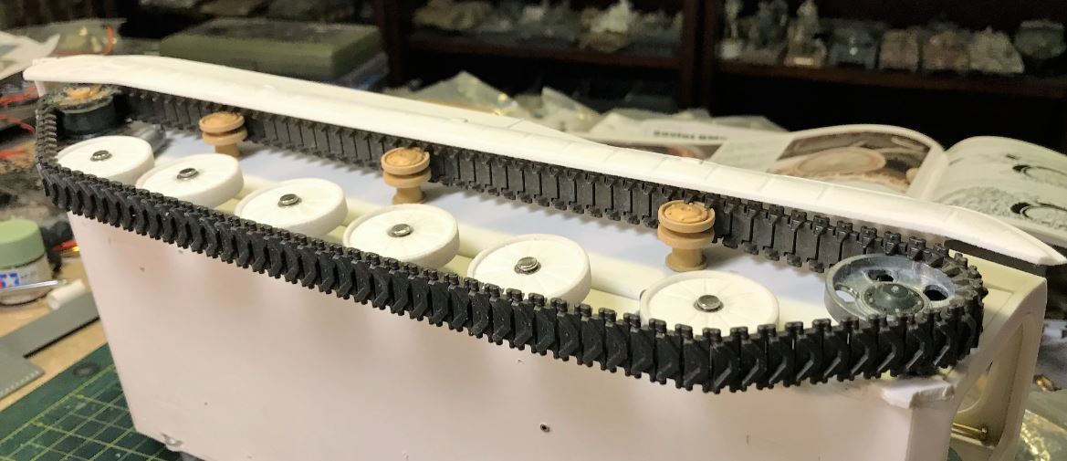

Continuing with the power train

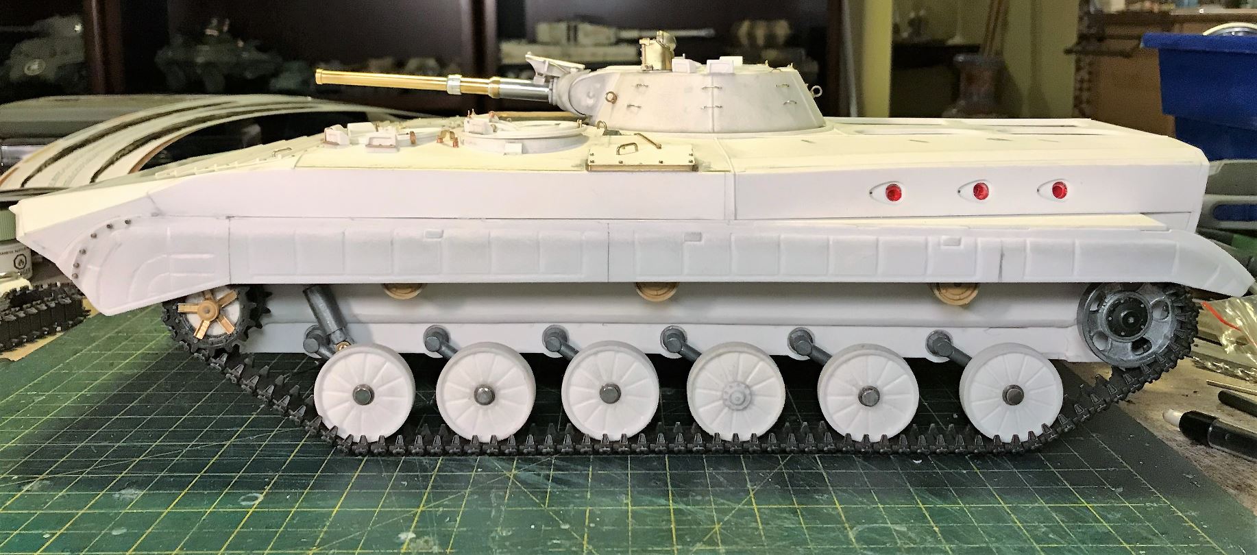

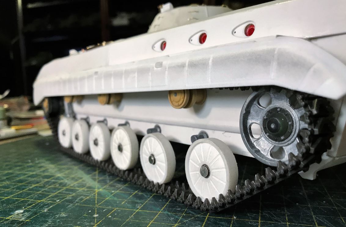

Return rollers installed
BMP power train 1/16 RC

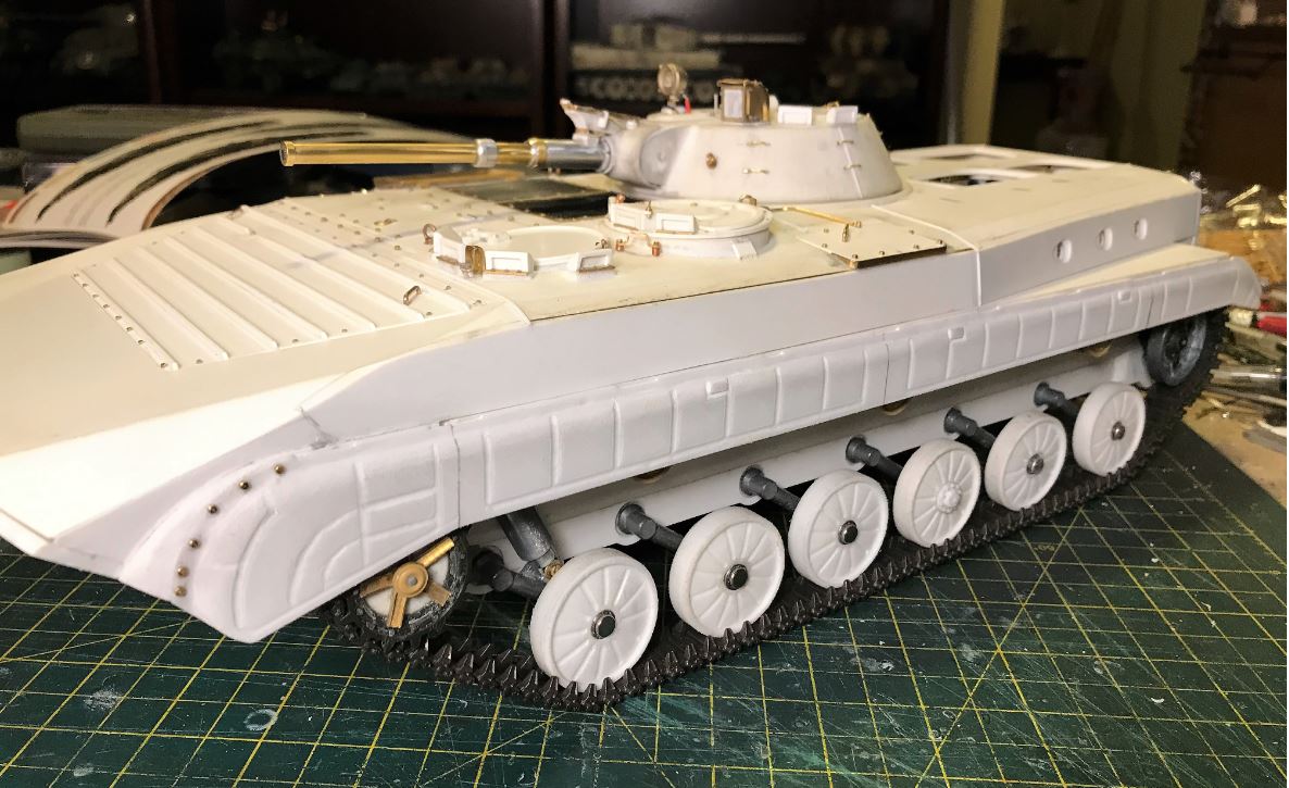

Side skirts needed to be temporarily put in place to determine if everything looked right.

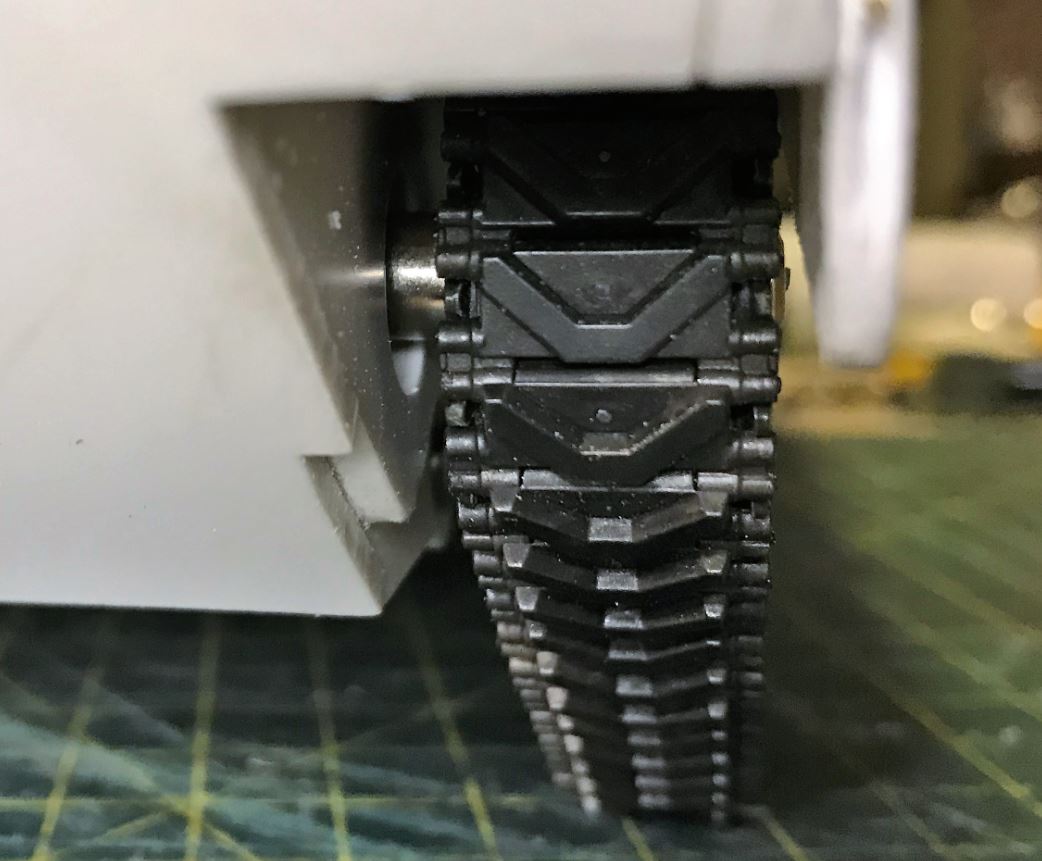

Although these 1/24 VS Sherman chevrons are not accurate for the BMP, the width and shape of the tracks are pretty good. No need to adjust anything between the hull and side skirts to make then fit.
Looks good

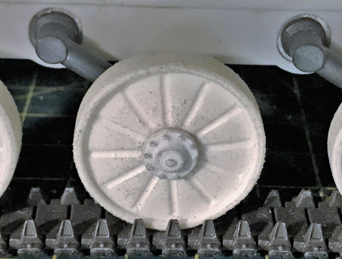

Tested one of the road wheel hub cap. Looks good.

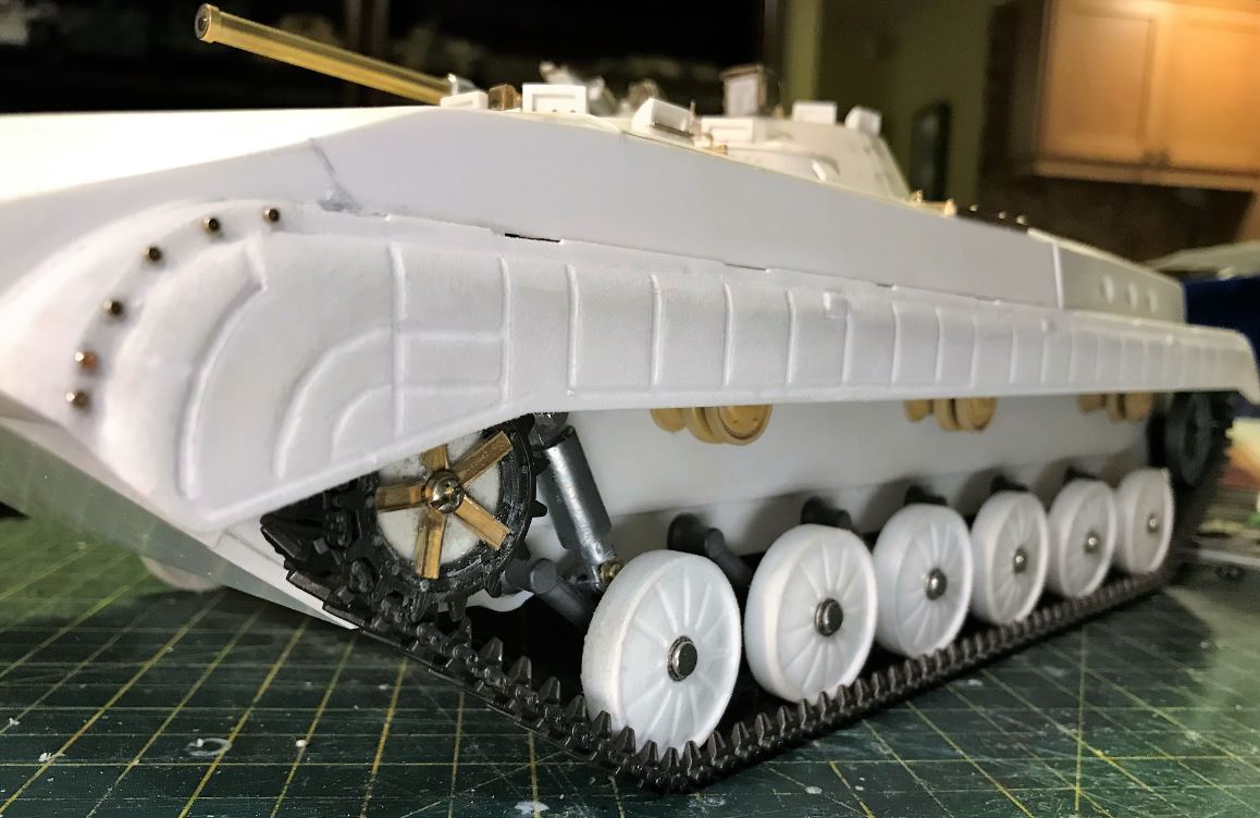

Overview of the model with one side of the tracks installed.
Man, it is looking like a BMP.

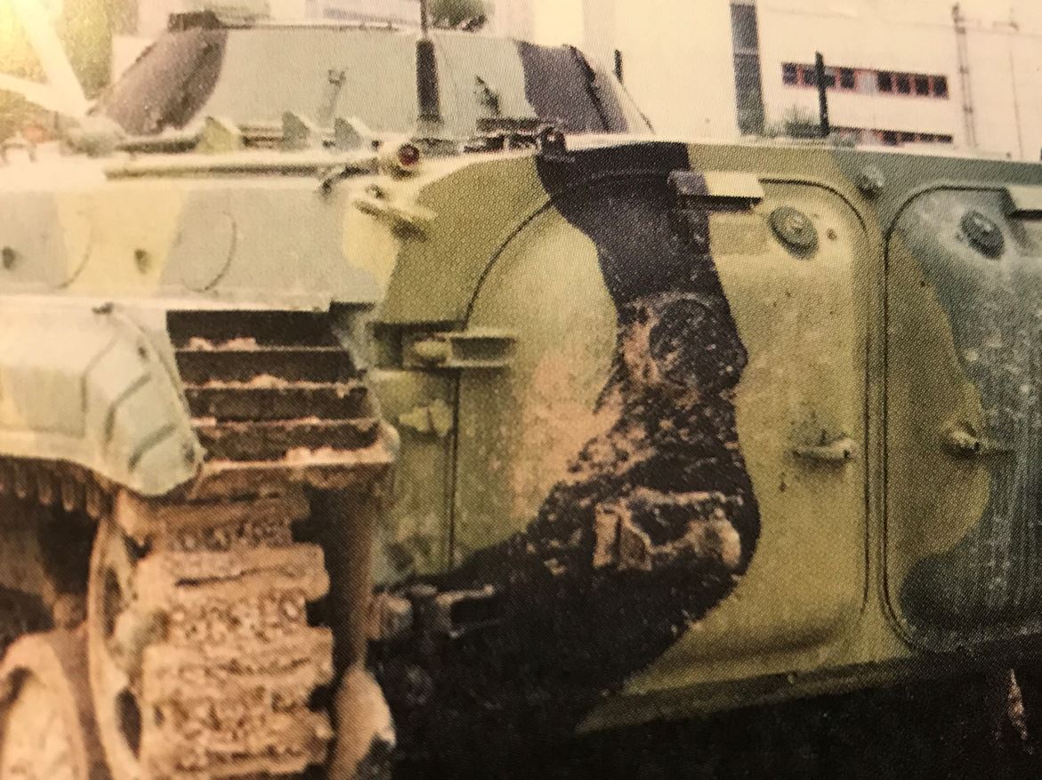

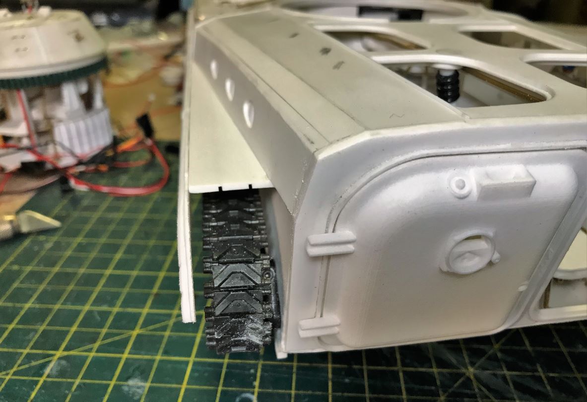

Next step is the the back of the vehicle. Here is a view of the real vehicle. I also need to order micro hinges for the side skirts.
No parts are provided for the rear of the sponsors attaching to the side skirt so this will be scratched built. You can also see that the hinges for the rear door will be a struggle to figure out. But that will be a story that will continue after my 2 weeks winter vacation.
