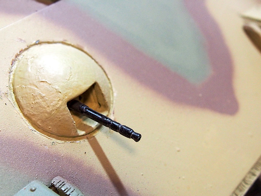

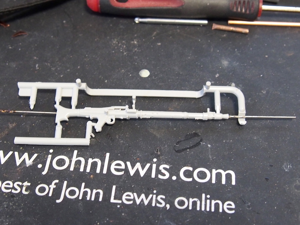

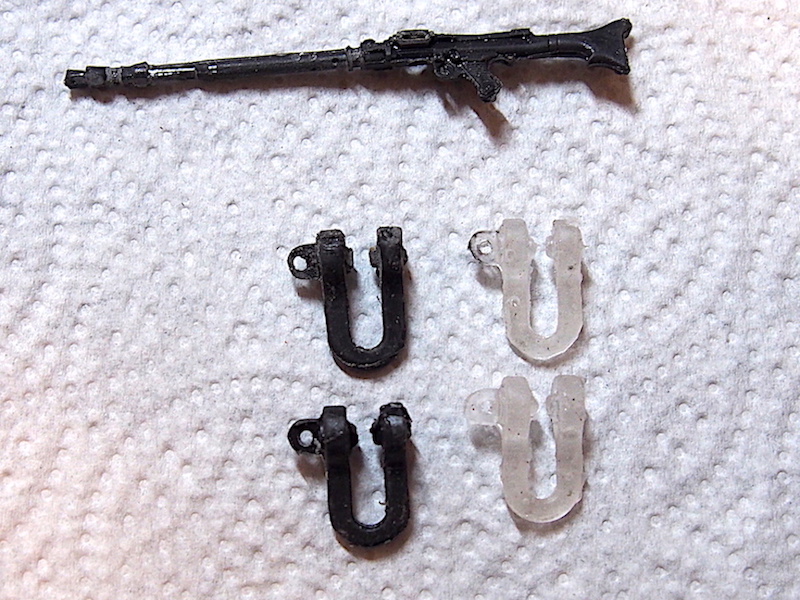

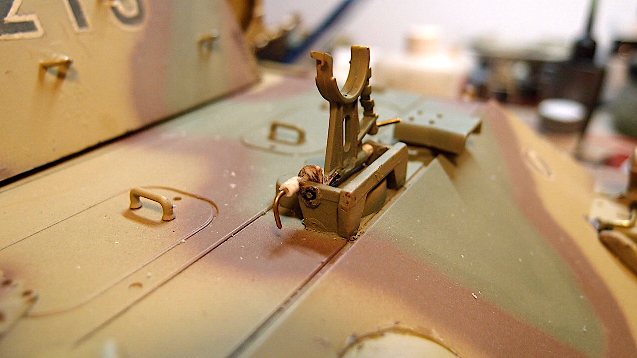

Mg sorted, its the devil in the detail . Sometimes its ok but you always know it can be better.
Will try to cast this before i think about buying a schumo mg for the turret AA.
correct mg  shape
correct mg shape
Best of 2 cast mg's
Best of 2 cast mg's

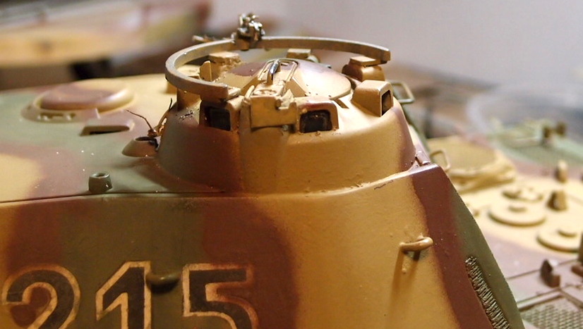

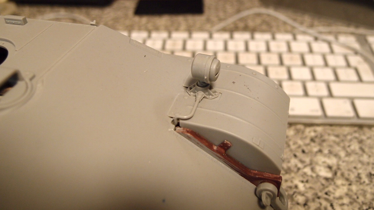

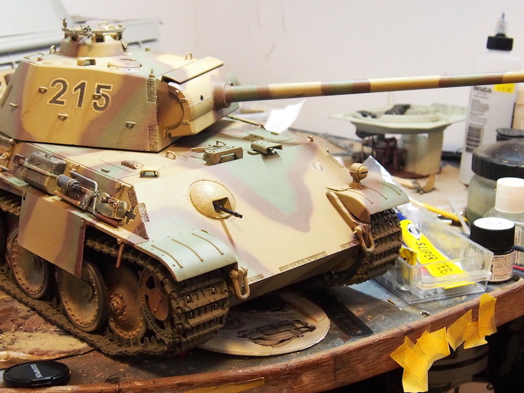

Hi Soeren Casting is looking like a learning curve is required, 1st go was with blue stuff and epoxy resin. Mixed results tried the mg and tow shackles. Added detail to the cupola.
Casting 1st attempt
Casting 1st attempt
Picking up detail from Trumpeter
Detail added, tidy up when glue sets and glue small stop on.

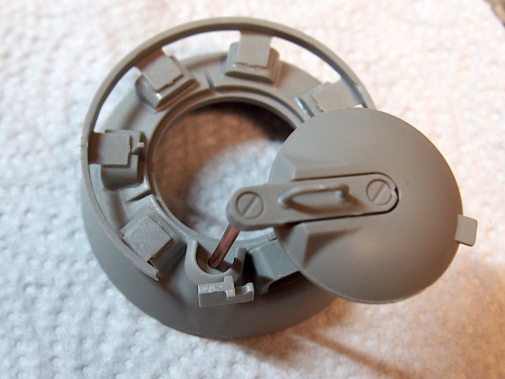

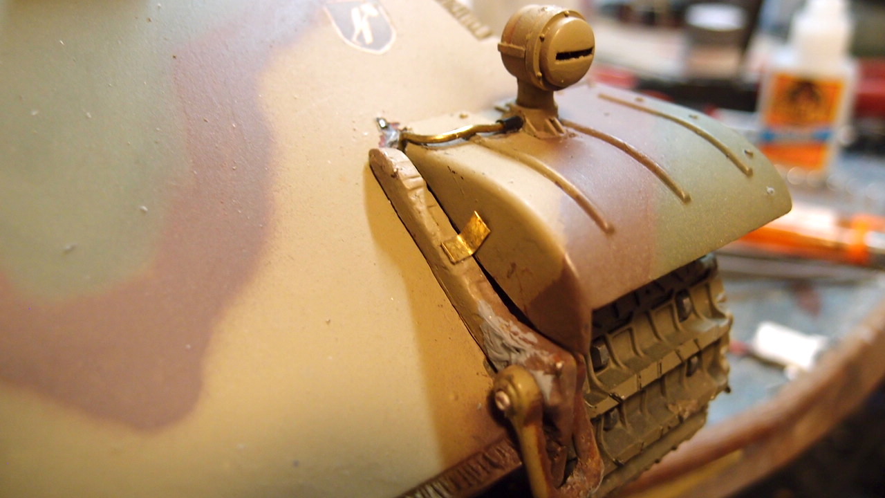

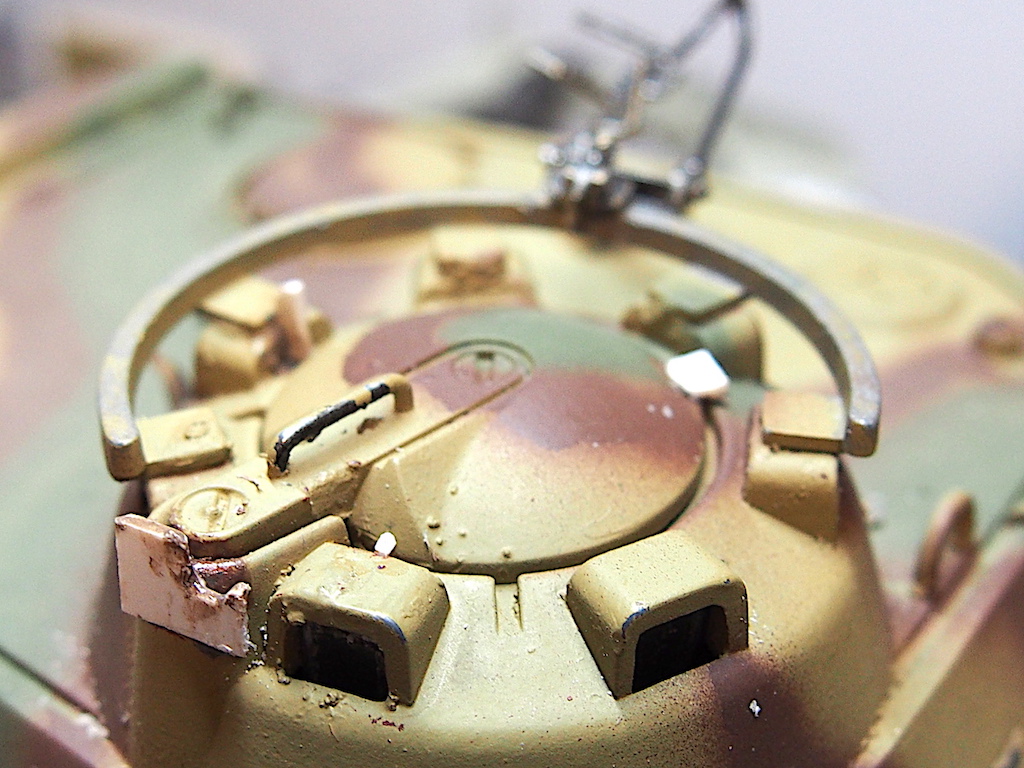

Cupola done ,paint ok on hatch stop. Fixed hinge cover as its low on HL.
colour match ok.
colour match ok.

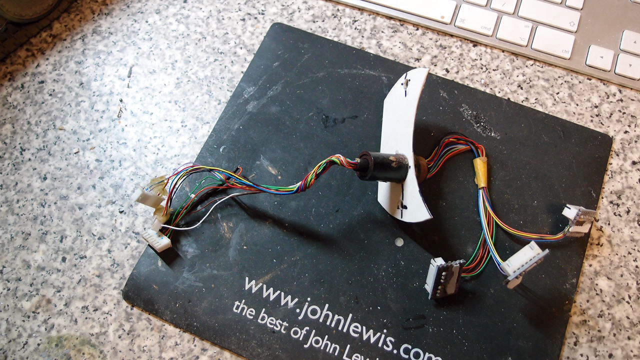

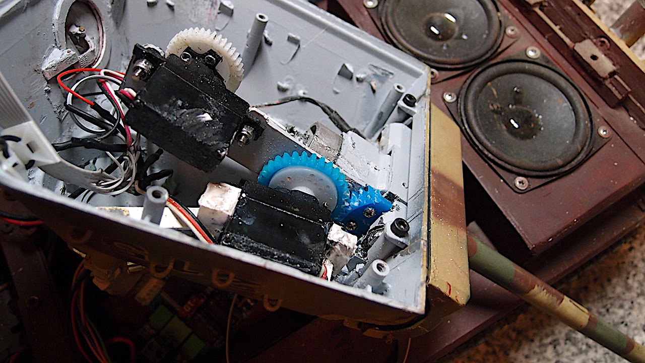

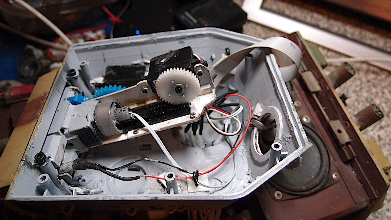

Electrics problem, slipring has failed. Problem is unless slipring is dead centre the cables will twist and some will fail. Will look for a slipring that has a shallow profile, rewired with computer ribbon for now. Upgraded the barrel elevation from servo lever to a servo gear system.
Off centre slipring twisting cables 2 snapped
computer ribbon rewire

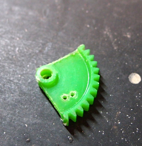

Nylon gears , hard part is fitting the barrel gear if its out gear will not mesh properly.
Cut up a gear and drilled out to sit on one of the pivots.   Lined up another cut down to match up the gear teeth.

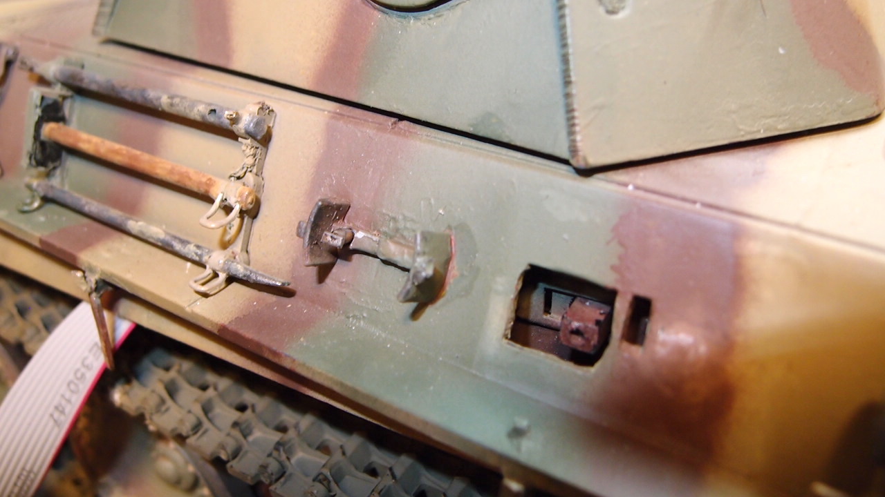

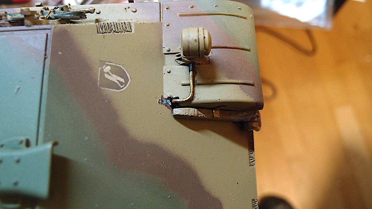

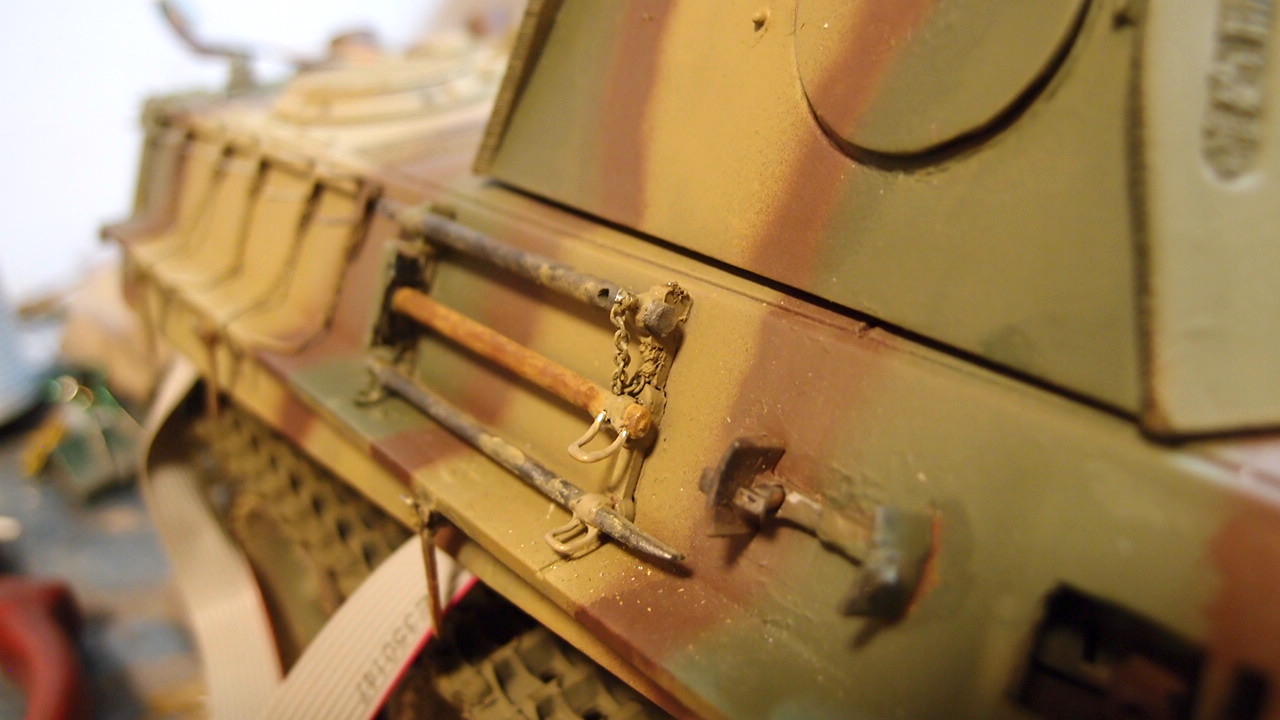

A few more little fixes and a repair. Hope i can match the yellow , or just add some grime as its a void beside the tracks.
Better fixing for the chain.
Track puller inner pin for the cable end
Added detail to the travel lock.
Mudguard stops
Mudguard stops

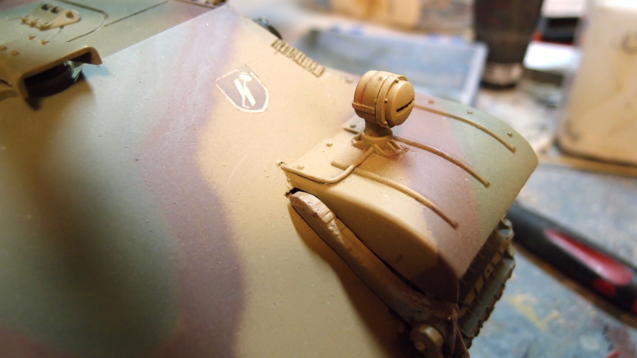

Cut out and new conduit run for the light.
Should have a cut out of the front mudguard.
This is wrong
This is wrong

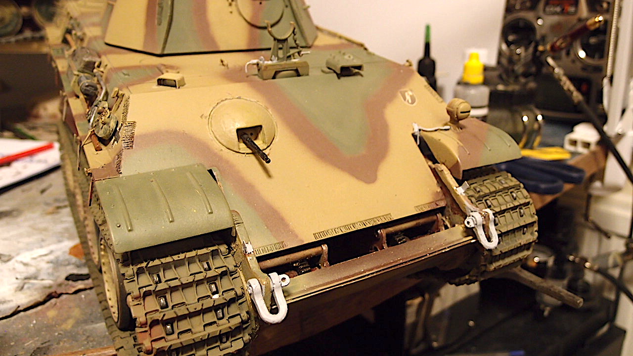

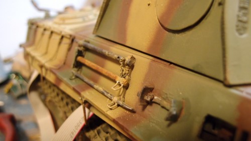

Fitted 2 towing shackles i cast from the Trumpeter kit. Next try and get the paint to match.
JBweld epoxy for casting the shackles
