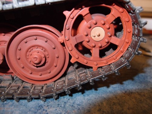

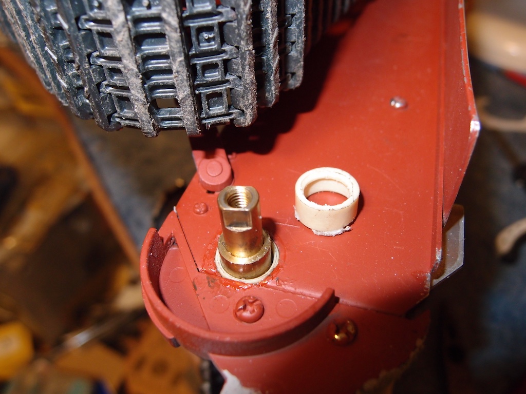

Found some bearings (iglidur® polymer plain bearings) to fix the wobble on the sprockets. Easy fix by glueing in, can't use a normal bearing as it covers the grub screw . Drill out from 10mm to 11mm and cut to size , one bearing fixes 2 sides.

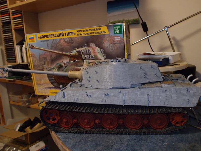

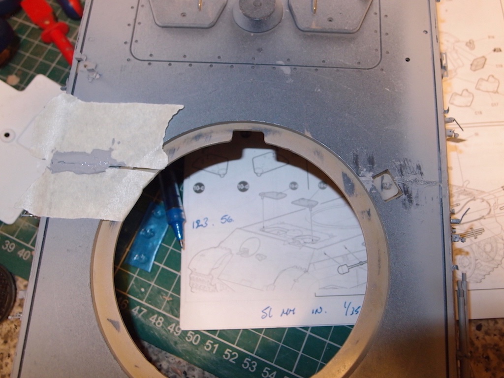

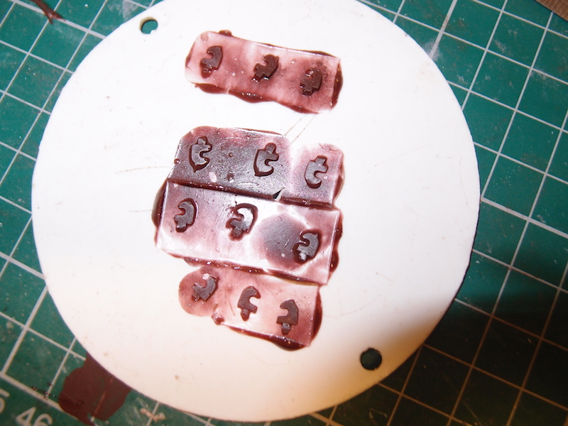

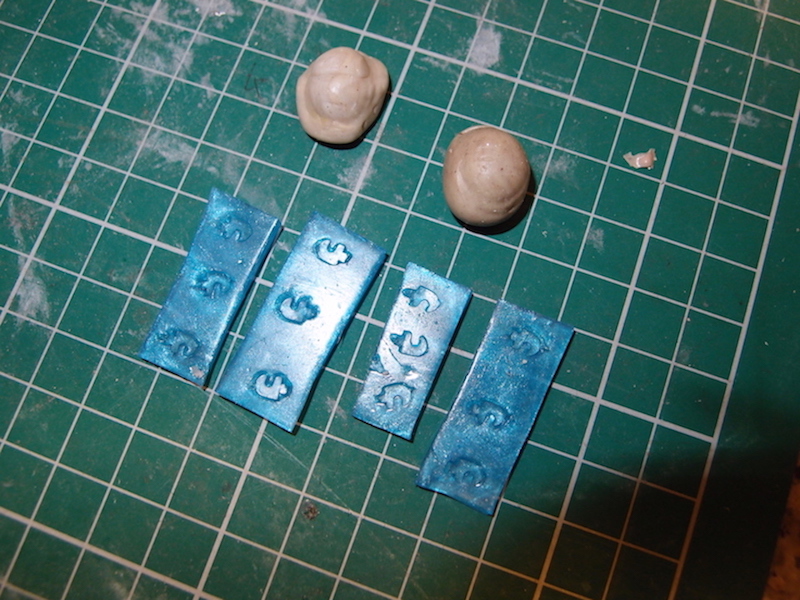

Bought a little kit, ZVEZDA king tiger. Going to check the camo looks ok . Waiting for mr surfacer and will try to cast some little hatch hooks and the driver /radio hatch catches. Machine gun mount in hull, M/G ring thinking about a metal one as it will be thiner and vision blocks next.

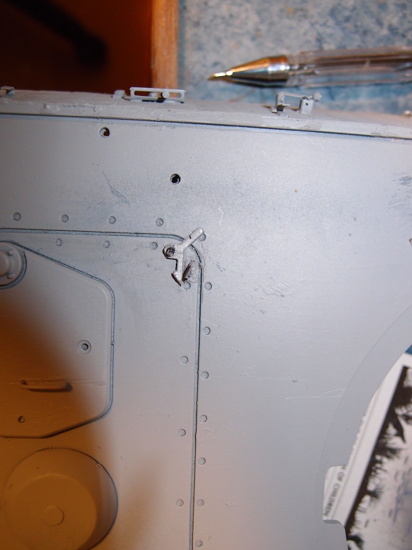

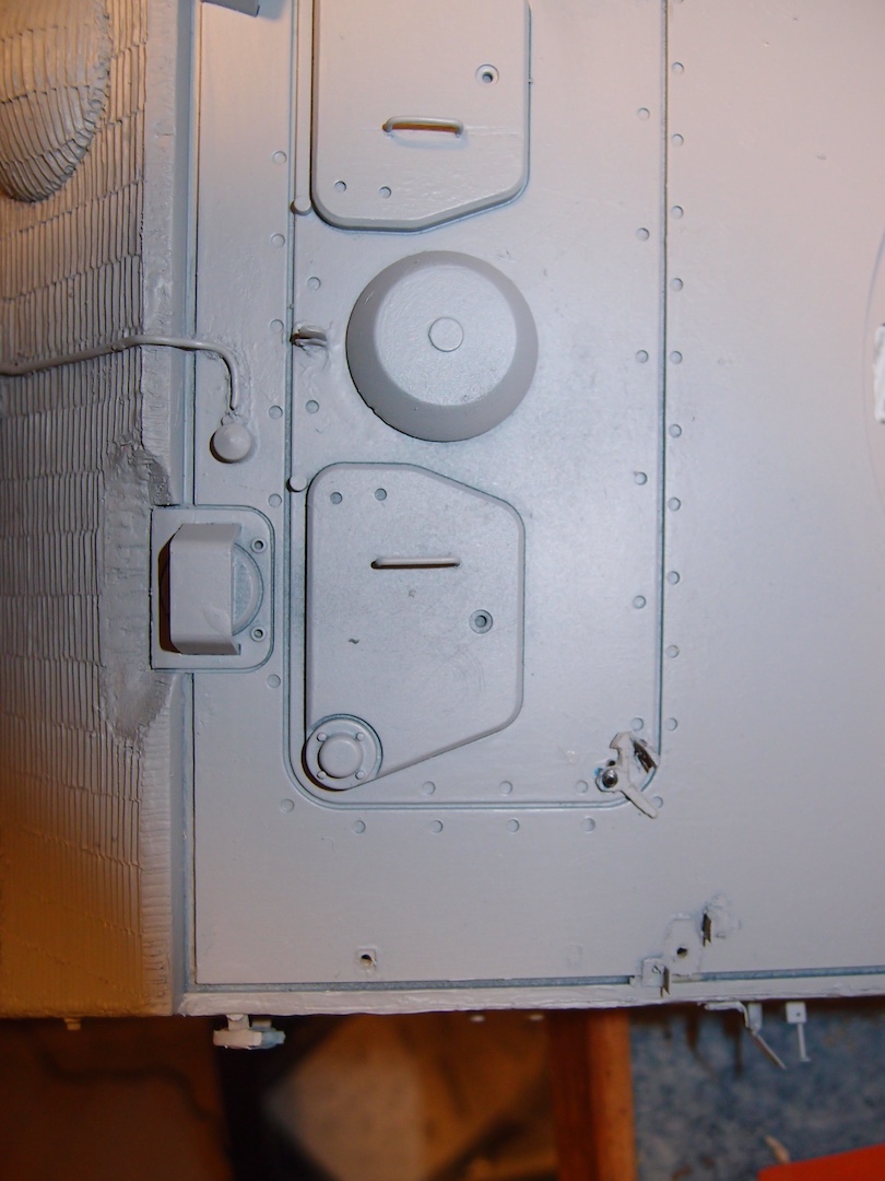

Chugging along, lifting hooks the small ones done , ball mount for MG and noticed that the deck has 2 plates so a groove cut and filled for weld.

Added little bold or is it an oiling nipple?

Re: 1st generation rc king tiger
Nice touches. I also put magnets in my sprocket hub to retain the cap.
Those lifting hooks tend to be fragile so
I’ve left them off mine being a roughy
Hi Herman Good call about the magnets, was going to see if a few coats of paint would take up the slack for a snug fit. The lifting hooks are flexible, used Gorilla epoxy and as its thin they have some give so thats a lucky find. Third attempt worked, tried AK putty and EpoPuty without success .

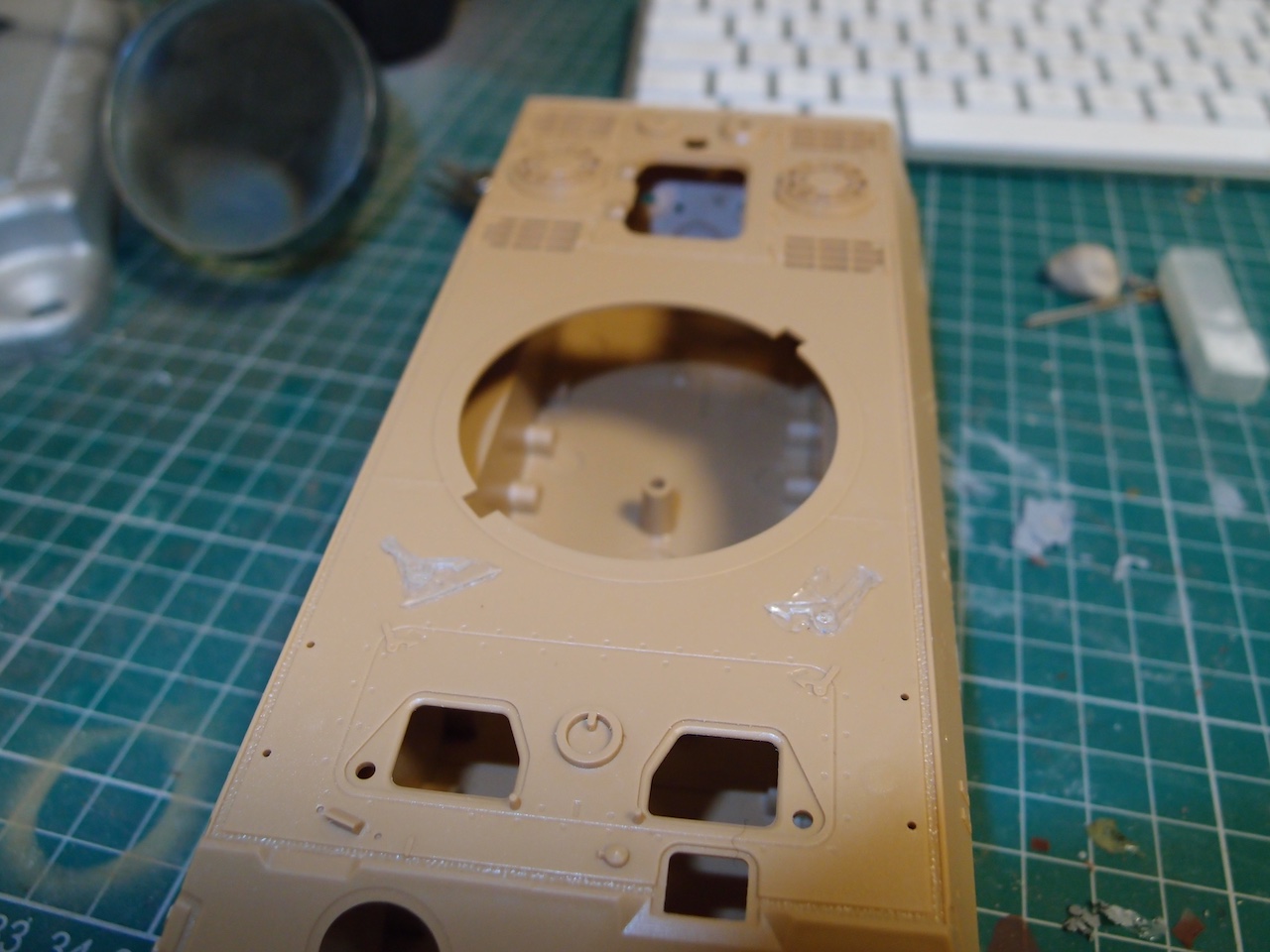

Made the hatch catches they look ok. Couple of attempts to get the position , glad i have a small KT for checking.
