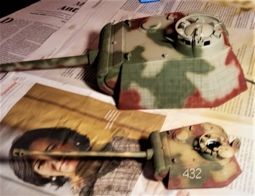

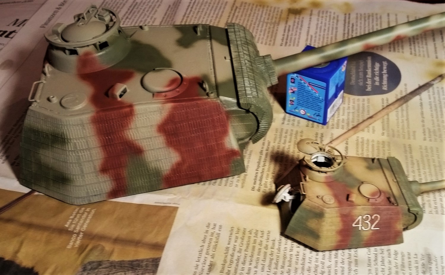

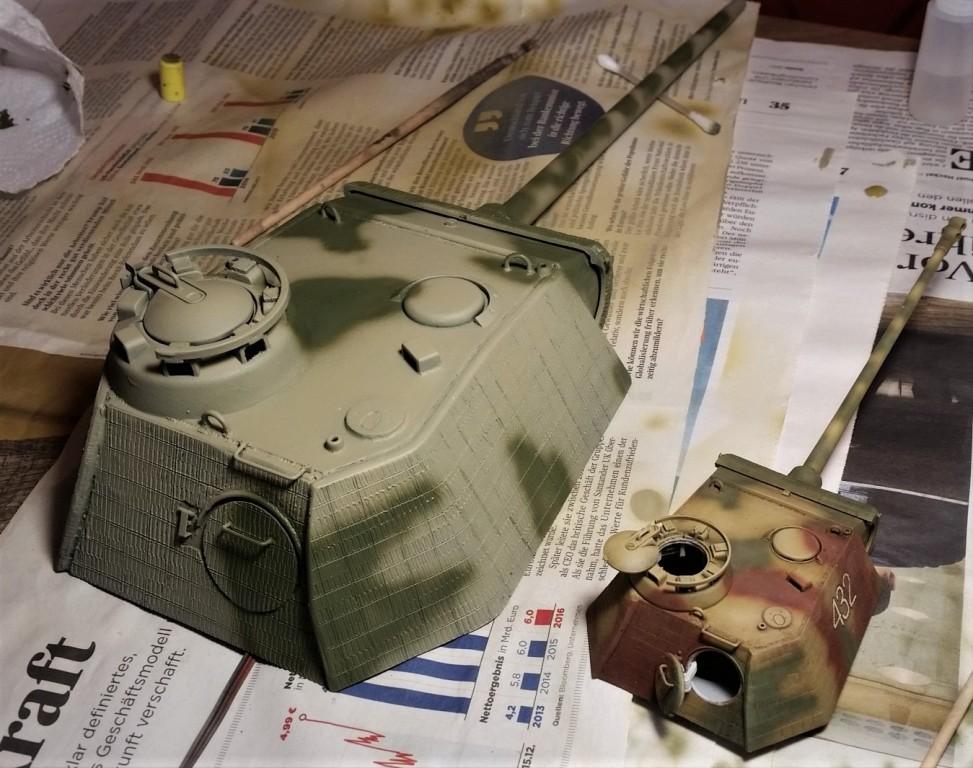

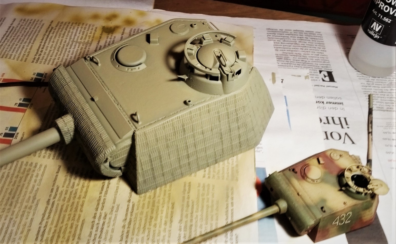

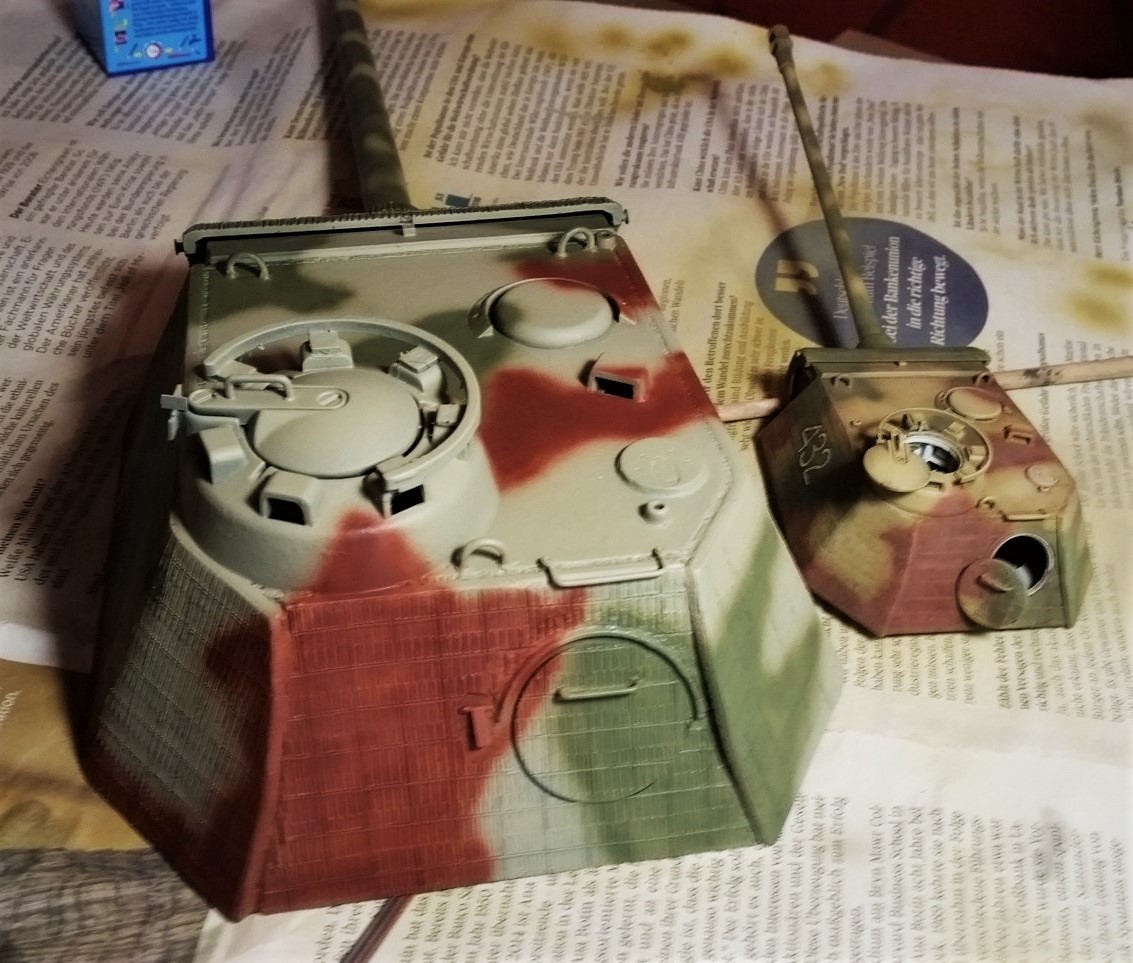

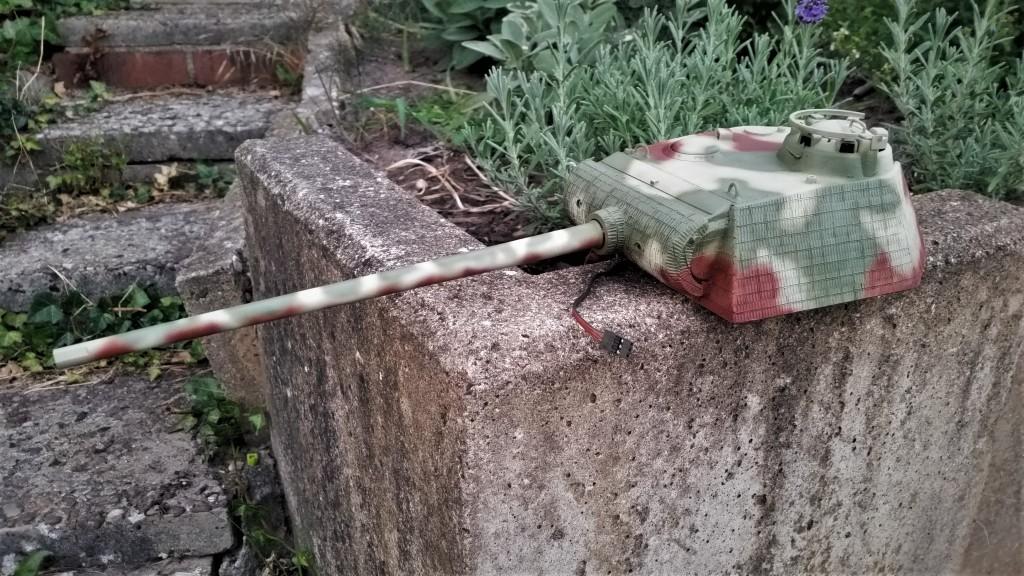

Hey, thank you both. I use Mr Surfacer 1000 and just paint it on in uneven coats. While still wet, I stipl into the surface with a brush. Then some light surface sanding. And repeat this as often as I feel need. I did this also to the styrene sheet above the mantle because that was too even to my liking. But only once. That gave some very subtle changes to the surface texture. I would say it is slightly exaggerated on the turret roof. But it is a detail I would like to emphasise in this build. Will see what I can do in aid during the painting process. Looking forward to have the 1/35 and 1/16 turret sit side by side painted by the end of next week.
Re: Panther Gs Detail upgrades
Hey there,
went ahead and gave the turret a base coat. Decided to go much lighter for the "Dunkelgelb" to start off and tinge it with filters. The small one was a bit too dark for my taste.
So here we are.
Edit. added one of those outside shots after some more highlighting in the Dunkelgelb and olive Green.
So here we are.
