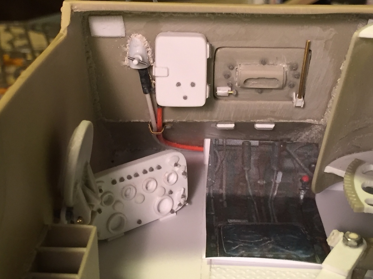

I finished the driver's position. After a lot of thinking as to how I would finish the area, I concluded the following was the best option.
I put a plasticard sheet to cover the open pit at the front. The Heng Long gears are no longer exposed. I scanned a reference picture of the driver's position, cut it to size and placed it where it would normally be on the model. What you see below is a draft version to give an idea of the final layout. When I will be in the final stages of weathering, I will do a proper high quality scan, adjust colors, print it on glossy paper, and then glue the picture in place. I will likely create the tip of the driver's seat in plasticard and make it stick out of the picture. The effect seems acceptable considering the alternatives.
No parts for this driver's area was coming with the kit. The dash with the dials and controls were scratch built and is temporarily in place. This thing took a couple of hours and part of my sanity. I still need to thin the round borders to the size of the dials on the decals sheet that I ordered. I figured that 1/24 aircraft dials should do the job. I'll see and adjust as needed. The dash, like the gun, will be only installed for good after the painting and weathering phase is done. No, the bin next to the visor does not open...
M7 Priest driver position

On the home stretch now, Louis. As always, I'm amazed by your dedication and attention to detail; the end result is sure to be an absolute work of art.
Your solution for the driver's compartment is brilliant, it's such a neat and elegant solution to an otherwise insurmountable issue. Well done!

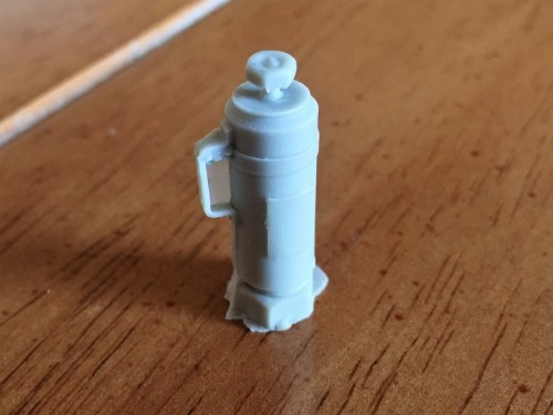

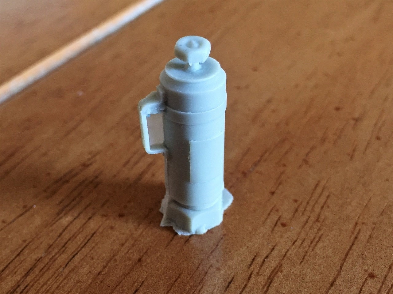

Continuing with the interior, below is the kit part that is supposed to be a fire extinguisher. Two are needed on each sides next to the ammo bins. It seems to me that it is actually a hydraulic jack, or maybe it's a coffee thermos. In any cases, it is not a fire extinguisher and i will either need to buy 2 somewhere (i could not find any on ebay at the right scale) or scratch build them.

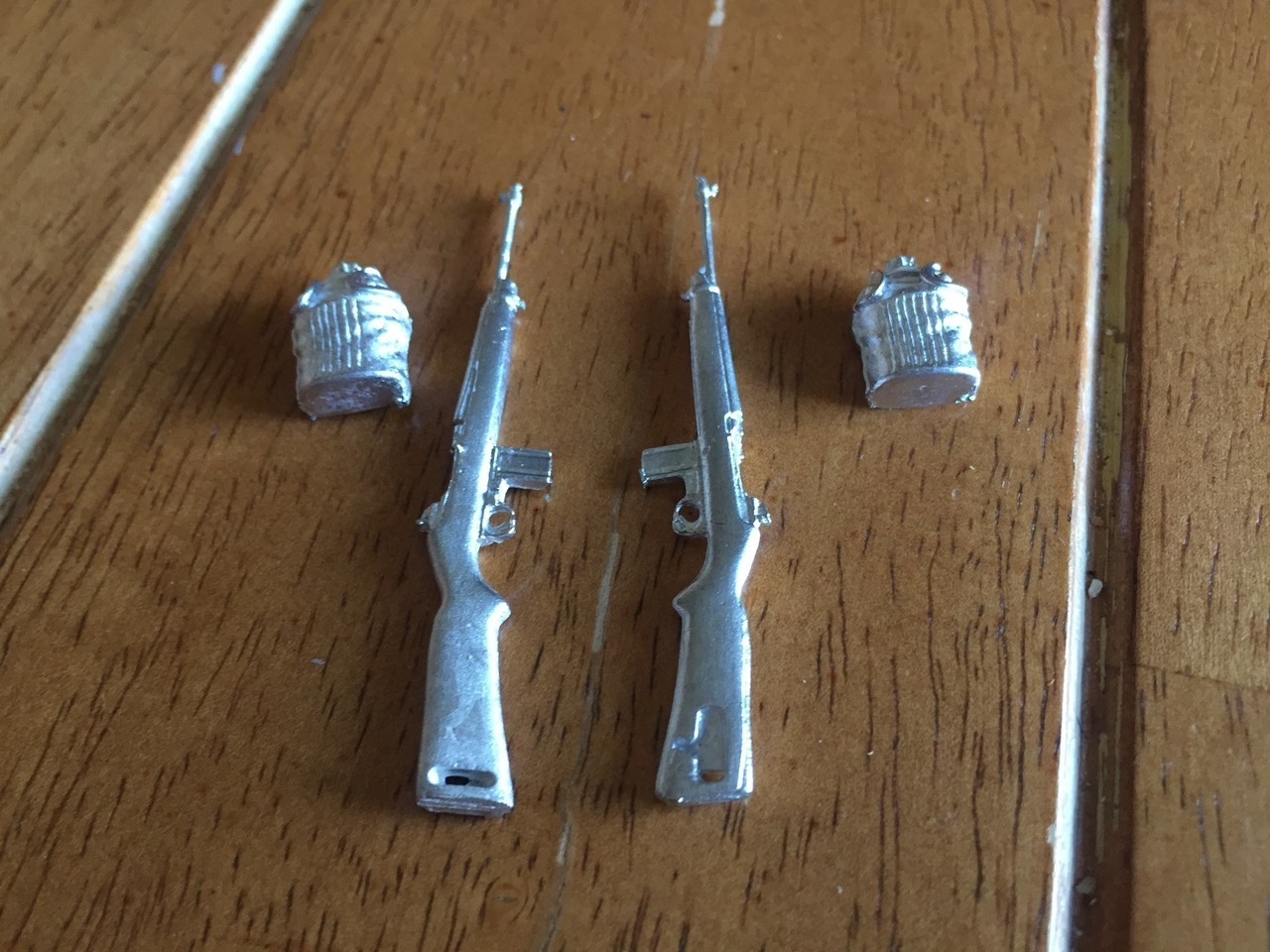

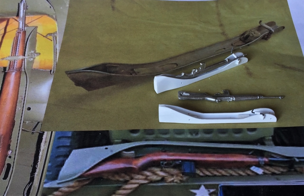

I have then concentrated on the M1 carbine racks. I need to build 2 of them for these little rare gems bought on ebay from Germany. They have not been cleaned yet. They come with a water canteen that will also be handy later.
1/16 M1 carbine
1/16 M1 carbine

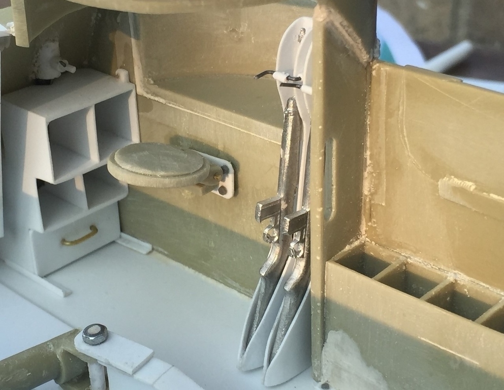

The US rifle/carbine rack for vehicle is complex to make, it has lots of curves and are made of thin metal. After studying references, basic parts have been made in plasticard.
1/16 M1 carbine rack
And after 2 hours of work, this is how they look. I created a working locking mechanism to store and retrieve the M1 carbine. It will come handy at the painting phase. I also installed inside 3 cushions made of dust mask material to keep the carbines from moving. Quite efficient and i am pleased with the result.

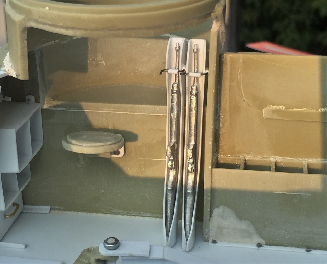

This is how they look mounted in the M7 pulpit. I saw a variation of these mounted behind the driver in some kind of weird perpendicular fashion but i prefer this way.

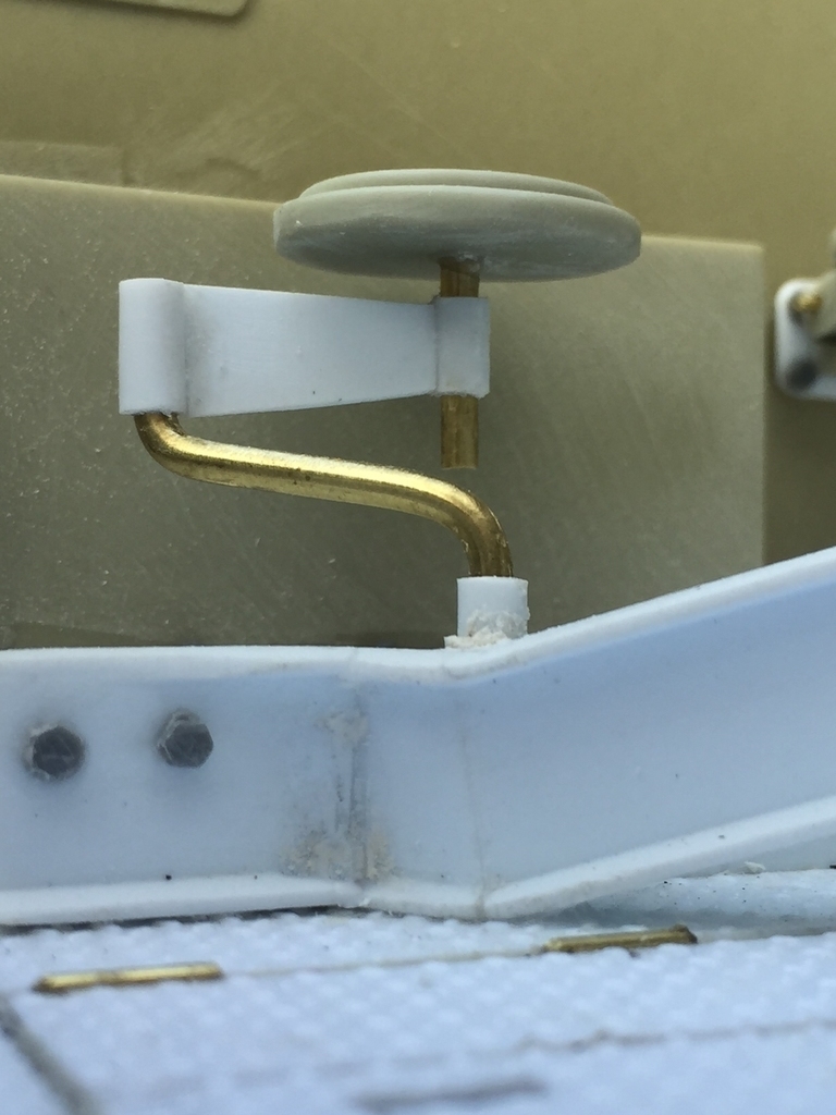

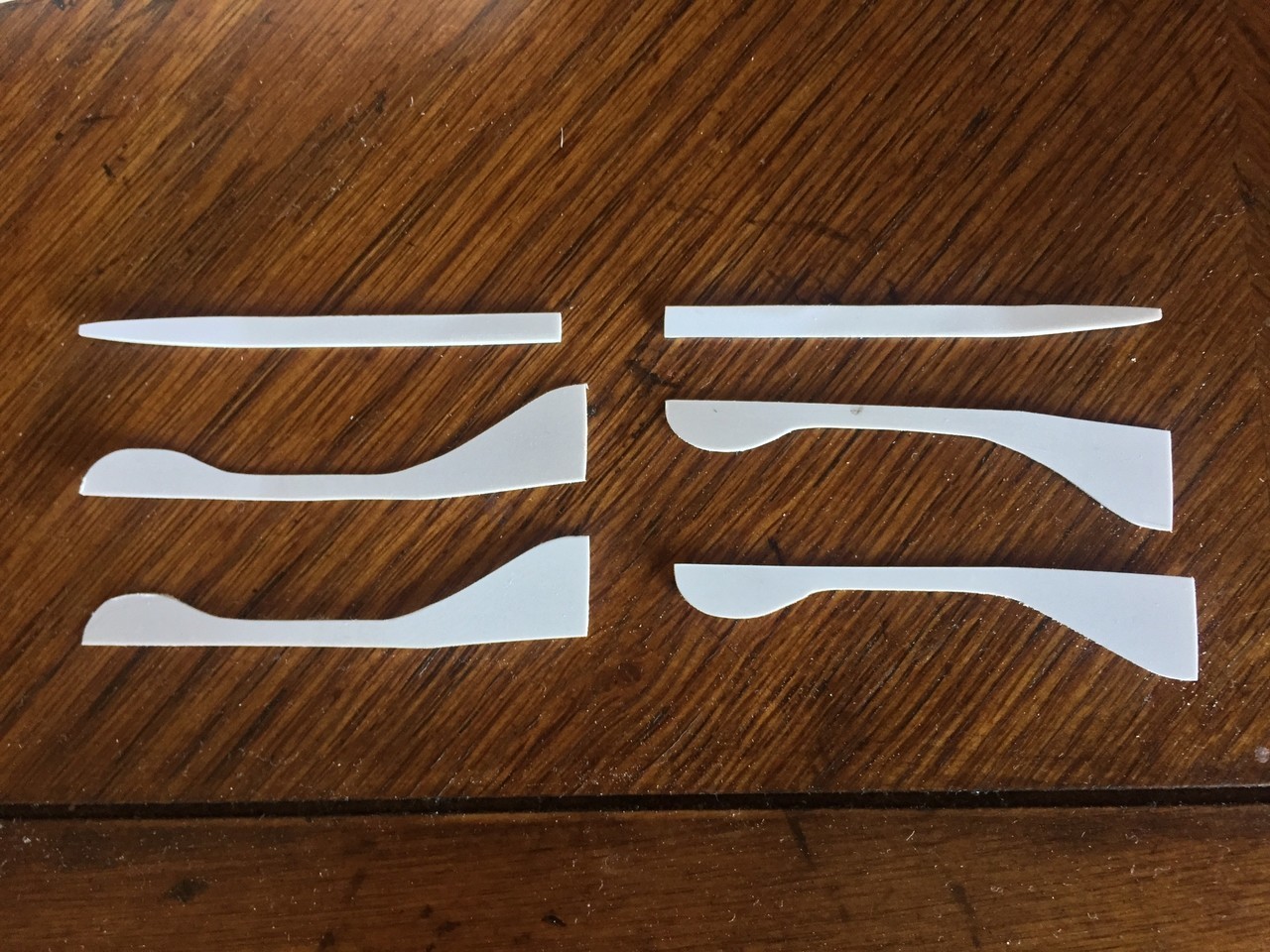

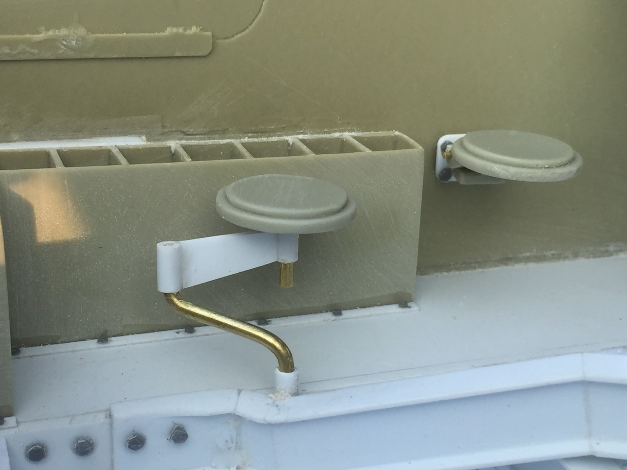

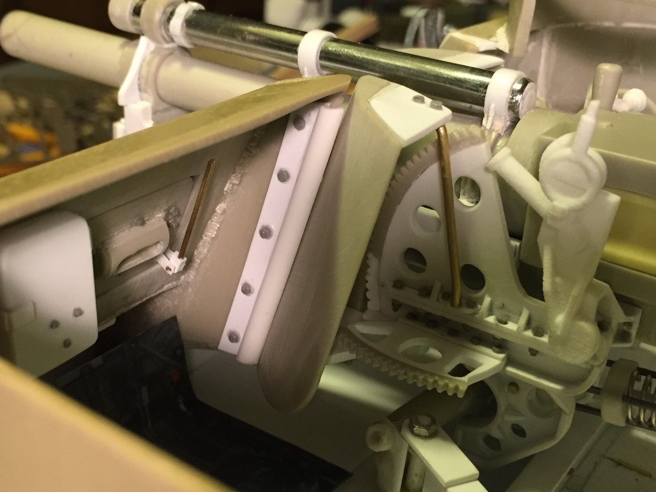

I have redone the gunner seat as per reference, reusing the kit seat but with a new brass/plasticard mount behind the trail. Again, many variations of these.
M7 Priest gunner seat
The brass job has been done on both sides.
M7 Priest
M7 Priest

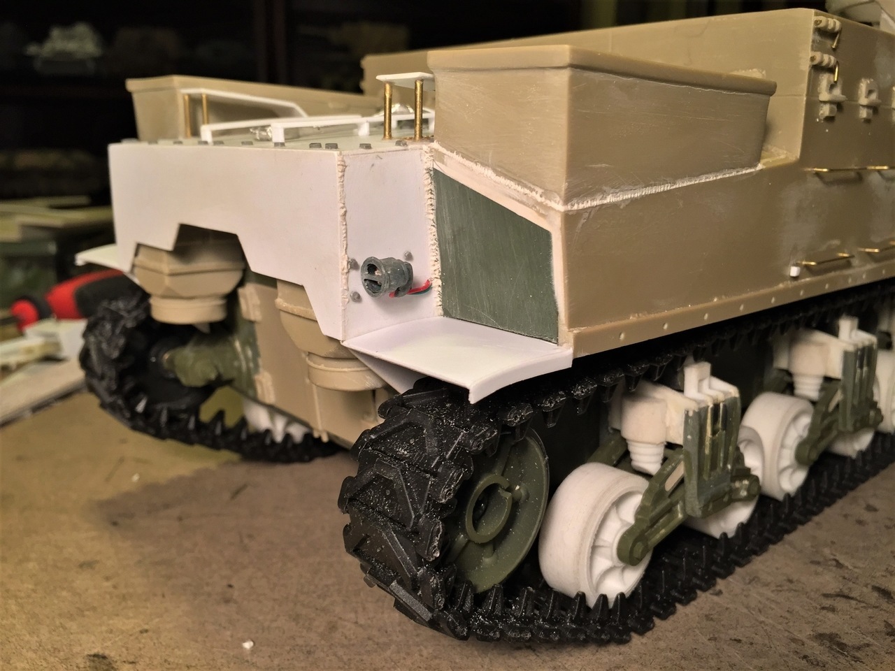

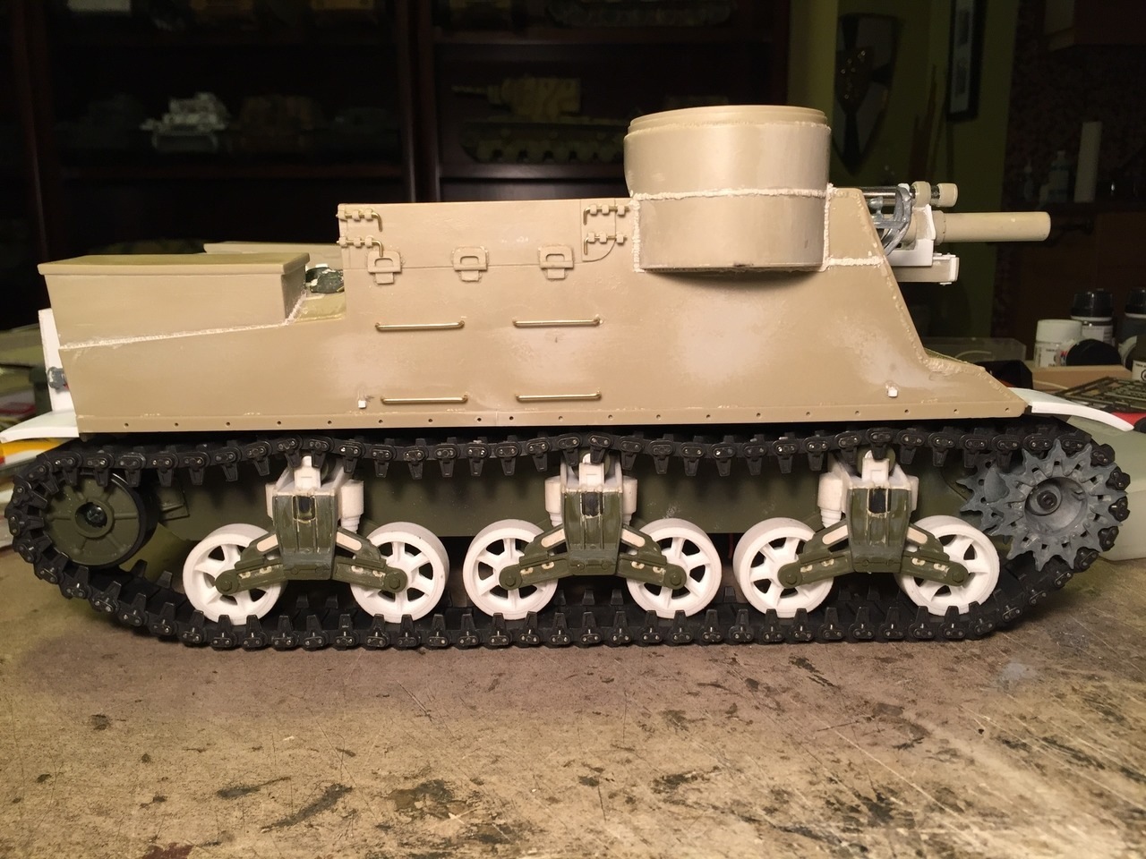

Hi everyone,

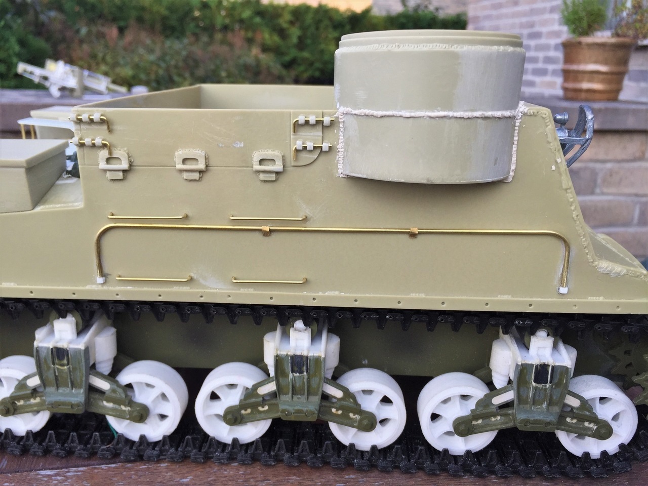

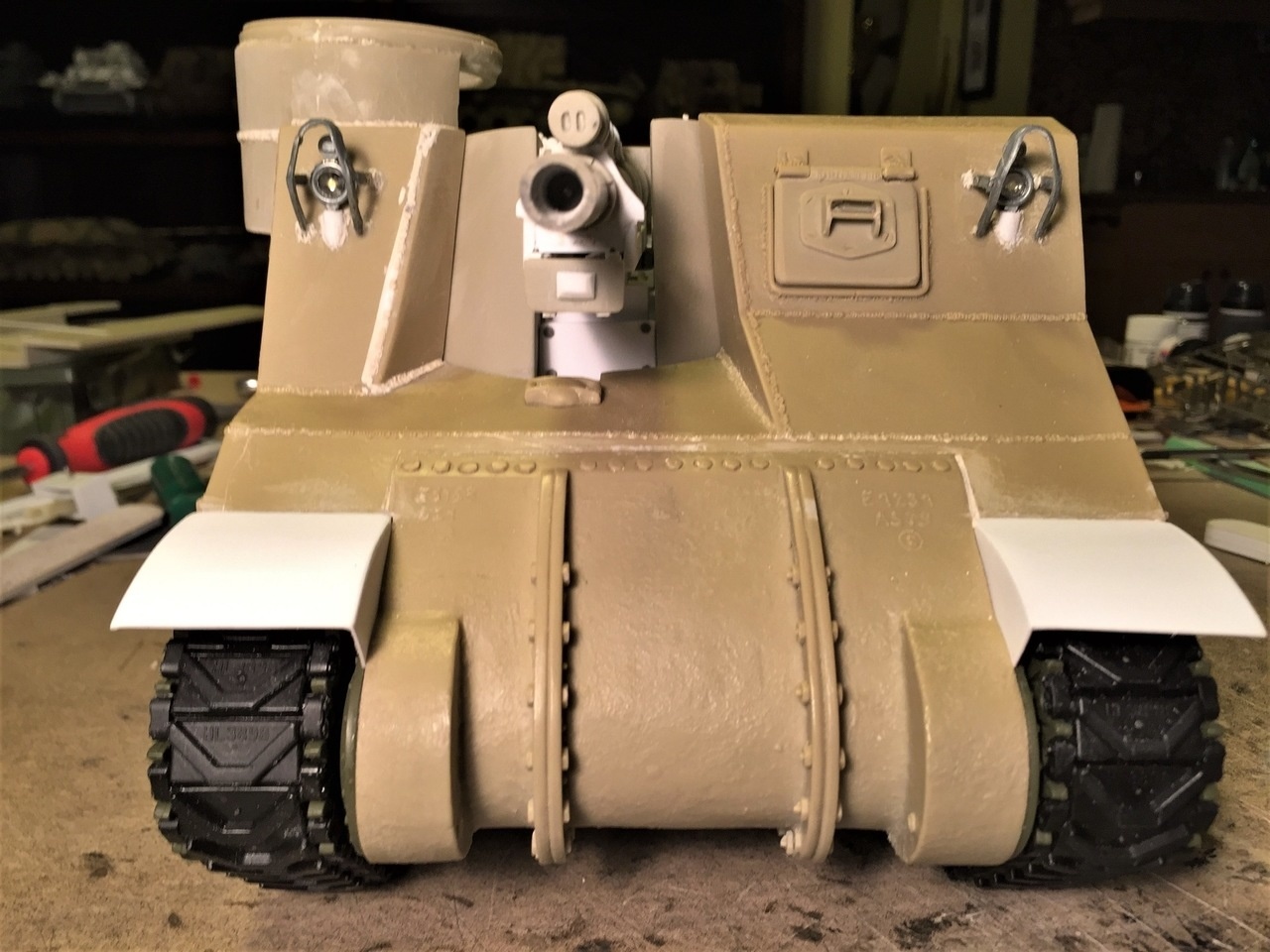

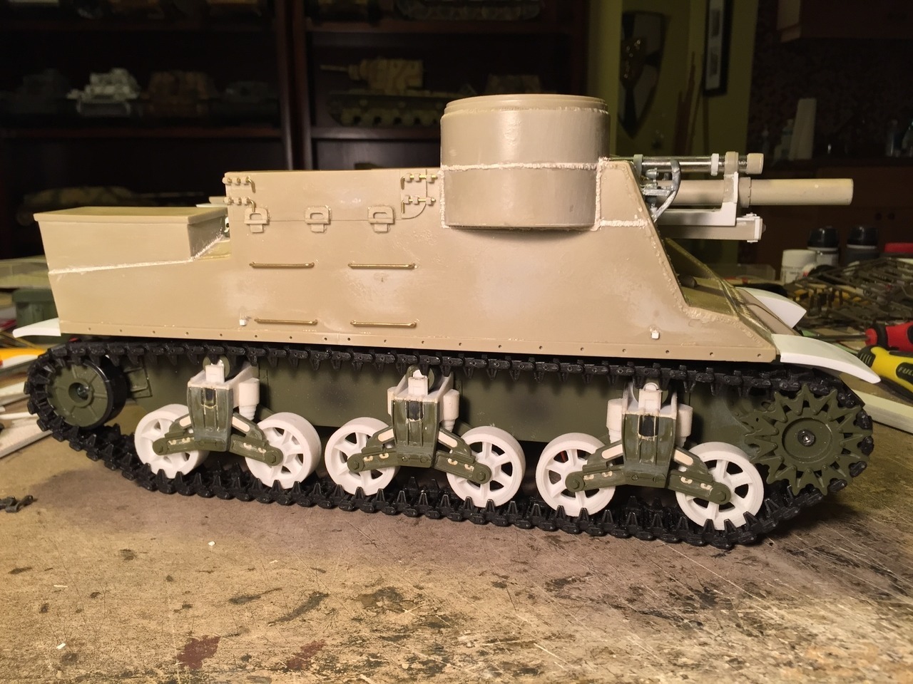

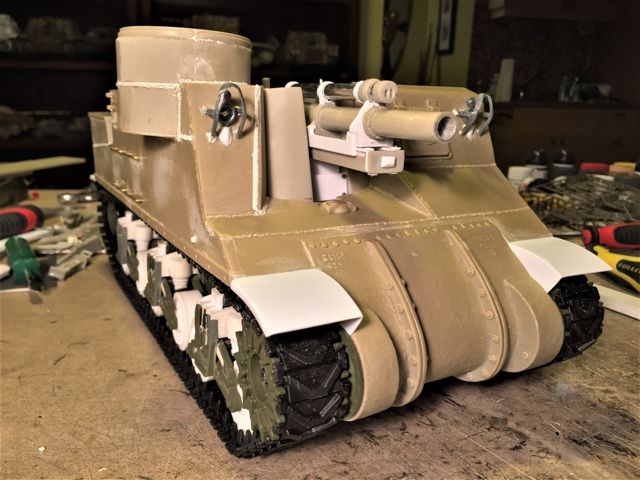

Here is a sitrep. I've been going around the model and adding items here and there. I am close to having finished the building phase.

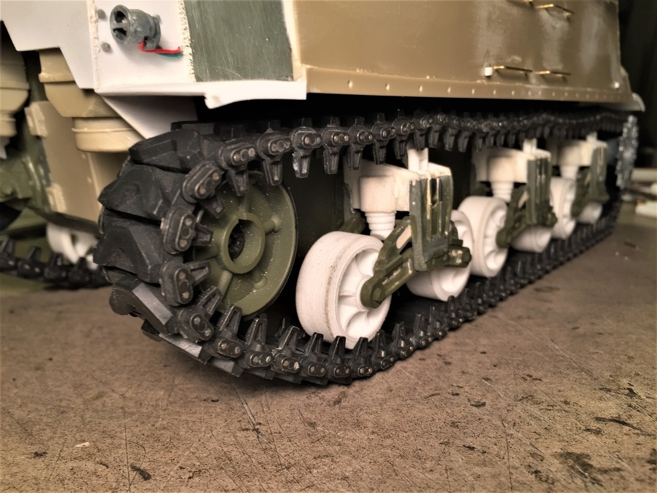

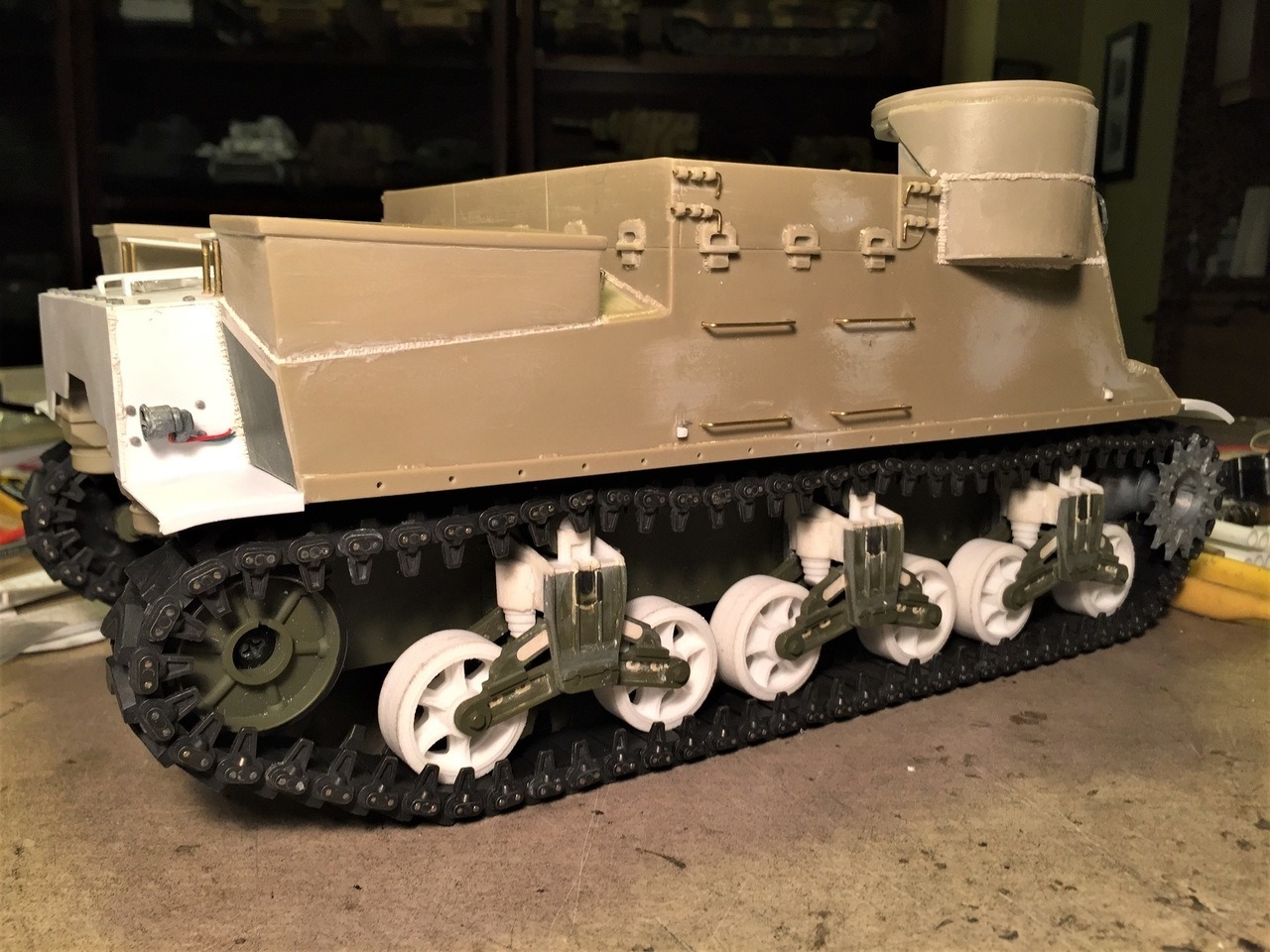

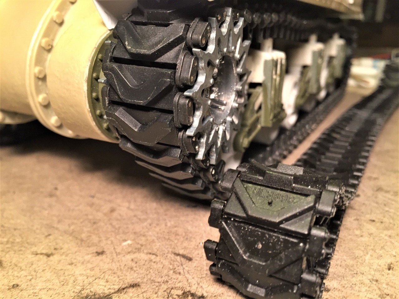

One thing I was looking at is replacing the Heng Long tracks by a set of spare plastic Mato T-48 tracks that comes with the plastic Mato Sherman, I have one set in store, along with metal sprockets for them. I have found the Mato tracks to be of overall better quality, they are not empty on the inside face but they seem oversized compared to the Heng Long and are quite heavy. Or maybe it is the Heng Long tracks that are undersized. Both seem to be T-48 but are so different.
I have not done any field test yet to see how the Mato runs with the Heng Long sized road wheels but other than being a bit loose, they seem to fit. I might need to remove one link or maybe replace the idler. The sprockets also fit the Heng Long gear correctly.
Here is the model with the Heng Long tracks
M7 Priest Heng Long tracks

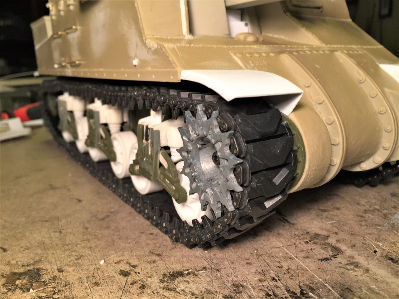

And now with the Mato tracks
M7 Priest Mato tracks
Here are the two track side by side, notice the difference for about the same unit cost for spares...
I personally like the Mato tracks better. Do you guys agree ?
Thanks, Louis
Re: Vandra M7 Priest SP Howitzer conversion build
Hello and good evening Louis. I've studied these photos for a few minutes and am on the fence. The Mato ones look s bit chunkier for sure.
Maybe a bit too thick. But much better detail for sure. The tell tale step will be once you paint and weather them. To get the real effect.
I wish the Mato ones were the size of the Heng Long ones. Look at this photo...Image
