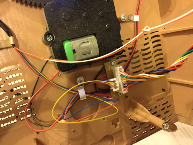

Re: T90 board into Tiger 1 question
This is what my Taigen Tiger looks like....
The three pin plug looks as though it is the key. One of the wires is a common.
Okay - the 3 pin plug on my last picture above - turn it round (this is on a Taigen Tiger)
Now I get the main gun to fire by moving the left stick horizontally to the right.
No gun sound effect though......
It's not right but it does fire the main gun.
