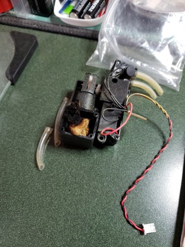

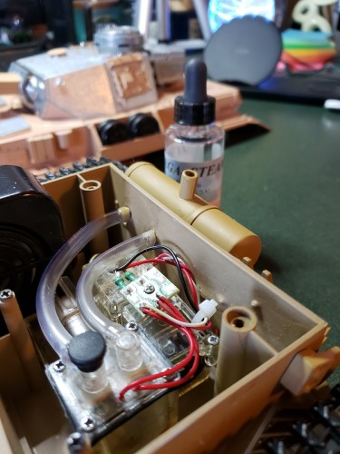

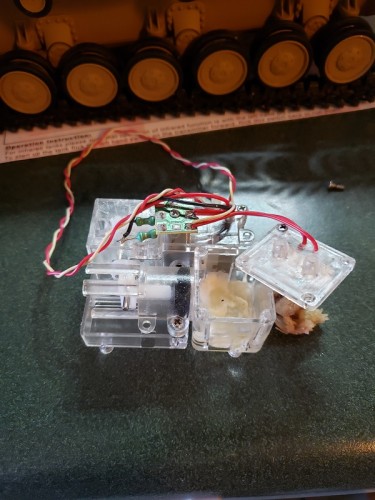

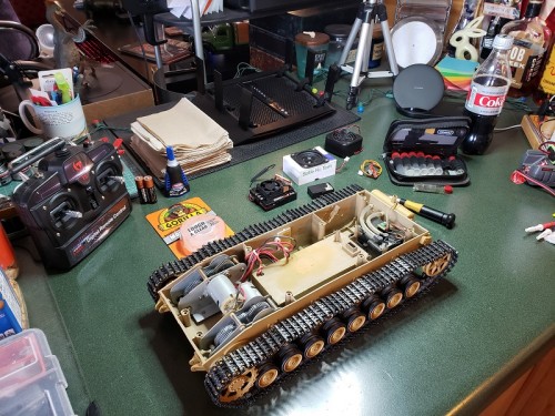

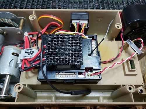

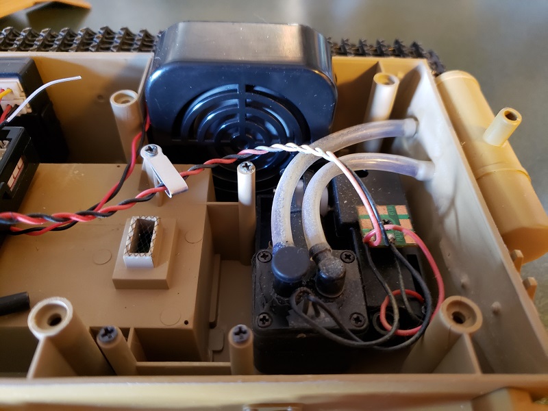

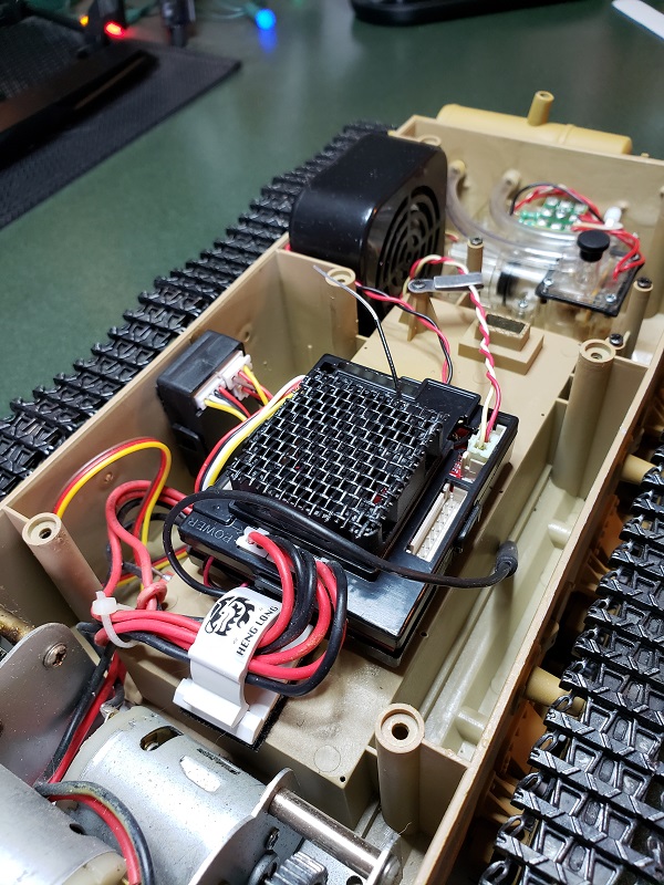

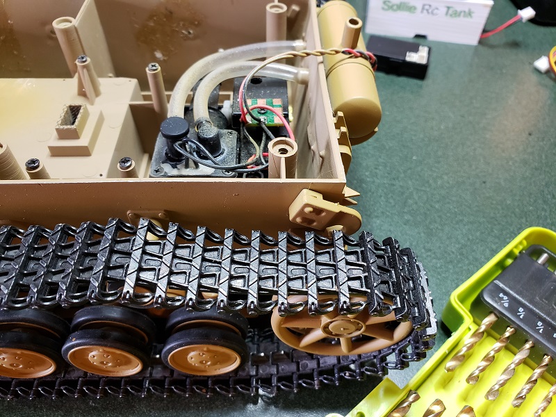

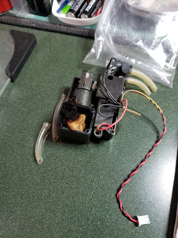

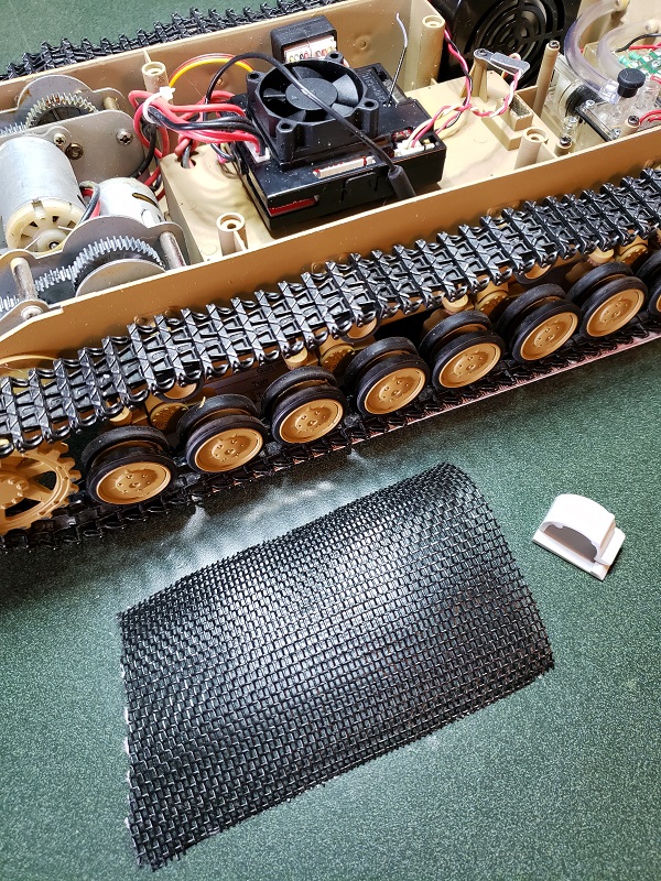

So, like the 'Palace' Build will always be part of Wish and then Bobby passing in one week, now this Build will always remind me of the General. ... I labored over a couple of nights installing electronics then repairing\replacing the Smoker. Everything works so far to my satisfaction...

I put some mesh over the old crystal port and use it as a heat vent for the battery if it ever got warm..jpg
Old smoker opened up and a cap for easier refill installed.  More on this thing later....jpg

Glad you caught the dodgy smoker before you had a total thermo nuclear meltdown Mr Painless :thumbup: nice idea with the mesh for a repurposed crystal port. :wave:

Thank you for looking in! Yessir, there were no resistors on the board for the original HL smoker so it worked initially then zorched itself with the extra current from the new MFU. The replacement Frankenstein smoker is built out of the best parts of three Taigen units so it should last a while. *crosses fingers and knocks on wood*

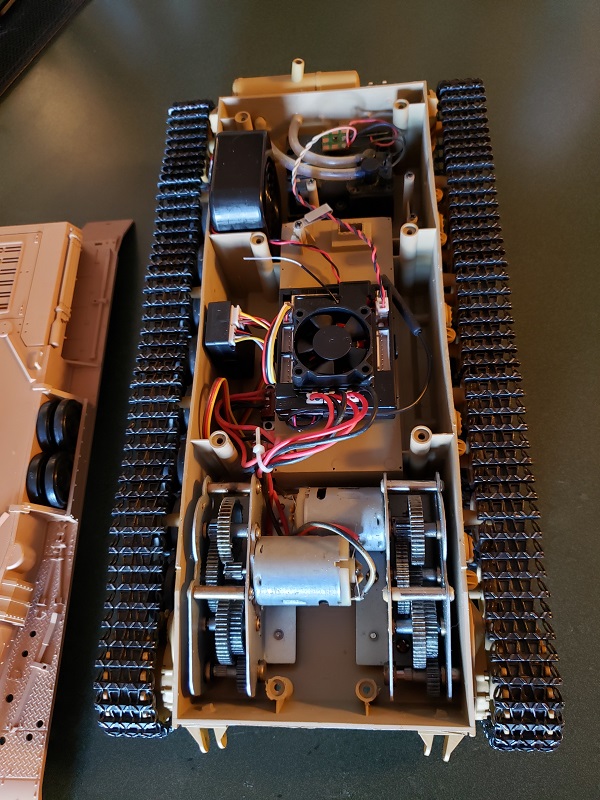

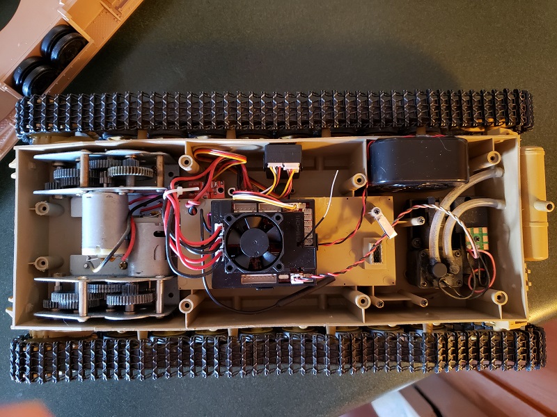

A little more more fun finishing up the electronics installation on the Lower. After that, it is time to turn the new Taigen Deck into an 'F' using the original HL Deck as a guide.
Biggest issue with those useful fans is keeping wiring out of them...Solved.jpg

Great progress my friend :clap: :clap: I'm enjoying this one!
